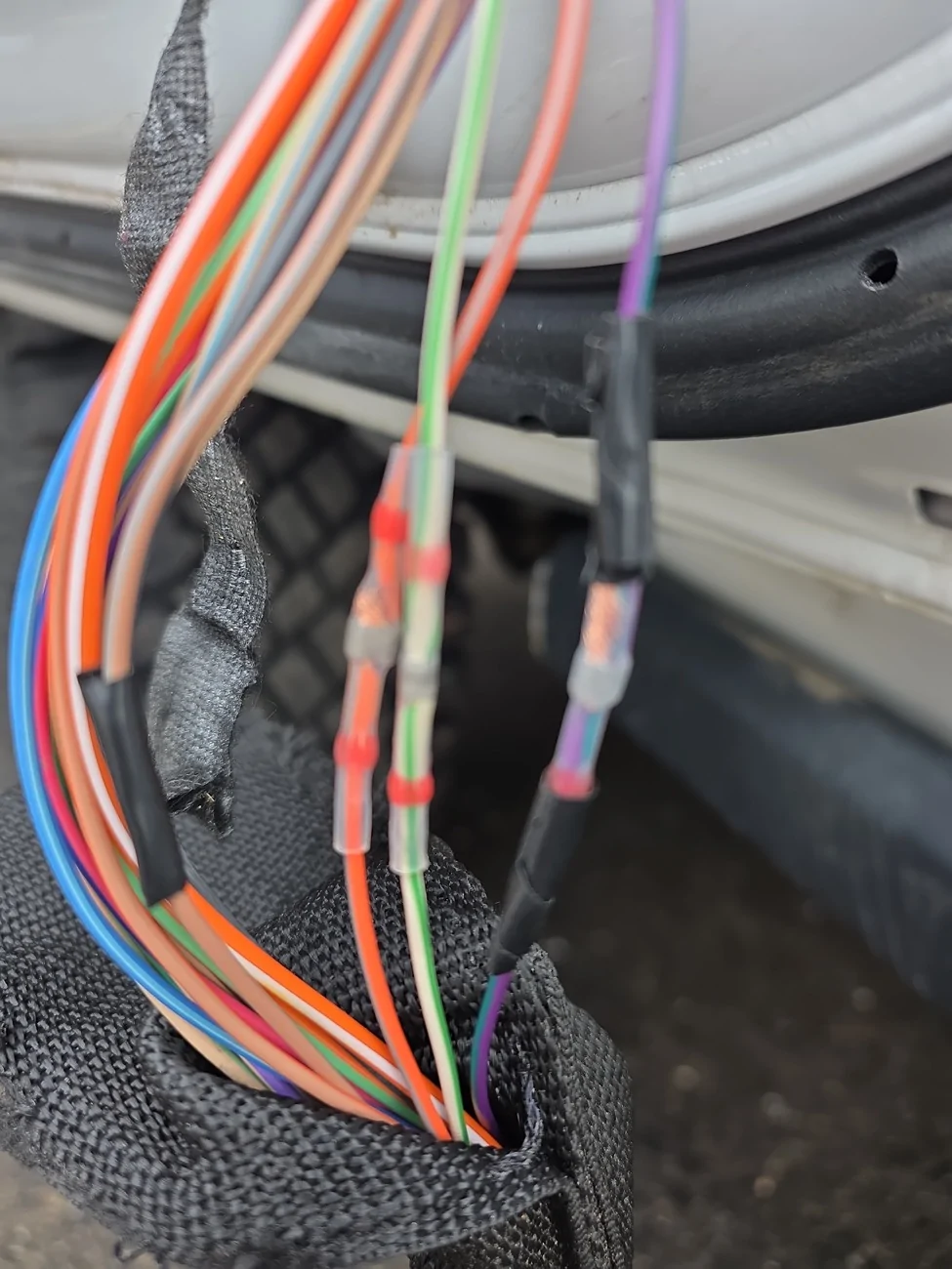

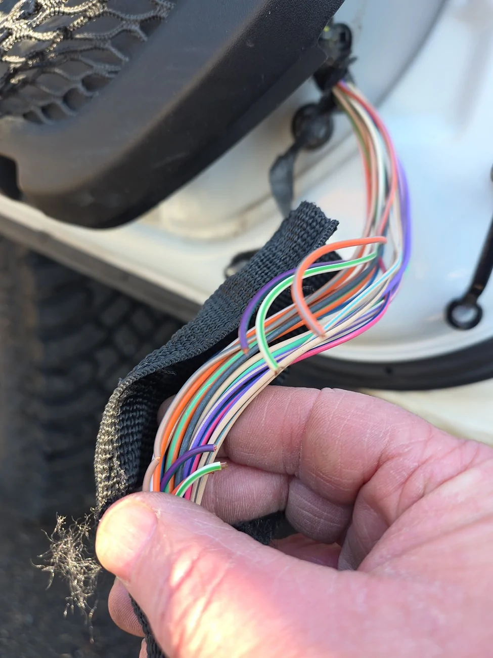

Fixed my driver's door electrical problem
1 split and 3 completely seperate
Okay I got the same thing going on . So how did you get that Nylon sheath off those wires ?
40,515
54,051
Solderless connectors...........
When repairing such wires, I typically put in lengths of high-flex silicone wires - high strand count, extremely flexible. It's like welding cable in miniature.
Copper work-hardens. The more it flexes in an area, the harder it gets until it eventually breaks. The key is making sure there's no stiff area and the flex can be distributed along the length of the wire. Copper wires break at joints, terminations and so on, or in these cases, where the bundle folds and flexes inside the sleeve.

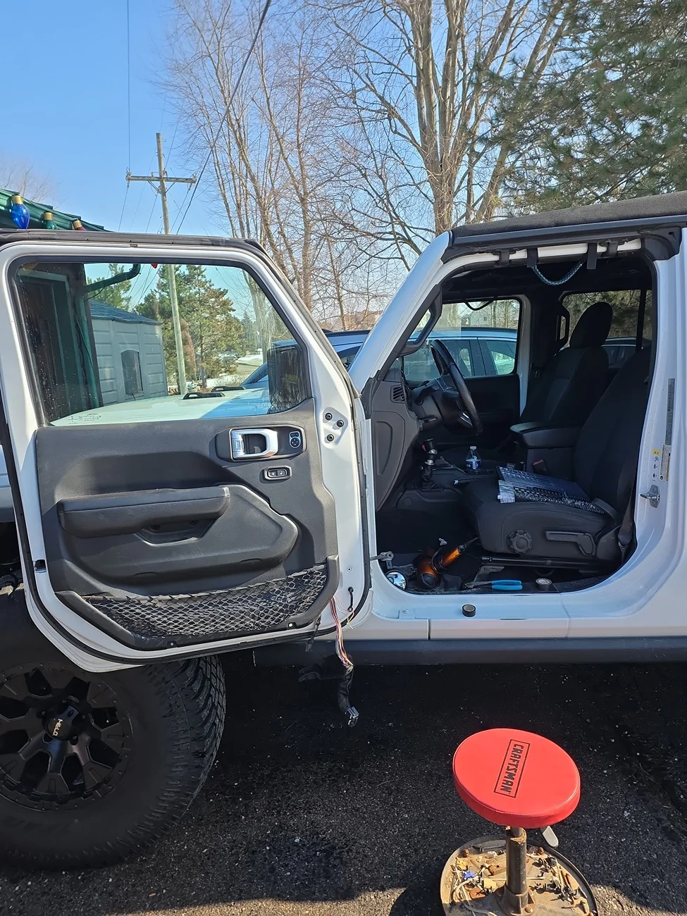

Nylon sheath, as in the strap?
I opened door completely to create room to work. Popped the door panel mostly off, to get the wire bundle free. Once I moved the strap up or down to find broken wires, I was able to use wire snips on the threads holding the nylon strap together. I think that strap stretches out over time and the wires inside are too short to handle the extra travel. To answer your question, the strap has a sewn seam that can be carefully separated.

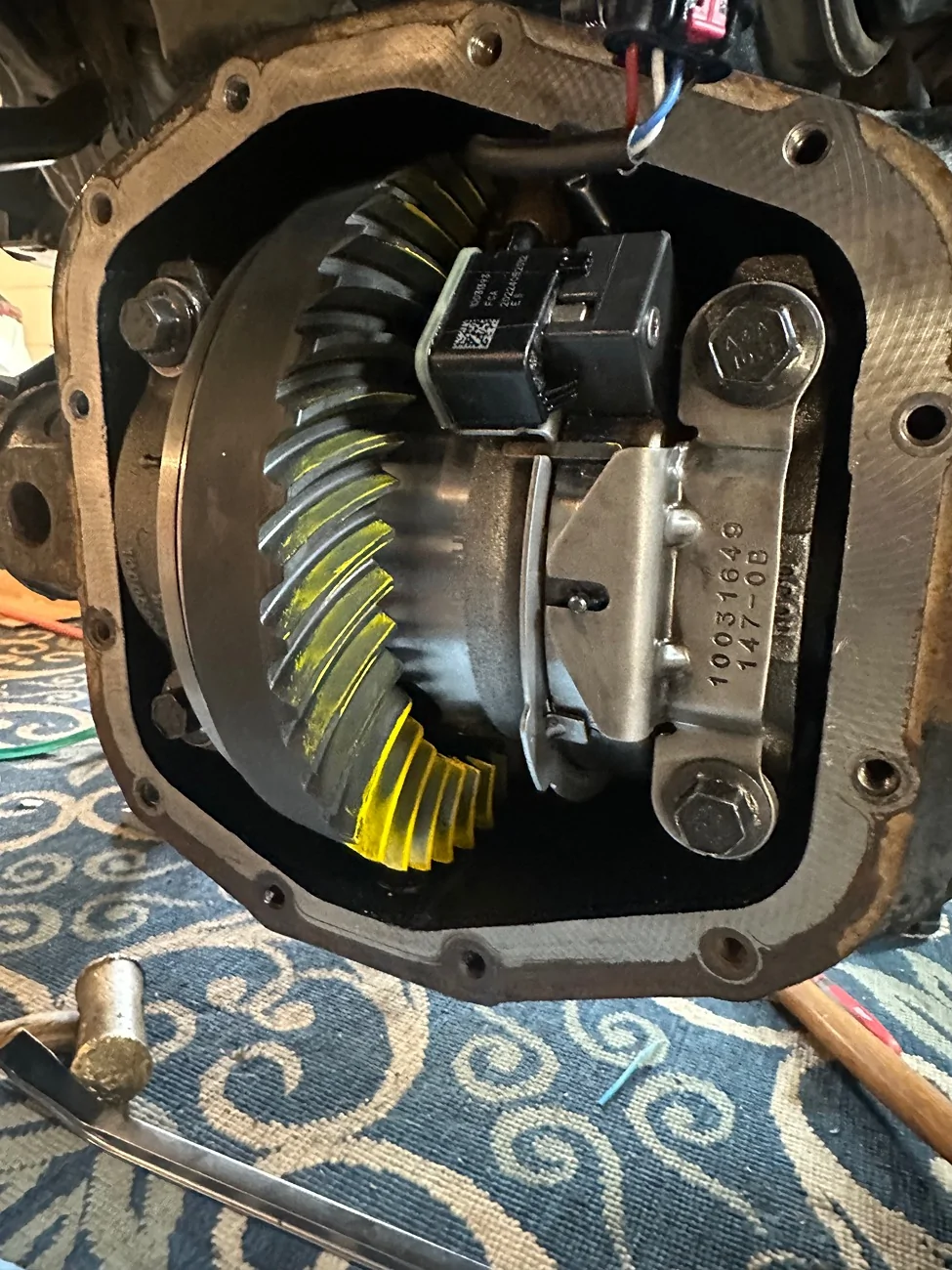

I was super happy with the parts Revolution sent. And there were more than enough shims. We got it as close to perfect as I can imagine. Only two tries. My 12ton HF press didn’t do it. Had to go to a shop to borrow the 20. It’s been demoted to only being used for the small press brake. The next time I do gears I’ll buy an actual good press. We did the final carrier bolt torque in the housing. It worked great that way. My very large bench vise wouldn’t hold it. And I don’t trust that press.

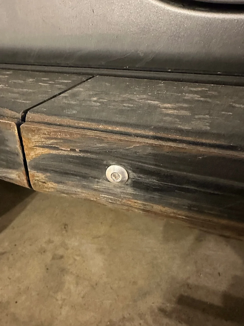

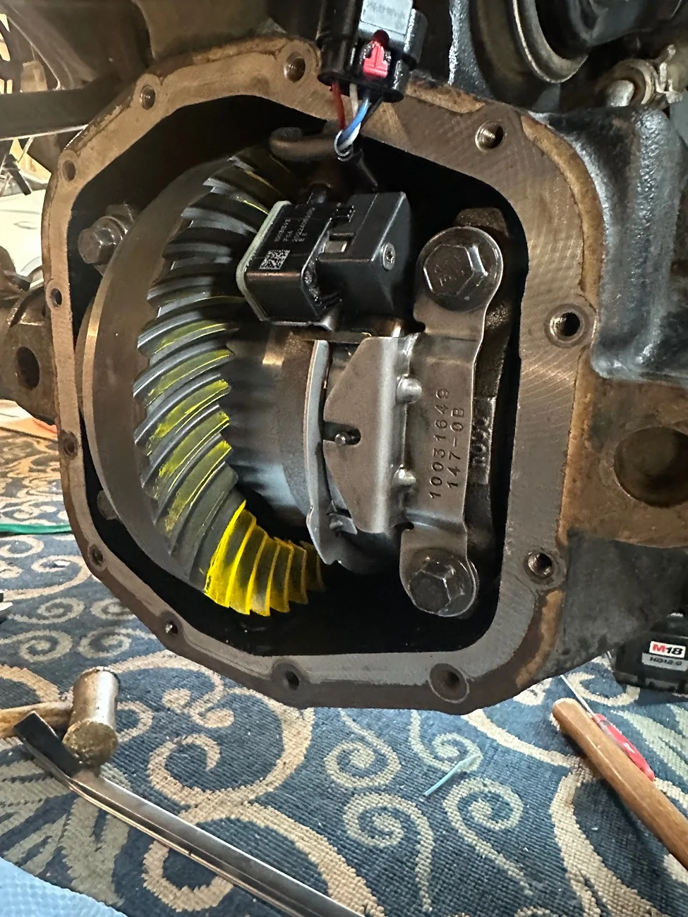

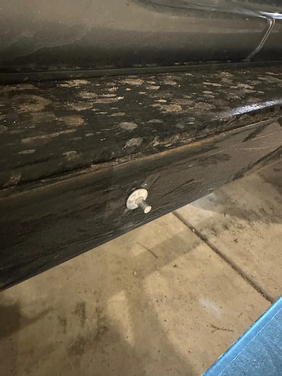

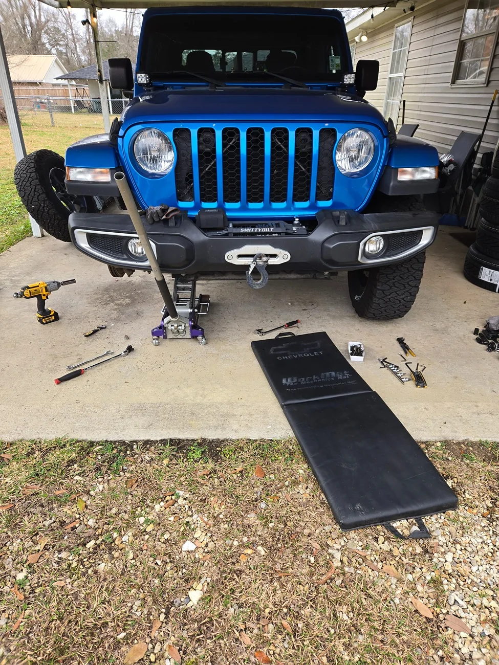

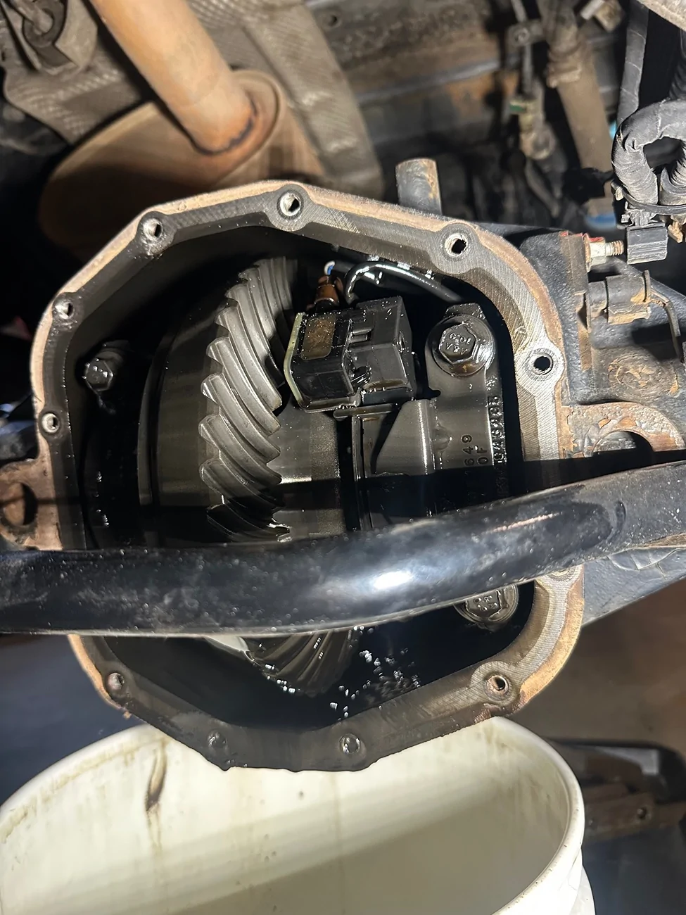

I’ve got a super small leak somewhere on my rear. It was redone a year ago professionally. Meaning new bearings, shims, seals, etc. I’m hoping it’s just the cover, as I’m going to AZ on Thursday for some rock crawling. So I guess I’m removing the skid and doing a fluid change for inspection purposes today. I replaced a couple RSE step slider rivets today as well. I sheared them off on the lane creek squeeze in September.

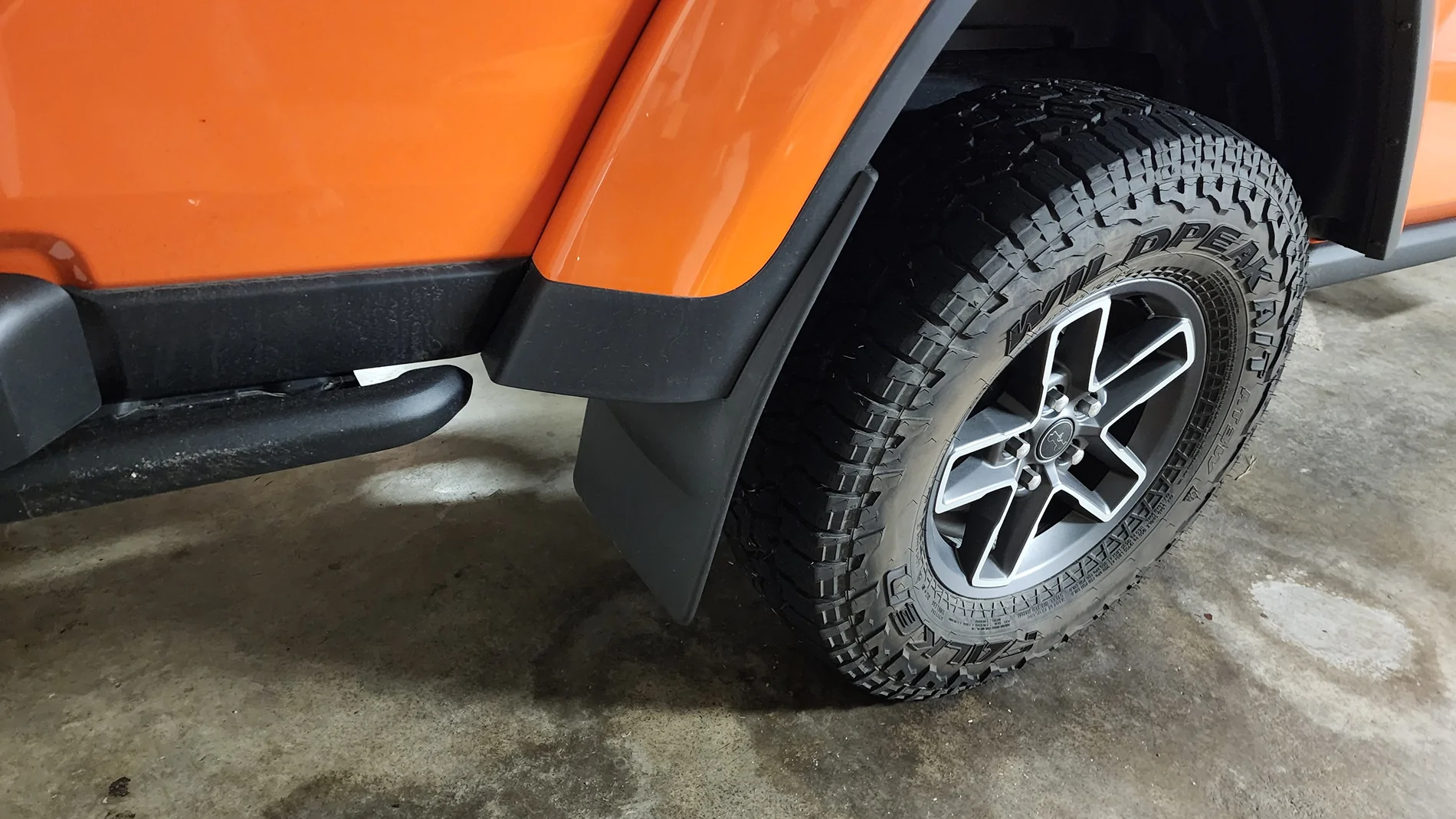

No pics, but installed the Weather Tech mud flaps this afternoon... Took about 1-1/2 hours to do it. Once I did one, the other 3 went pretty dang straight forward. Only issue I had was even with my small hands, 2 of the 3 bolts are not the easiest to get the nuts on. Once on, it's a snap... Looks good and the bride likes the look too. Win-Win for me. :)

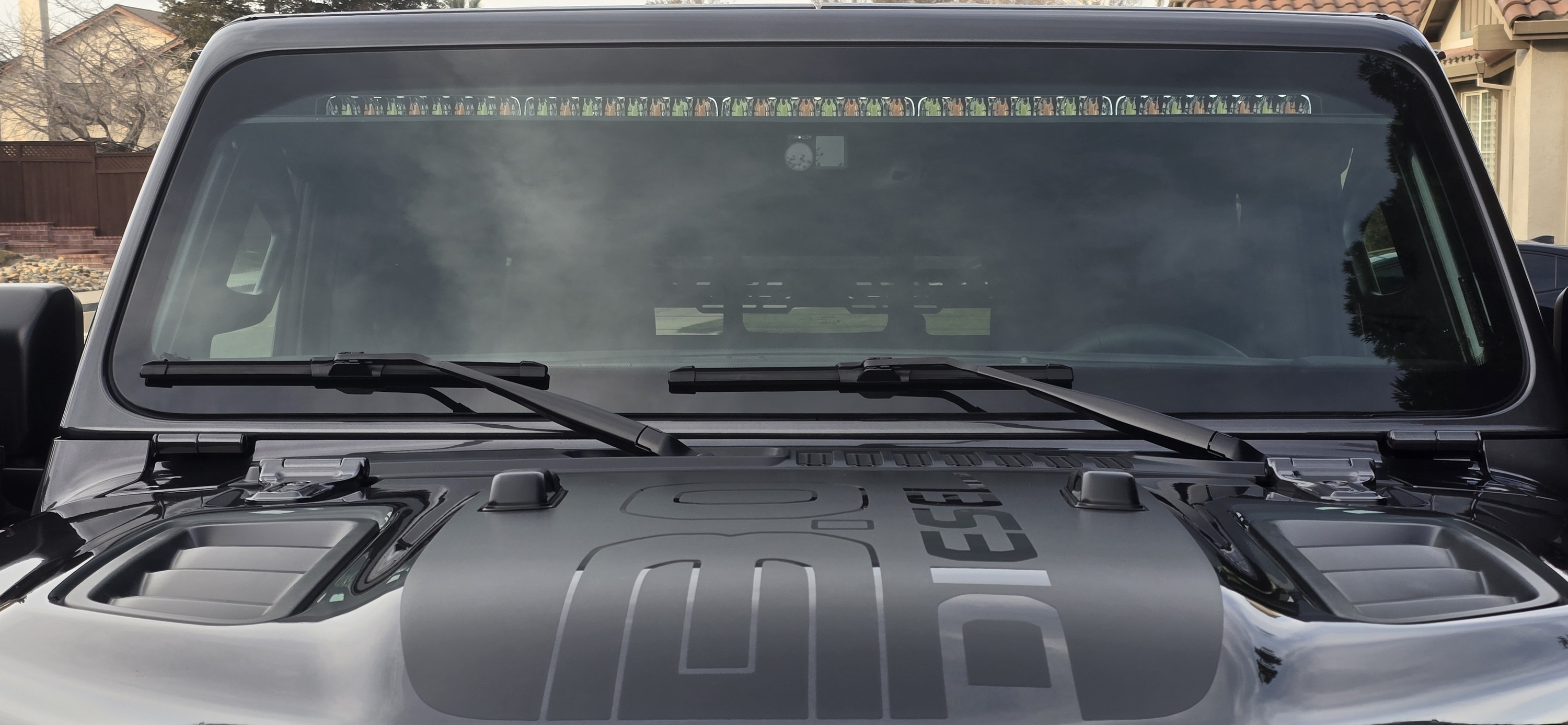

Mounted a DJI Action 5 Pro camera to the underside of my Stealth Light Bar. Wired it to a power supply so it doesn't drain its battery when the ignition is on.
Who makes that light bar and do you get any backwash from the windshield once it’s on?

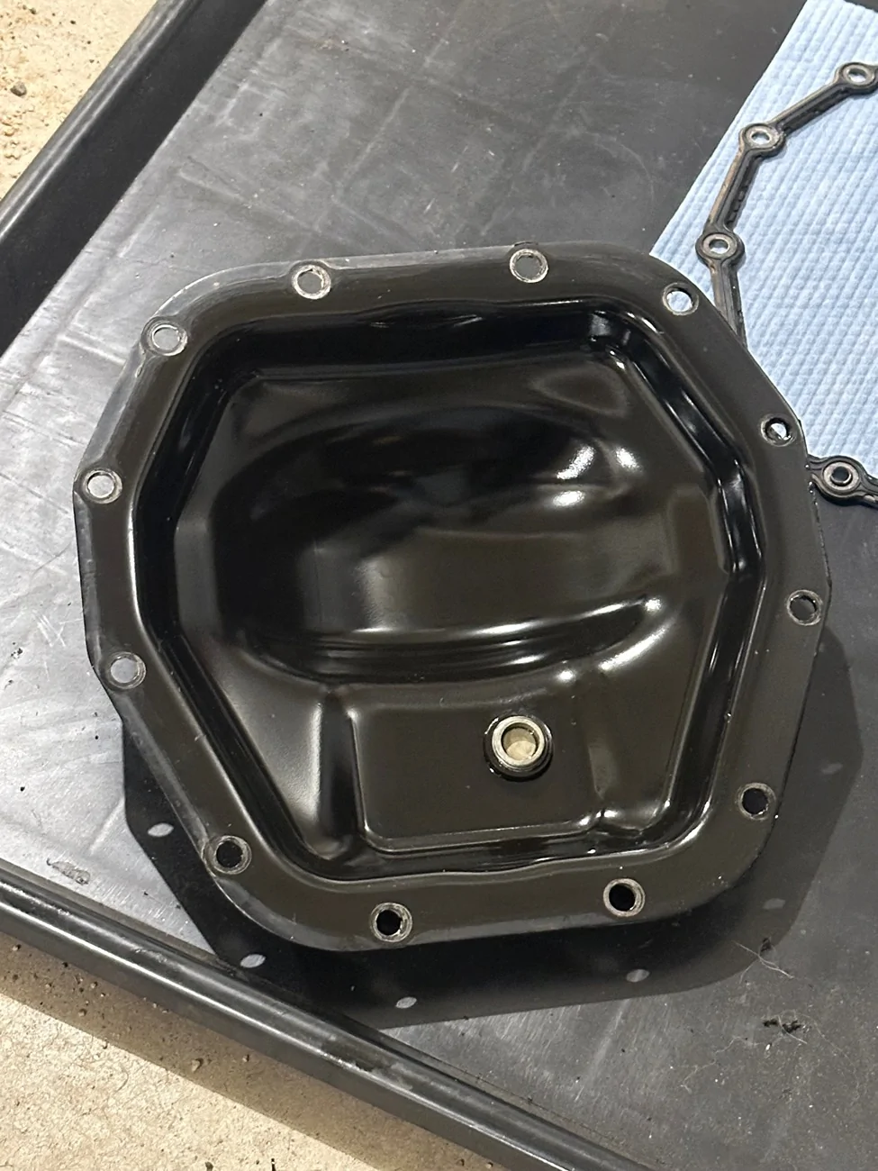

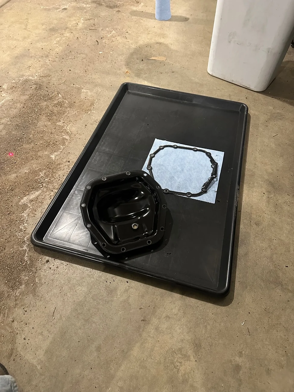

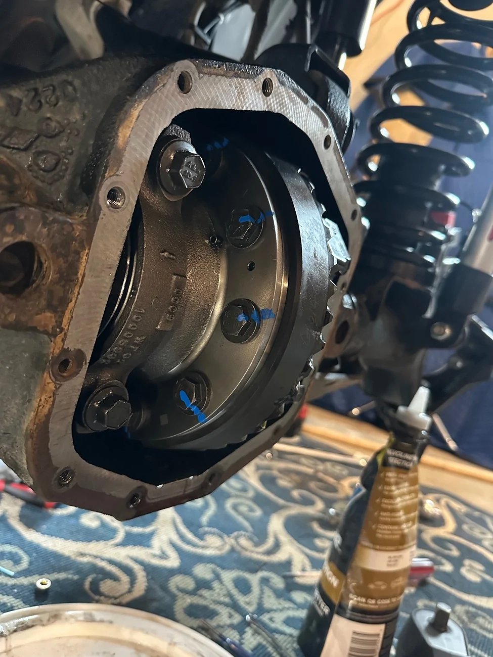

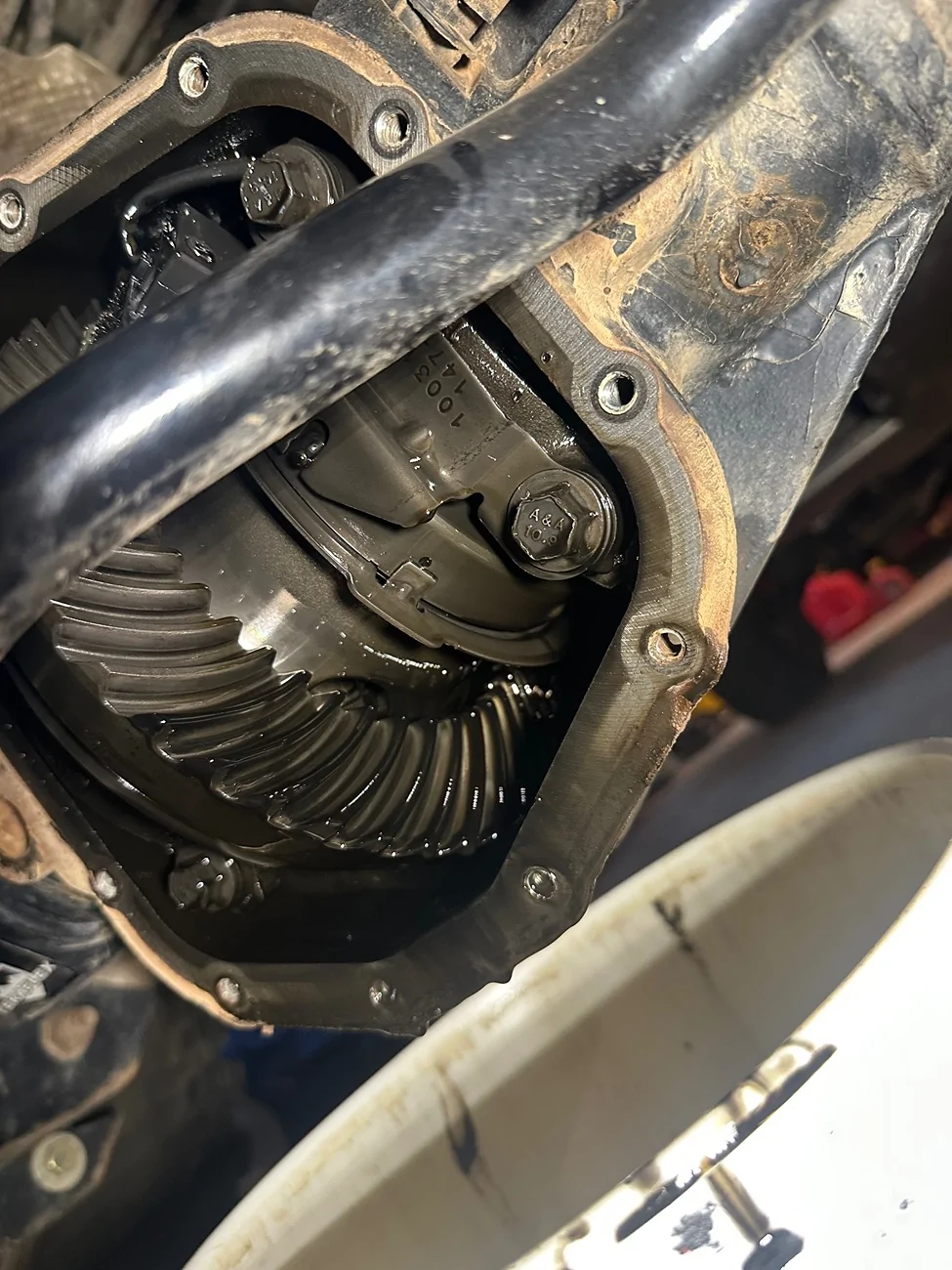

Just did the thing I was dreading, but needed to do before driving it to phoenix for rock crawling on Thursday morning. Trails Friday through Sunday.
I had some small occasional drops from the rear diff I’d been avoiding looking at. I assumed pinion seal, but hoped cover leak. Couldn’t tell without pulling the skid. Pinion. Shit. When I found that on my front the pinion gear was also toast. Lots of debris in the housing. I pulled drained it, then pulled the cover, and thankfully there’s no debris in the rear. So screw it. I’m not pulling the carrier this week. I’m just refilling it and I’ll bring a quart in case it starts leaking worse. Gears look great I think. They have 71k miles on them. I’m a bit pissed that I paid to have bearings and seals done (full master install kit) in like November 2024, and I’ve already lost the pinion seal. Jesus. But for this trip, new fluid and it’ll be fine. Anyone have ideas as to why I’d lose a seal in so few miles? I just looked it up, and it was only about 10k miles since the bearing, seal, and shim job.

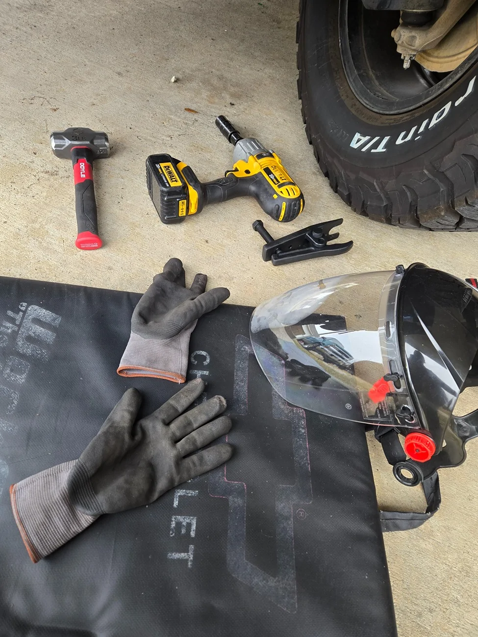

Installed a Metalcloak drag link. OEM one was shot at 35K miles on 33s šŸ™„
Was relatively easy. Ball joint separator press and a 3 pound hammer made getting it off the pitman arm not too horrible. Being a southern truck helps.
