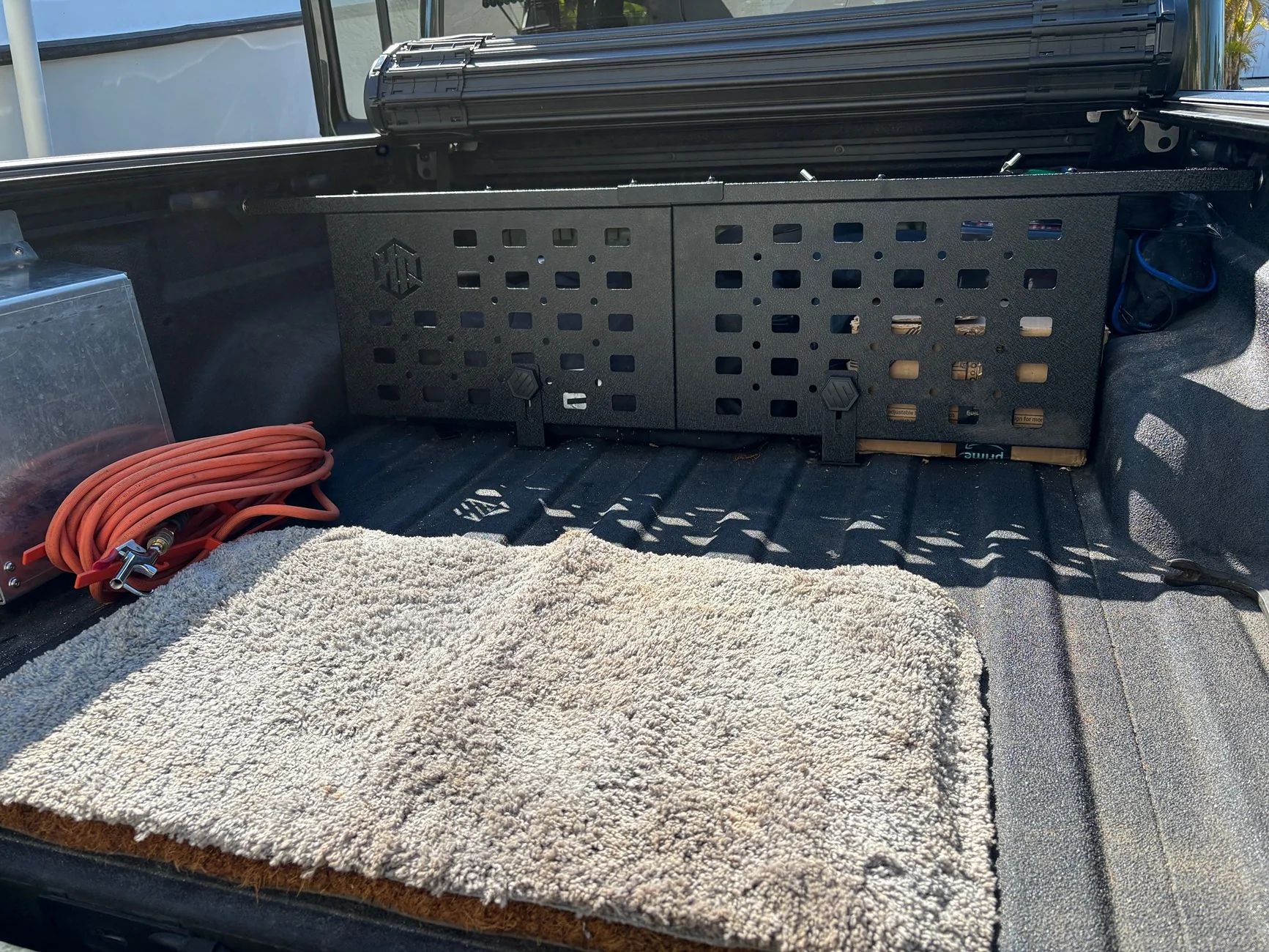

Finished the install of my @Hooke RoadĀ® Cargo Divider.

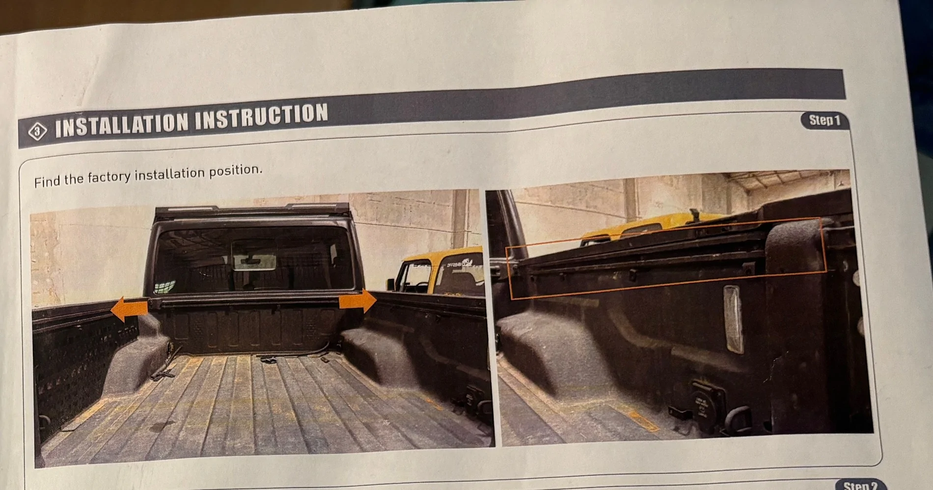

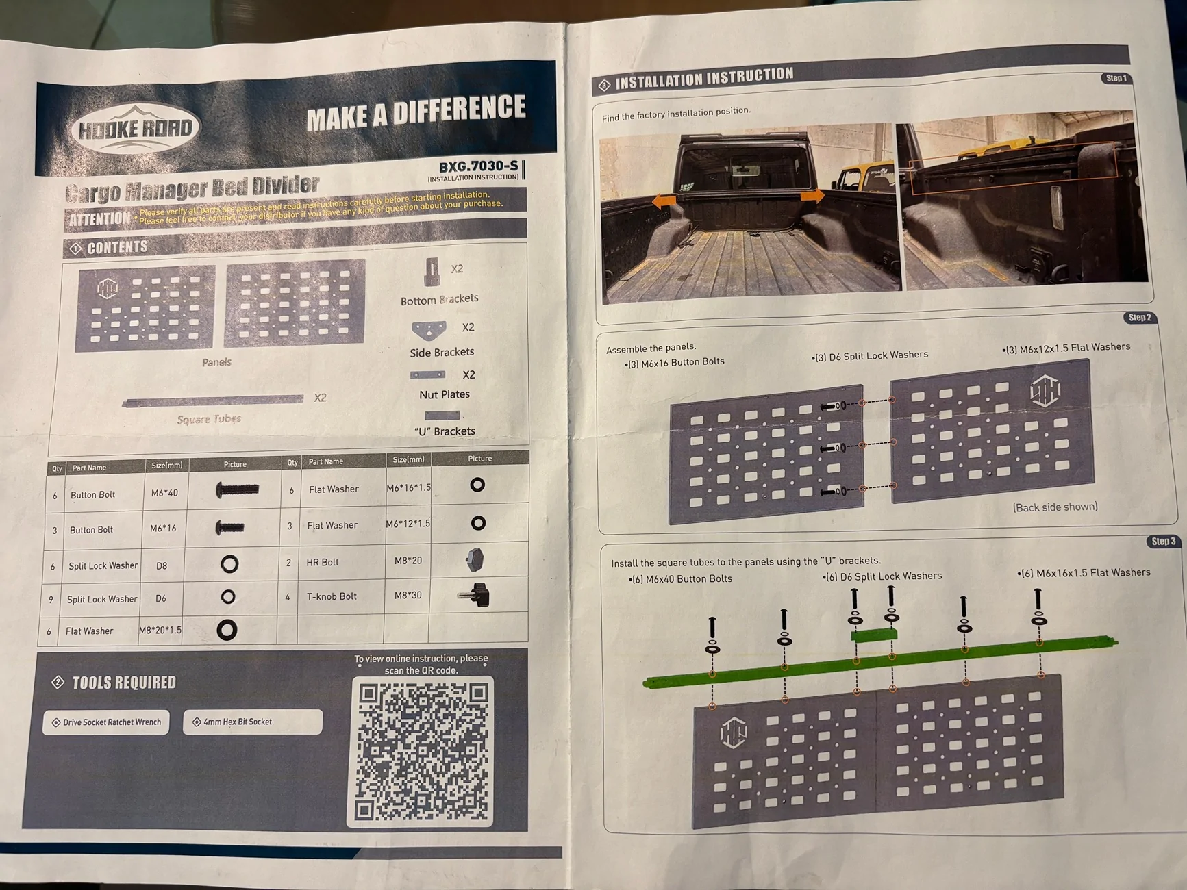

Pro's; It works as advertised once installed. It looks good. Other than the first and sixth step of the installation, the directions were good---love the fact they actually include words with the pictures. My Bak4s roll up tonneau didn't have to be touched to install the Hooke Road divider. I believe most tonneaus will work fine and it's a typical cover your ass statement. It would be regretful if you have a tonneau system that didn't use or come below the factory rail system and forgo buying this.
Cons: Step one of the instructions are horrible as shown in a picture below. The step 6 photo is completely misleading as the factory rail system actually goes end to end from the front to the back of the bed--as seen in their photo of step one.
Jeep Gladiator What did you do TO your Gladiator today? [ADMIN WARNING: NO POLITICS, NO GUN TALK] 1 Install pg 1 n 2
Looks good, right?

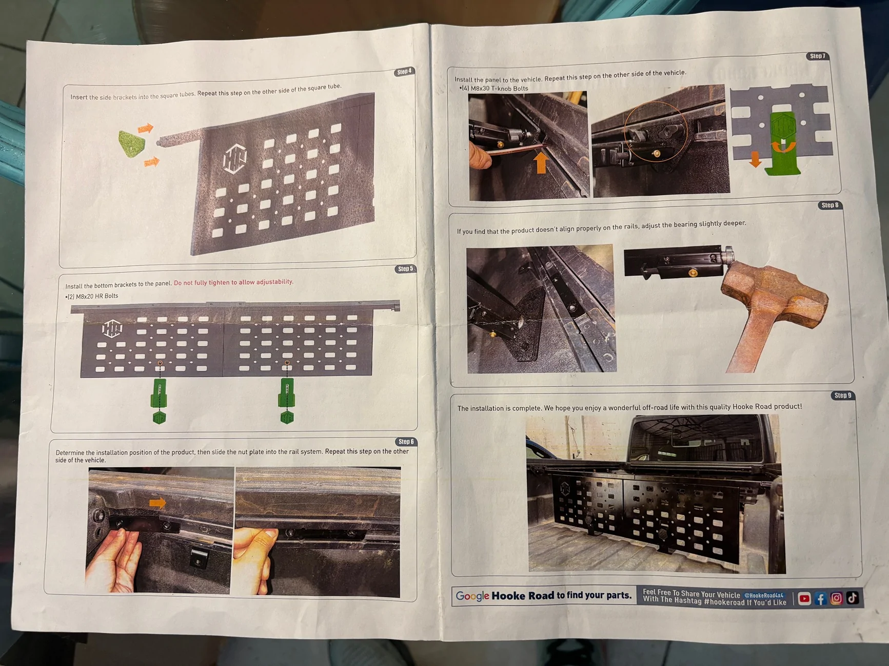

Jeep Gladiator What did you do TO your Gladiator today? [ADMIN WARNING: NO POLITICS, NO GUN TALK] 2 step 1
WTF does any of this mean? Where are the sliding mounting hooks that come with the factory trail rail system?
Step 1 should clearly state that the entire factory trail rail system needs to be removed in order to slide on the backing for the Hooke divider.
It should also state the option to remove one or both sliding cargo hooks. I elected to remove one from both sides so I would have a hook in front of and behind the Hooke Road divider plate.

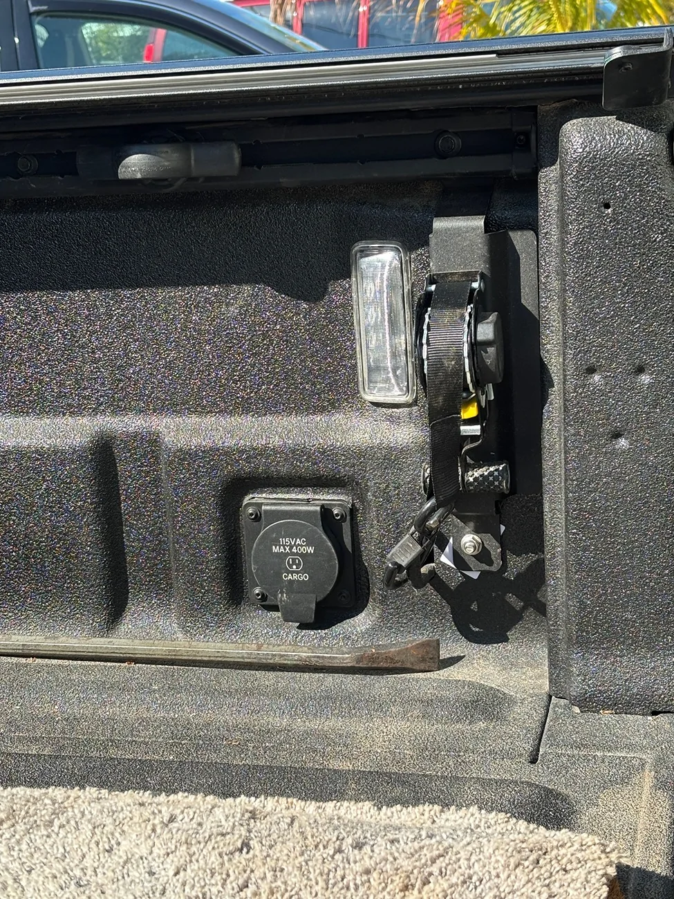

Jeep Gladiator What did you do TO your Gladiator today? [ADMIN WARNING: NO POLITICS, NO GUN TALK] 3

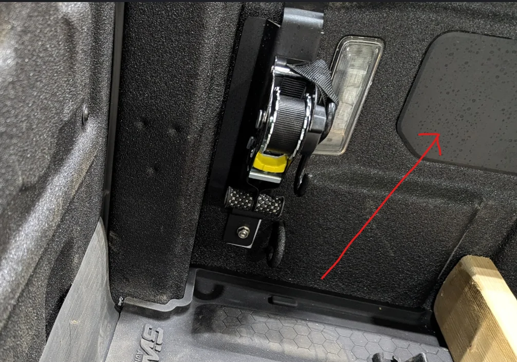

In my case I also have something else on both sides of the truck that need to be taken off from the factory rail. The ratchet strap just needs to be taken off to allow the Hooke plate to be inserted.

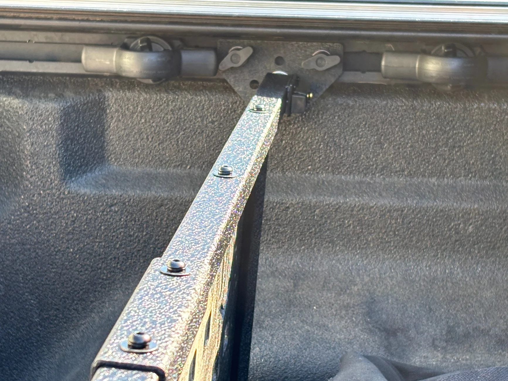

In the case of my dual compressor there is also a plate in the rail the compressor attaches to. So this plate as well as the mounting hook had to come off and the Hooke plate inserted before putting the mounting hook on and then the compressor plate reinserted.
Jeep Gladiator What did you do TO your Gladiator today? [ADMIN WARNING: NO POLITICS, NO GUN TALK] 5 install pg 3 n 4
Again, the factory rail has to come off to insert the plate so the step 6 picture is completely misleading.
Finally installed with help of the wife unit. Impossible for a mostly one armed man to get the holes lined up even with the great adjustable bottom brackets that hold the divider up to the right height.
She had the brilliant idea to roll up a shop towel and wedge it behind the plates to keep them in place to screw in the side bracket t-knob bolts. Worked great on the Hooke Road divider.
Neither one of us could lift the dual compressor high enough for the other to get the bolts in---so being a tool guy I tried the crow bar but it wasn't wide enough to keep the compressor in place as soon as one of us tried to insert the bolt. So then I lay the crowbar sideways on the bed and added some tools on top but that didn't work either. She's says, "wait here" and then comes back with a stack of books and magazines to put it on until we found the exact right height. Love my woman---even if she was a squid.
Jeep Gladiator What did you do TO your Gladiator today? [ADMIN WARNING: NO POLITICS, NO GUN TALK] 6
As you can see I have a stock trail rail slidable hook on either side of the Hooke Road Divider

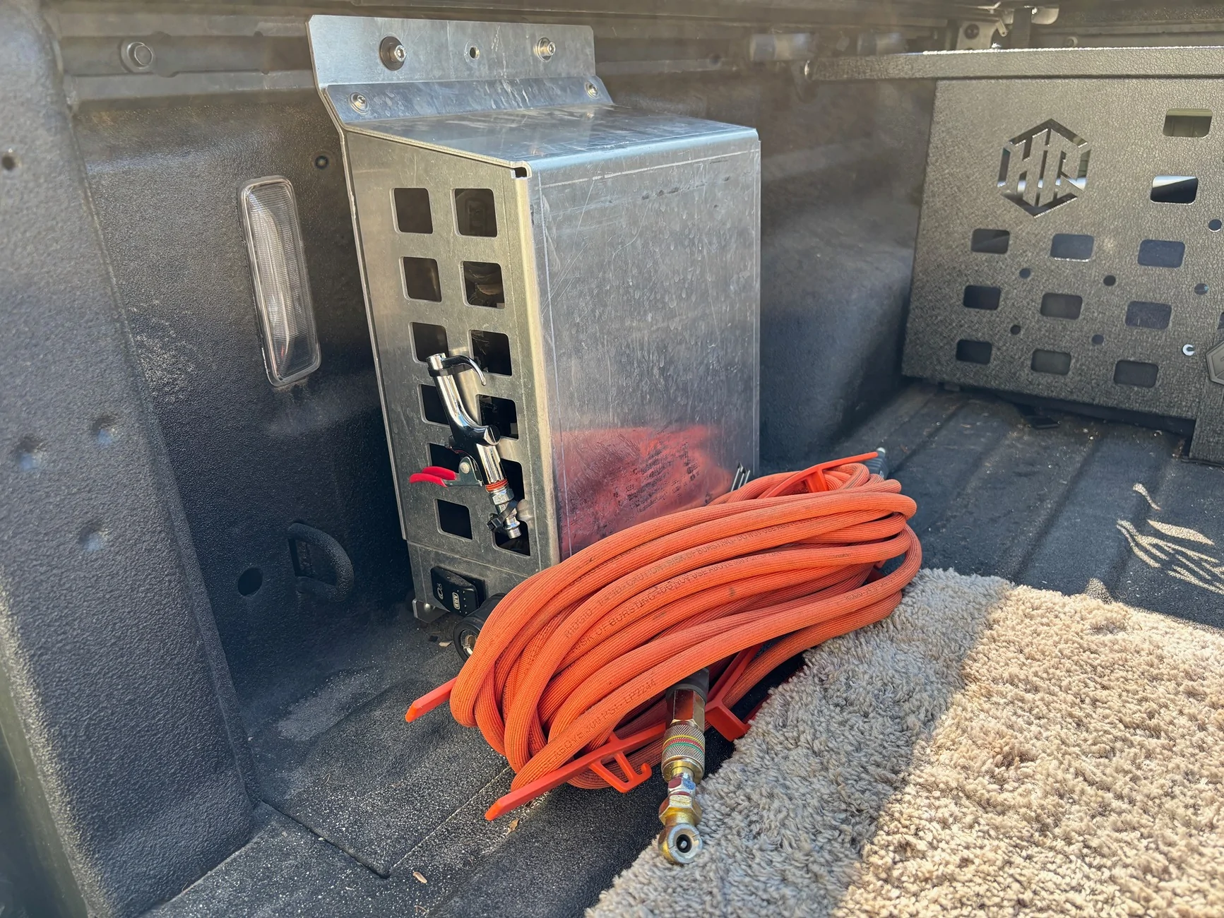

The other major thing I did to the Gladiator today was mount a zip tie to the air compressor to hold the tire inflator.
Jeep Gladiator What did you do TO your Gladiator today? [ADMIN WARNING: NO POLITICS, NO GUN TALK] 9
Then I went all out and mounted a second zip tie to hold the air blower! :handsinair:
Looks good, right?

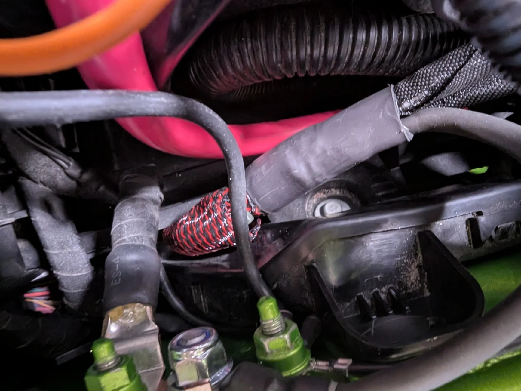

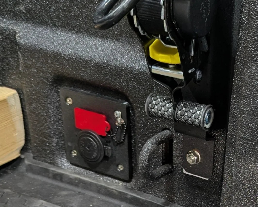

The wildguy will be happy to know that although I'm having to rearrange my acrylic mounts a bit, the wiring run into the engine bay is working out fine. I had to stop as Barbara needed me in the house ASAP- but there's only 2 connections left to make.

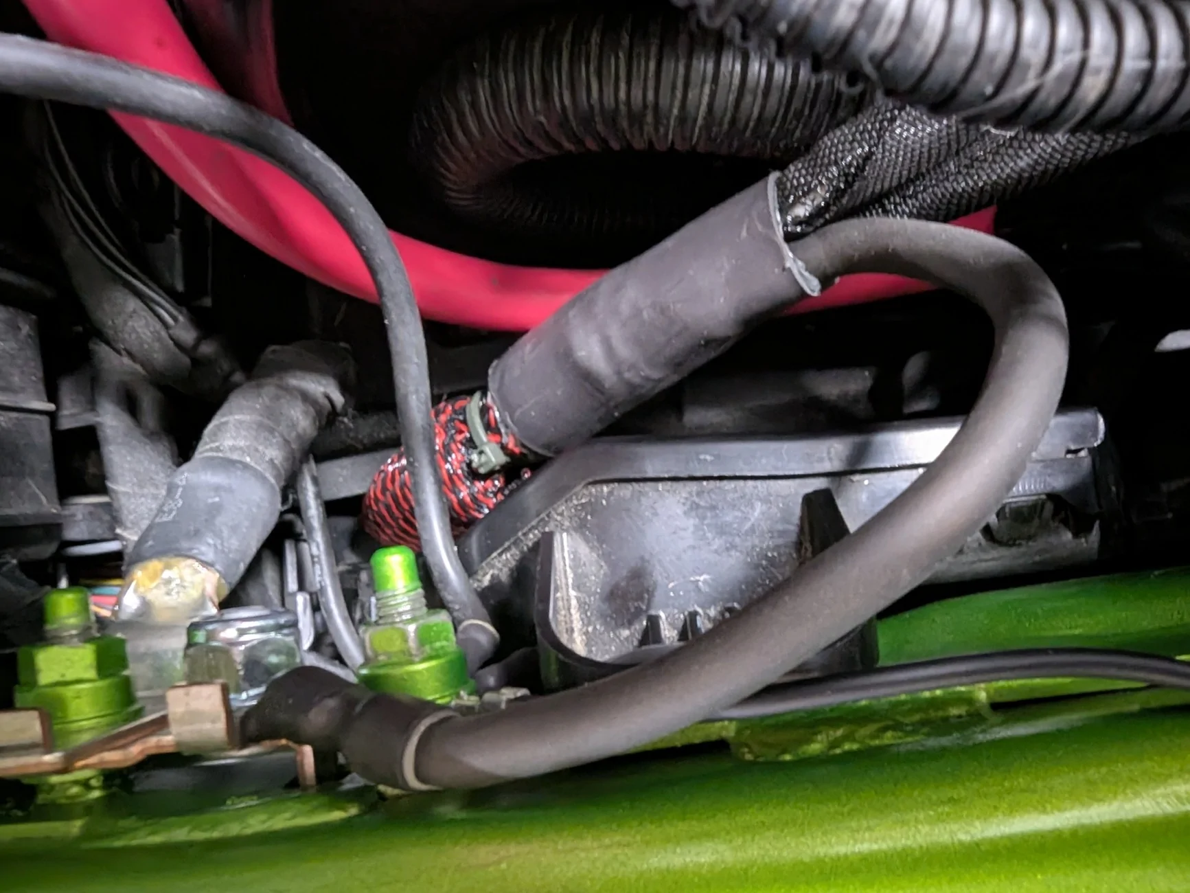

Here's the ground from that bundle, terminated to the heavy 8mm ground stud where the batteries connect to the chassis - seems like a good spot to pull ground for a 50 amp circuit and keeps the path SHORT.
The white 14 gauge is terminated on the terminal block for aux #4 to run the Oracle backup lights independent of reverse if wanted.
The orange 14 gauge is terminated at aux #2 on the terminal block to power the USB in the bed and an eventual 12v outlet.

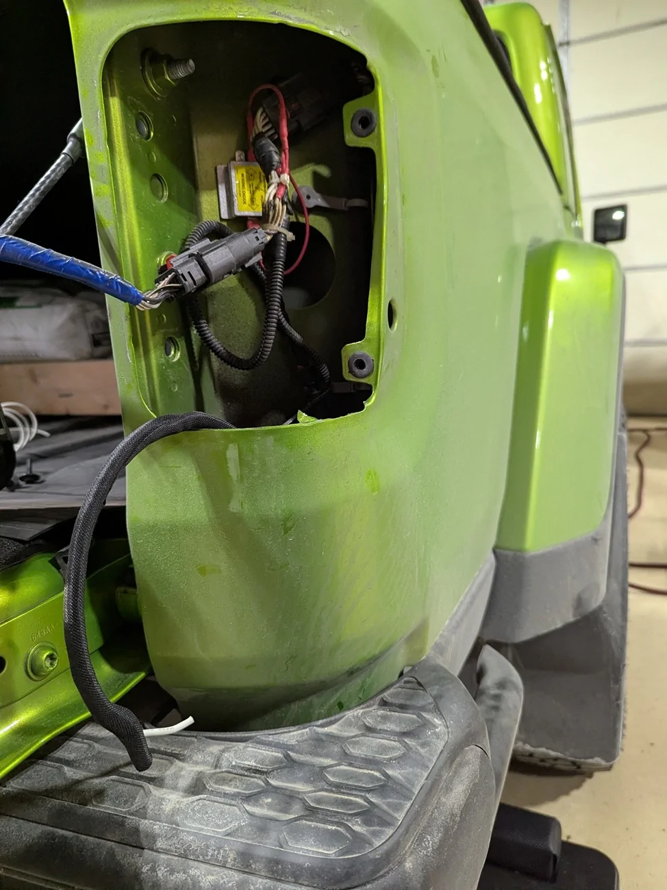

This white lead, part of the Bundle Dan helped with - goes to the diode behind the tail light.
Jeep Gladiator What did you do TO your Gladiator today? [ADMIN WARNING: NO POLITICS, NO GUN TALK] PXL_20260205_224643184
This is the 50 amp connector which will eventually power my 2500 pound trailer winch -
The orange wire that is part of that bundle will handle the USB charging in this plate, and I'll install a 12v outlet in the plastic panel/cover on the left side of the bed someday.
