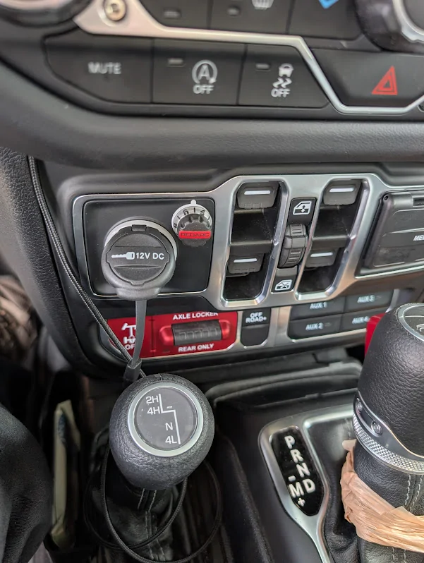

No, this is on my 22 JTR. I've got the Aux switches so these USB ports are wired to the ignition wire in the passenger footwell.

Here is the USB charger:
https://www.amazon.com/dp/B0D66VC3C1?ref=ppx_yo2ov_dt_b_fed_asin_title&th=1
Got those because they didn't have lights, were low power (only deliver 24W max (not per port)) so that wouldn't come close to the 10A fuse on that ignition wire.
The USB A to USB C 90 degree adapters:
https://www.amazon.com/dp/B0FXLWKSSM?ref=ppx_yo2ov_dt_b_fed_asin_title
I'd suggest getting two of those, just in case. It comes with two adapters, one to the left, the other to the right. I ended up using two of the go to the right kind, just to make the cable layout easier. I could have made it work using the "wrong" adapter by rotating the USB charger 180 degrees, but the center stack was all put back together by then.
The 90 degree USB C to USB C adapters:
https://www.amazon.com/dp/B0B1X14DZ3?ref=ppx_yo2ov_dt_b_fed_asin_title&th=1
Then if you are trying to do this with the BulletPoint Rubigrid dash mount, then these cables:
https://www.amazon.com/dp/B0CBSDR75V?ref=ppx_yo2ov_dt_b_fed_asin_title&th=1
Have the straight USB C connector that is just thin enough that it can be forced through the slots in the Rubigrid. Though they seem to be out of the black version that I ordered. Thanks to @Minty JL for finding those.

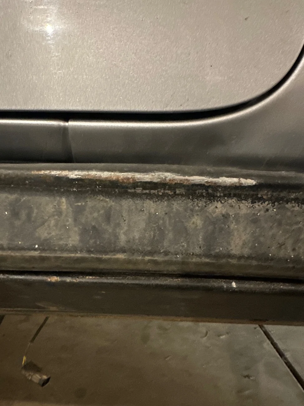

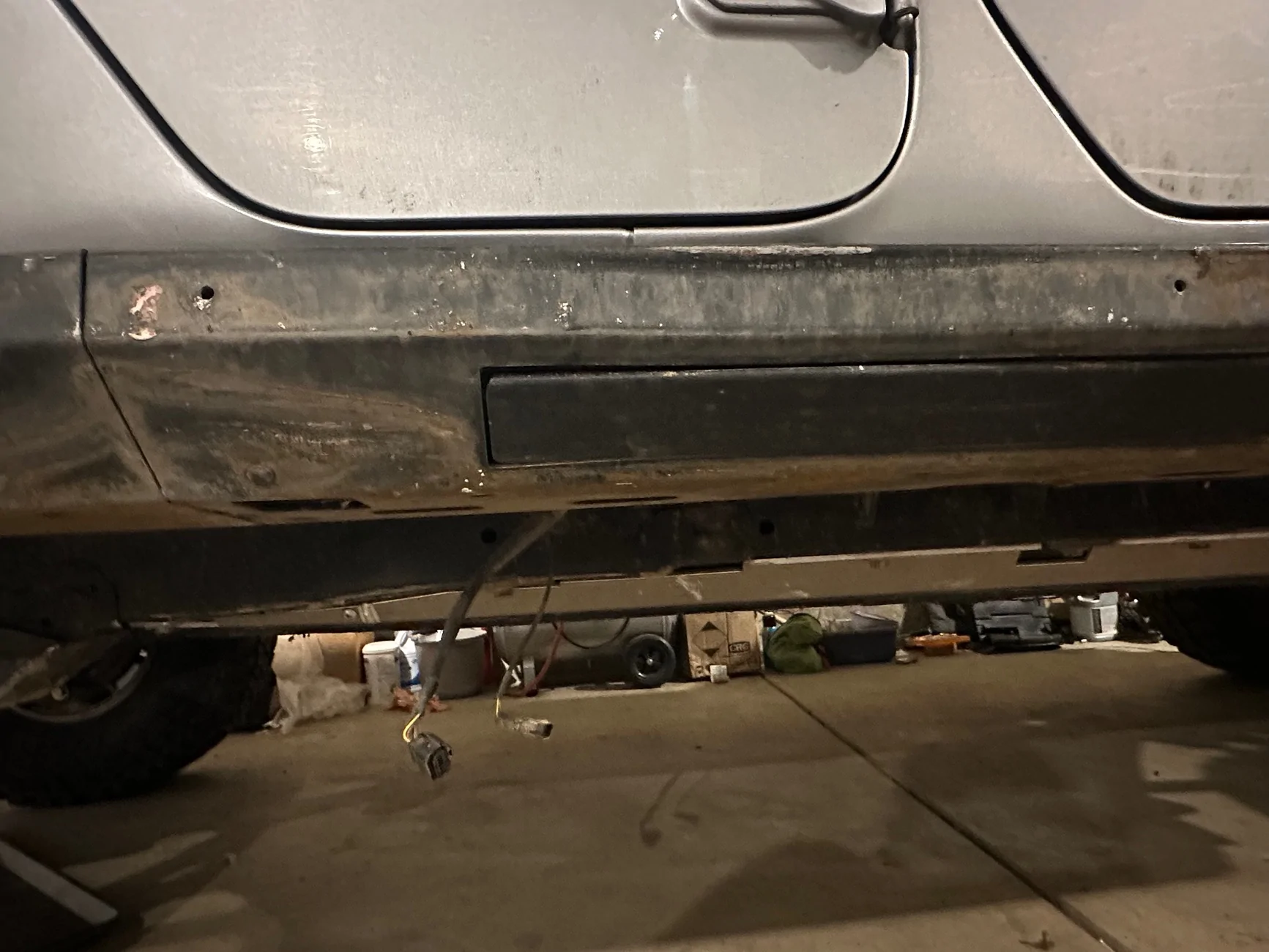

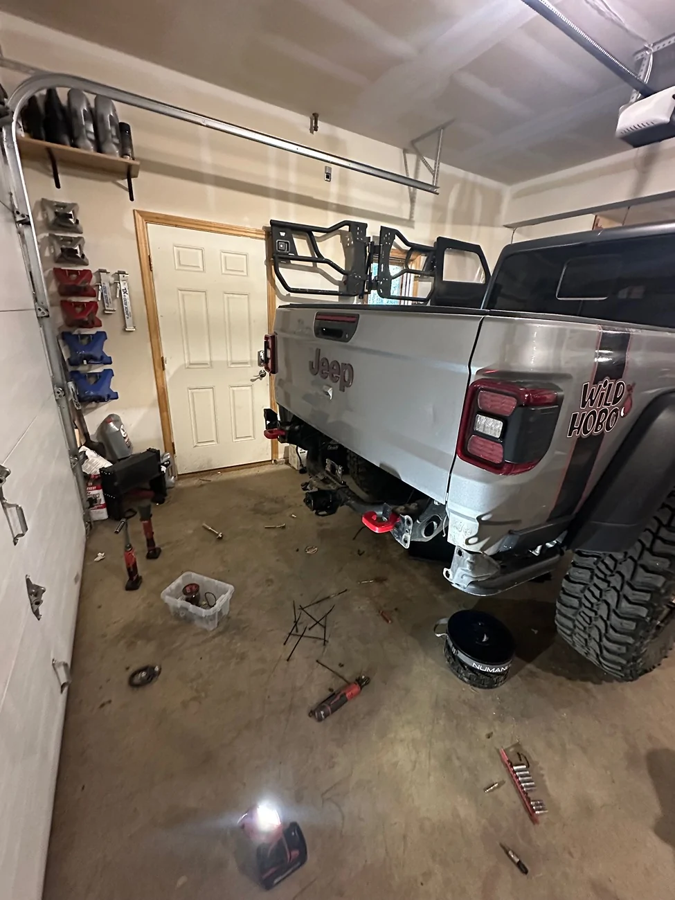

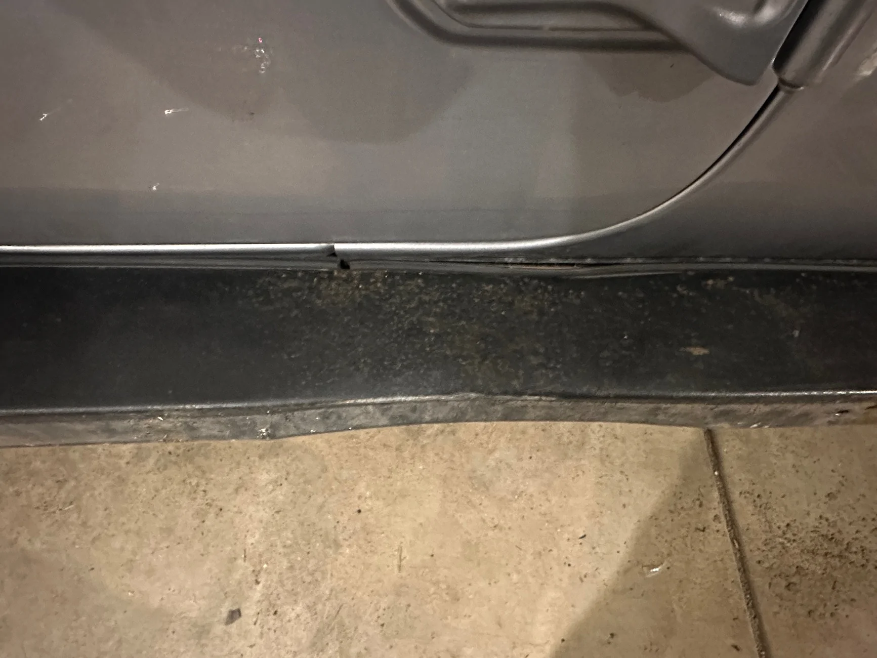

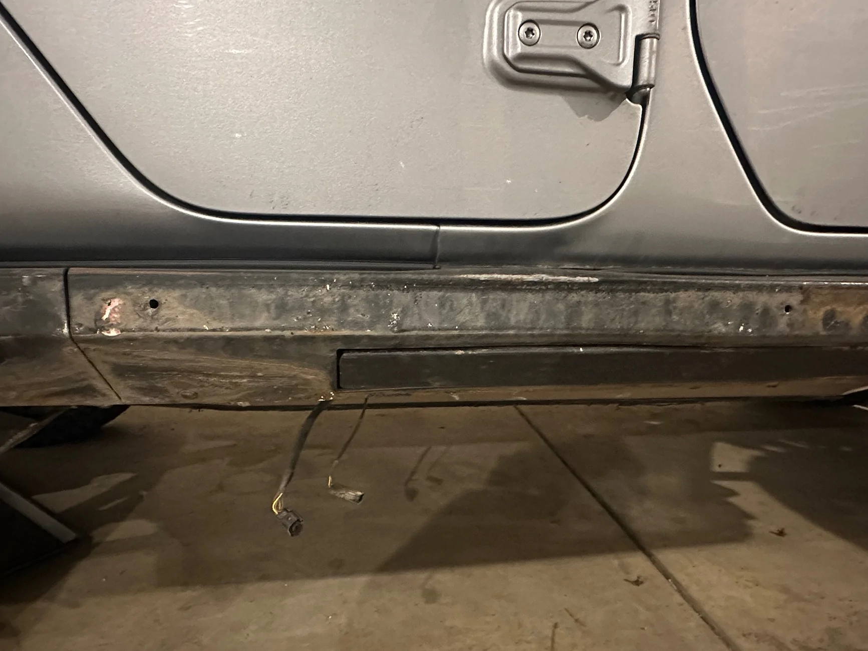

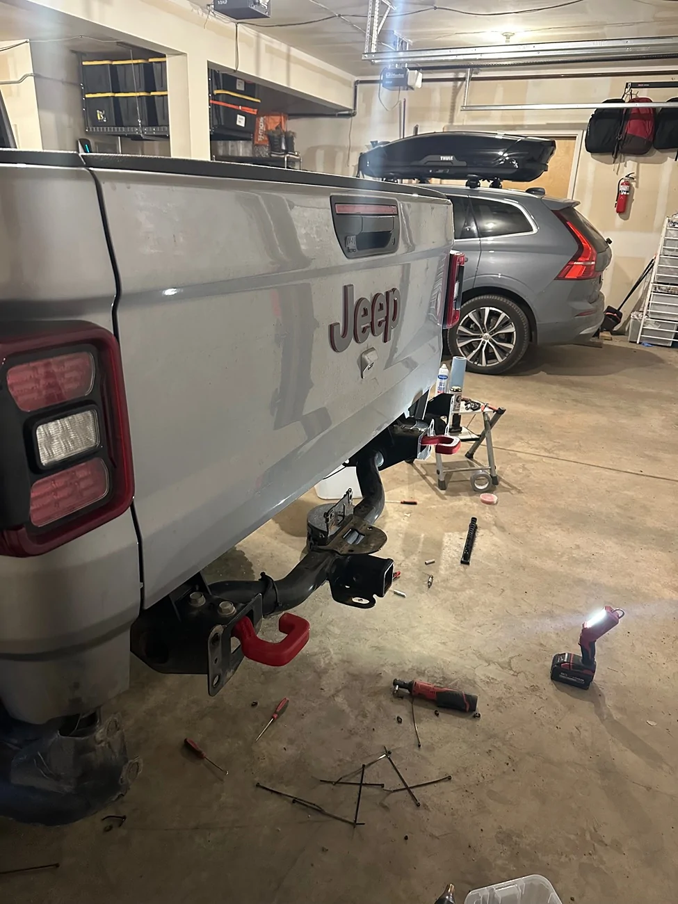

Getting closer. Got everything off and out of the bed that will interfere with the body shop taking it off. And got the damaged passenger rock slide step off. Pretty ugly stuff underneath.

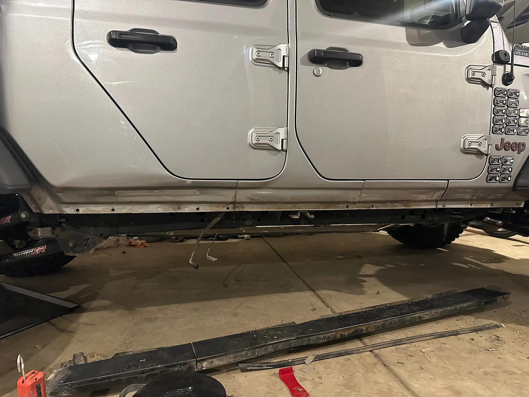

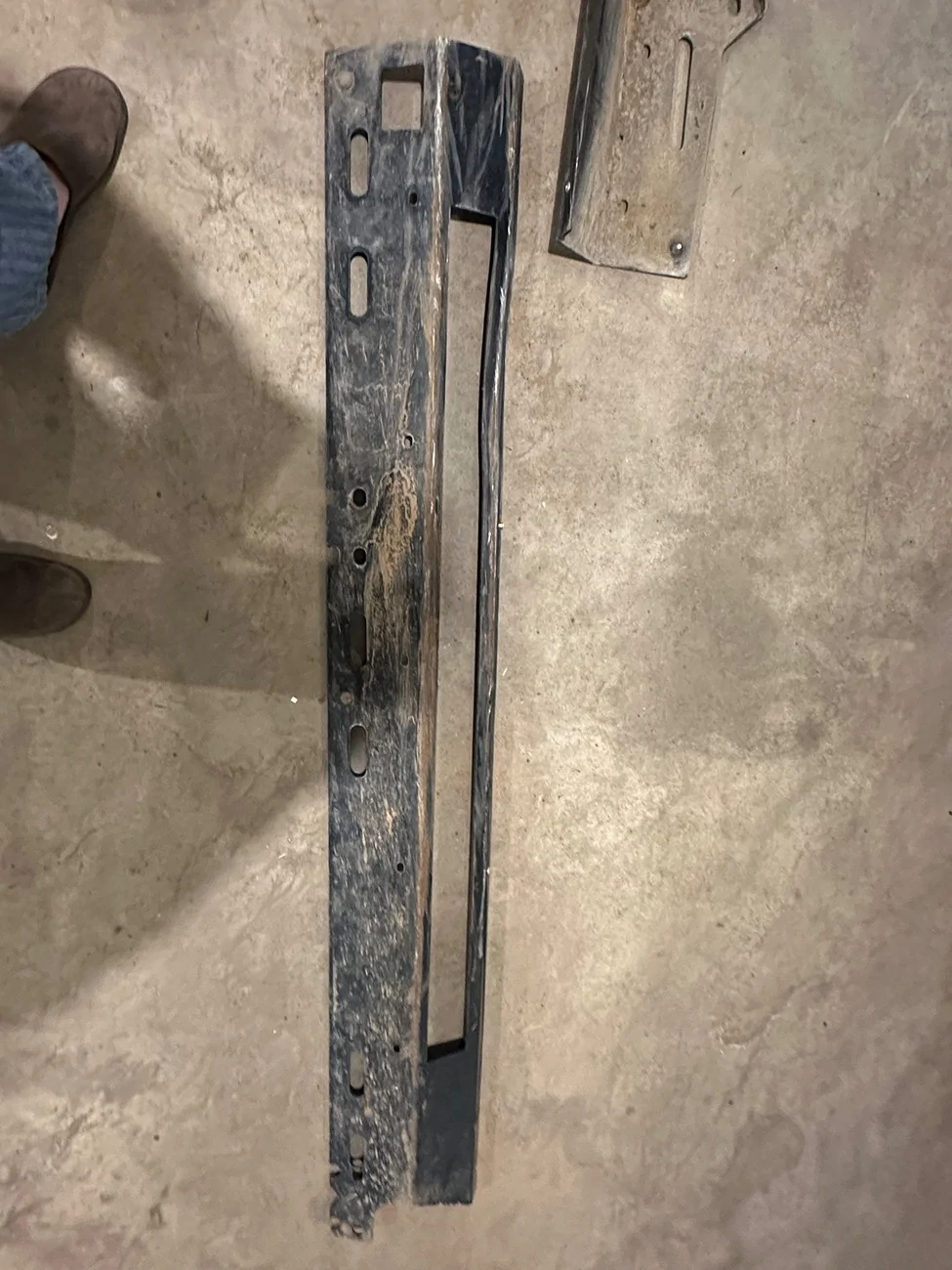

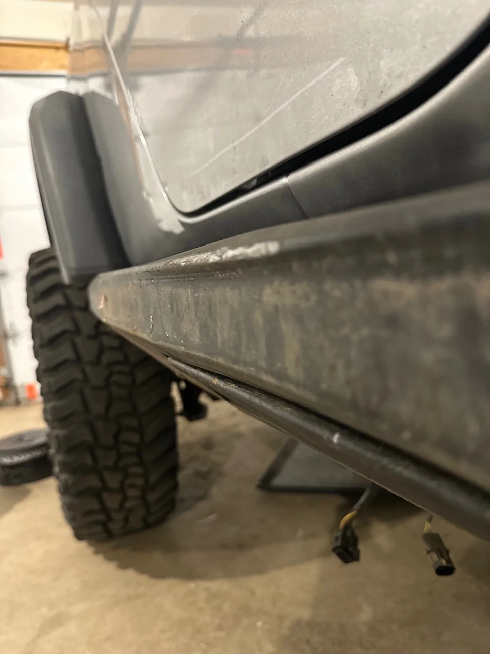

Got the driver side rock slide step off. Took just under 3 hours. Had to cut a couple bolts, and broke one wrenching. Still more clean up and wiring to remove before it goes in tomorrow. At least now that I can see the damage clearly, I can see that it should be fixable for a good shop. Helps to have any kind of forward progress after a month of seeing it busted up.
