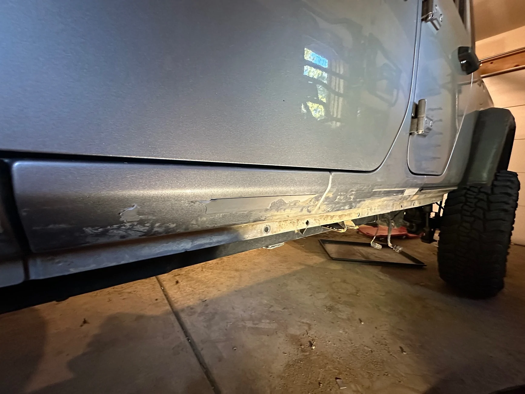

The driver side rocker is fine, so I don’t want to jack up the clear coat.
I’ve used these many times. 3m adhesive remover wheel. Works great for decal removal and double sided foam tape you have. Won’t hurt your clear coat, just don’t hold it on a single spot for an extended period.

I actually have that same one I think. It’s definitely 3m. I used it for some of it. Ran out of time and didn’t get every single bit, but enough that the body shop doesn’t need to charge me hours of labor for that cleanup. Took it out and sprayed/sponged off the dirt on the rockers and pinch welds. It’s going to need some serious tlc. You can really see the weird ways it curled in and bulged out on the passenger side. Driver side pic is for comparison.

Just checked. Yes. That’s the one I have. I’d never used it before, so I was pretty over cautious. Thanks very much for the validation. Makes me feel way better about having used it.

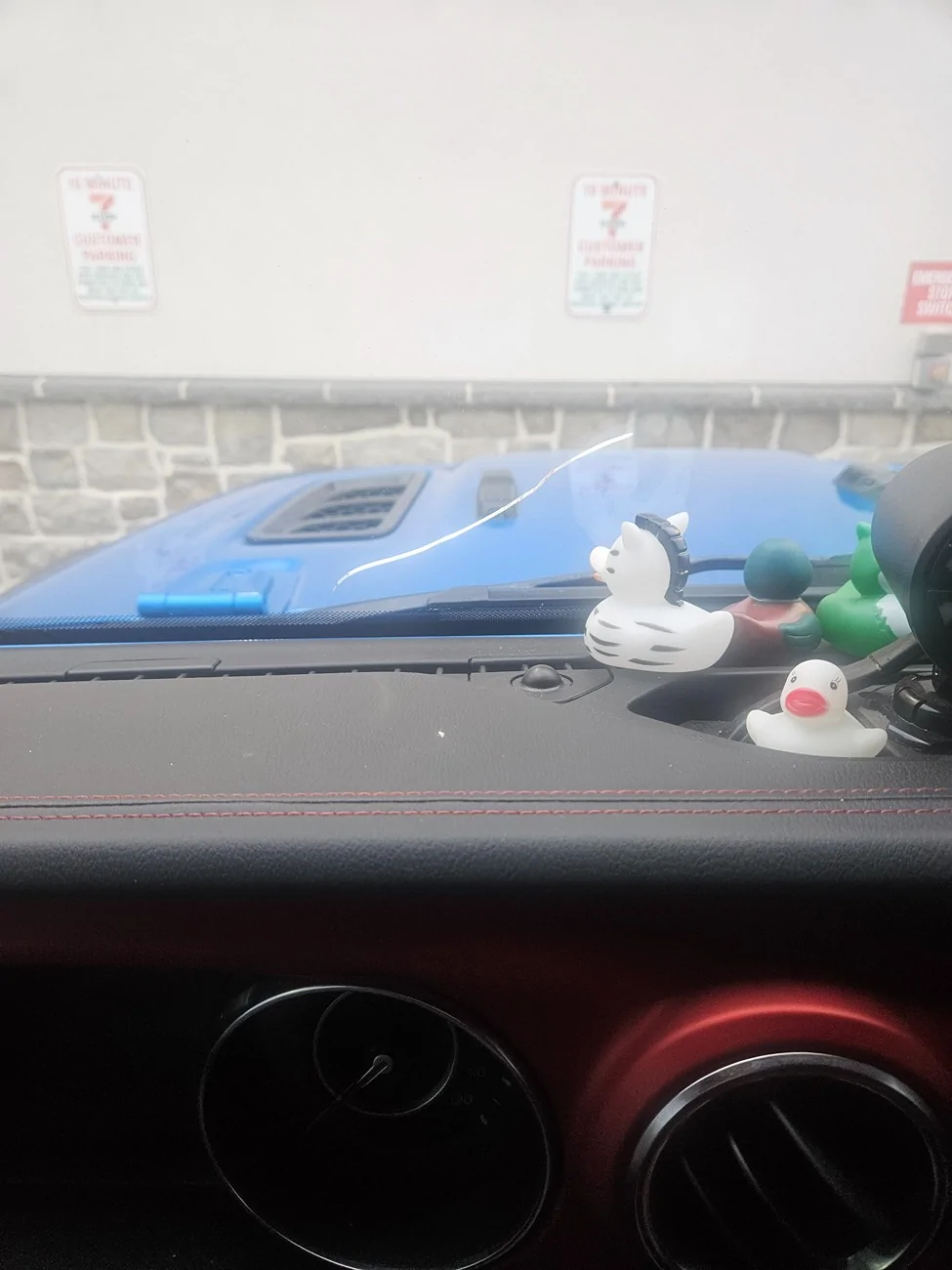

Cracked the windshield. And it's growing. No stone chips or anything else along the crack.
Hit both ends of the crack with a small triangle file, inside and outside of the windshield, angle both of your small file scratches towards the bottom of the windshield, it should run both ends to the bottom rubber seal. Not too deep on the scratches. This will keep it out of your vision path until you can do the repair.

Citrus based degreasers work well for getting that adhesive off and it shouldn't hurt the paint. Or the stuff I've used never has.
Those 3m wheels work well, just be really careful you don't spend too much time in one spot. It will burn the clear coat. It's not that likely, just know it can be done.

Goo Gone is citrus based, and I tried it. Not very effective. Heat works best, but it’s slow going. The wheel worked in a few spots, but I’m tired. No body shop expects this much prep receiving a broke ass truck. So good nuff. No rear bumper, no bed sliders, no spare, all accessory wires removed from the bed (it needs to be removed) and rockers cleaned up pretty well. I need to remember to throw the rear plate in so I don’t get a ticket driving it to the shop in the morning.
