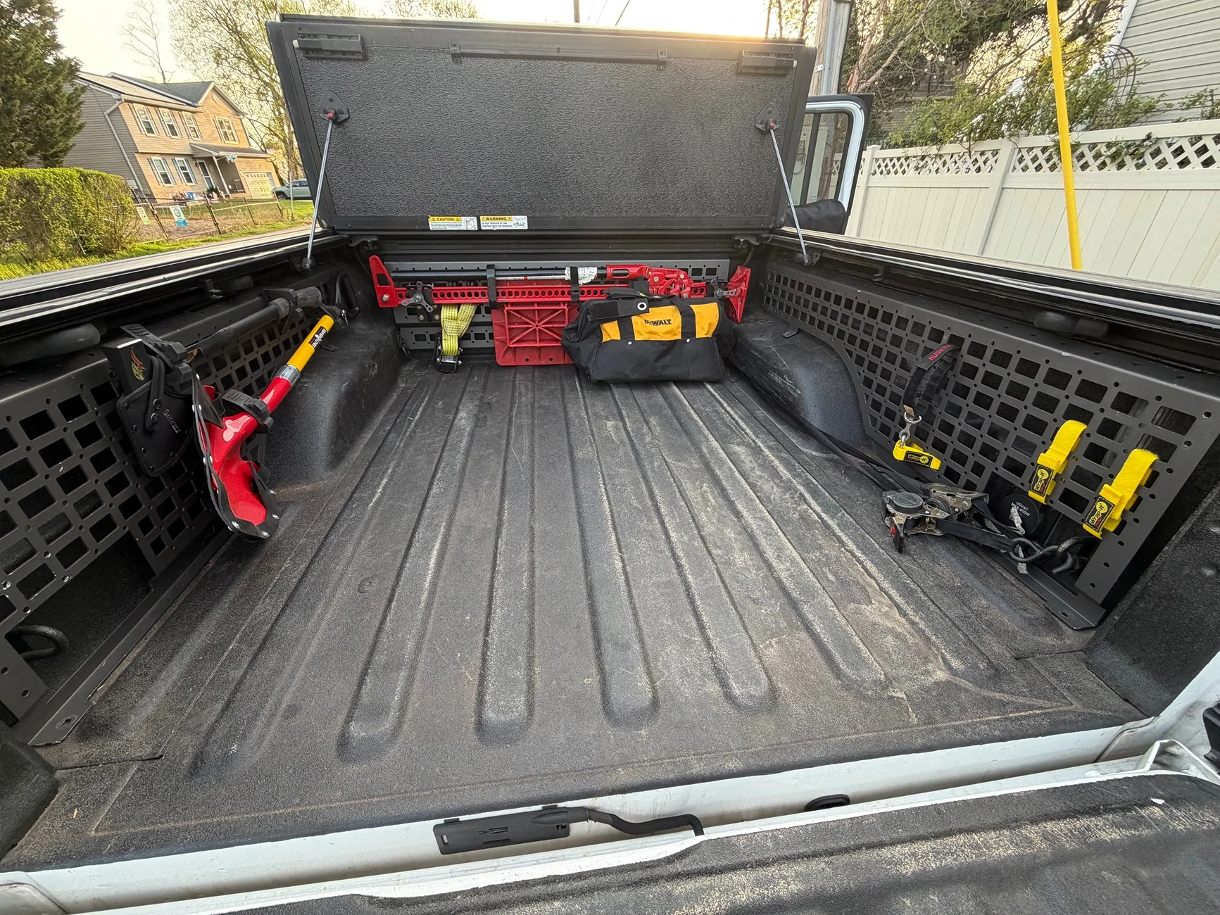

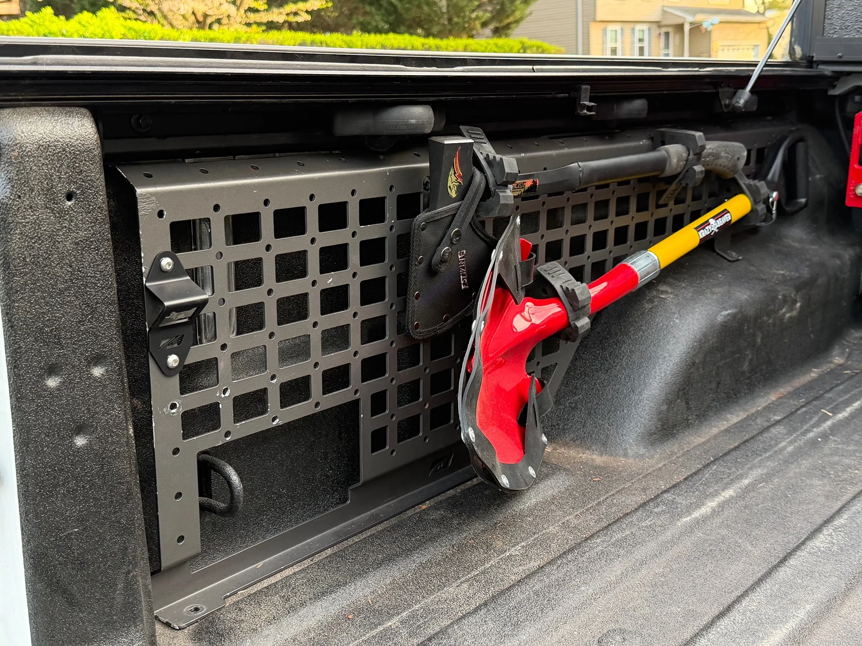

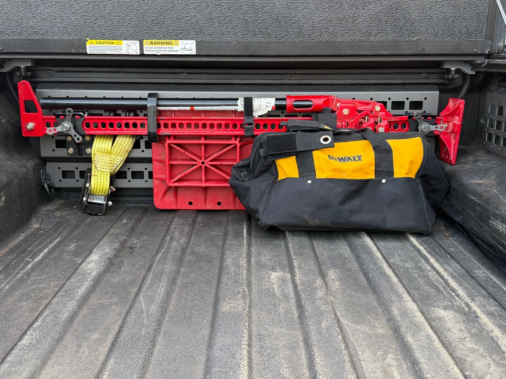

I scored some Motobilt molle panels locally off FB Marketplace this morning with their Hi Lift mount and two Rotopax holders and threw them on.
I had the jack and axe on the driver's side (for easy access) and wanted to do the same with the panel but a lot of trial and error with Motobilt's jack mounts (seriously over engineered) proved to be my undoing. I threw it on the cab side panel for now since that's the most secure and Future Steve will bolt the sides to the bed this coming week and maybe try and slide the jack over to the passenger side. The Dewalt bag has my recovery rope, fire hose tree saver, kinetic, hitch shackle and jumper cables. Other recovery gear is in the bins under the back seats.
(I now have 2 Motobilt Rotopax holders and a set of Hi Lift trail rail mounts for sale if anyone's interested. )

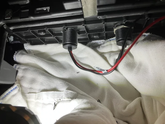

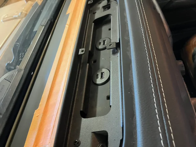

Finished adding a second set of USB ports to the top of the dash.
Jeep Gladiator What did you do TO your Gladiator today? [ADMIN WARNING: NO POLITICS, NO GUN TALK] IMG_2851

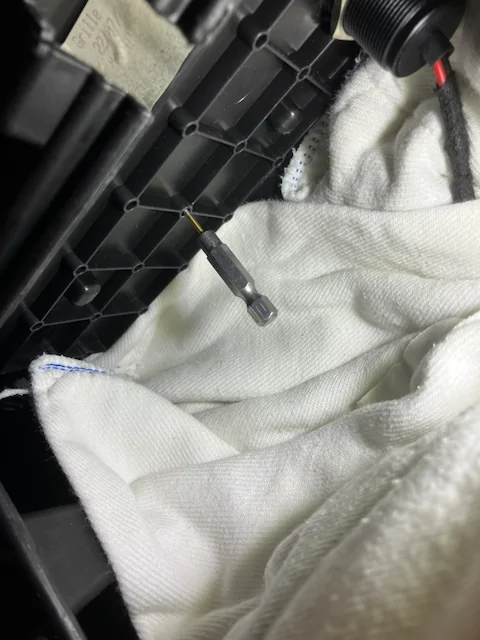

Put the first set in last year and used the two ports for a Gopro and an iPad mini that runs OnX Offroad. After the last offroad trip we did, decided that it would be nice to have our phones more easily accesible (previously they would ride in the center console to charge). To make sure the hole for the charger is centered, I took a very small drill bit and drilled up from below just using my fingers. Only takes a couple of twists to punch through.
Jeep Gladiator What did you do TO your Gladiator today? [ADMIN WARNING: NO POLITICS, NO GUN TALK] IMG_2848

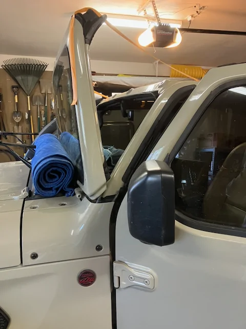

Then got as large of a bit as will fit in that hole in the webbing and repeat. Ended up with a good pilot hole. Tipping the windshield forward then let me drill down from above using a step bit to enlarge the hole enough for the USB charger to fit.
Jeep Gladiator What did you do TO your Gladiator today? [ADMIN WARNING: NO POLITICS, NO GUN TALK] IMG_2846
Jeep Gladiator What did you do TO your Gladiator today? [ADMIN WARNING: NO POLITICS, NO GUN TALK] IMG_2849
The gap between the two USB chargers has enough room for all of the cables that connect to the back of the Uconnect display to fold up in there. This is on my 22 JTR, don't think the MY24+ dash is anything like this. Finally a handful of temporary zip ties to control the excess USB cable before reinstalling the top plate of the rubigrid.
Jeep Gladiator What did you do TO your Gladiator today? [ADMIN WARNING: NO POLITICS, NO GUN TALK] IMG_2852

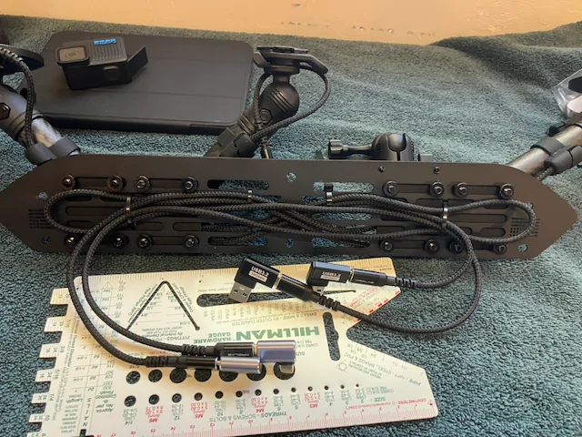

Went with the Quad Lock magnetic wireless charging mounts for both phones. Thing I like about them a lot already is that you can have the phone in either orientation, portrait or landscape.

Looking at this, it's a '24 model or newer? That's been a miss with Jeep since the current body style came out in '18. I've looked at the idea of doing that, as it's just USB connections behind the center console. Looks sharp.
