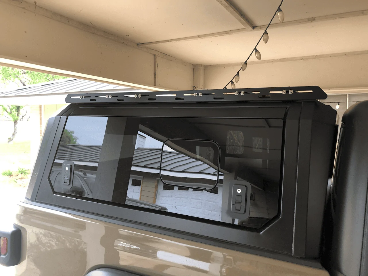

Built a top rack for my RSI cap. Crossbars are 1x2 extruded aluminum and side bars are 1/4" x 2" aluminum bar. I cut the slots on my router table with a 1/4" spiral upcut bit in small depth increments until the holes were through.
I like this topper
Can you put the details up

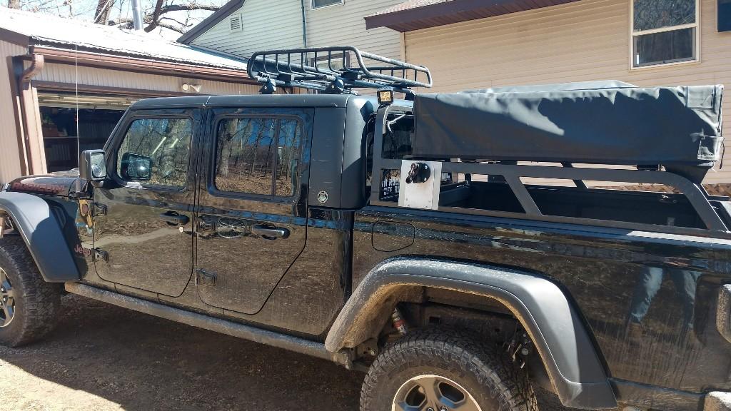

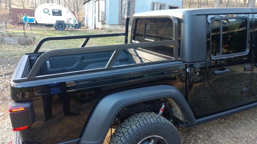

I made a bunch of stuff so far. CB antenna mount, phone and tablet mounts, (modified) rhino rack roof rails and a mount for my roof top tent.
Tent mount:
The bed rack is made from 16 gauge 1"×2" steel tubing and 1"×1" steel tubing. It mounts to the stock holes for a bedcover front and rear.
The aluminum thing's (as yet unpainted) are mounts for rotopax cans. The roof rack is made from Yakima crossbars and feet mounted to a modified set of Rhino rack fiberglass topper rails. Yes...the yakima stuff fits the rhino rails very well. I shortened the Yakima roof basket so it wouldn't hang over the front or rear of the top. I'm planning to hang lights on the front of the basket. (Money,money,money,repeat....)
This rack looks awesome

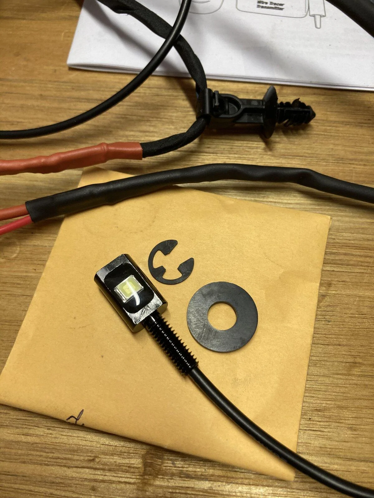

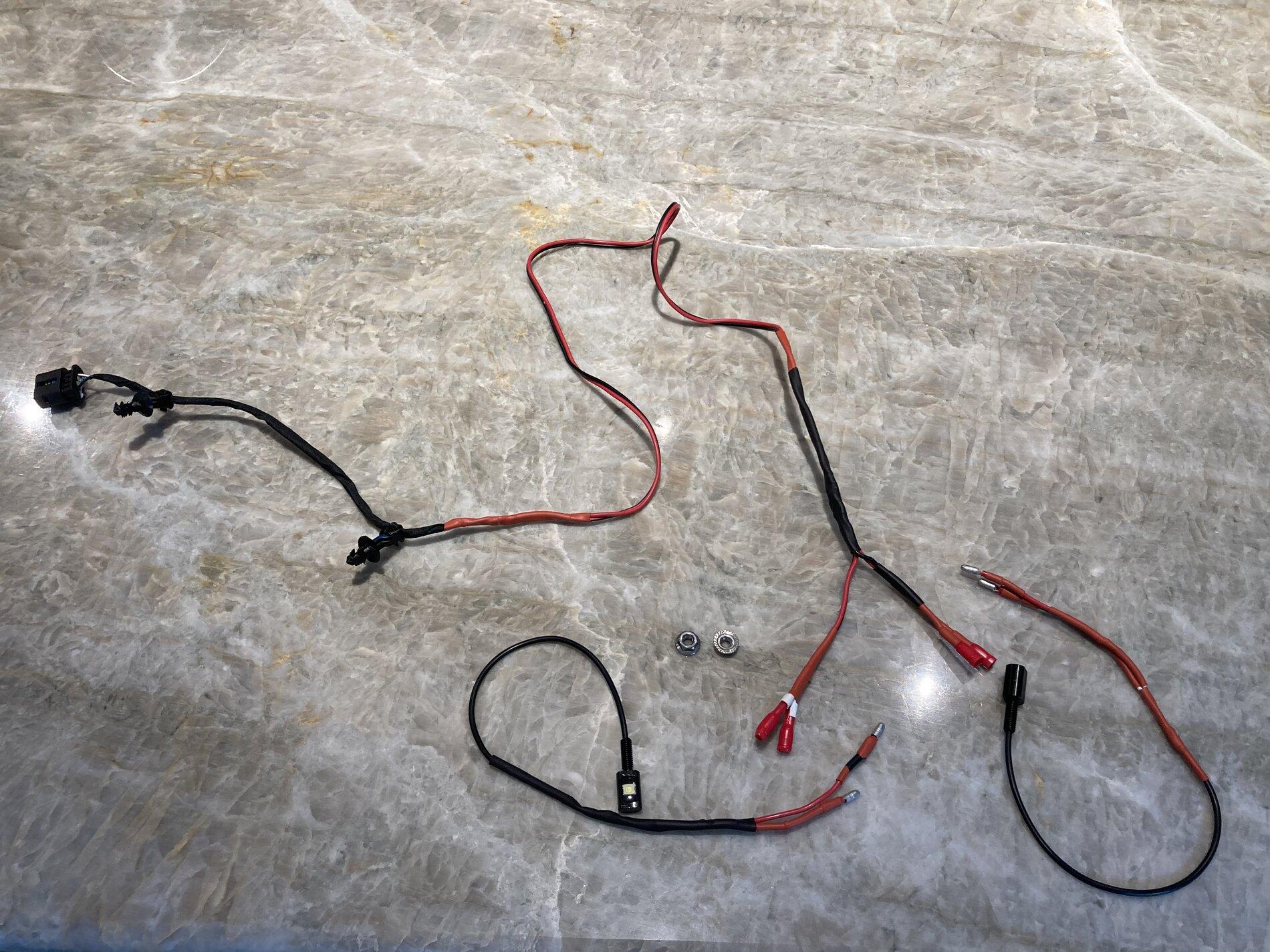

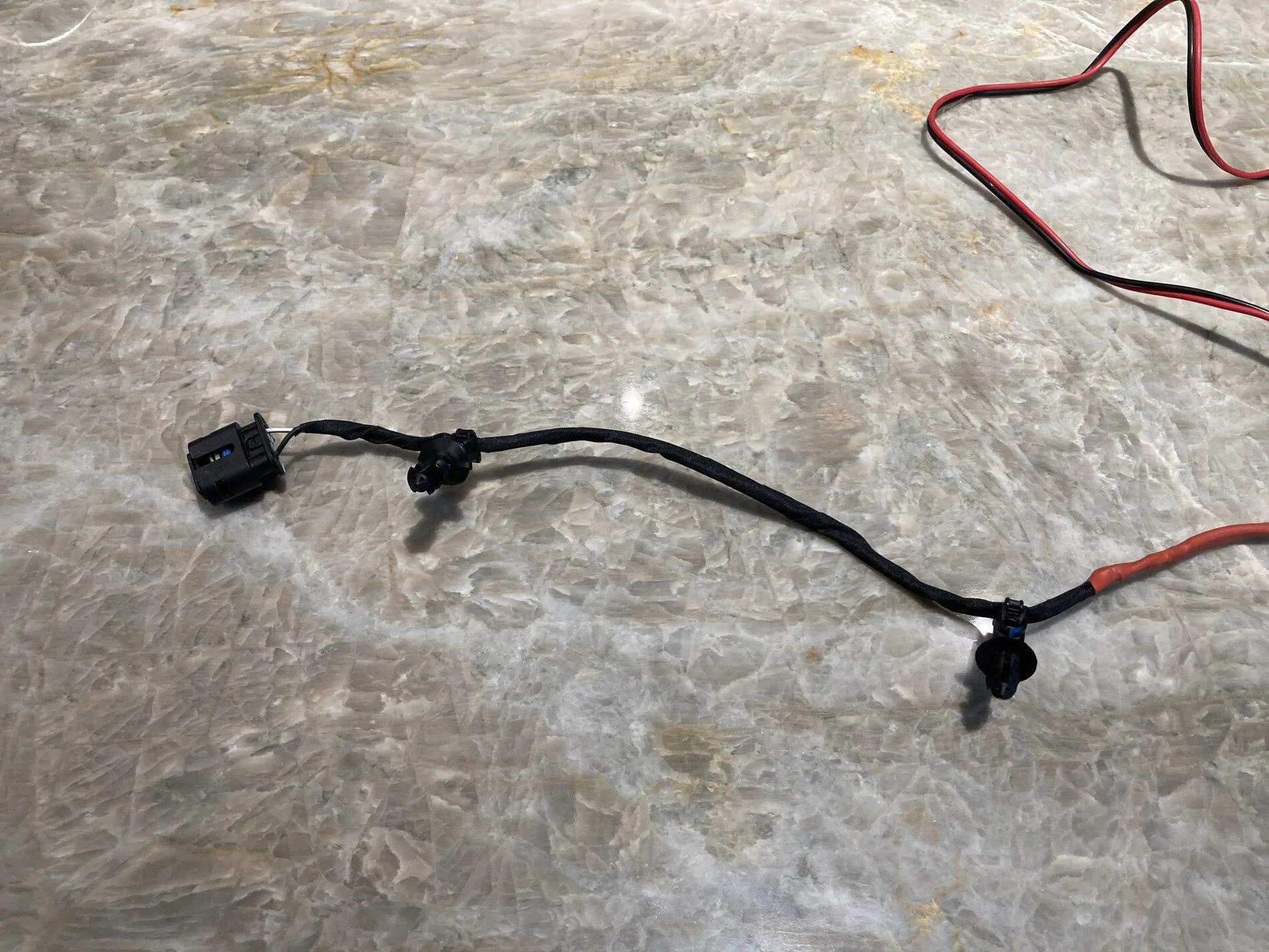

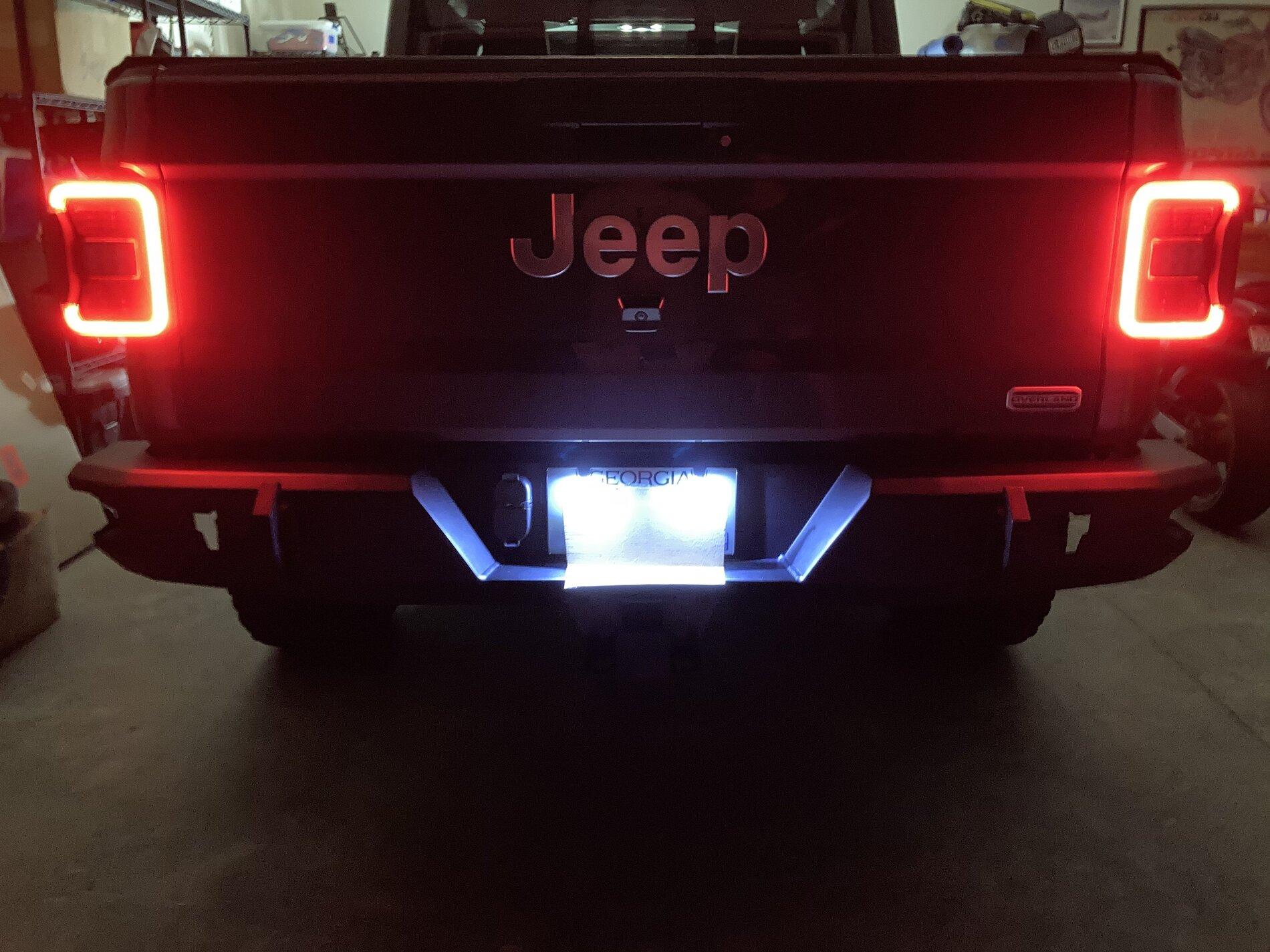

Made tag light harness to use the factory plug. Used bolt lights for the RR HD bumper.
Jeep Gladiator What have you MADE for your Gladiator? 6C3786C8-D616-4AA3-BC81-37CEB43649BD
Jeep Gladiator What have you MADE for your Gladiator? 14E930CC-E8AF-46A4-B34A-0FAC19D81968
Jeep Gladiator What have you MADE for your Gladiator? EBBEE9DC-2C54-492E-8061-98C43BCC0606
Jeep Gladiator What have you MADE for your Gladiator? 591E2A3C-00EF-4F9D-BA6D-255CB455D900

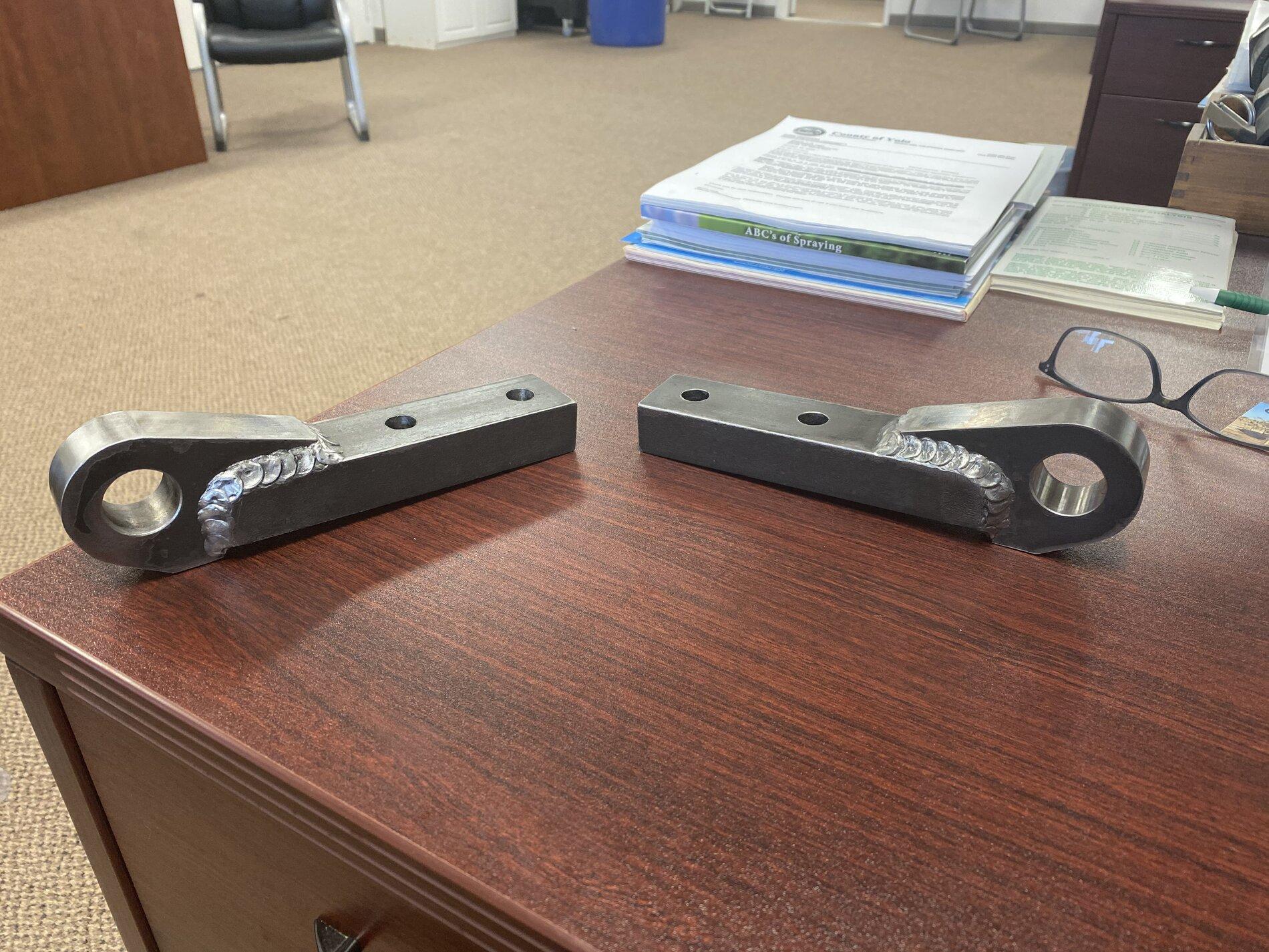

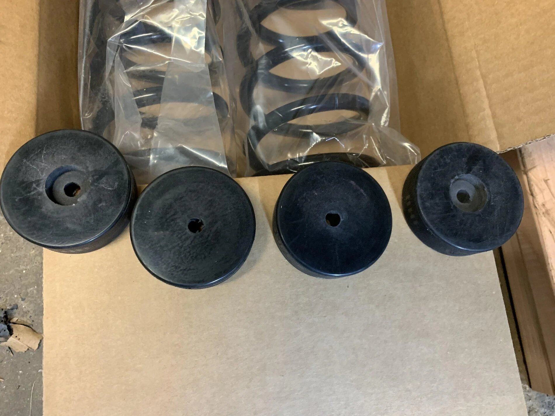

Front Bumpstops
Jeep Gladiator What have you MADE for your Gladiator? 65B7CB8E-2834-41D3-89EC-CB18628737C5
Yikes! That glass looks expensive if thieves want to break in for something in the bed.
