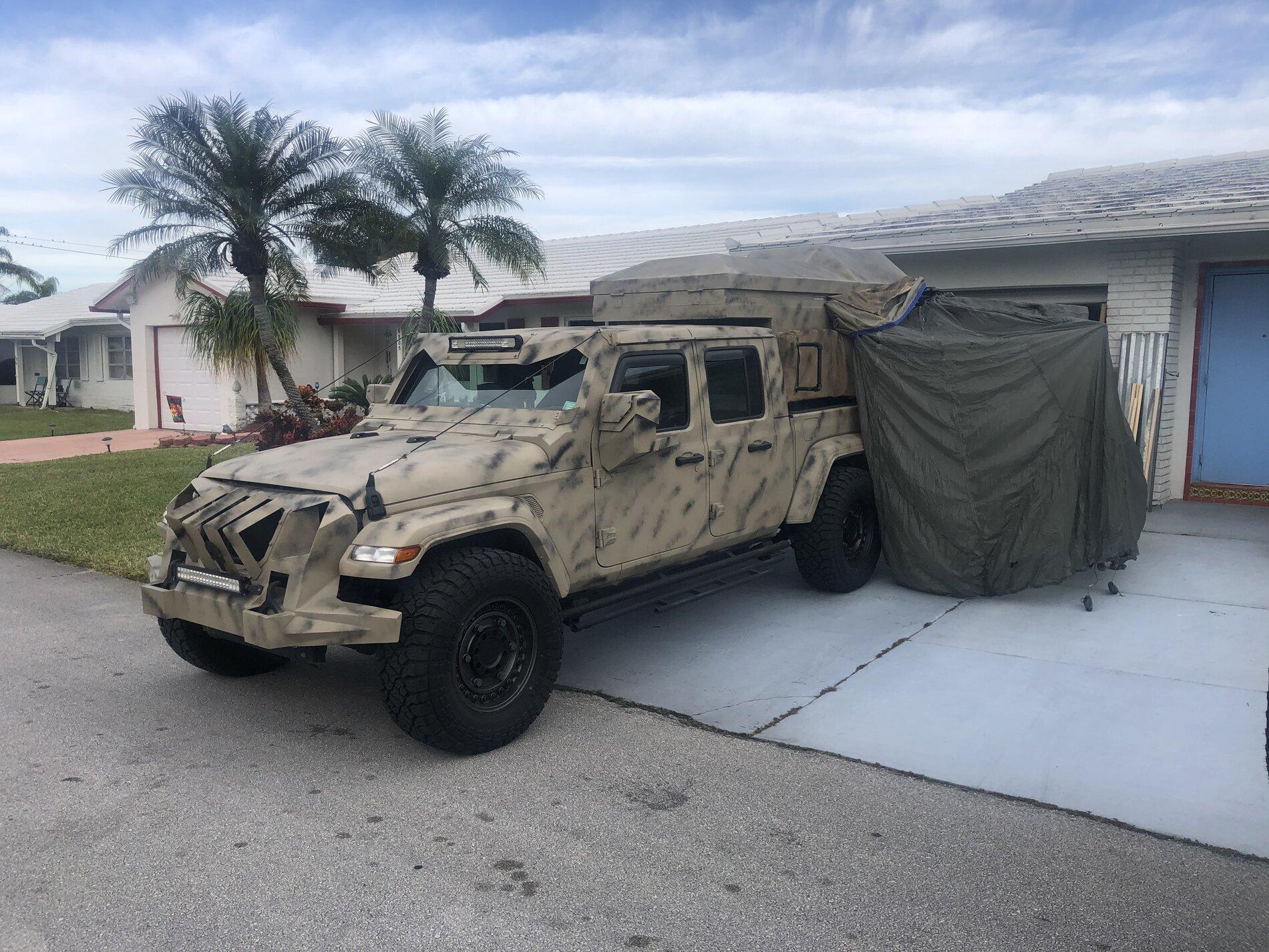

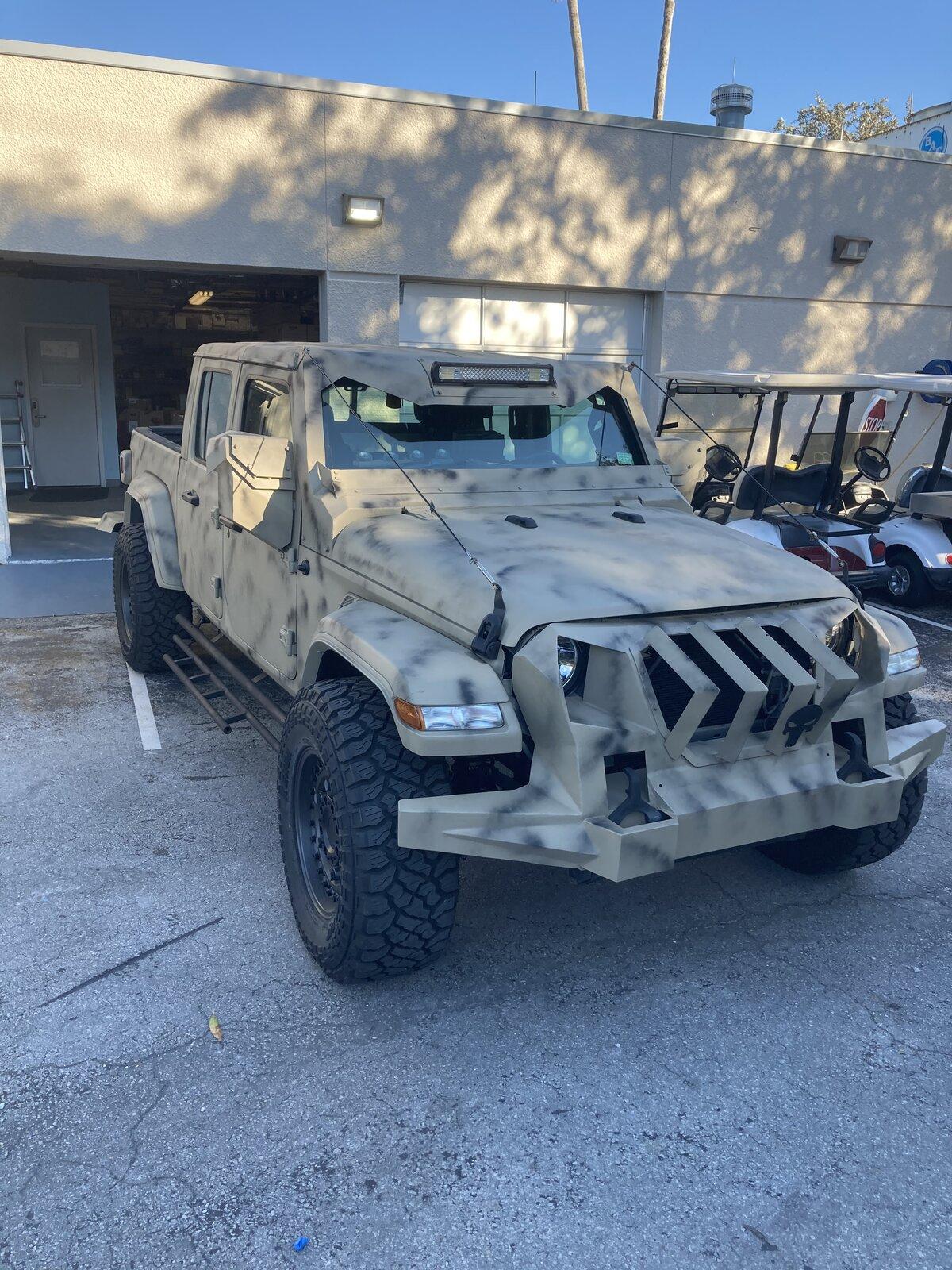

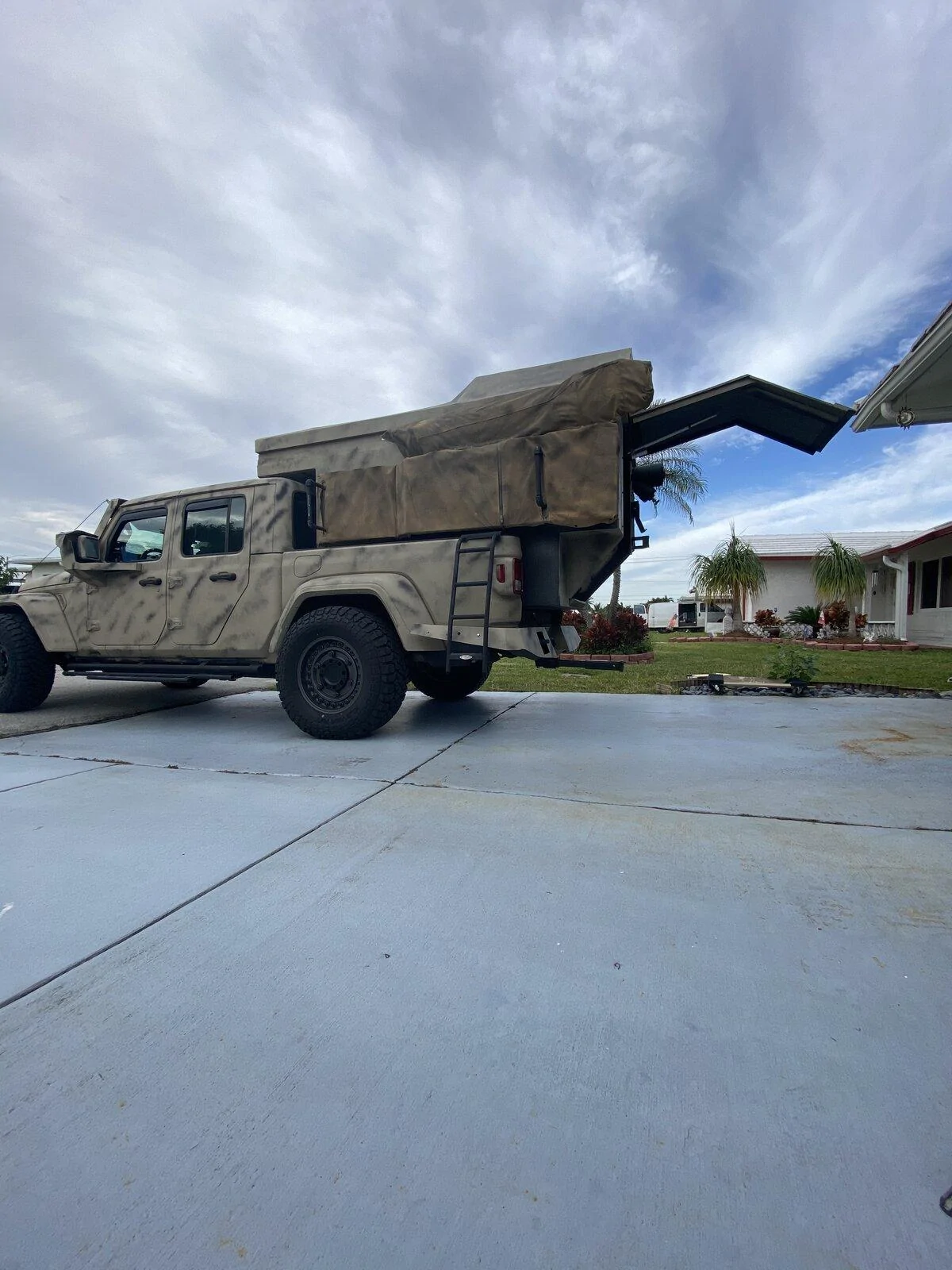

I have made a few things. Some easy some a little complicated
But all you see on my gladiator is all home made
I even did all the inside myself as well
Just wanted to make it my own style really.
If you look at the cost of the parts you can buy off the internet it just seemed like highway robbery.
So I made them myself.
The front a rear bumpers, the grill which is interchangeable
The screen cowl, the wing mirror guards.
I had a lot of fun doing it too.
If anyone saw the pics of the slide in I built that was all home made too. I have taken it off for now as it was a little too heavy for my comfort, so I have lowered it and changed the design a little.( Probably be finished in a couple of months as I had to stop due to knee surgery)
If anyone lives near me
South Florida I would be willing share how to do and even help construct the ideas they might have for their gladiator,
Look forward to seeing all the ideas people have done
Holy batrap there! Well done on the fab skills there.

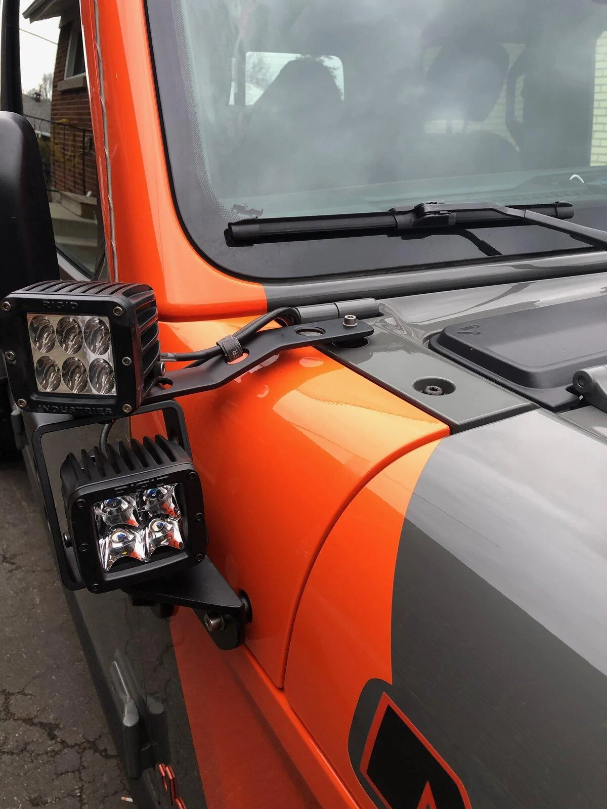

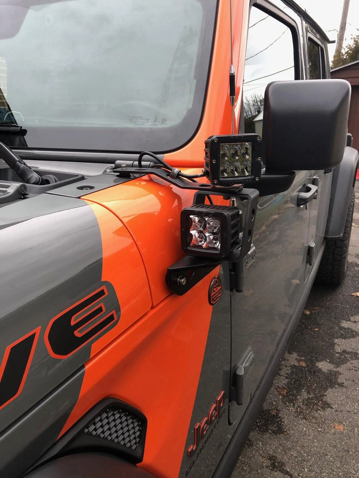

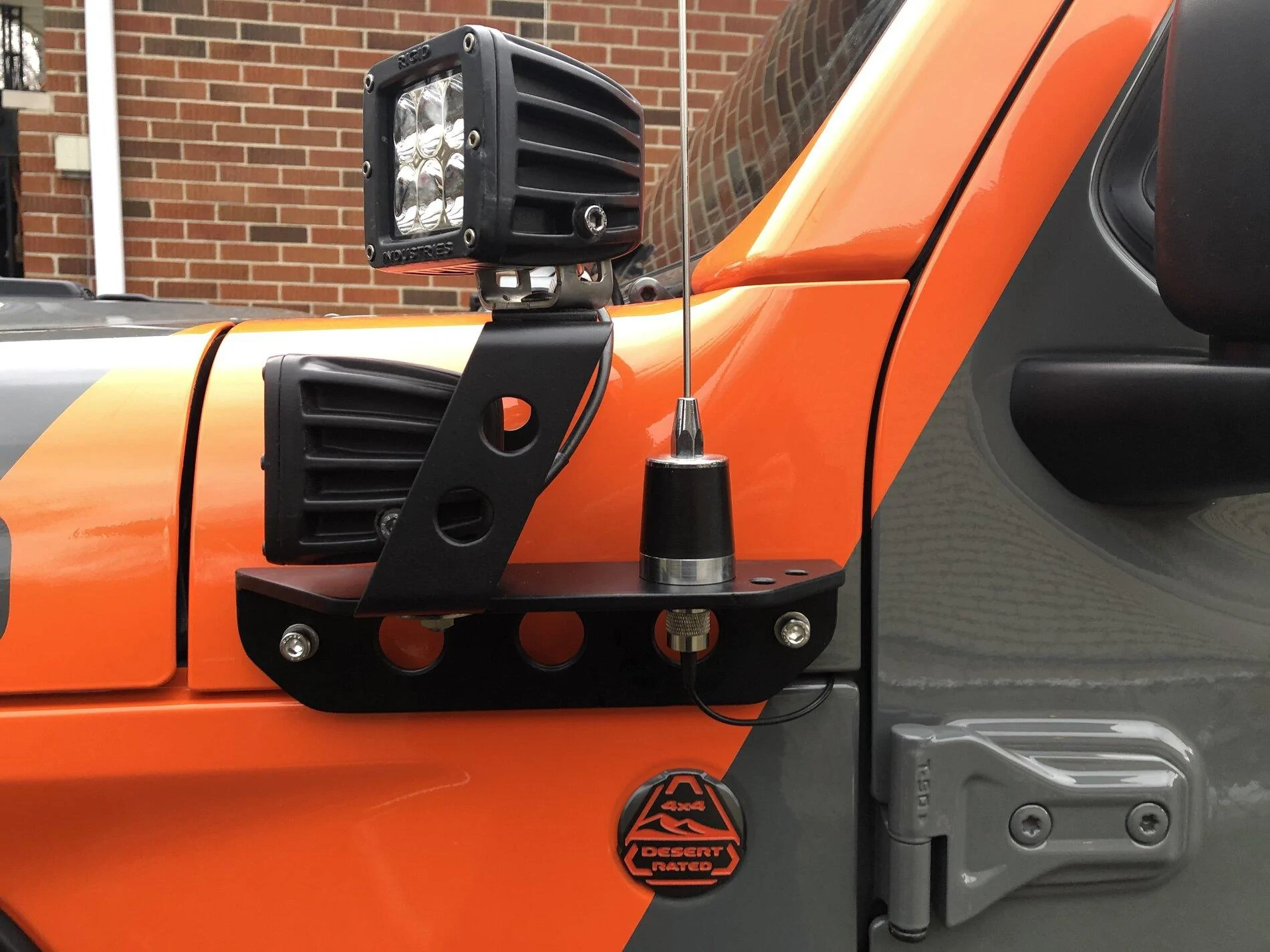

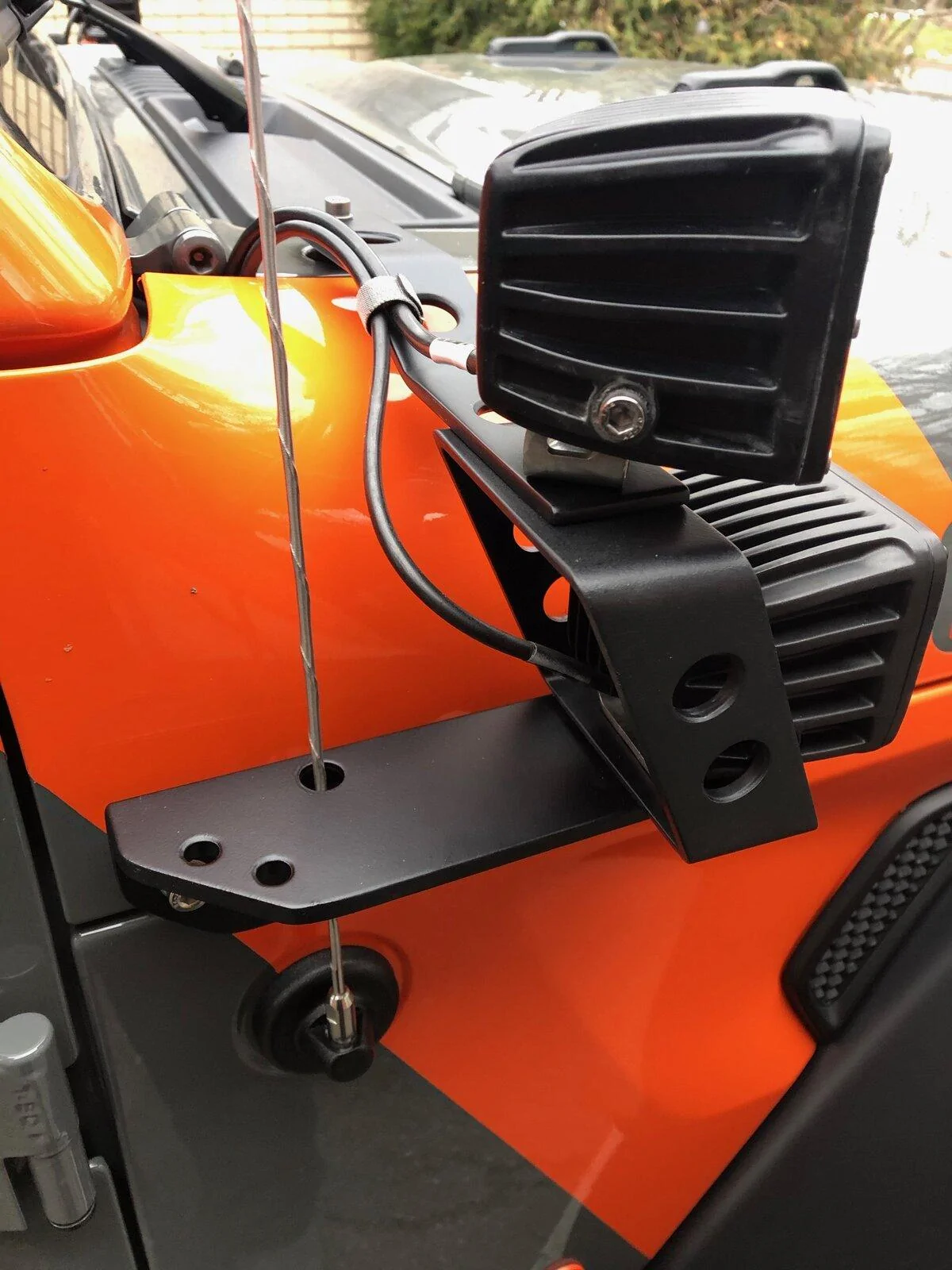

Made these light mounts that also incorporate antenna provisions. The main forward lamps are below the hood line so no scatter on the hood, and the lights are far enough outboard so as not to interfere with the windshield folding.

Awsome job. Well thought out.

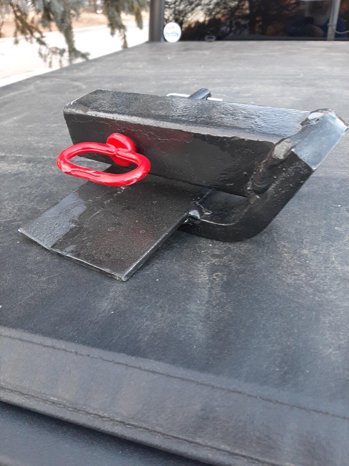

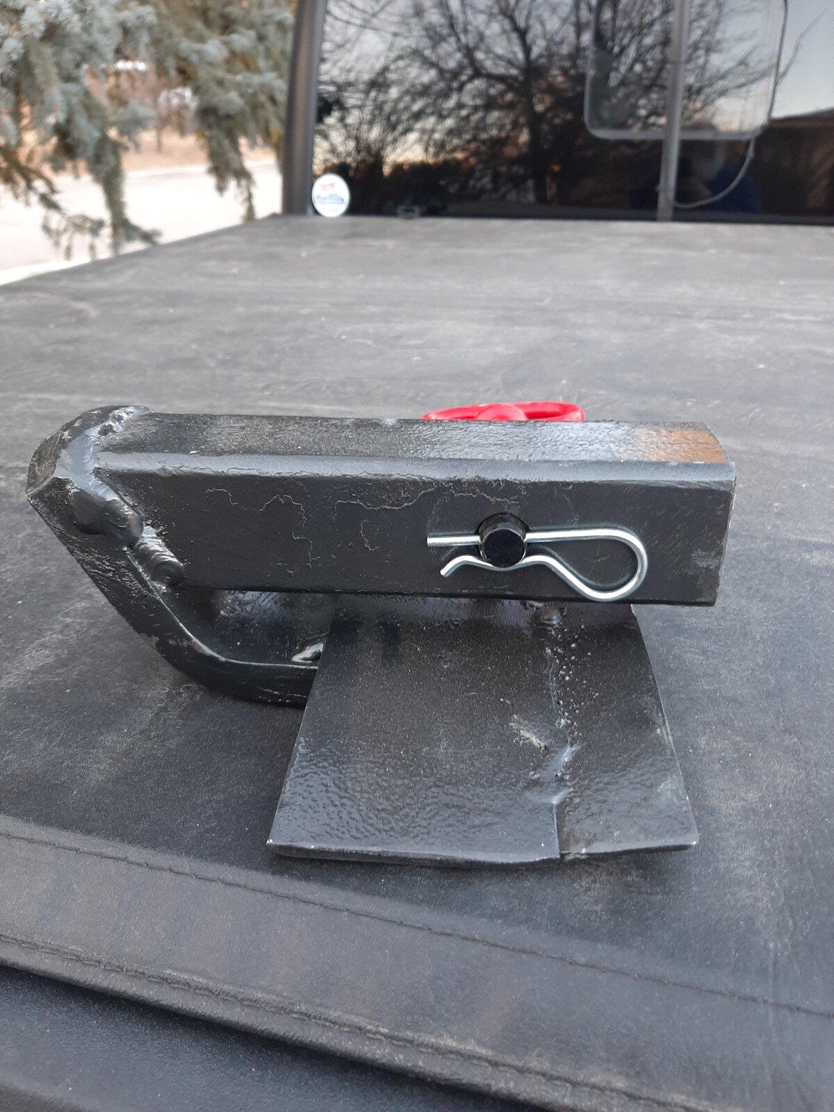

@trust how are the results of the hitch ramp? I've been thinking about making one also. I haven't hit it a LOT, but have here and there.

I'm ashamed to say that I havent tested it out yet. I got home from moab Utah last fall and had drug the hitch and lower rear frame control arm mounts quite badly so I ordered up some skids for the mounts and built the skid but haven't gone out since. I'm going back up 1 April and will report back after I try it out in The red dirt. Of course I also am up 2" too and likely won't do anything to challenging but ill find a ledge or 10 to try it on...

I hit all those parts as well, and put guards on some of the shock/control arm perches, have a couple more to install. I'm stock height except for a 3/4" leveling kit up front. Our closest playground is tight and not friendly to a long vehicle. It was great for my JK though.

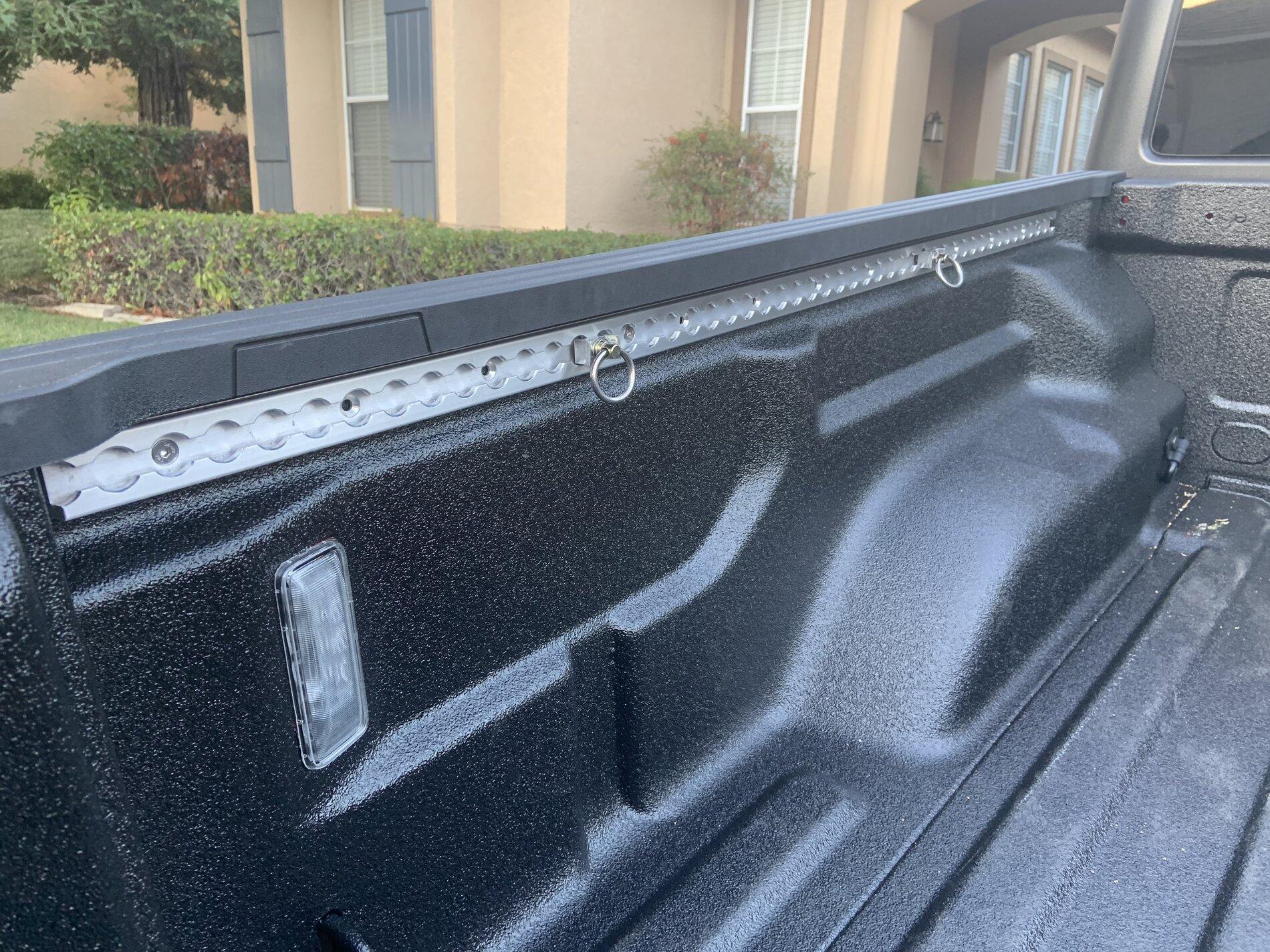

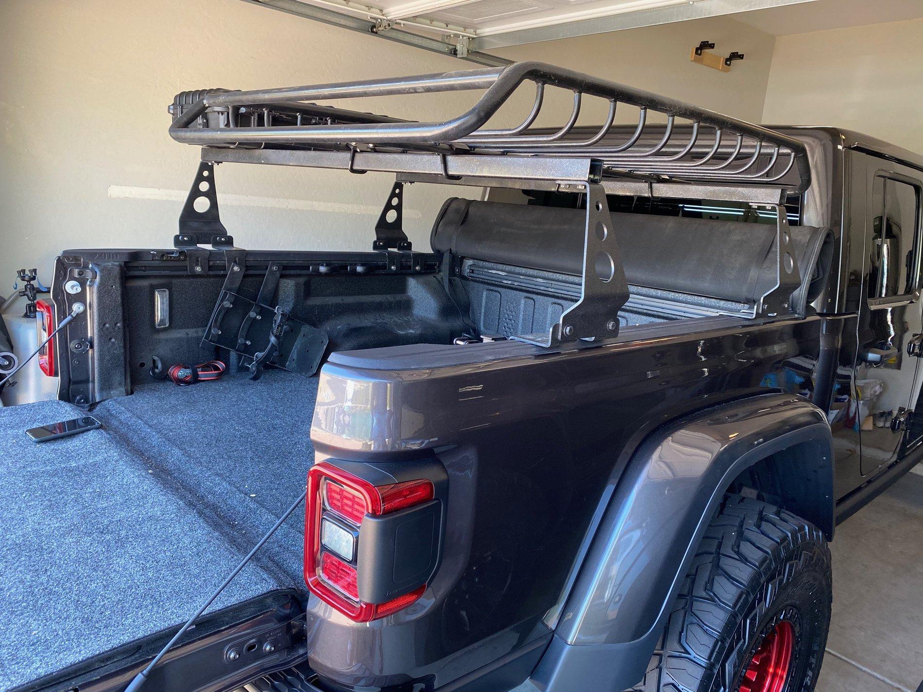

Did you have to drill holes in the L-Track for this?
Yes, I was only able to use one of the original holes, and had to turn another into countersunk slot because of overlap. Thankfully, I have a small benchtop mill which made short work of it. If I had to do it again, I would have started with undrilled L-Track. But that stuff is hard to source.
