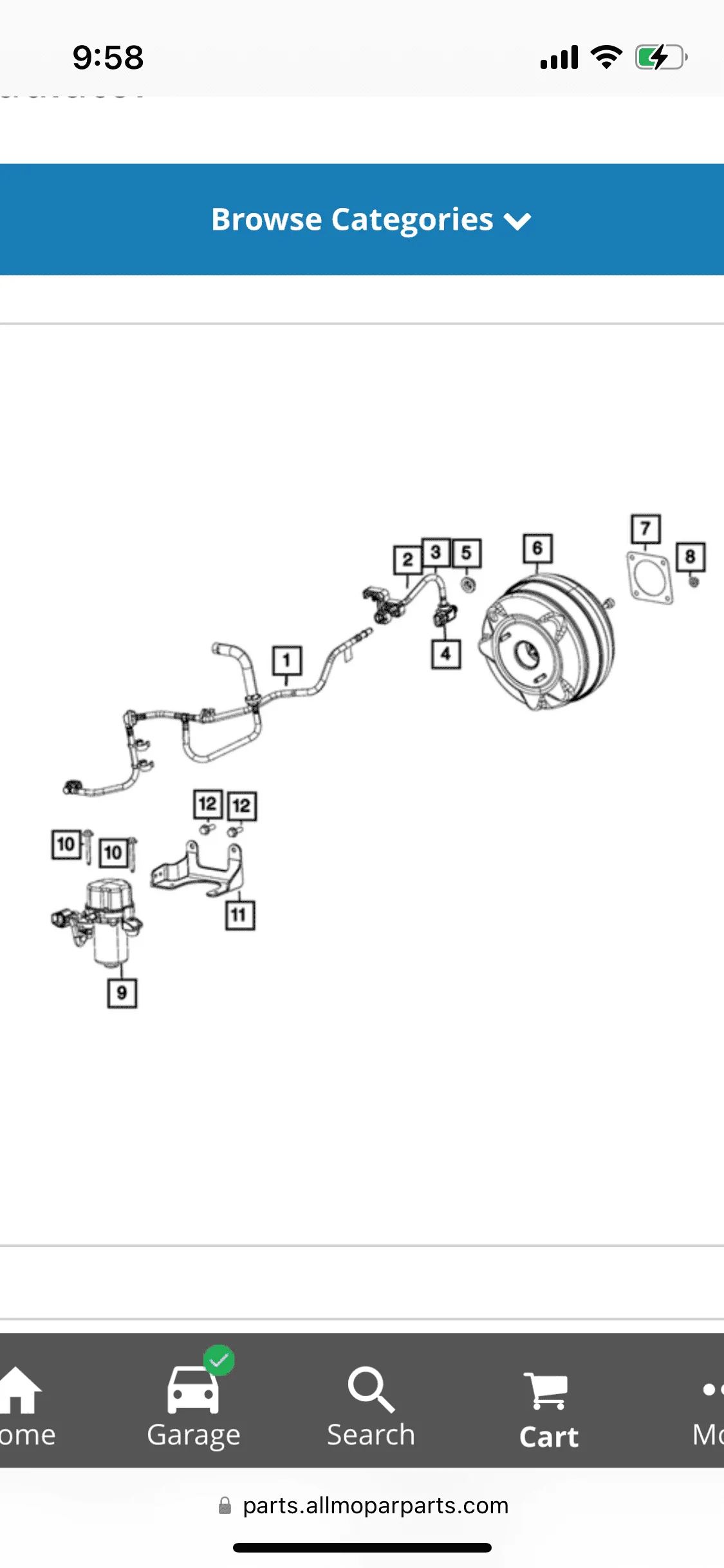

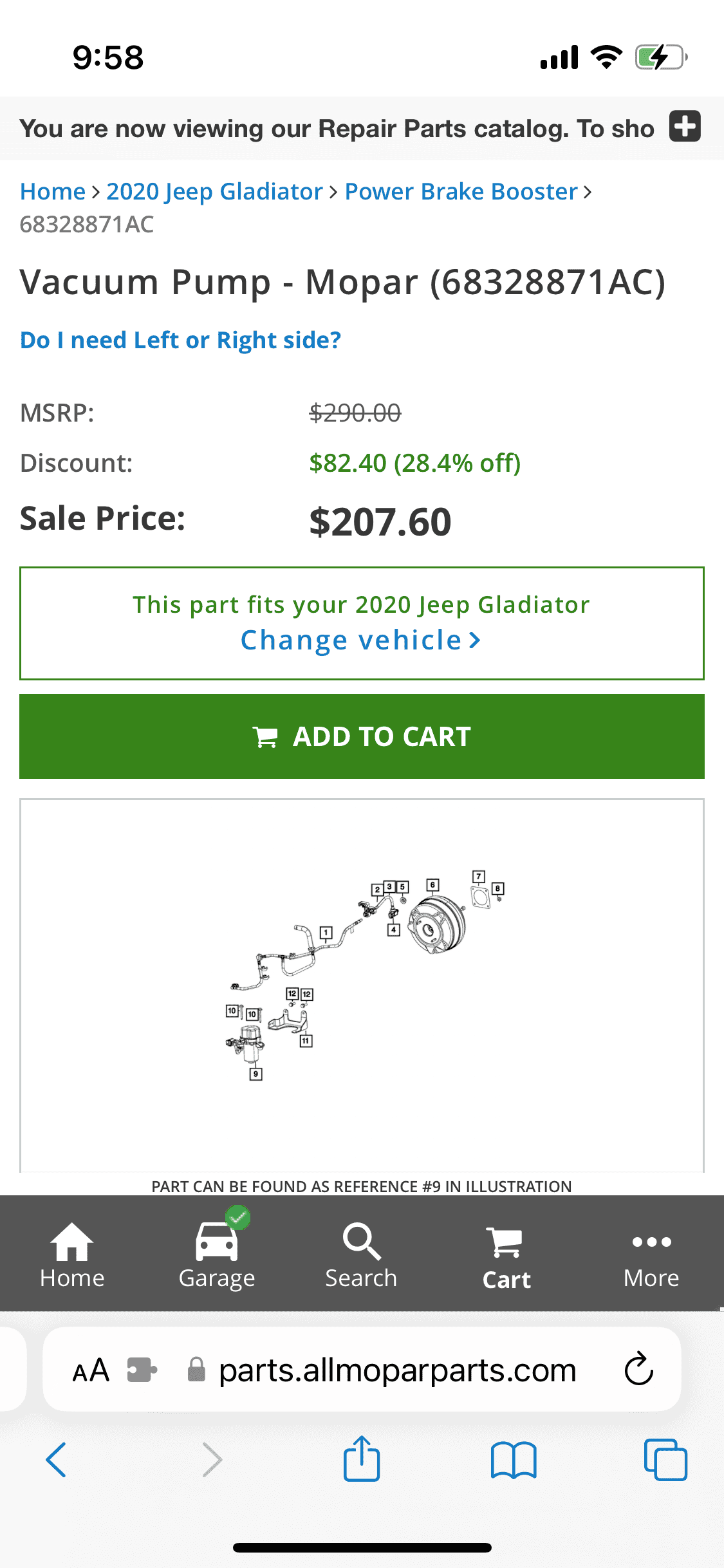

i MAY have solves it.
hmm. seems a poor location for a vacuum pump - I wonder if water can back feed into it if submerged and not on pumping are out of the vacuum booster. Also kinda interesting how they don't use engine vacuum anymore?? Since when? I must be getting old......
seven30
Tom
Apr 12, 2021
681
554
central texas/ south colorado
2021 JTM 6spd, 2001 Cherokee, 1992 Comanche
Programer
It's got a tee and check valve to the intake like the old days. I think the pump is to ensure vacuum is maintained during the stop part of the start/stop although I try to remember to disable it.
I wonder what other doodads these have. There is an electic power steering pump somewhere.
40,497
54,011
Vacuum pumps have been used for years....... you need brake boost in case of engine failure, in ESS events, or when the engine is under load and in low-lift valve mode. Engines aren't the vacuum pumps they used to be. Even guys who have rad cams in their cars (more rad than the one I run in my 73) use vacuum pumps for brakes or even to evacuate the crankcase since PCV systems don't work on such engines.
It's interesting that no one has really wondered how the power brakes work on these under so many conditions.

I was thinking it was electro-hydraulic until I noticed the vacuum diaphram. I had an 80s Alfa that was electro-hydraulic. No vacuum. I think some Buicks had the same setup.
ecidiego
Nov 3, 2021
62
3,625
5,582
San Diego
2021 Gladiator Mojave
IT

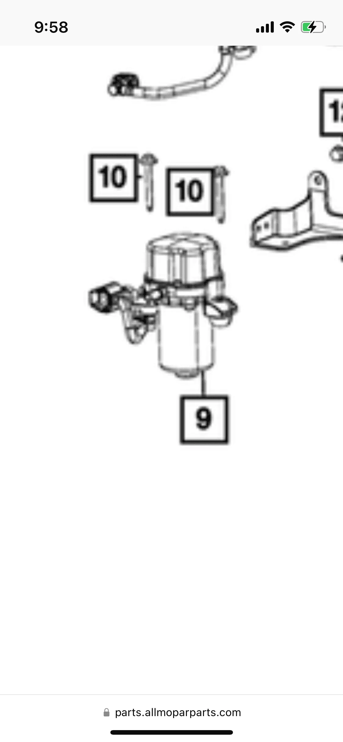

A thing that stupidly interferes with the belt tensioner strong-arm hole so you have to remove it to mess with the belt to change the alternator.
40,497
54,011
Like Chevrolet used - the pump handled PS and PB hydraulicly.
"Hydro-boost", not vacuum.

As Shadows Papa described, it is the vacuum pump for the brake booster. Engines don't make as much vacuum as they used to - especially once carburetors with throttle bodies went away. Under certain conditions the vacuum isn't sufficient for a sustained brake pedal response so the electric vacuum pump keeps the vacuum strong in the brake booster..
I tow our Jeeps behind a diesel pusher motorhome and have an M&G pneumatic braking system that applies the Jeep's brakes proportionate to the coach's air brakes. I had to cut into the harness for that pump so that it would operate whenever the Jeep was plugged into the hot wire on the coach's trailer lights harness otherwise the pneumatic actuator wouldn't have the power to depress the Jeep's brake pedal without vacuum. That's common to most Mopar products. Ford and GM require an add-on vacuum pump for flat-towing behind a motorhome.
