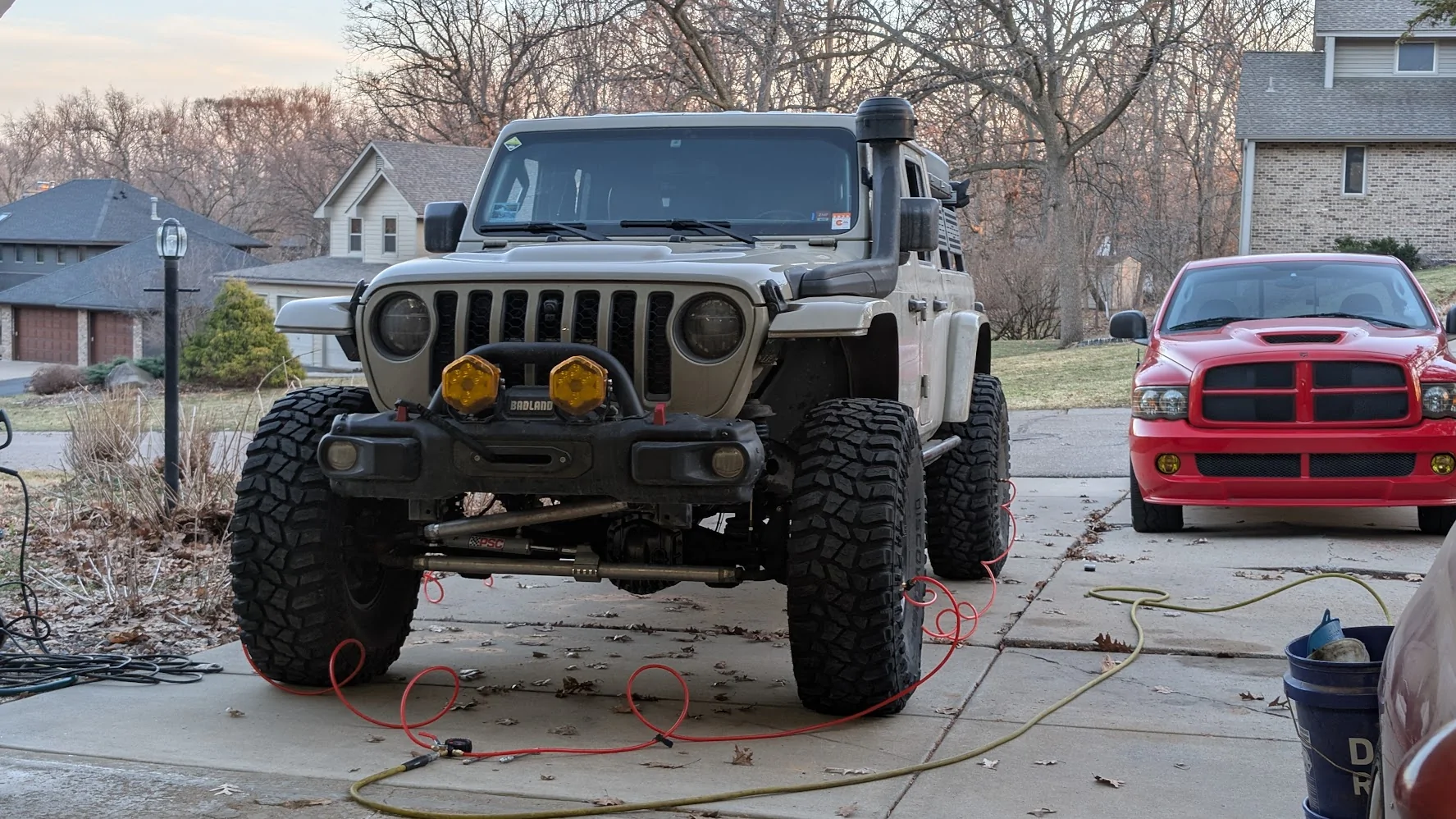

I ran for a couple years a pieced together spacer lift that drove great and worked really well, addressed all the basic points like sway links, bump stops, etc, and maintained a factory level of Rubicon travel. There's a lot of little bits to be aware of. It really depends on what you want and how much you want to spend. I think the spacer lift route is a totally acceptable way for you to go for your first foray into Jeeping. You might find out it's not for you and at least you haven't wasted a bunch of money. It is, however, more expensive than it used to be... I pieced this same setup together in 2022 for half the price it is today.
If you wanted to go that route yourself:
IRO 2" Spacer lift - $230
Mopar 68322798AA Extended Front LCAs, need two - $72.26 total
Mopar 68306981AA 2" Front Sway Links, need two - $55.78 total
Mopar 68436812AA 2" Rear Sway Links, need two - $57.68 total
Clayton adjustable front track bar - $289.00
Add 2" bump stops both front and rear. You can use hockey pucks if you want, drill and countersink for bolts. Don't over tighten or they'll crack over time.
If you go that route and want to reduce the rake you can go to a 3" front spacer or stack a 1" on the 2" IRO (they're keyed and it works fine) and you'll lose an inch of down travel but I believe Metalcloak makes a 3" shock extension bracket that would replace the IRO bracket and you'd still retain the factory ride and travel.
This is my rig on that setup 4 years ago, 37s. It drove great:
Jeep Gladiator What matters in a lift kit? Any recommendations? 1775367419445-x

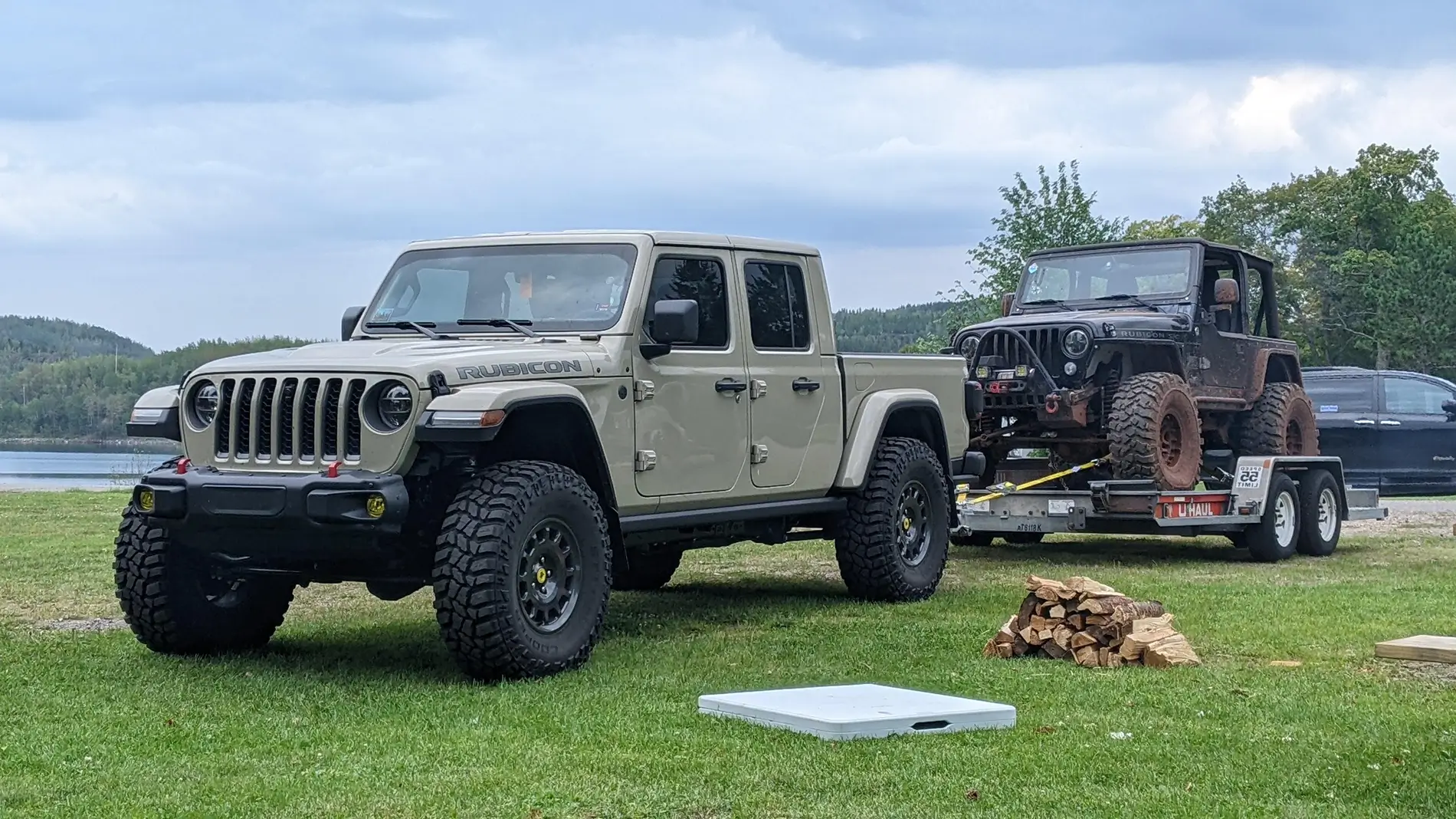

And just so you know I'm not preaching the cheap approach just because it's what I have, this is my rig now, which I'm also happy to share the pieced-together setup for if you want:
Jeep Gladiator What matters in a lift kit? Any recommendations? PXL_20260309_235436196
