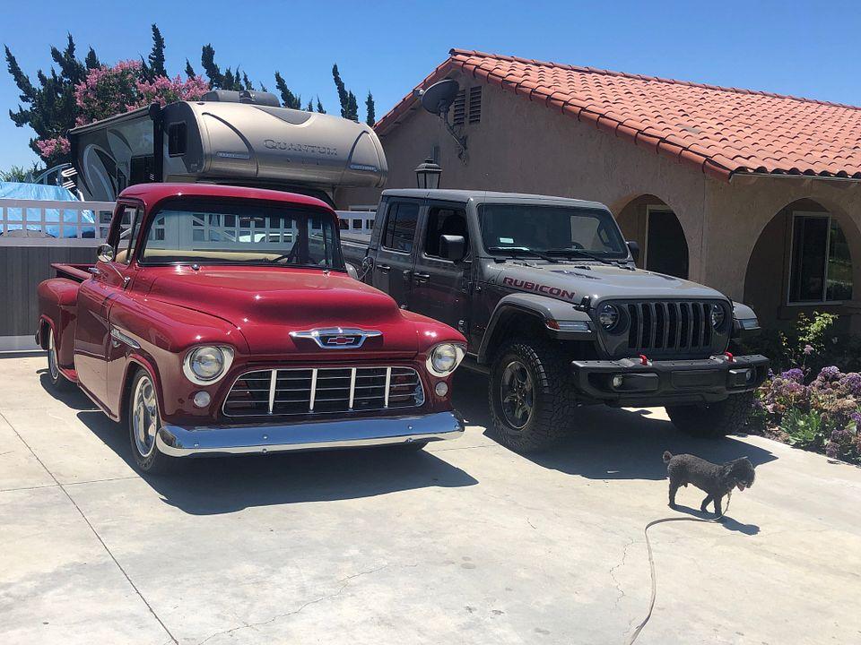

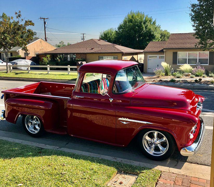

Agree. It isn't me that's claiming 10:1 compression is extra high compression. It' not "low" compression but it certainly isn't like the old days hen guys would be running 12 or 13:1 on the street.
For example the mildly cammed 6.0 LQ4 in my off topic '55 Chevy truck is an iron block engine. It is 9.5 compression now. LS engines hardly qualify as "old school" and I run 87 in it all the time. It is running the Holley Dominator EFI and runs great. It's "only" making a bit more than 350-360HP and similar torque; which is fairly low for that engine. And it never pings in the least even if I bury my foot in it.
Sorry, it's dusty in the 2nd pic:
