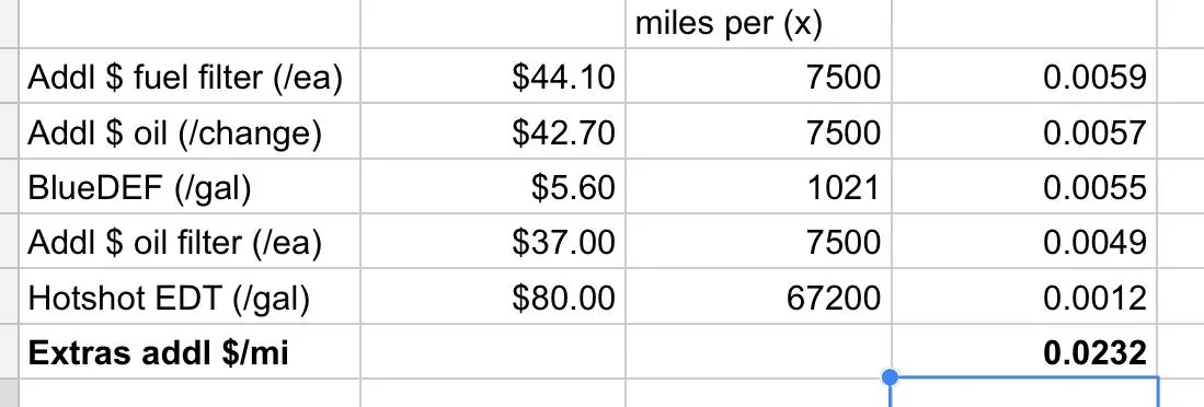

Here’s something fun regarding running costs. I made a nerd spreadsheet of additional costs vs the gas motor
Jeep Gladiator What should I know about the 3.0 IMG_0742
There are MANY assumptions built in here, so rather than argue about these particular numbers, you should first make your own spreadsheet. Some of these are: Pennzoil Euro 5W-40, OE filters at the new recommended intervals, Costco BlueDEF, using Hotshot EDT at their recommended 1oz/25gal (and buying in gallon bulk), and the MPG and DEF usage I personally have seen so far (I don’t tow).
The fun thing here, I think, is the relative magnitudes. If you find deals on quality oil, DEF, oil and fuel filters, snap them up.
[Also interesting for me personally, with my particular build, with my local fuel prices, is that even with these additional per-mile costs, and the additional one-time costs vs the gas truck I would have bought otherwise, the overall cost per mile still comes out lower on my diesel. Change any of those variables and the conclusion might change, so I won’t bother showing those numbers here.]
