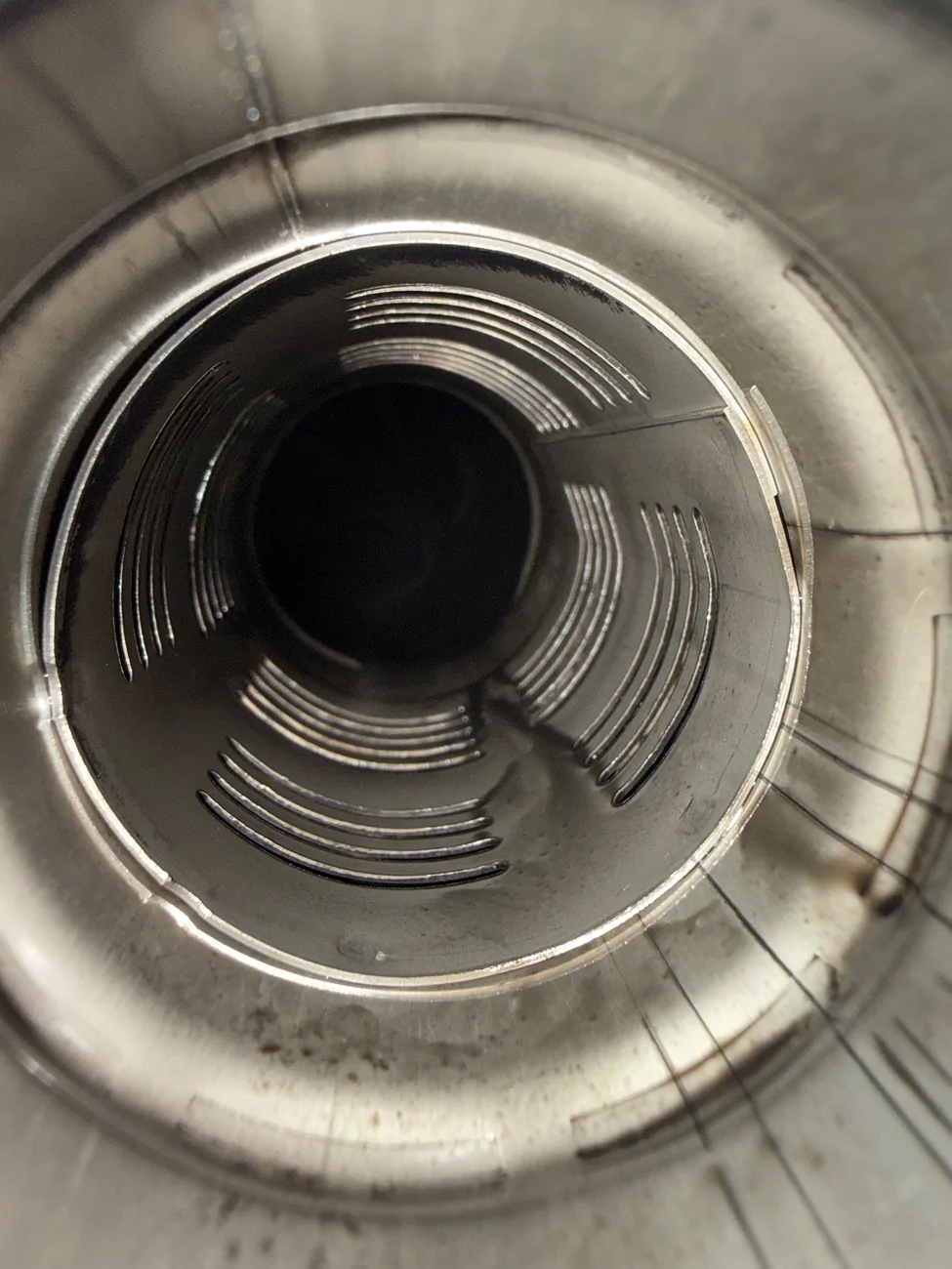

I never felt the need for a full snorkel and I’m not a fan of the aesthetic but I want my Jeep to breath more fresh air. Next I’ll be replacing the charge tubes but $600 seems a bit steep for aluminum tubing and silicone fittings readily available, especially after looking inside of the factory charge pipe with crazy baffles shown below.
You should hear this thing now!

The baffle appear made out of steel and spot welded in there. The gen2 is plastic and easily removable.
I think you’re referring to the intake piping, pre turbo, not the charge pipe, post turbo. I’ve already installed an AFE cai with the gold filter. Works and looks great

Anybody make an intake tubing that retain the factory air box? Just to eliminate the baffle section.
You can take the intake off and pop the plastic baffle out of it, this is the charge air piping after the turbo

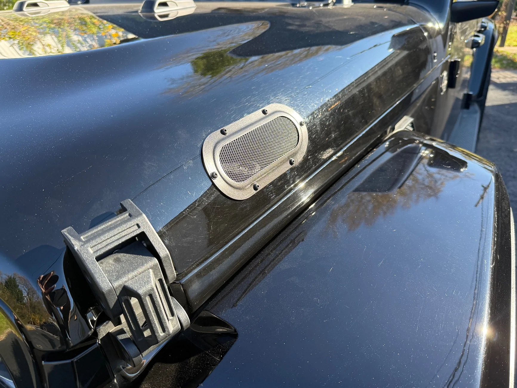

Where did you get the screen you put on the hood?

So did you notice any changes? I just bought my first JT and it's amazing that the engine bay is so restricted to letting air pass through. Looking at the intake and how close it is to the hood, where does the air come from in that tight spot?
I am in AZ and we have very little rain. What you did would be perfect for my engine provided it actually has an advantage?
