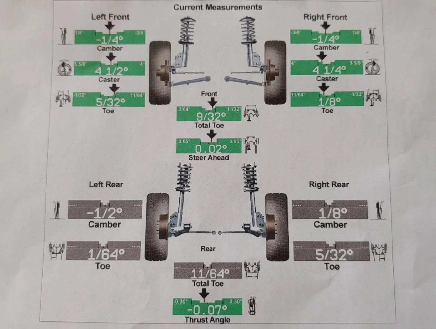

My mistake it was toe-in. The driver side was .39 and the passenger was .32 corrected to .05
.05 is the steer ahead angle.
That's the angle of the steering wheel when the wheels are straight ahead on a flat road.
Toe would be more like 1/8 degree for example.
I’m just repeating what’s on the alignment paper I have. That’s exactly what is has.
40,514
54,044
Your alignment sheet should look like this - it should show a before and after. This is the sheet from when I had the dealer simply check mine - no changes were made so it says "current measurements".
So folks looking on know - "steer ahead" would ideally be 0.0 degrees - perfectly level. That is perfection. Anything .05 or less is great as it means the wheel is pretty danged level to be less than 1/10 of a degree off.
They show toe on each side with the steering wheel level or as close to level as possible, and they show a total toe.
Total toe is what we used to go by before the modern equipment and methods. We'd center the wheel, lock it in place (not with the column lock) and then set toe-in (toe out for front wheel drive)
Anyway, steer ahead is the steering wheel, toe is the number of degrees the front of the tire is inward from perfectly straight ahead. As my father would say to compare - it's either knock-knee'd or pigeon-toed.
In my example, steering wheel pretty much straight ahead (.02 degrees from perfectly level), I show a total toe of 9/32 degrees and split fairly equally each side. There's only 1/32 of a degree difference on mine. OCD perfection would be a perfect split, say 1/8 degree each side for a total of 1/4 degree. We used to use inches, like 1/8" toe-in instead of degrees but if you put bigger wheels and tires on, even if the degrees are the same the inches would be very different.
Mine IMO, is on the light side of caster - 4 degrees is minimum on a JT and mine is 4.25 right and 4.5 degrees left so I'm just inside caster specs.
All the dealer can set is steer ahead and toe. Toe should be equal left vs. right (in specs of 1/32-11/64 degrees each side) with near zero or zero steer ahead.

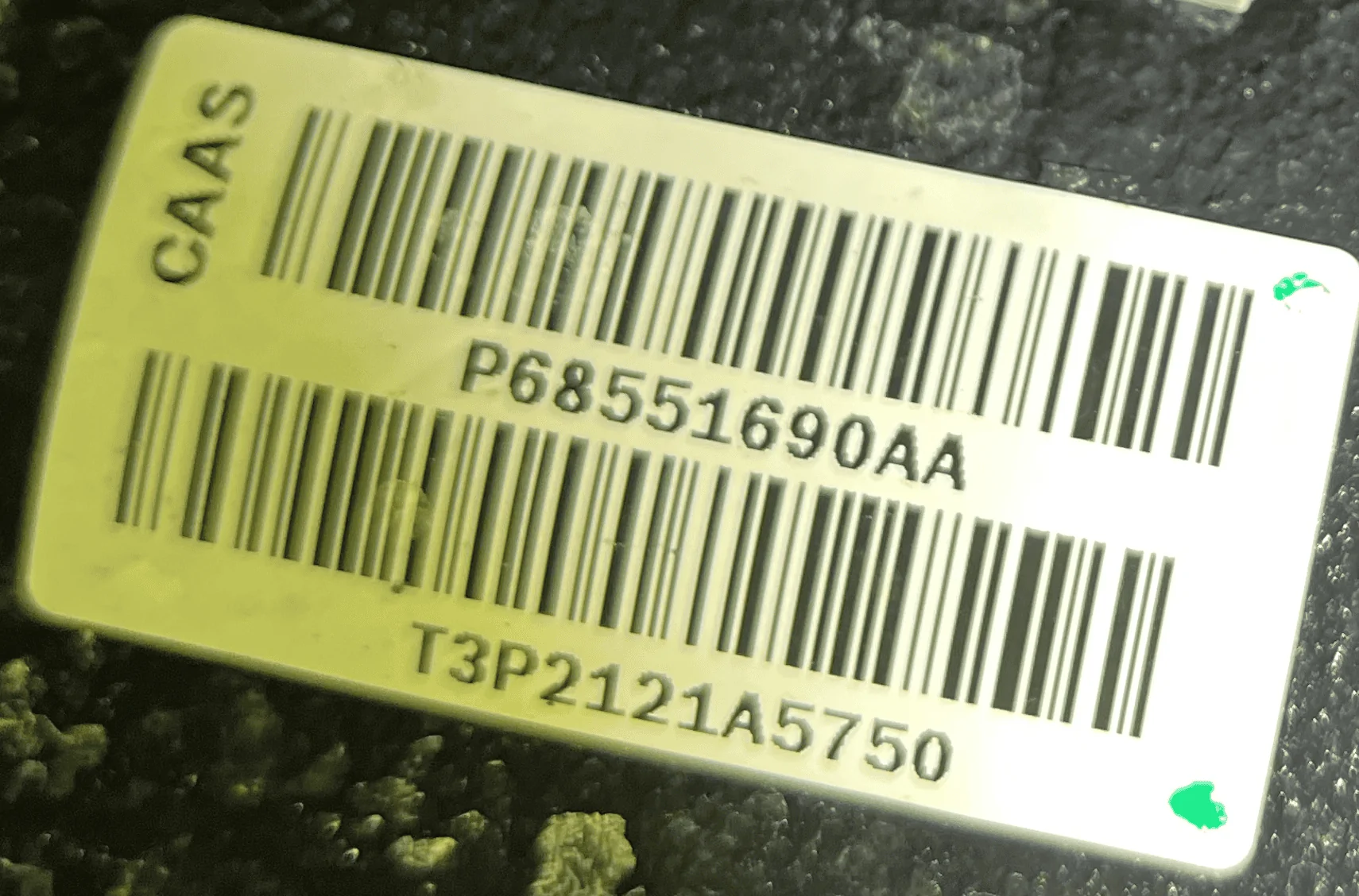

I just took this picture of my 2022 Rubicon
Jeep Gladiator What should I tell the dealership to get second steering box TSB fix? 1642466694536
40,514
54,044
That's a 2022 - possibly they've totally changed the part for 2022. There's any number of reasons for them to do so.
2020 and 2021` have the other numbers.
Is yours a diesel by any chance?
Davesnothereman
Davesnothereman
Dave
May 13, 2020
85
Ny
06 Liberty
I don’t know if the flashed the ECU, would that matter if they put a 2022 box in?
40,514
54,044
Don't know about that part - but when the steering gear is swapped they must perform a flash. There's even a separate communication to dealers on that.
We don't know why the change to a totally different part number on the 2022.
(and was that a DIESEL or gas that the 68551xxxx part number came from??????? If diesel, that could be why that 2022 number is different, not because it is a 2022)
Elff
Dec 20, 2021
1,363
3,985
Keebler
TJ Rubicon, Buell XBRS
Interwebs
I have a the 3.6L gas engine.
How’s your steering though?
I lowered the Tire pressure down to 35Psi and so far it is not bad.
I have to make slight corrections based on the road dipping, but I live in PA, and we have some of the shittiest roads in the country. I will have to see how it feels on one of the main highways. I have a longer drive on Saturday to pick up an 18' trailer and that will be a good test for me.
I will say, my 2004 TJ Rubicon on 35s does feel tighter. I have the OffRoad Only Tru Turn on that which splits the Tie Rod from the Drag Link, and the Steering box was upgraded by the previous owner to the MB one.
All of this aside, I think the Gladiator feels ok and I can comfortably drive it with 1 hand without feeling uneasy
