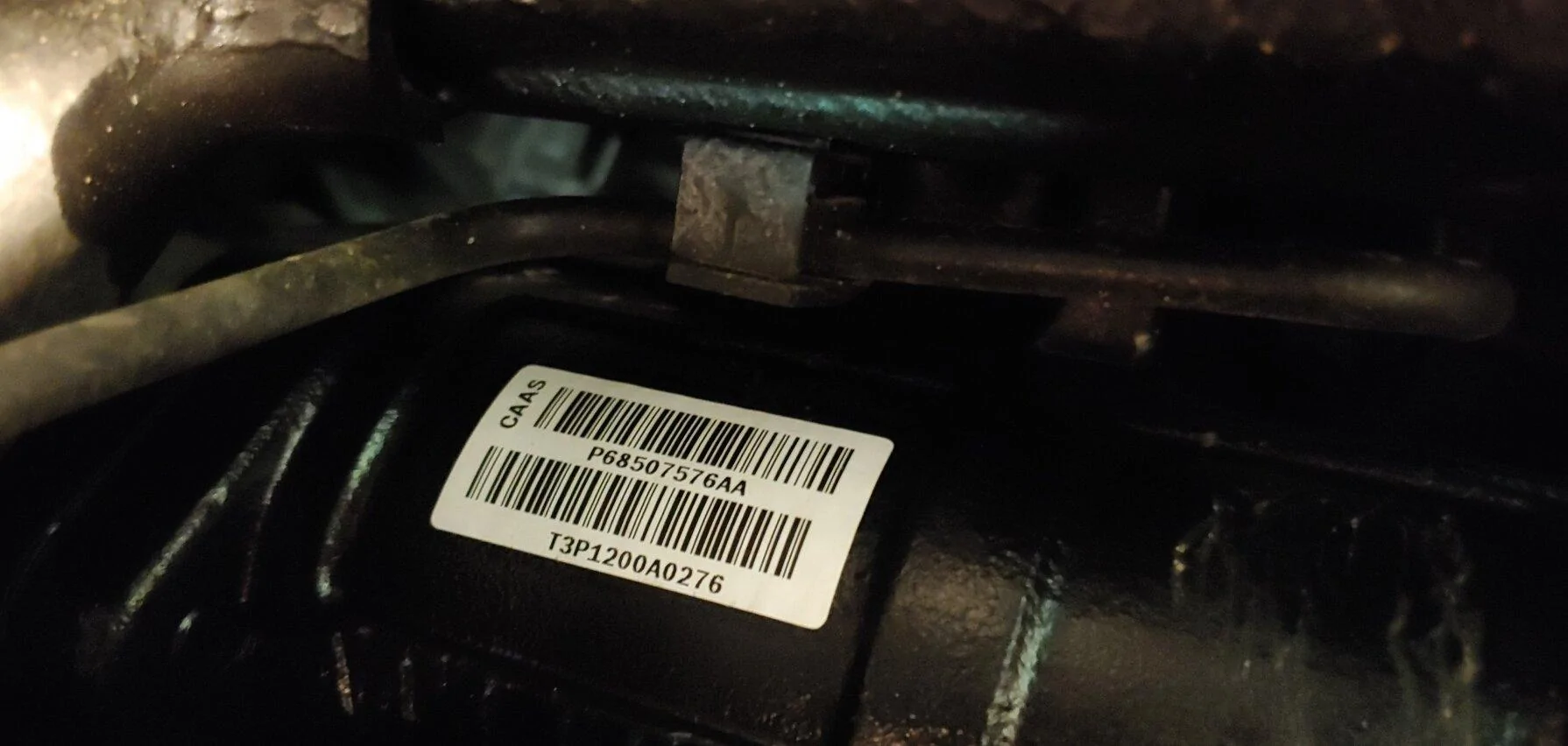

My first replacement steering gear - THIS is the part number the TSB specifies -

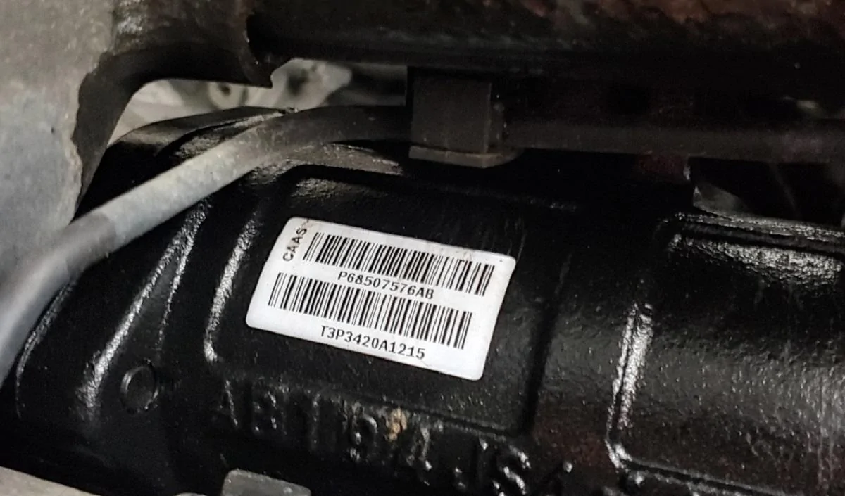

This is the next steering gear I got - minor revision, AB - not sure what the difference is or was, usually when the last letter changes it's an extremely minor change -
