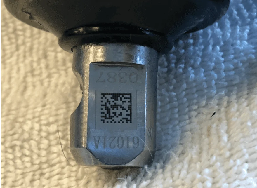

This is what the input shaft looks like. If that bolt is present and tight, the joint is tight. The coupling would not be loose or there would be a rattle or noise and you could feel it in the steering wheel or should be able to.
There's no way this would be so small in the coupler that you'd get over an inch of play in the steering wheel. I bet if you have someone wiggle the wheel back and forth with the engine off and you feel the shaft to the steering column and not feel that much play.
That thing would have to be waaay loose to give you 1.5" play.

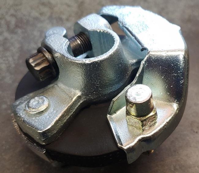

Outside the firewall if I am correct there's an intermediate shaft that has u-joints. This doesn't have the old style flex joints, which shade-tree mechanics called "rag joints". This would be an actual cross type u-joint on these, I believe.
It's pretty solid, there won't be play in these systems. If there's play, it's because the tech left a bolt loose or out, or it's in the steering gear, or they left the pitman nut loose or there's play elsewhere.
This isn't a matter of a shaft being too small in a coupling. The coupling clamps to the shaft.
I believe this is the intermediate shaft. Note the solid cross type u-joints, no old-fashioned flex joint.
You can see where it's supposed to collapse in a catastrophic accident. This is ahead of the firewall at the lower end of the main steering column and clamps to the input of the steering gear. It doesn't just slip on and sit there loosely. There's not a lot of play between this and the input on the steering gear. If it's loose, someone f'd up on the install. It would be akin to leaving the bolt out in the old-fashioned flex joint seen in the bottom pic...... but if that was loose and that clamp opened up you'd be in deep doo-doo. (that one is a flex joint I restored recently)
Ok, it has the same type of joint as a Power Wagon. Same steering design. Small u- joint. This joint will get play in it over time. There is a bushing kit for it. Wonder if is the same size.
