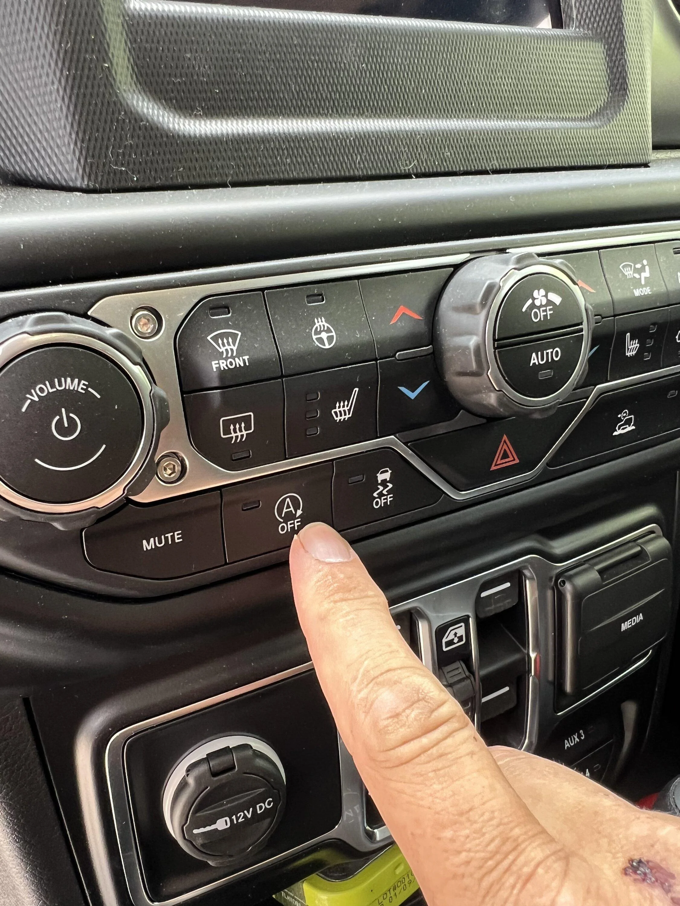

Turn it off
LOL - pushing a button is tooooo hard. It's just easier to complain about it and hate it and validate your hate for it by finding someone else who hates it - simply because they do.
