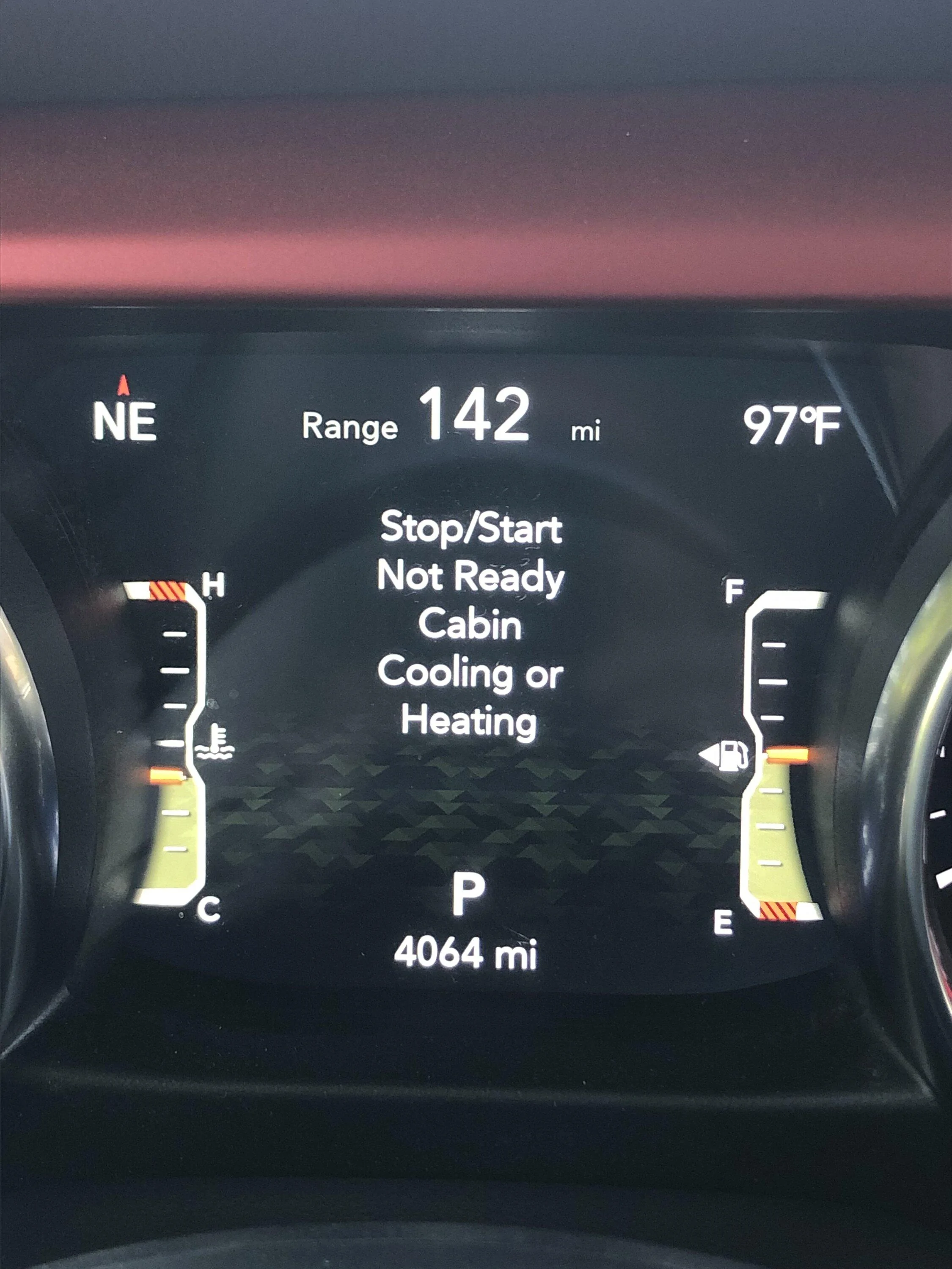

What's the main cause, low charge aux battery? It kicks in less lately, I'm only at 3700 miles. Recent inspection and first oil change done, no codes/issues. Is this something to worry about? I realize that electronics monitor conditions for this feature to switch on.
Mine takes longer to engage in extreme temps - when it gets hot and the AC is getting the car to auto set temp or when it's cold and it's getting heated up. The message center usually says "stop start not ready" on the stop/start status screen.

When you get to the screen and it says not ready charging. Take it to the dealer an have them replace the batteries. I had this done on mine and it was at about the same miliage you have.
At 3700 miles? Wow, hopefully just duds. I'll be replacing mine every 20-25k regardless of issues. Sounds like 30-35k is when people start getting electrical issues due to a dying aux.

Per those conditions, it's only been hot days here, over 90, could be the cause then. I'll check that monitor on the dash too, thx!
It is not be the miles, it is just be that is the miles you are at when the summer heat kicks in. It has been up to 108 F here in the last week in Vegas and mine does not kick on all the time now in order to keep AC working at top level while stopped. I am at 1700 miles. My BMW was same way. Got so used to it with. BMW I dont notice because that was and is normal in many cases
