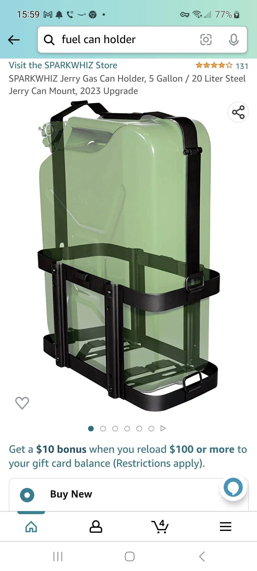

Depending on your skill set you could make a fuel can basket out of some 1/8 by 1in strap metal to hold fuel cans. Or you can buy some from Amazon or Summit racing, or other companies.
Jeep Gladiator Where to mount 5 Gallon NATO Jerry Can? Screenshot_20230329_155913_Amazon Shopping
I've got 2 of this one on my LJ rear bumper.

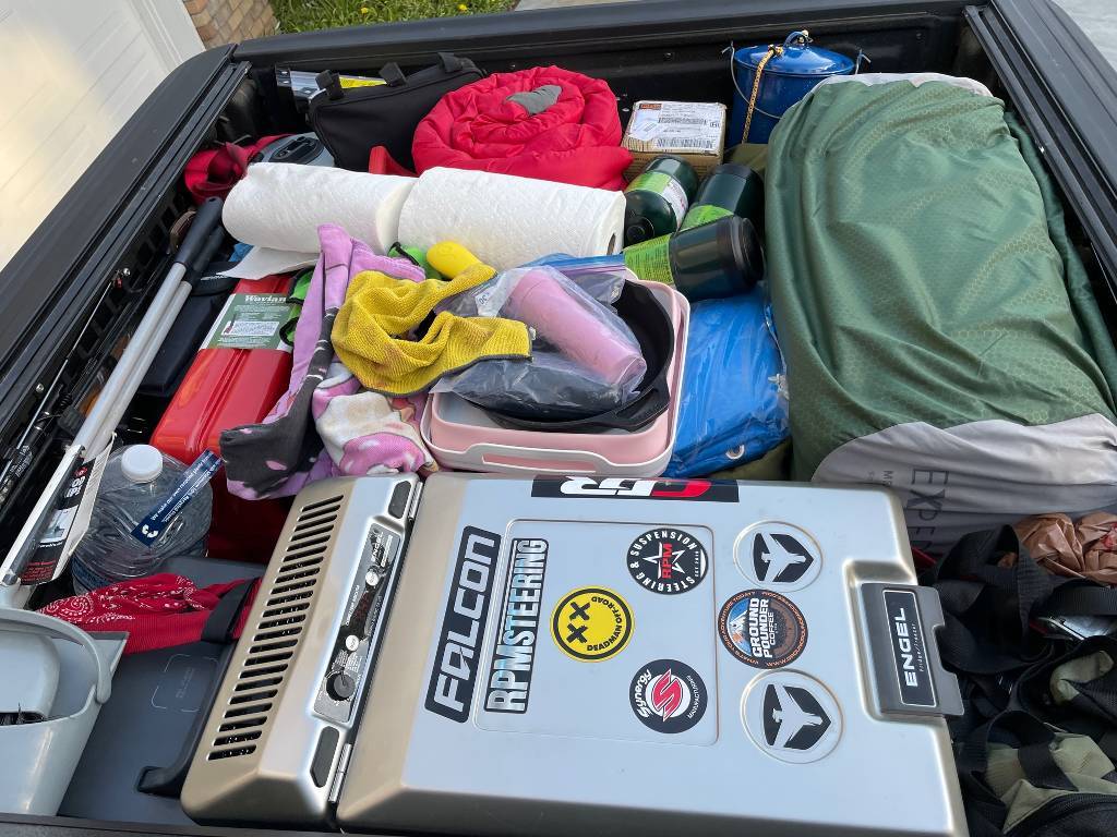

I have a Wavian 5 gallon and molle panels in my bed. I also run a hard Tonneau cover. I put the Wavian on its side with the cap facing up, then, I ratchet strap lengthwise very tight (under the handles) the wavian to my Molle panels. I can close my tonneau cover, and I ran that way through the Rubicon trail with no issues, no leak, no smell... Here is a pic from the Rubicon trail trip.
PS. I also bought the Wavian Red Long Nose Flexible Pouring Spout (4136-RED) - which makes it very easy to add the gas to the gas tank vs. the short plastic push pour one that comes with the Wavian. This is highly recommended.

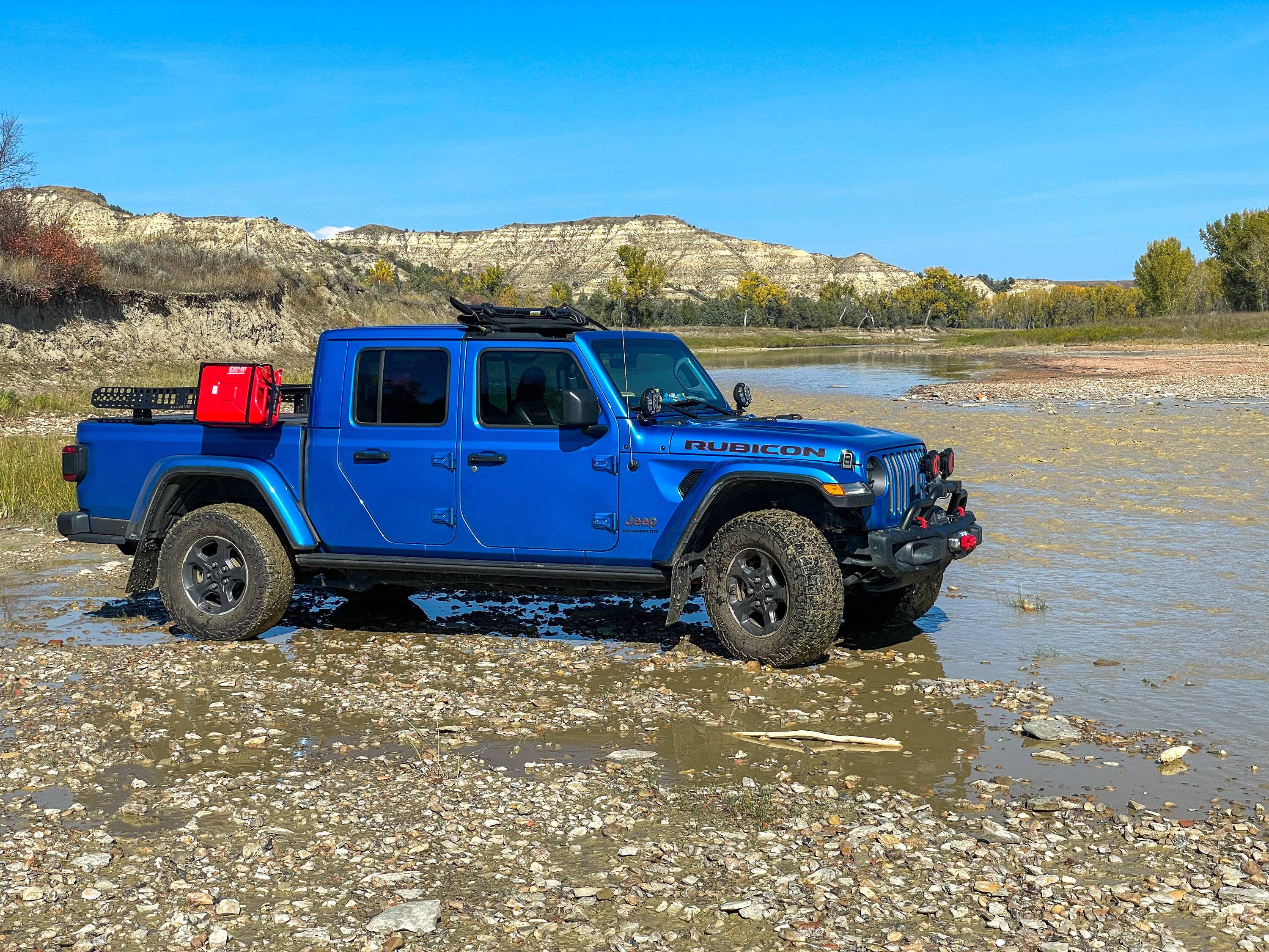

Did 14,000 miles cross country using the Wavian cans and mounts and Billie bars and their Molex panels. The only bummer was that you would think that after all these yours that the Wavian mounts would work with Molex stuff. But they did not and I had to build brackets to mount them to the Molex panels.
Jeep Gladiator Where to mount 5 Gallon NATO Jerry Can? IMG_0064
i also looked at roof racks that mounted to the roof and only covered the rear doors but ultimately decided that the combined weight of the rack, cans and gas exceeded what Mopar recommended attaching to the roof.
