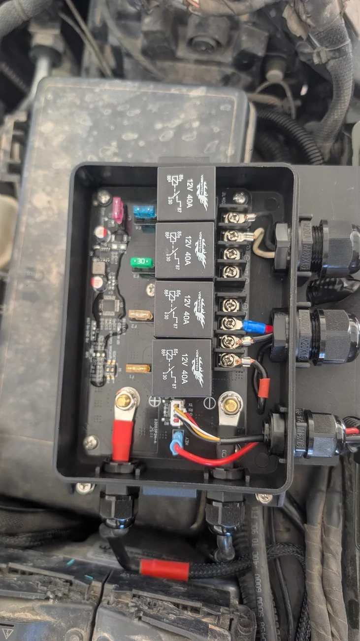

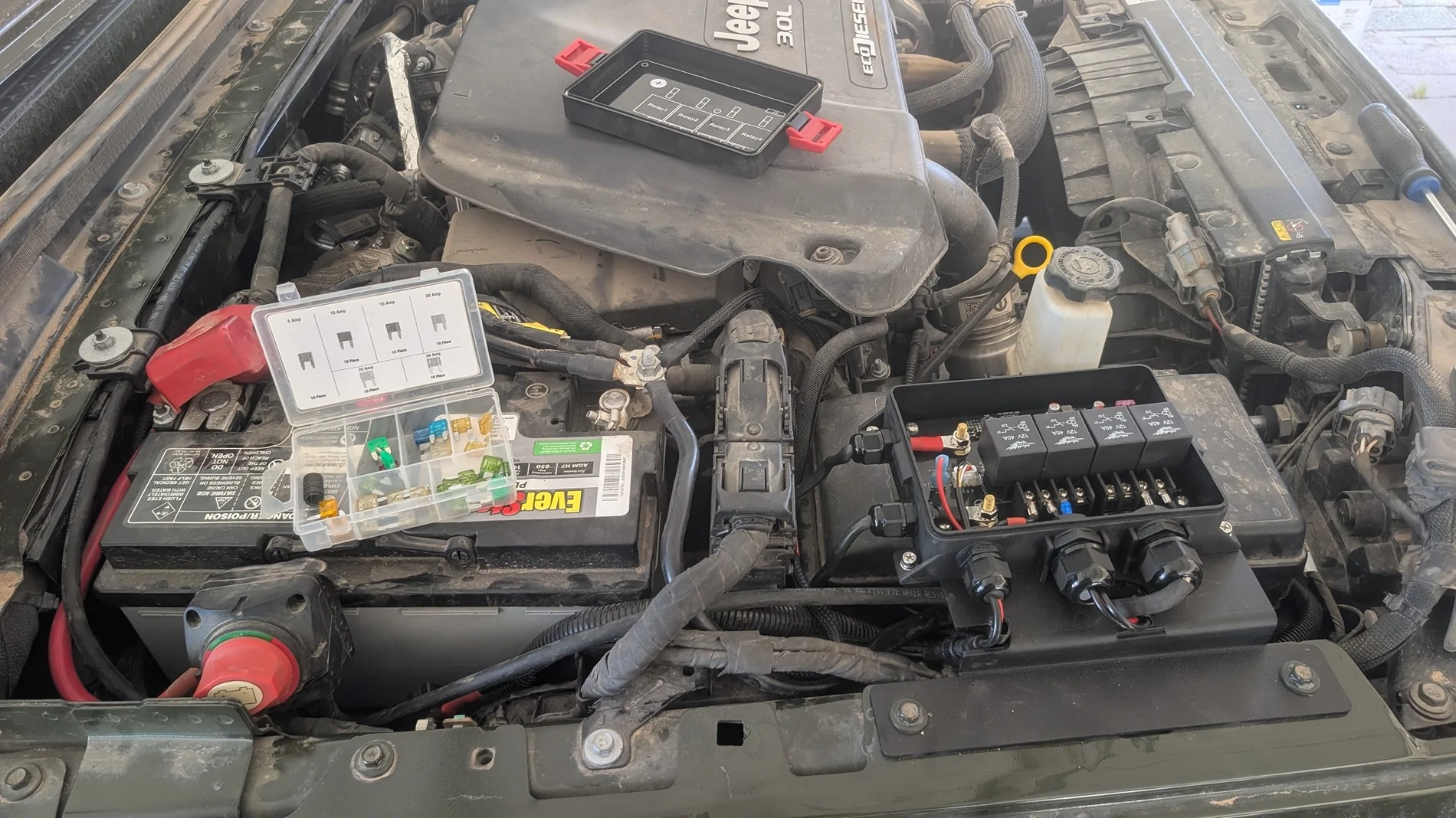

Old thread, but I just installed the voswitch jl400 over the fuse box. After I hooked up the fuse tap for switched power of course.
Jeep Gladiator Which Auxiliary Switch Control for the EcoDiesel? PXL_20260508_204453109
Jeep Gladiator Which Auxiliary Switch Control for the EcoDiesel? PXL_20260508_204514294
