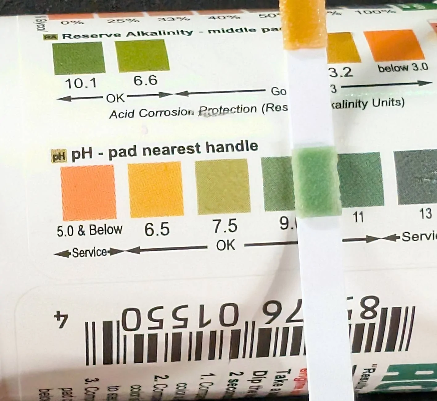

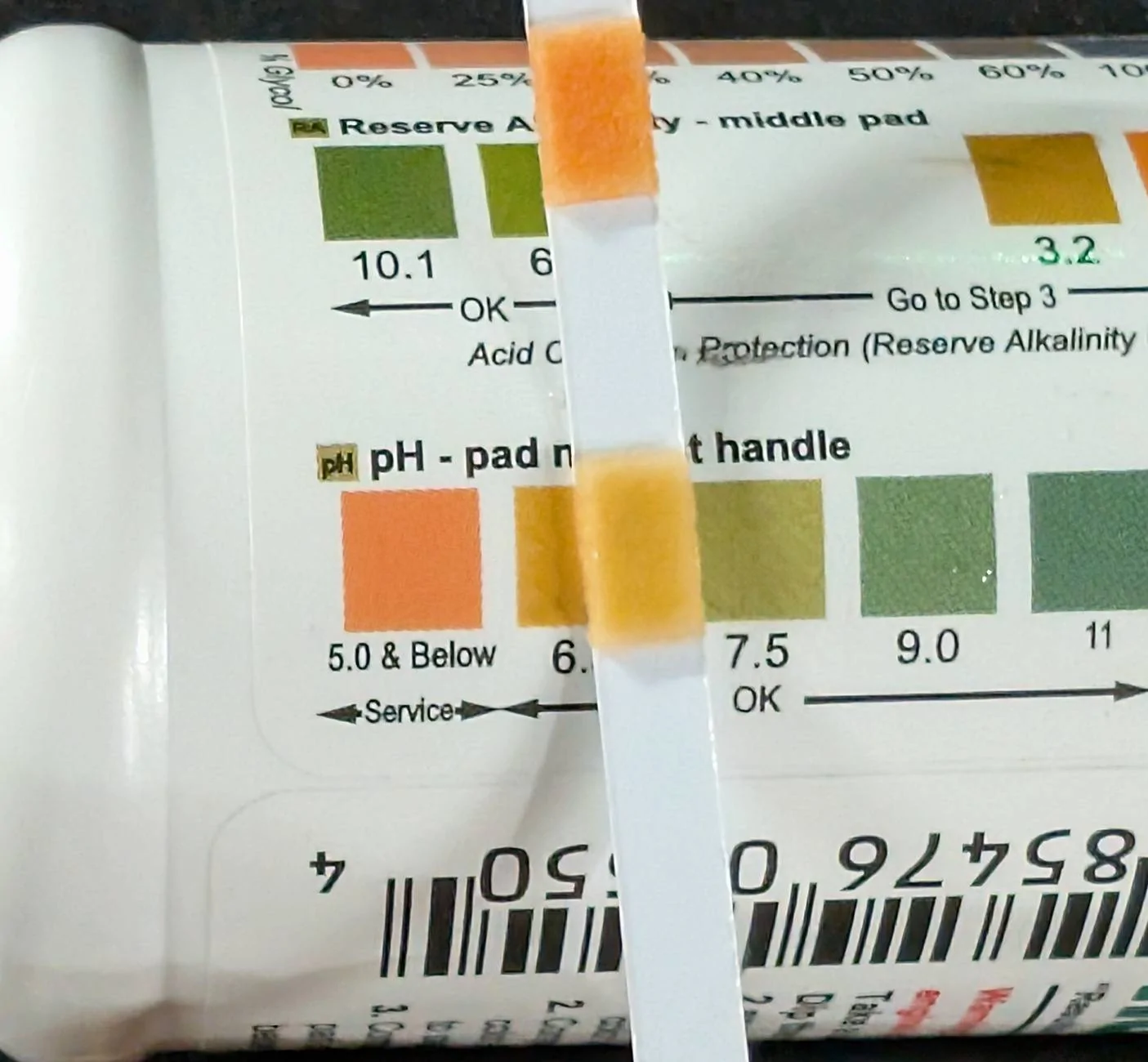

Mopar coolant in the Jeep. Last changed in fall 2022, 30k miles. Topped off with maybe a cup of fresh coolant a few weeks ago.
New Mopar coolant straight from the bottle
Wow in 3 years and 30k miles! Check out how I did the change in this post with the extractor. It will protect you from this erosion that will occur with the low pH.

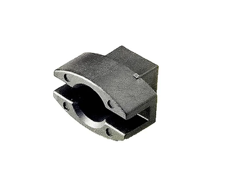

The 2015 and 2020 Ram EcoDiesel use a different draincock. For those, I use a 9mm hex socket bit for the drain valve, then use a 10mm wrench to turn the 9mm hex bit.
It looks like this style of socket will work on the Gladiator:
I had one of these but I forgot exactly why the socket was easier. I think from slipping but also I think space. This with the ratchet was tight on the Gladiator I think. See which one you like.

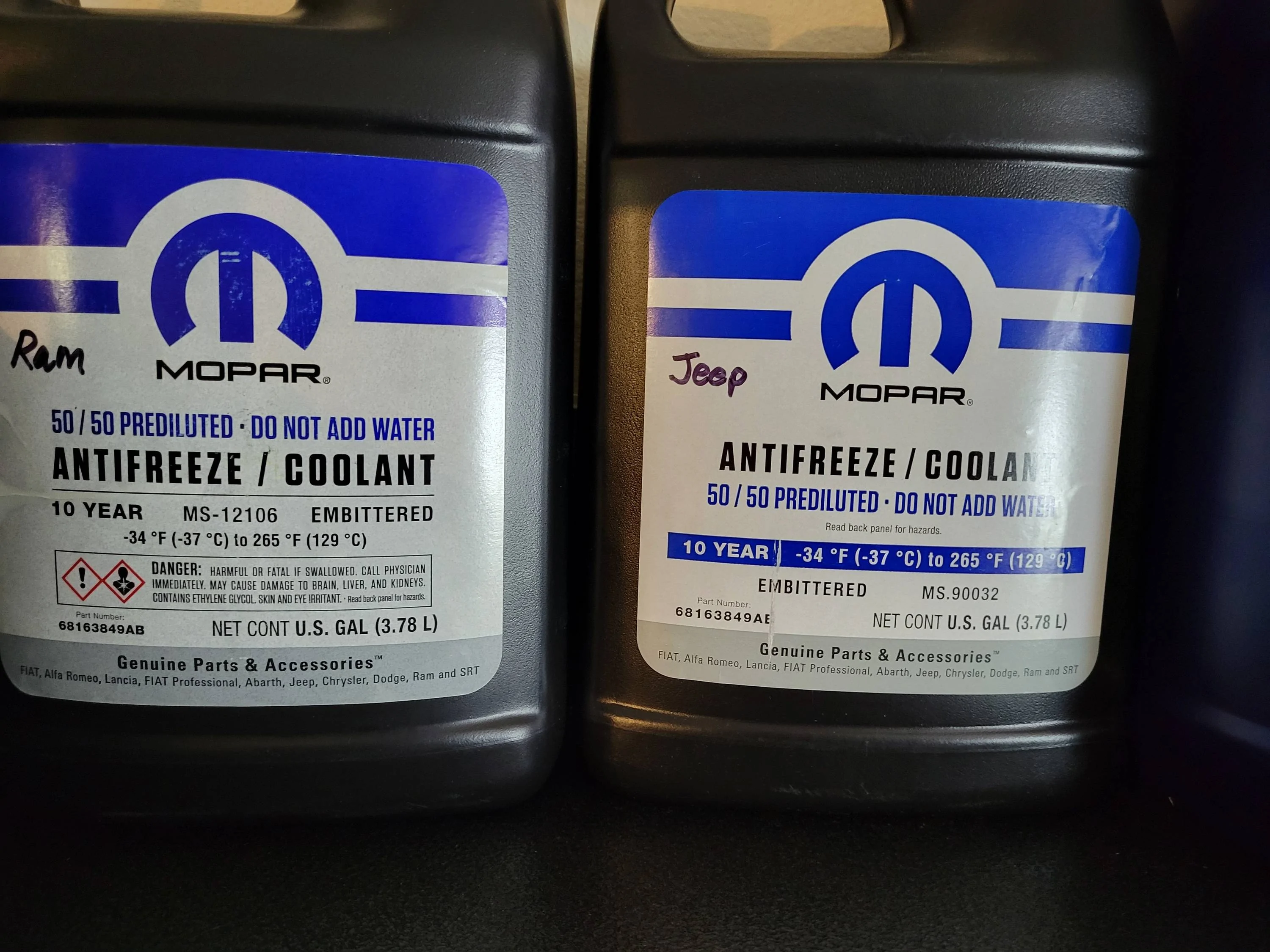

The recommended Zerex coolant differs from the OEM coolant which is an OAT (Organic Acid Technology). The Zerex red or yellow is an HOAT (Hybrid Organic Acid Technology) so a complete flush of the system to remove any trace of the OAT is necessary otherwise sever damage will occur.
The Zerex Yellow is an OAT coolant. You can mix it with the Mopar coolant with no problems.
Because the OP mentioned ZEREX Yellow and Red, I decided to dive into the details on the labels. Although it doesn't matter whether I agree because I am not a diesel expert, I agree that ZEREX Yellow (specifically, ZEREX Heavy Duty Extended Life Nitrite Free Yellow 50/50 Prediluted) is the better option for the 3.0L EcoDiesel.
Even though there should not be an issue with mixing in this case, I always do a flush & fill when switching between coolant products, and always top off, if necessary, with the same coolant that is already installed.

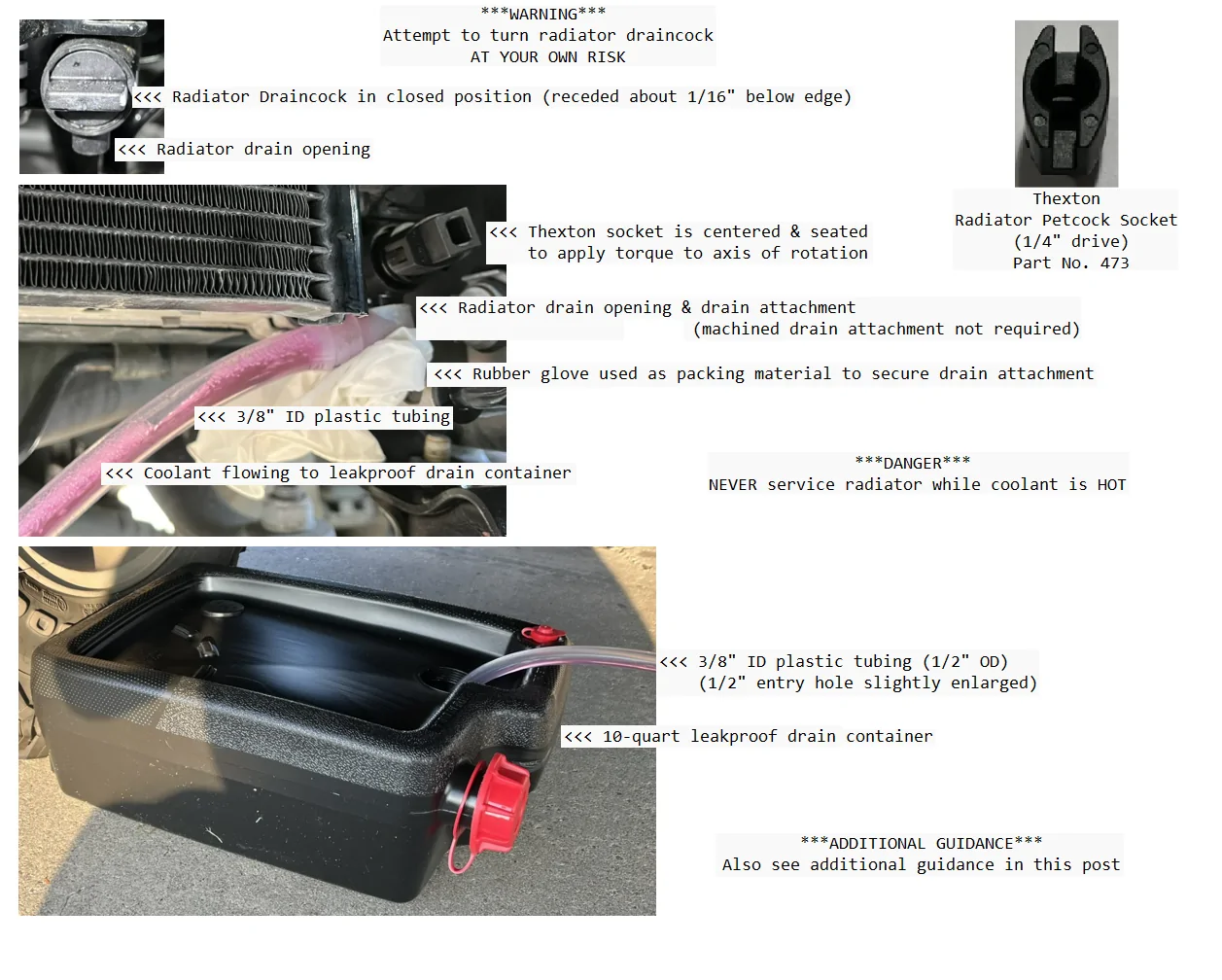

This Thexton socket worked like a charm. VERY snug fit to prevent movement while being rotated. Needs to be centered & seated to ensure torque is applied to axis of rotation. Apply SILICONE spray lubricant (not WD-40) into drain and around draincock seam. Some turning back-and-forth may be required to get to open position. Socket adapter (3/8" F to 1/4" M) required unless you have a 1/4" drive ratchet. Purchase spare Radiator Draincock (MOPAR 52028466AB, verify part number) in advance, and keep large drain pan on hand, in case it breaks. Attempt to turn radiator draincock AT YOUR OWN RISK; plastic radiator draincock and/or plastic radiator drain are KNOWN TO BREAK.
After coolant has been drained and drain has been closed, confirm that draincock recedes about 1/16" inside of edge. This should mean that the internal O-ring is properly seated.
For access to radiator drain, remove Air Dam and Brush Guard (no parts to buy, links for show only). I torqued the metal fasteners for these two parts hand tight. For a clean job, use 3/8" ID plastic tubing and a leakproof drain container.
Disconnecting the lower radiator hose is much safer and slightly faster, but using the radiator drain is 1) very clean and 2) workable for someone who lives in an apartment. If you are prone to breaking stuff, just drain the coolant by disconnecting the lower radiator hose or have a cooling system service done at a shop.
At least one (complete) cooling system service, involving a flush & fill (to remove sediment & debris), is recommended before using either of the radiator-only methods mentioned above. Removing the engine block drain plugs is out of scope.
Also see my video on YouTube:
Coolant Change Gladiator JT Wrangler JL 2018+, Using Radiator Drain (placed here with permission)
Attachment: Using Radiator Drain to Drain Coolant from Radiator.png
