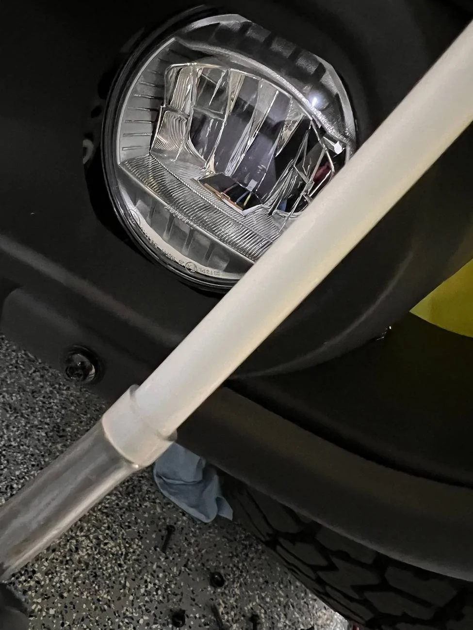

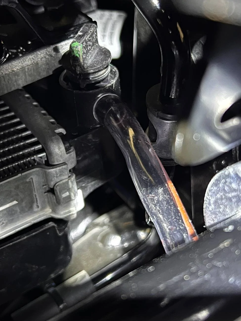

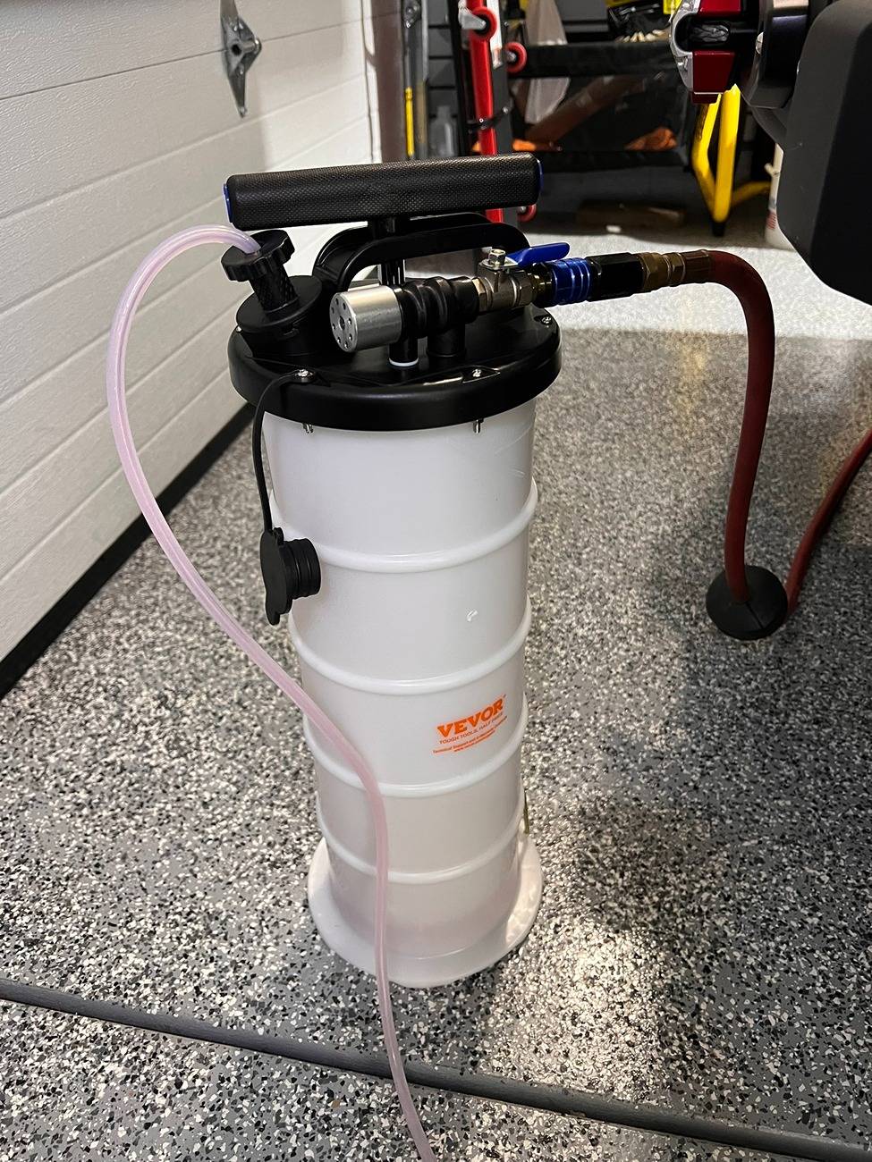

Here is the best way so far to change it unless there is better. I drain by opening the petcock with 19mm 6 point socket. It VERY hard to turn by hand. I have a petcock socket coming which will be better. I removed my shield to get better access. I used 5/16 ID clear tube and slid it on to drain into pan. I then used a Vevor Pneumatic extractor from Temu for $46 shipped. Looks like there out but other sell the same one different name. https://www.temu.com/goods_snapshot..._1738476629793_8kfflzizvz&refer_page_sn=10032
The extractor had a tube that fit snug on that 5/16ID clear hose. I then pull a little more out creating some vacuum in the system with the coolant reservoir cap almost closed. After that I vacuumed filled it with the AirLift. This pulls all the air out then fills it with coolant so no air pockets or bleeding needed. I love this thing! https://www.amazon.com/UView-550000...ocphy=9031176&hvtargid=pla-435688359104&psc=1 In went the the new MUCH longer lasting higher quality Zerex HD Extended Life Diesel claimed 10 years or 1 million miles. It is yellow and OATs compatible. Here is the link to the best place I found and bought 2 case 12 gallons 50/50. https://www.maxwarehouse.com/produc...bUXb7NiL4htx0yH4QmY_pvcfzhT386xxoCuAAQAvD_BwE
Im going to keep doing this until I finish the 12 gallons. Then test with Acustrip and change from time to time at 7.5pH This is the BEST coolant and will hold pH much longer then Mopar.
