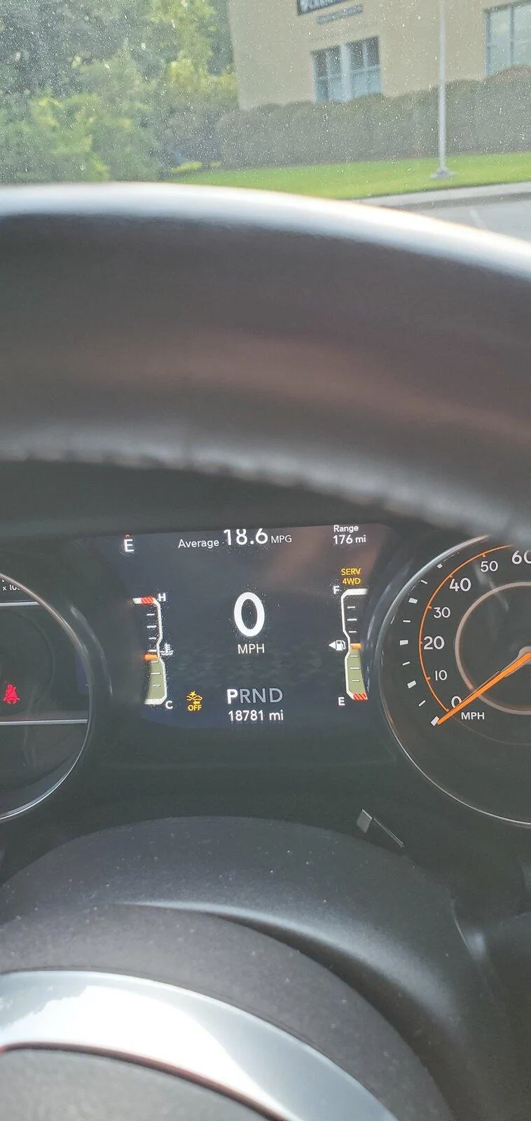

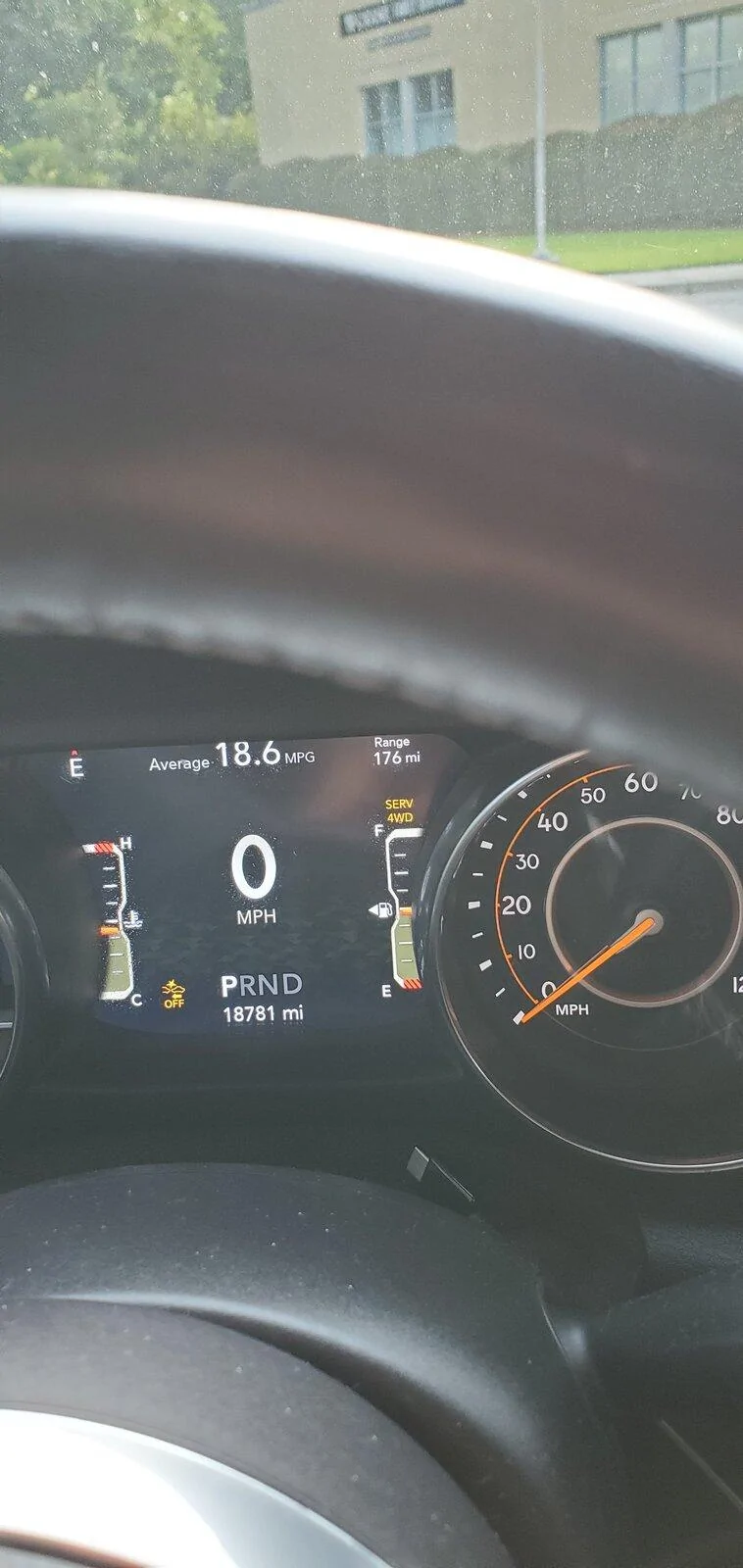

I recently started getting this fault and light in dash. It also gives a fcw light and turns off Park sense system and light comes on on the button. I will attach pics. Took to dealer and they said can't get to it now, they are backed up. I made appointment for today and told can't get to it. Any idea what could be causing this and is it OK to drive. Trying to get into another dealer to get it checked, heading to jeep invasion next week and need it. I can pull over and turn off vehicle and it goes away but will come back.

I do not think there is one magic bullet item for this fault indication. Having an Overland and it's 4WD Auto system with it's transfer case clutch system also adds an extra lay of complication. Could be a transfer case, FAD, switch or even ABS issue that ties into this system and anything without a proper dealer or high end scan tool diagnosis will just be stabbing guesses.

That's true. Even without the Select-Trac system, there still is quite a bit of other ancillary systems tied into what will makes the "SERV 4WD" caution light to come on. It is nothing I would take stabbing guesses on without a decent high level scan tool to help troubleshoot.

At this point, though, he's doing the right thing and getting it looked at. Nothing anyone can really do until that diagnosis comes back. My money is also on an issue with the transfer case or ABS system, but that's just a guess at this point.

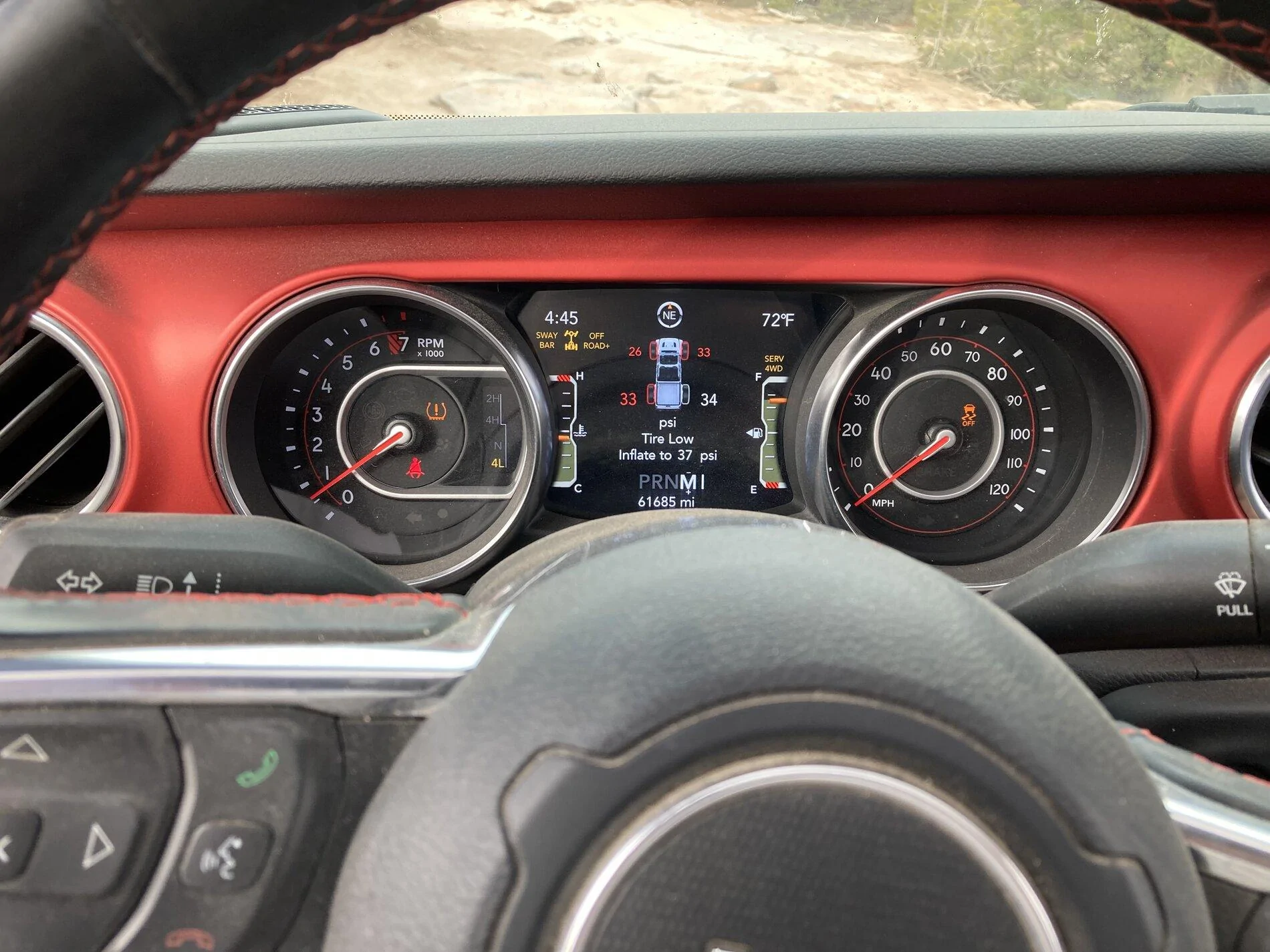

I too am getting random Service 4WD warning light activations when in four wheel drive. They reset when I shut the rig off, and sometimes do not return for hours. A few weeks ago in Moab my dash was lit up like Christmas!
