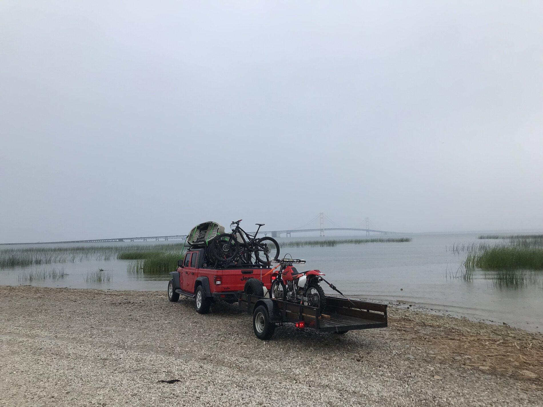

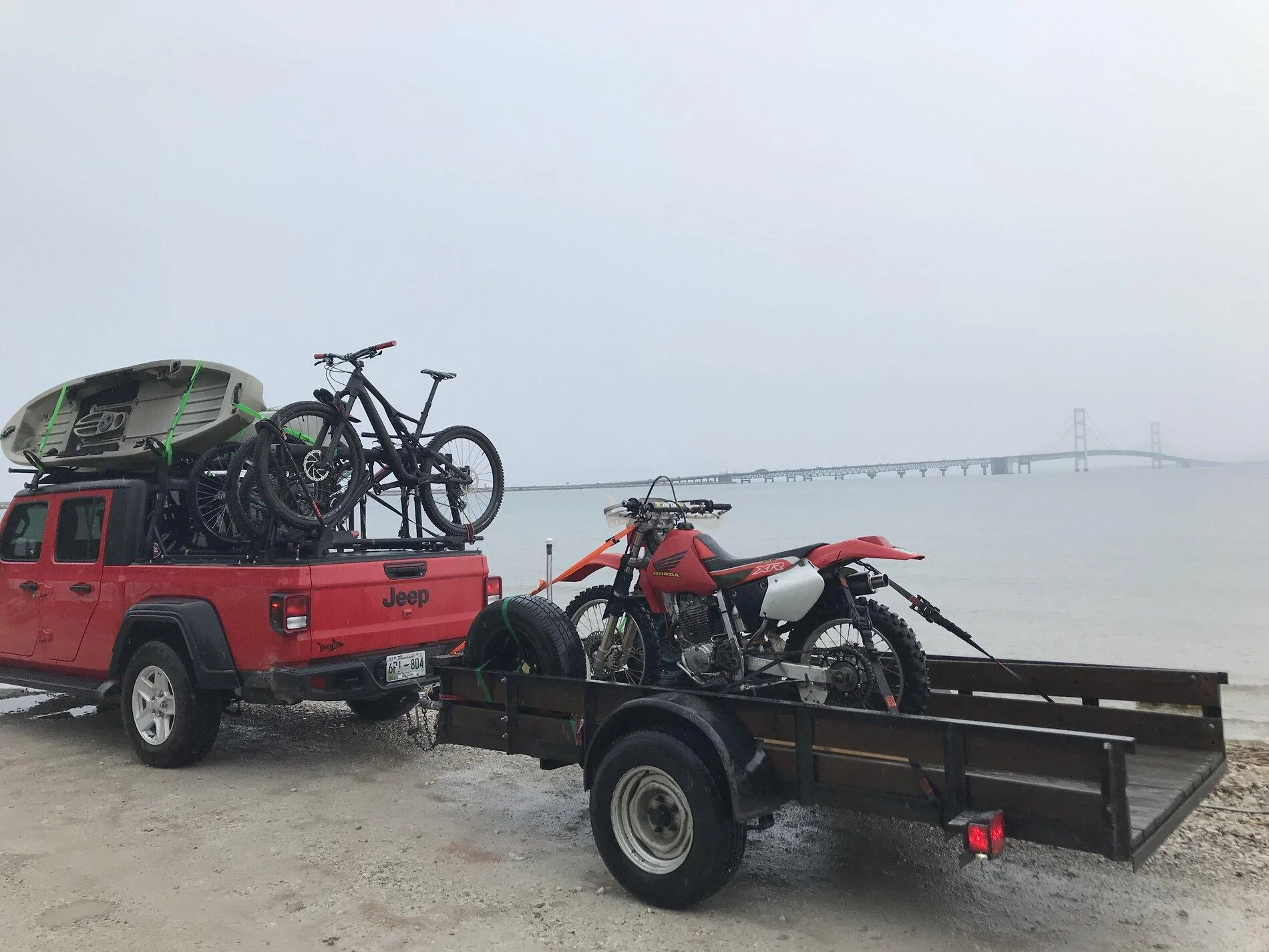

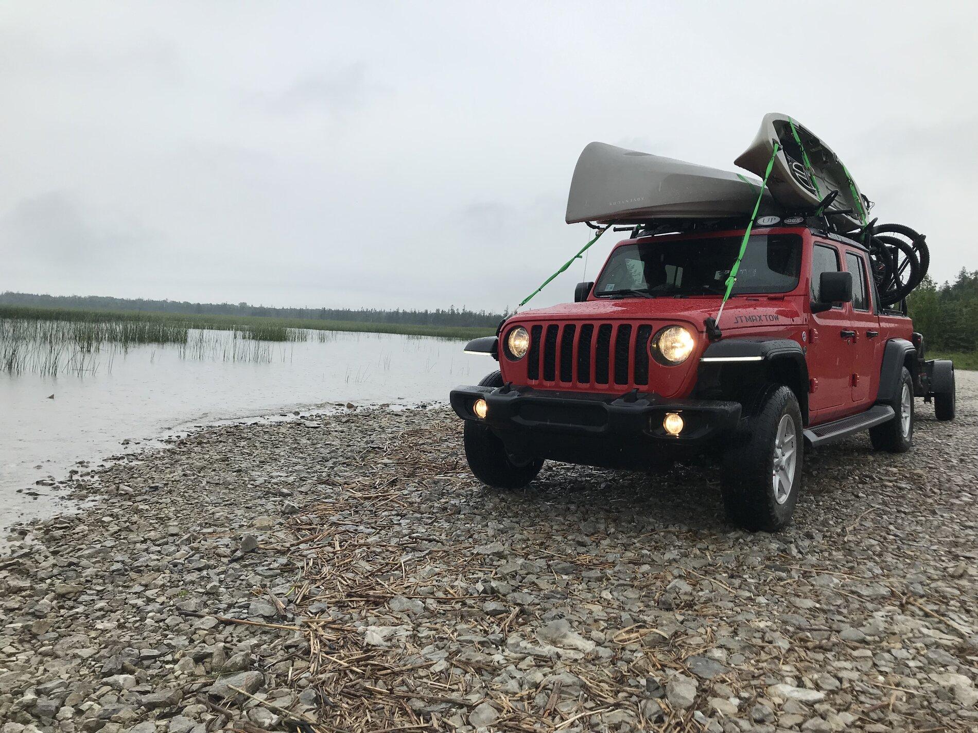

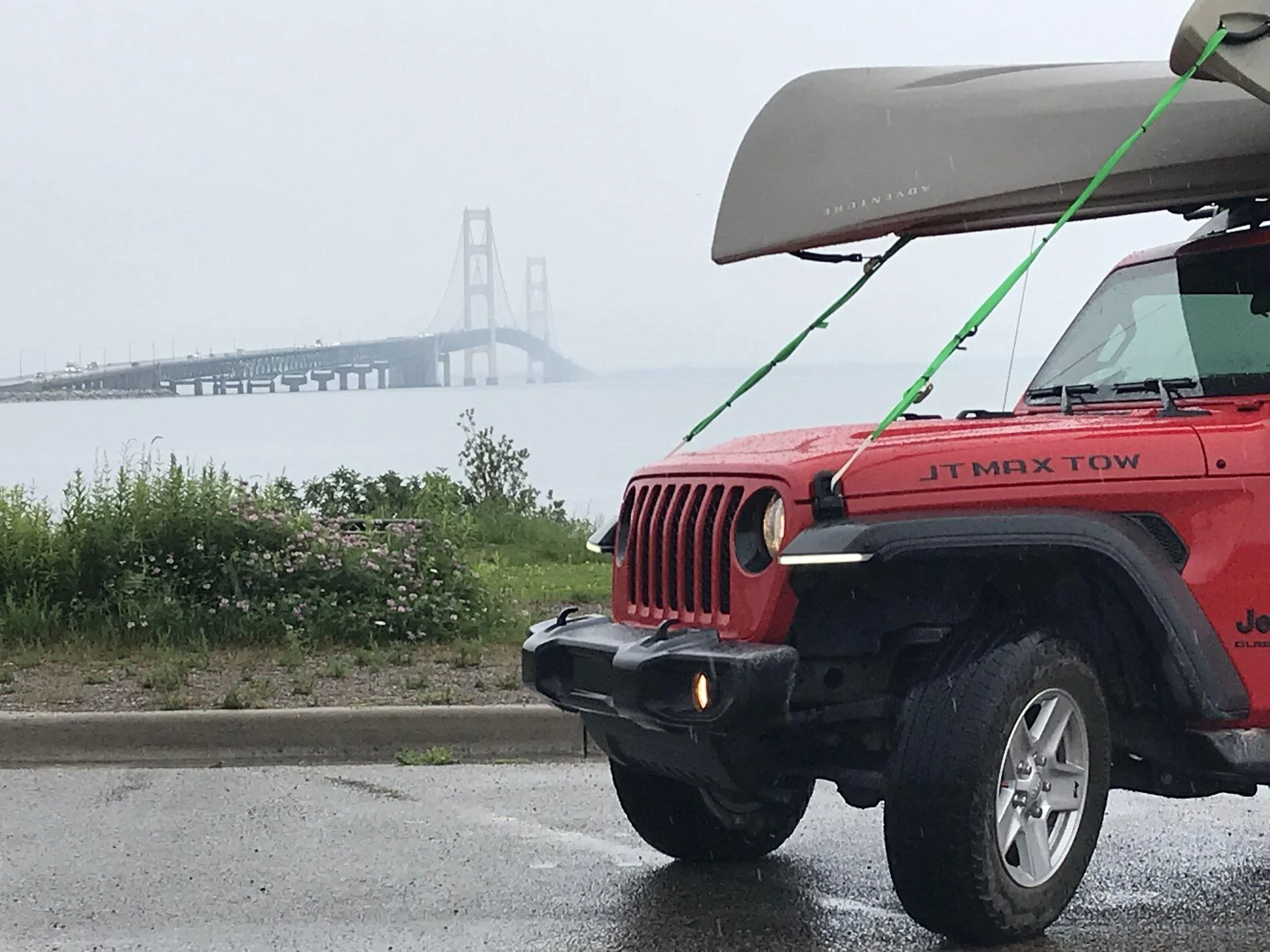

Almost 45,000 miles and love the Pentastar. Just finished a 2000 mile round trip loaded with canoe, fishing kayak , 3 bikes, trailer and dirt bike loaded with all kinds of gear backseat and bed no problem. The JT doesn’t even know the 1500lbs PF trailer fuel and dirt bike are even back there.
With the 8 speed auto, 245x75x17 tires and 4:10 gears there is plenty of power. I maneuvered through lots of traffic, merging and even one windshield saving and potential crash saving maneuver (dump truck full of gravel driver forgot to secure tailgate at 75mph interstate speed and stone was flying all over the place. So were the cars behind him. I was just beside another truck that started to take my lane and I sped up to get out of the way and past dumb ass dump truck). The JT was able to hit 98mph for a a few minutes to get past the mess. This proved how quick this set up is, though had to stop next exit to clean out my under ware and check the load and poor trailer. All was good!
JCR off-road should recognize this place my Jeep is pictured in.
Up in da U.P. eh? St. Ignace side. Last photo.
