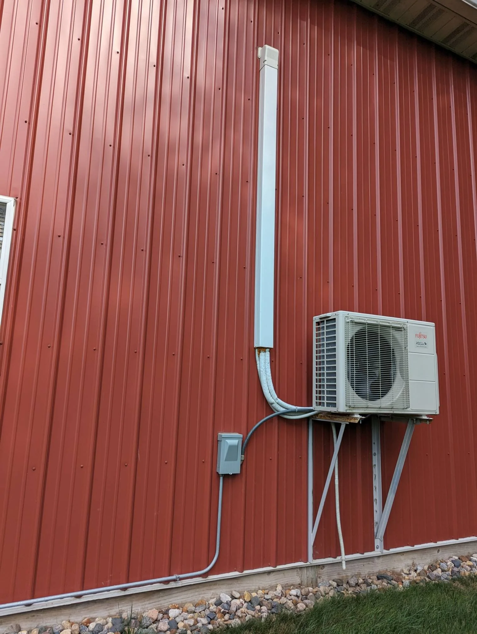

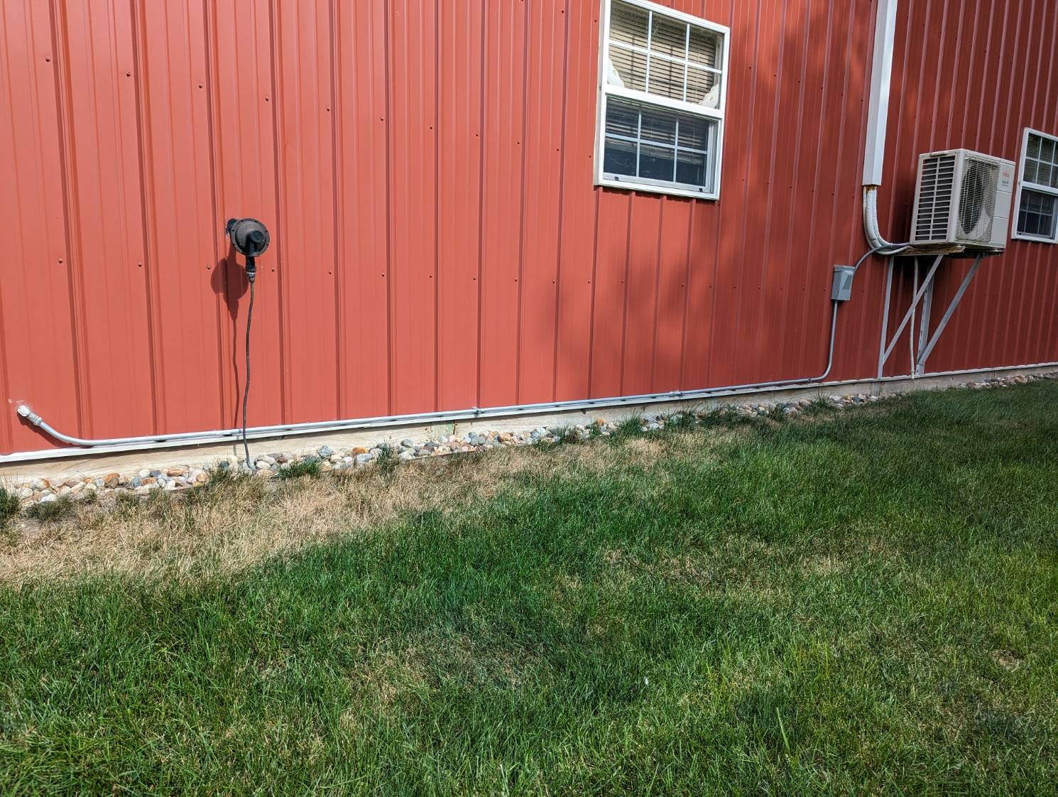

Yeah, the guy who installed the one in my shop was a brilliant young fellow who showed the brackets they supply - then said - you have a lot of room, if you like we can mount them THIS way so they don't stick out.
I said yes and he ran into town and bought some angle iron and more bolts and mounted them different than "instructions" and got it way up off the ground, closer to the building but still plenty of space from the building per specs. I need to repaint the brackets, but 6 years in our weather - ain't bad.

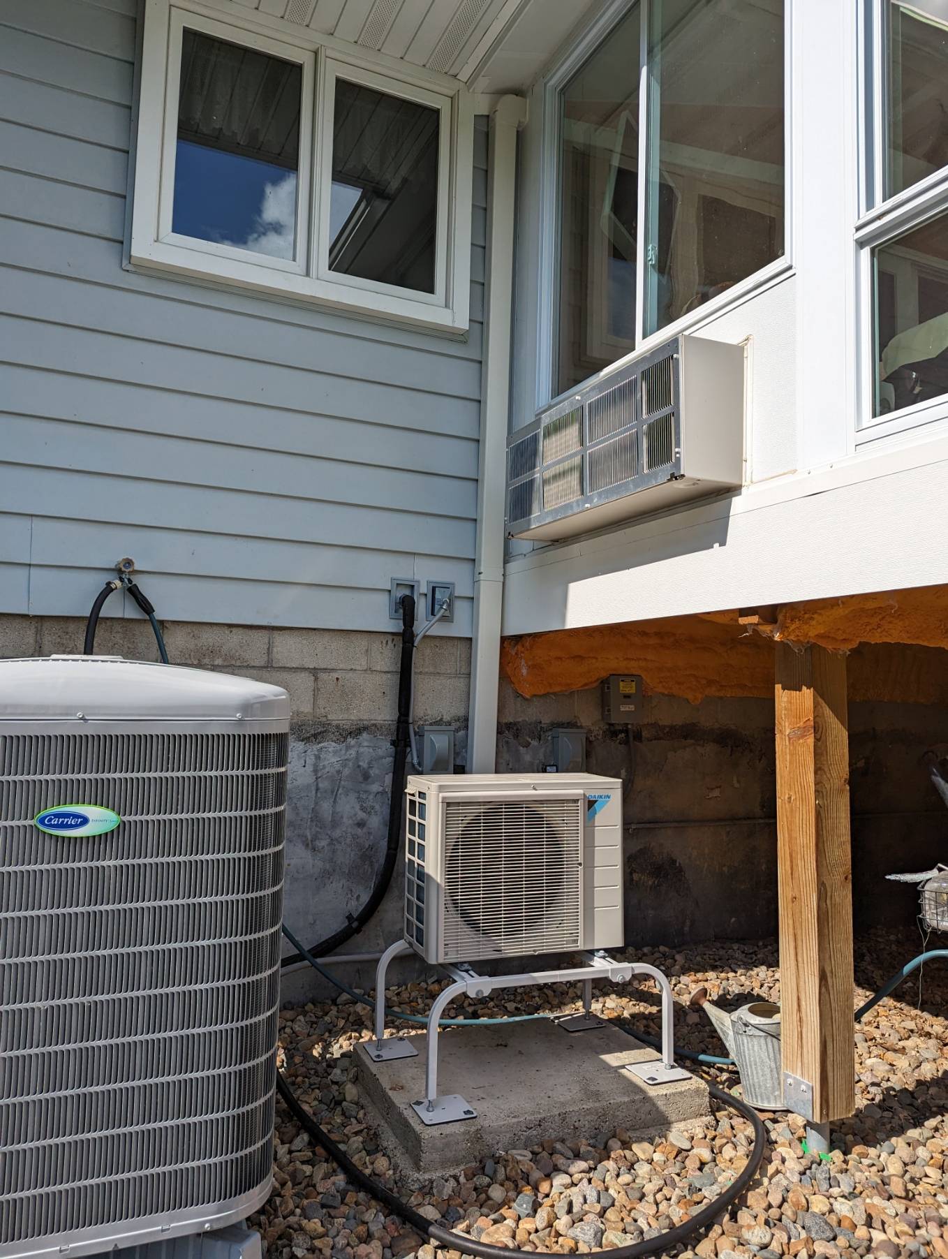

There's a lot of minisplits around here now. They last if they are sized correctly and installed correctly. The problem is that you need someone who is trained and understands them to do it right.
Mine is 6 years old and going strong.
The new one in our sunroom comes with a full 10 year parts and labor warranty (or was it 11 years? I'll have to look!)

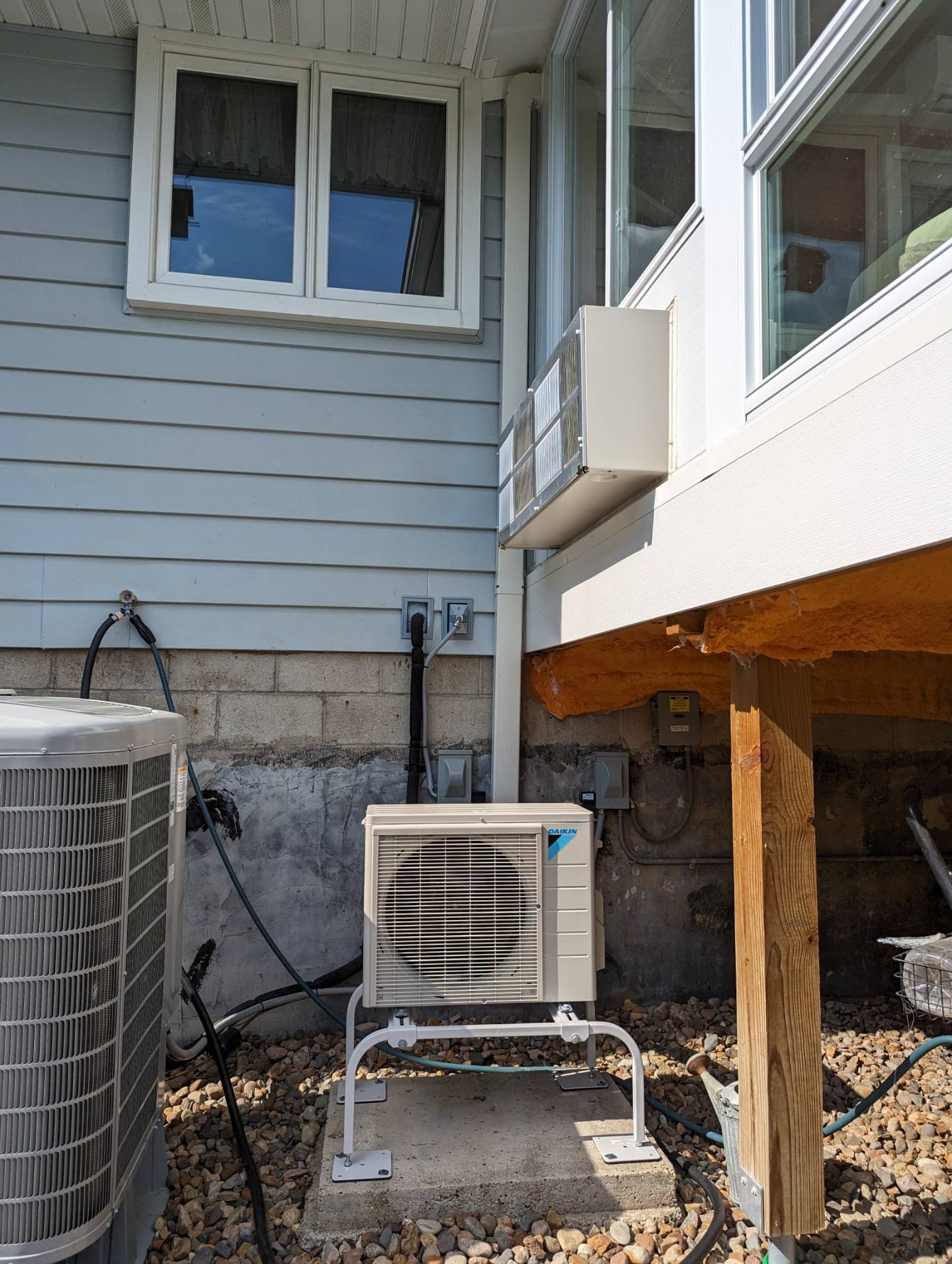

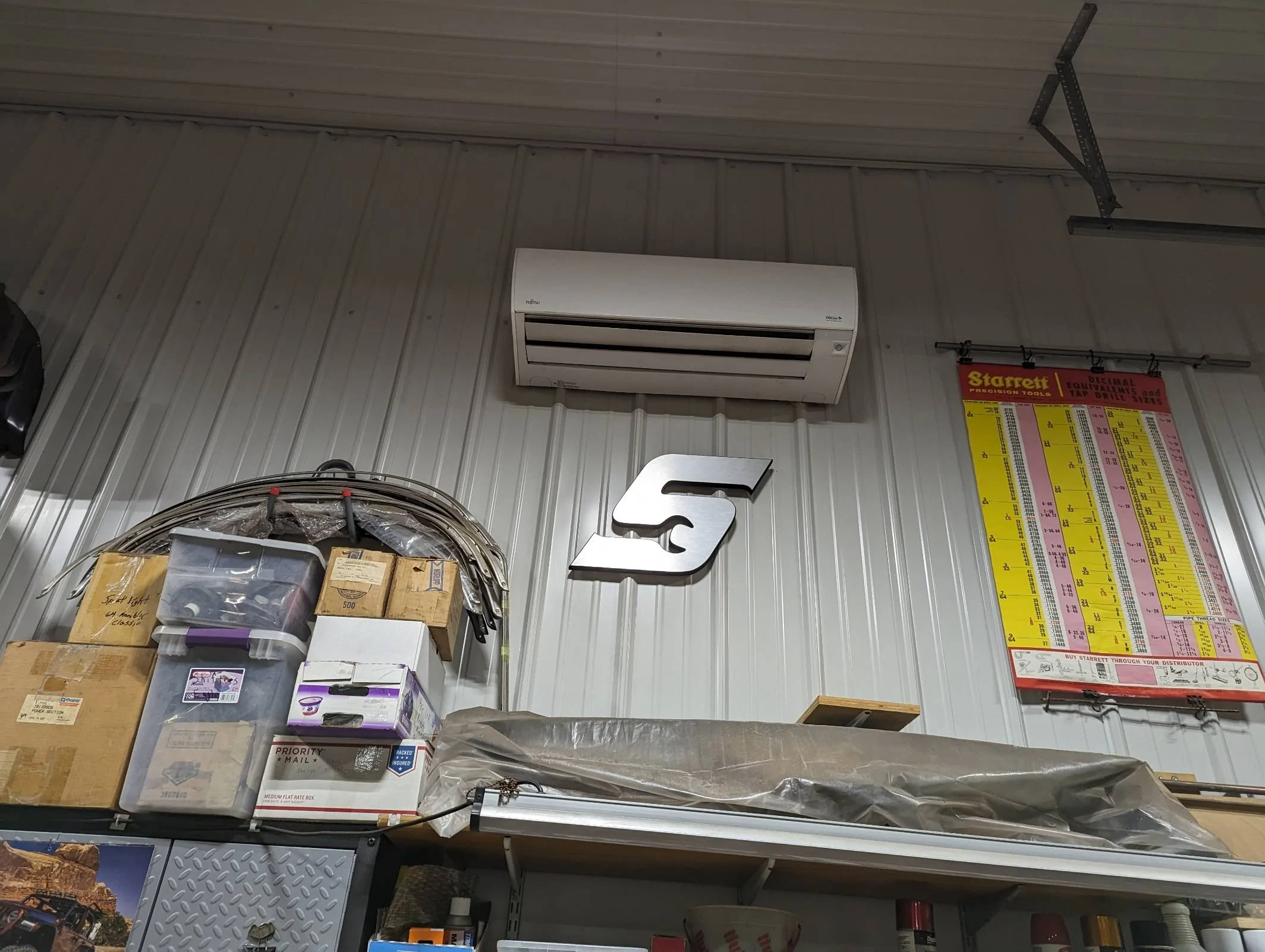

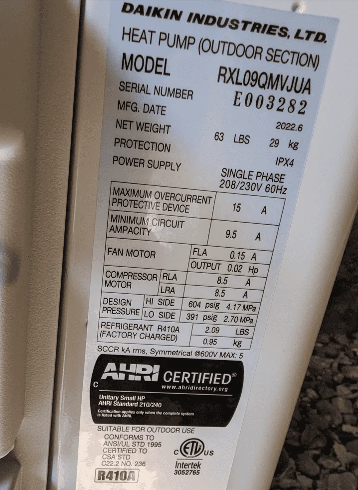

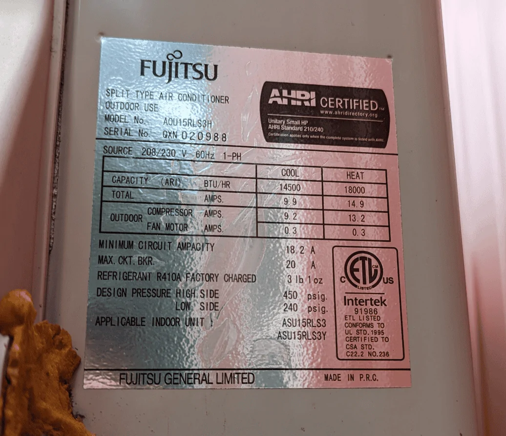

They are the most efficient thing I've ever seen. The shop unit - the Fujitsu, is running on a 20 amp 220 circuit.
The house unit is running on a 15 amp 220.
I wired them both, using 12 gauge.

The ceiling in my shop is 15' high.
Shop is 30' x 36'

This is the house unit - look at how low the current use is on this thing - very low amperage, IMO.

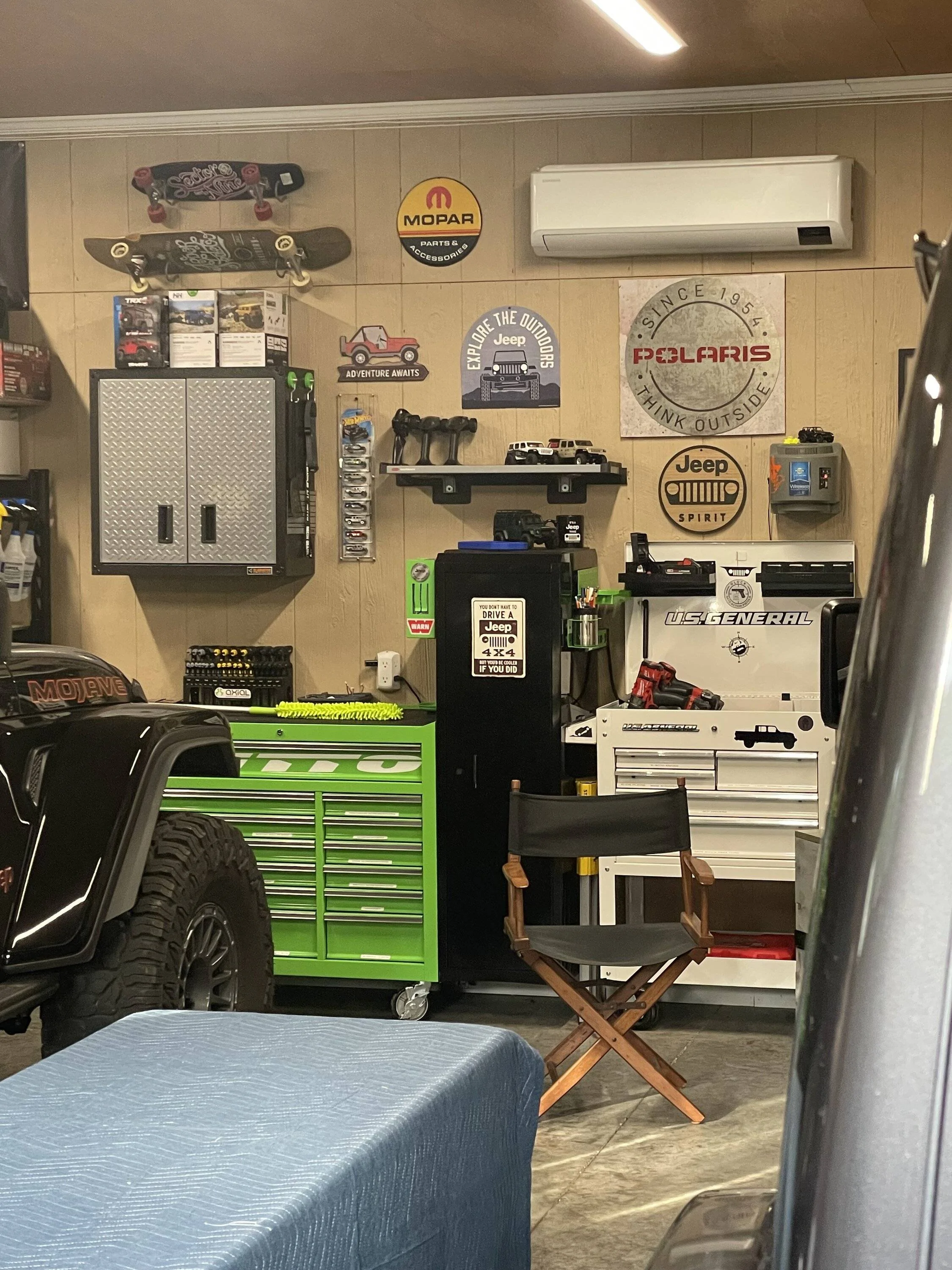

My separate garage is 30x30. A few years ago my best friend friend and I were modding a 2014 JKU I bought as a project in the dead of winter. I had gone out to buy a propane Dewalt heater the night we were installing some MCE Fenders. I was still wearing a heavy jacket and he looked at me and said “ you know if you call **** he can install a mini split for 5k ish” we called that night and within in 3 days it was installed and I’ve been in comfort whenever needed. This is in Tennessee. Some of the best money I’ve ever spent on my household.
I’ve got a Samsung but not sure of size
