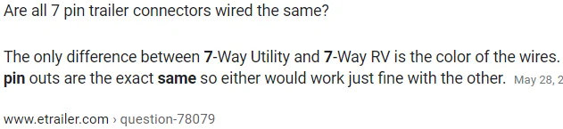

Don't know where you got that info, but for years, the pinout has been the same. Now maybe you found a pic of the "outlet" on the truck vs. the plug on the trailer itself. I see some post one, while others post the other. Otherwise, they are the same, they must be otherwise you could very easily FRY something. There's no way you could have the same exact plug with different wire destinations without some damage.
There's one standard. According to etrailer, the difference is wire color, but FUNCTION is the same.

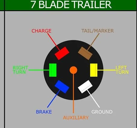

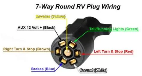

Where I got it is doing what you suggested. Here are two examples.
Jeep Gladiator WHO READS OWNERS MANUALS? i GOTS TO KNOW 1
Jeep Gladiator WHO READS OWNERS MANUALS? i GOTS TO KNOW 2b
Not only are some assignments different, but so are some colors.

Those are all identical, so I'm not sure what you're saying. All trailers and all vehicles with the 7-way round connector are fully compatible. All trailers with the 4-way flat are compatible with all vehicles that have that. They are always the same, and pretty sure they always have been.
Auxiliary is the same as reverse? Red same as yellow? etc.

The colors are meaningless, and yes, aux and reverse are the same. Have you ever had to rewire a trailer just to connect it to any vehicle? I've towed a lot of things with a lot of other things, and never had to.
No need to continue. My only point was that the images with nomenclature and colors you find online are not all the same. To a neophyte, this can be confusing.
