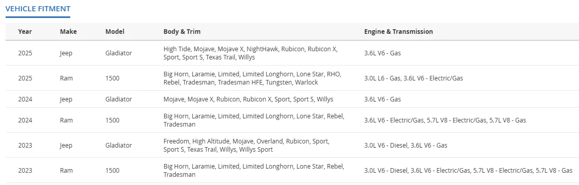

I finally found one of the threads from way back that references the rear UCA and LCAs xref to a ram 1500 too. So maybe they saved some cash there, and then just used a lighter duty axle with similar pick up points.
That is correct the rear uppers and lowers are the same as Ram parts.
Jeep Gladiator Why do we have larger diameter rotors IN THE REAR? Gladiator and Ram rear lowers
JT1
Nov 13, 2020
745
722
Oklahoma
2021 Gladiator Willys
Good find!
So that explains the funky rear geometry we see. They just slapped that on an M220 and called it a day.
