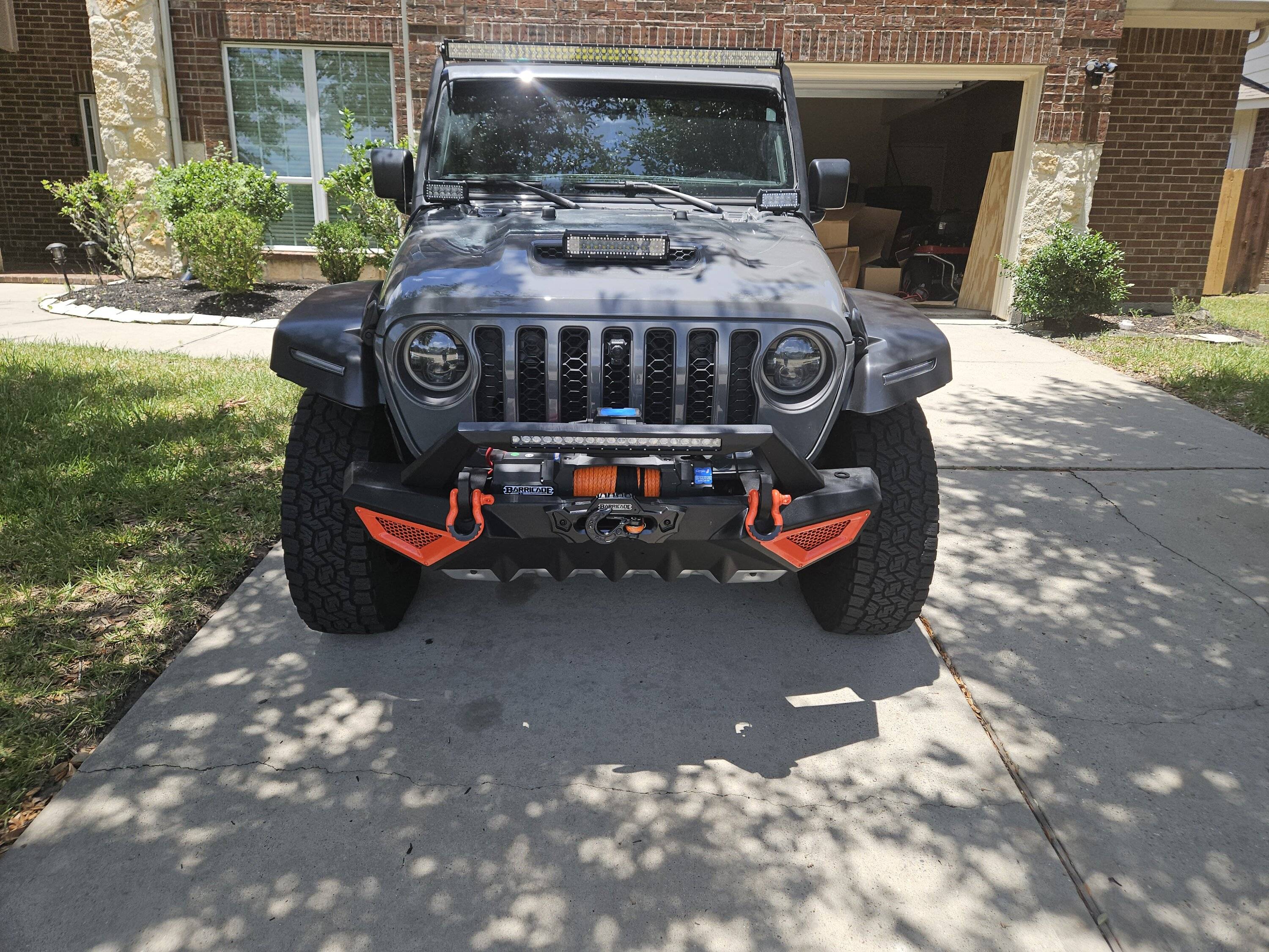

If I was a serious off-roader and rock climber, I would have gone with the Rubi. However, the Mojave is built for my purposes... beach wheeling, fast daily driving, some light towing and hunting. The suspension is fabulous as is the extra lift that you get from the factory; I have seen 37s on an unlifted Mojave. But the real reason you go with the Mojave... that ORANGE man!!!!
Jeep Gladiator Why Mojave? 20230713_132151
