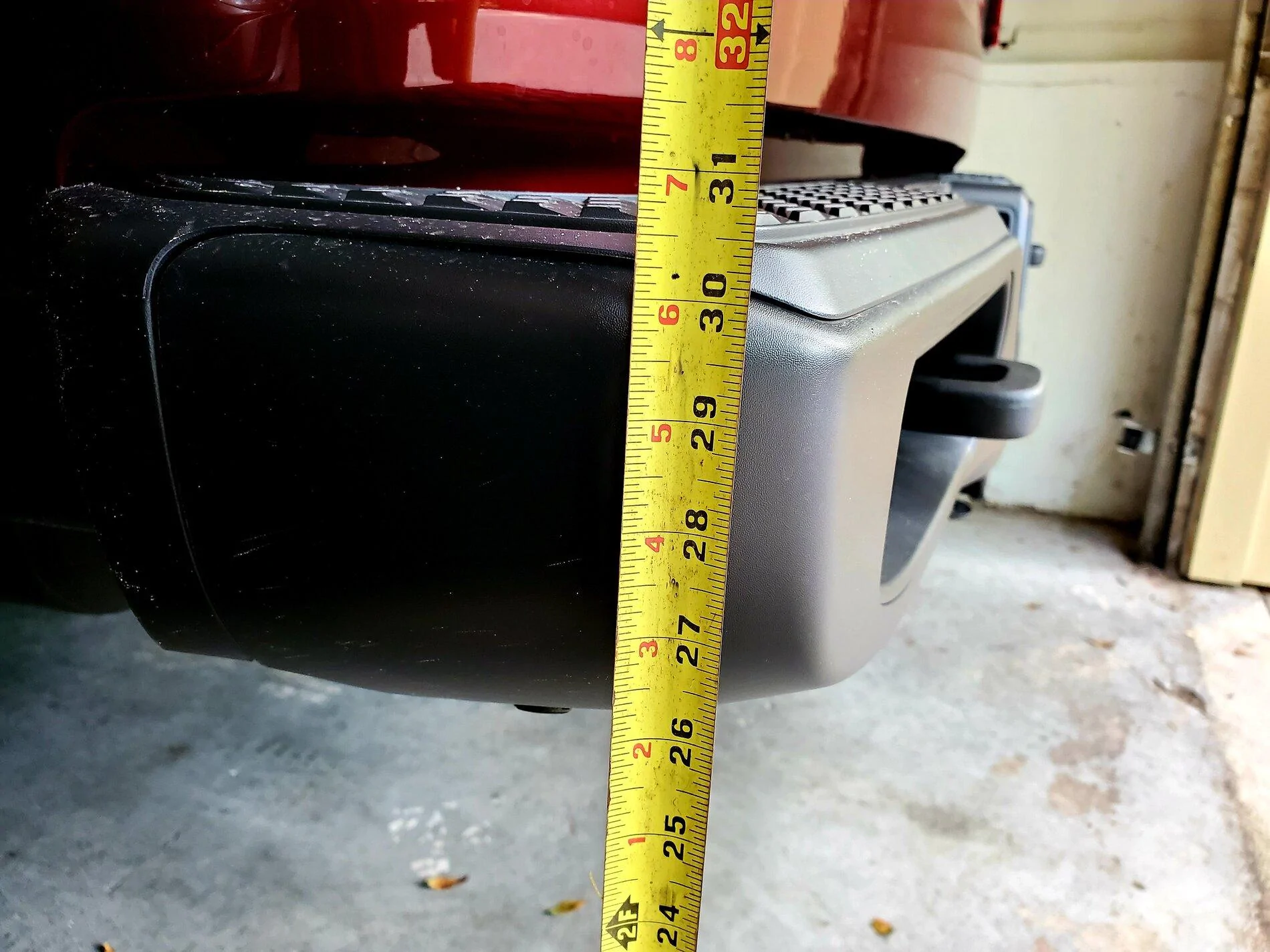

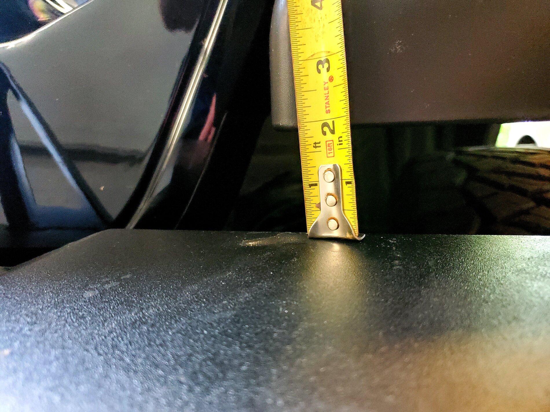

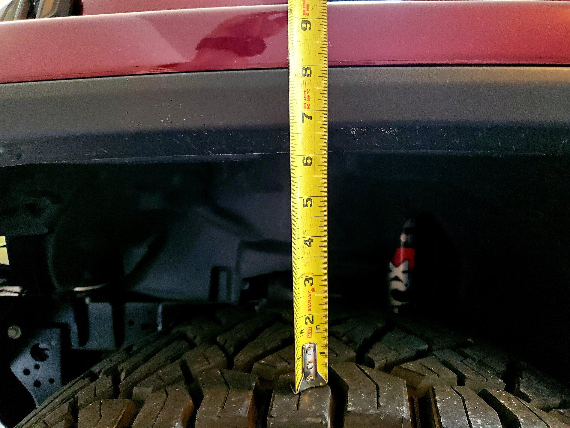

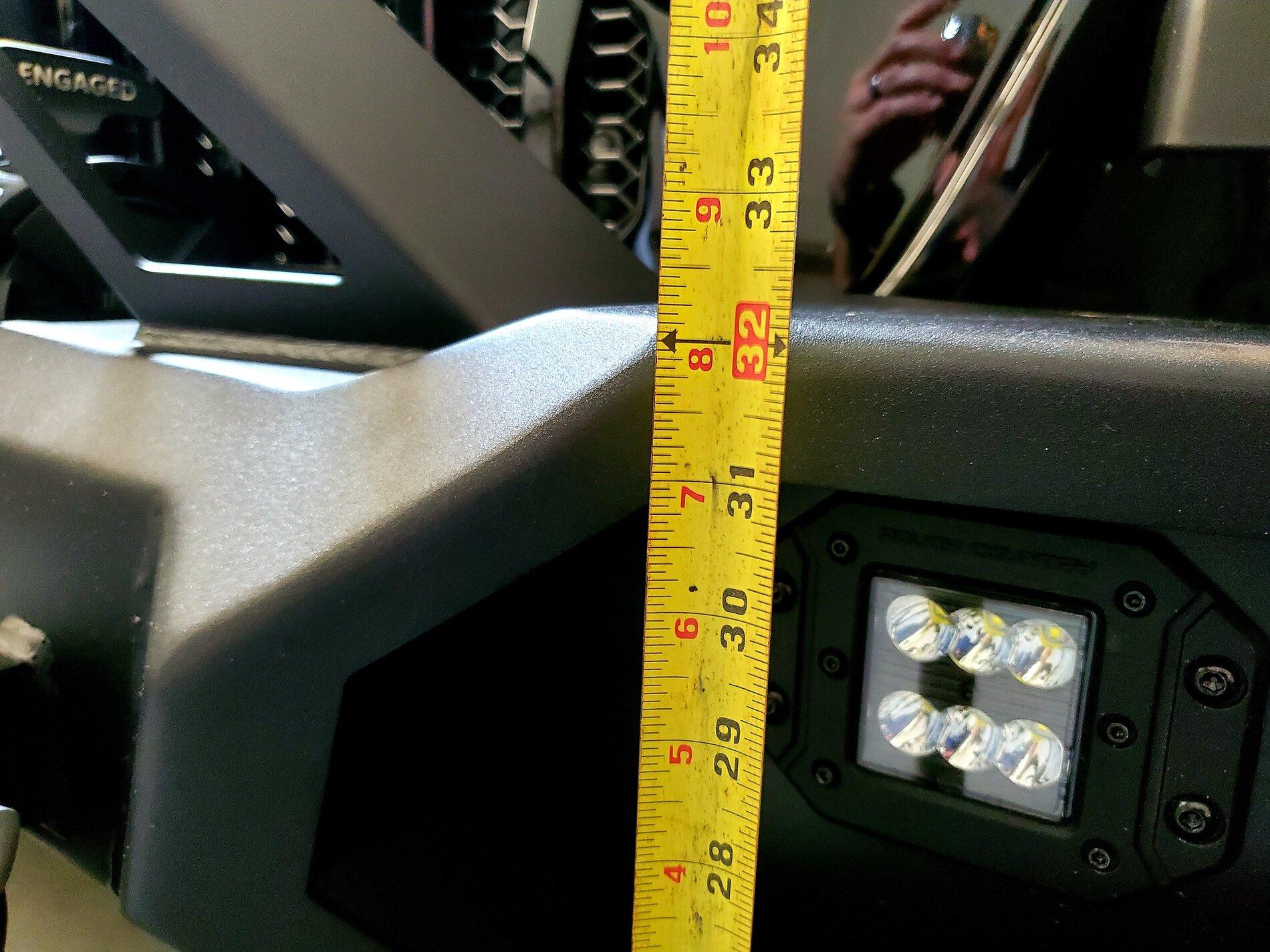

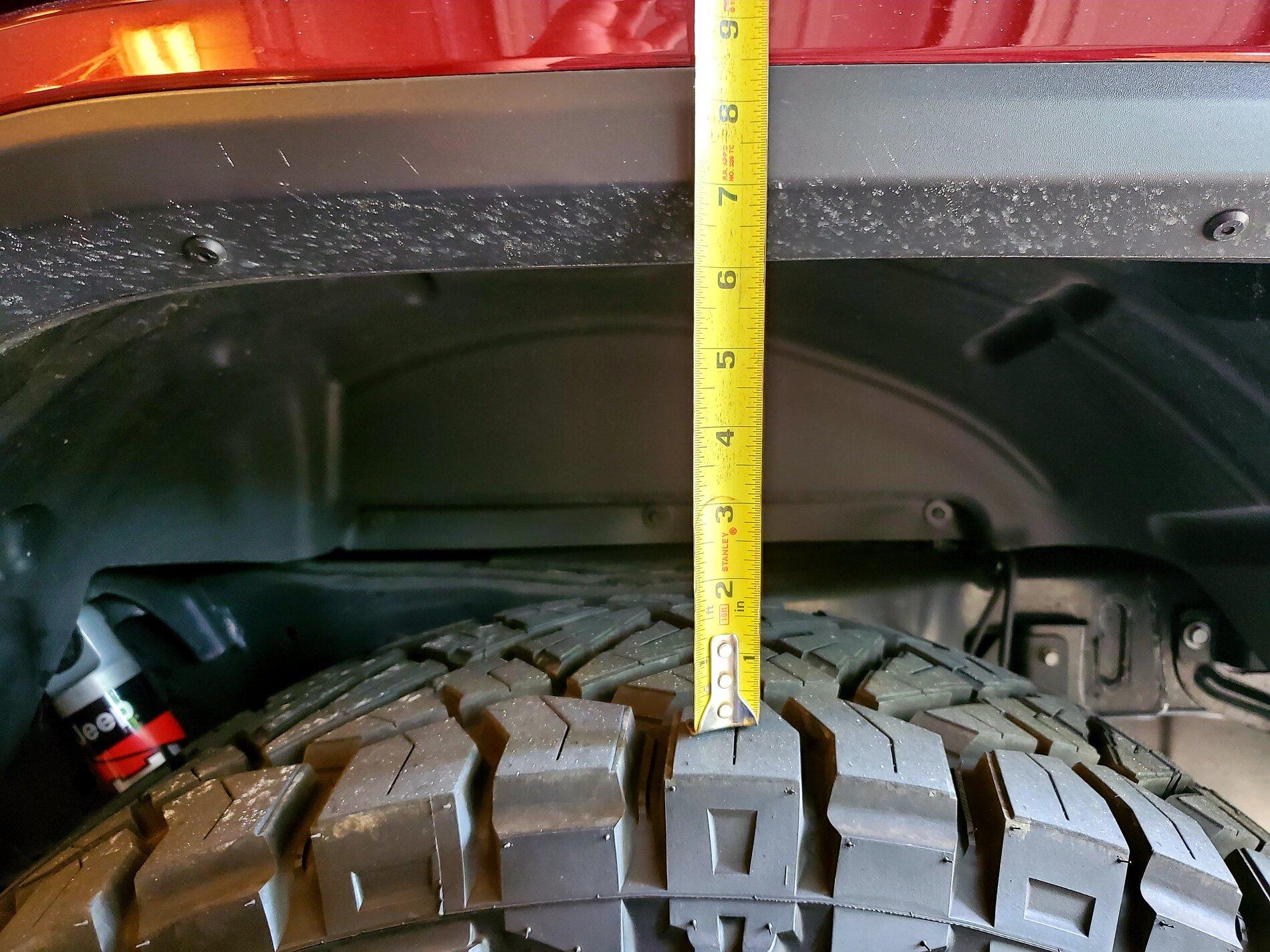

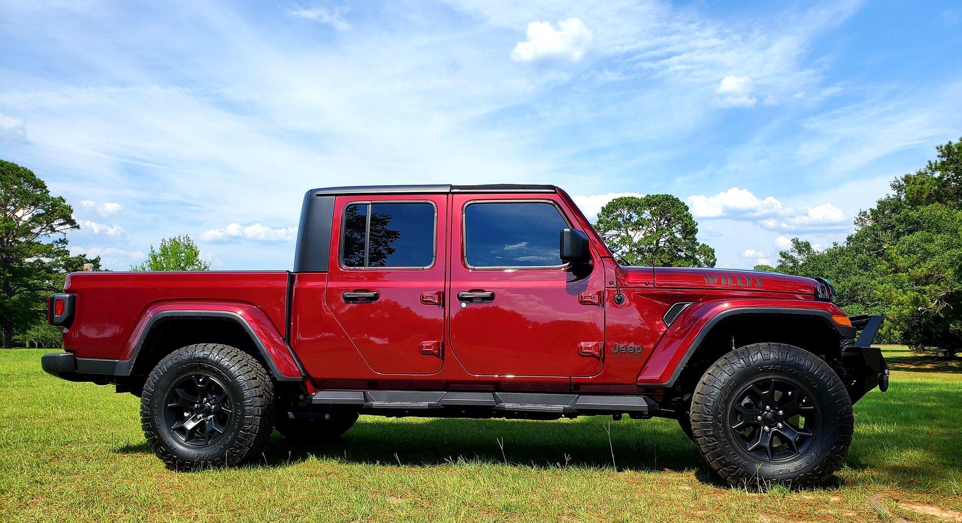

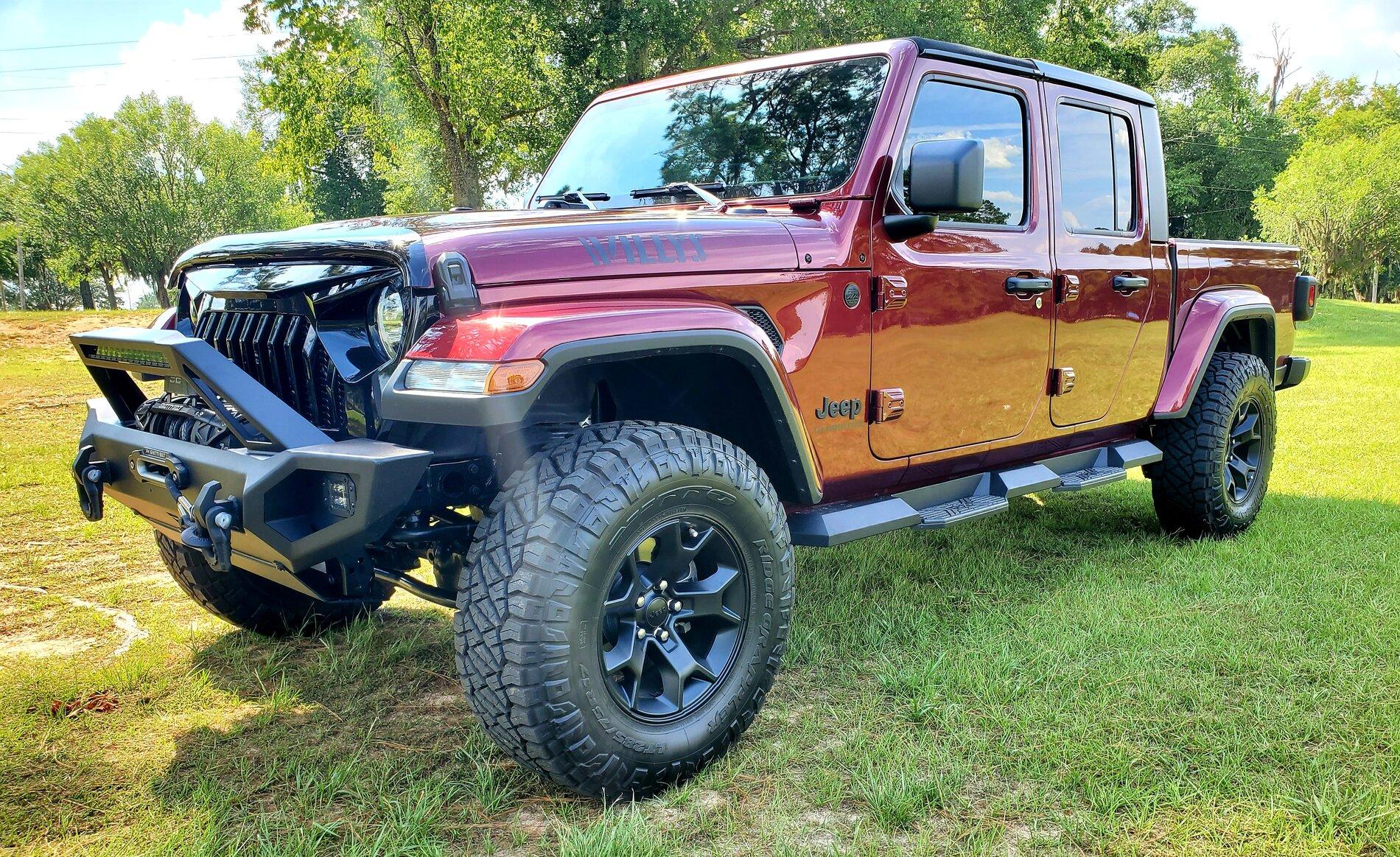

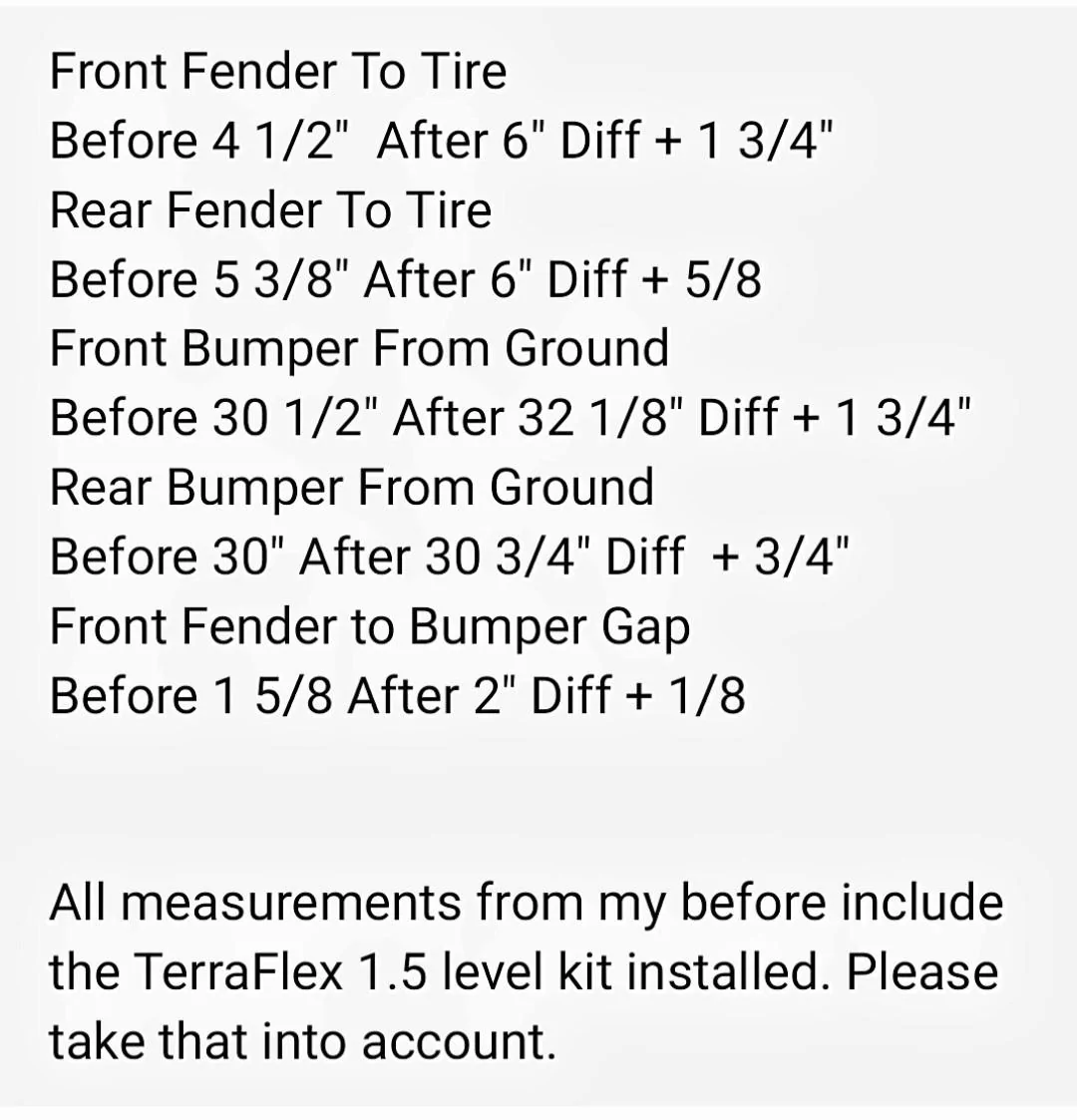

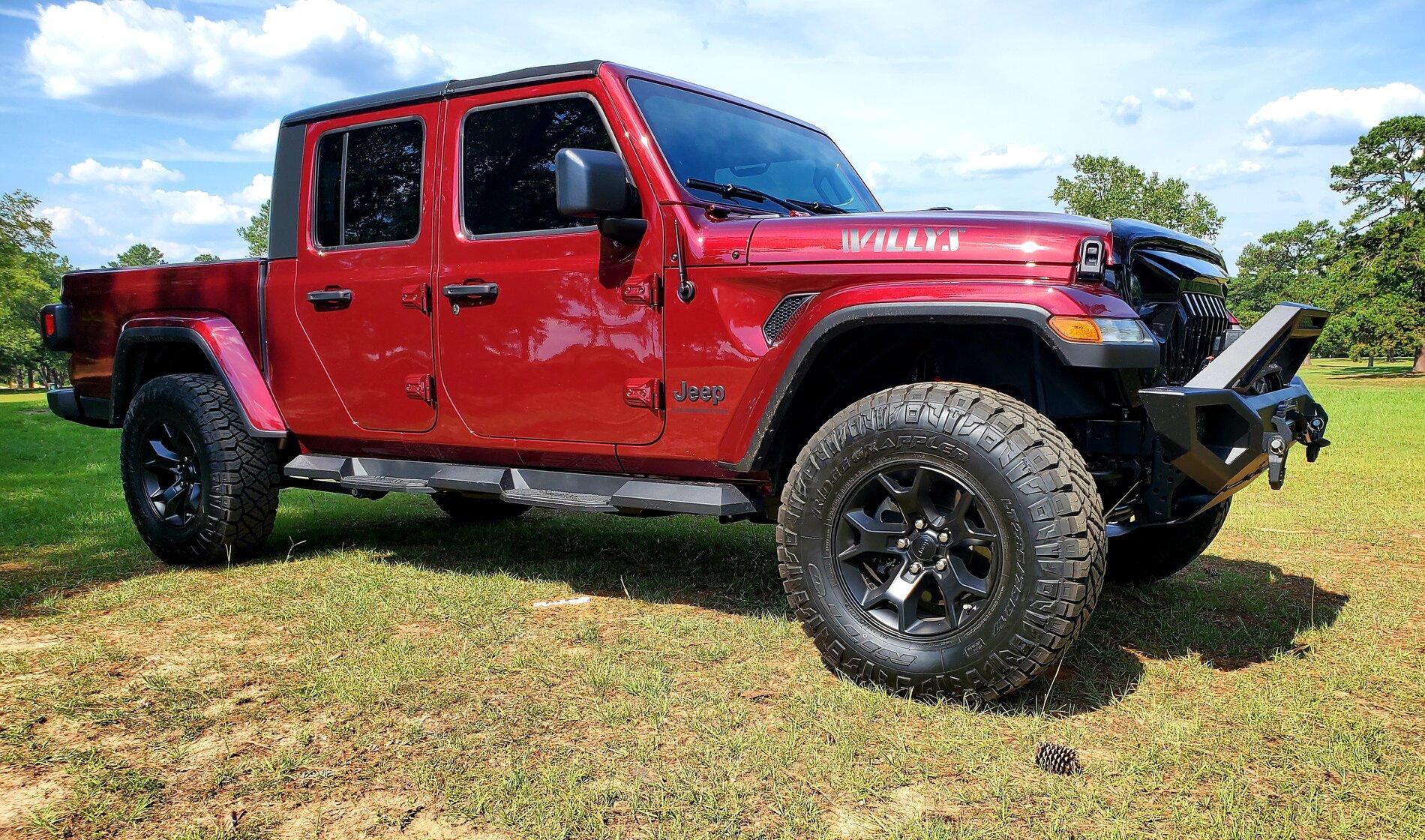

In case anyone is interested in up grading or changing to the Rubicon Eco Diesel Take off suspension here is my experience and measurements. My before and after measurements include the following. Before: added 1.5 TerraFlex level and RC Steel Bumper and Smitty Bilt Xrc winch. After: Installed 1.5 with Eco suspension and up graded to Adjustable Front and Rear Trac bars Tier 3 (Core 4X4) to further keep things properly aligned I also installed the RockJock driveshaft carrier bearing drop kit. On the Willys you will not need the sway bar end links ront or rear they are identical. You also don't need to change out the lower control arms they are the exact same part number. This setup is very nice. Firms up the JT. Feels more planted in the curves and less bouncy over broken pavement or rough dirt roads at speed. I drove it for about an hr after install on all types of terrain then took my measurements in my level garage and in the exact same spot from my before measurements. I also have my before and after tape measurement photos if anyone needs to see them. I included the after pic's.

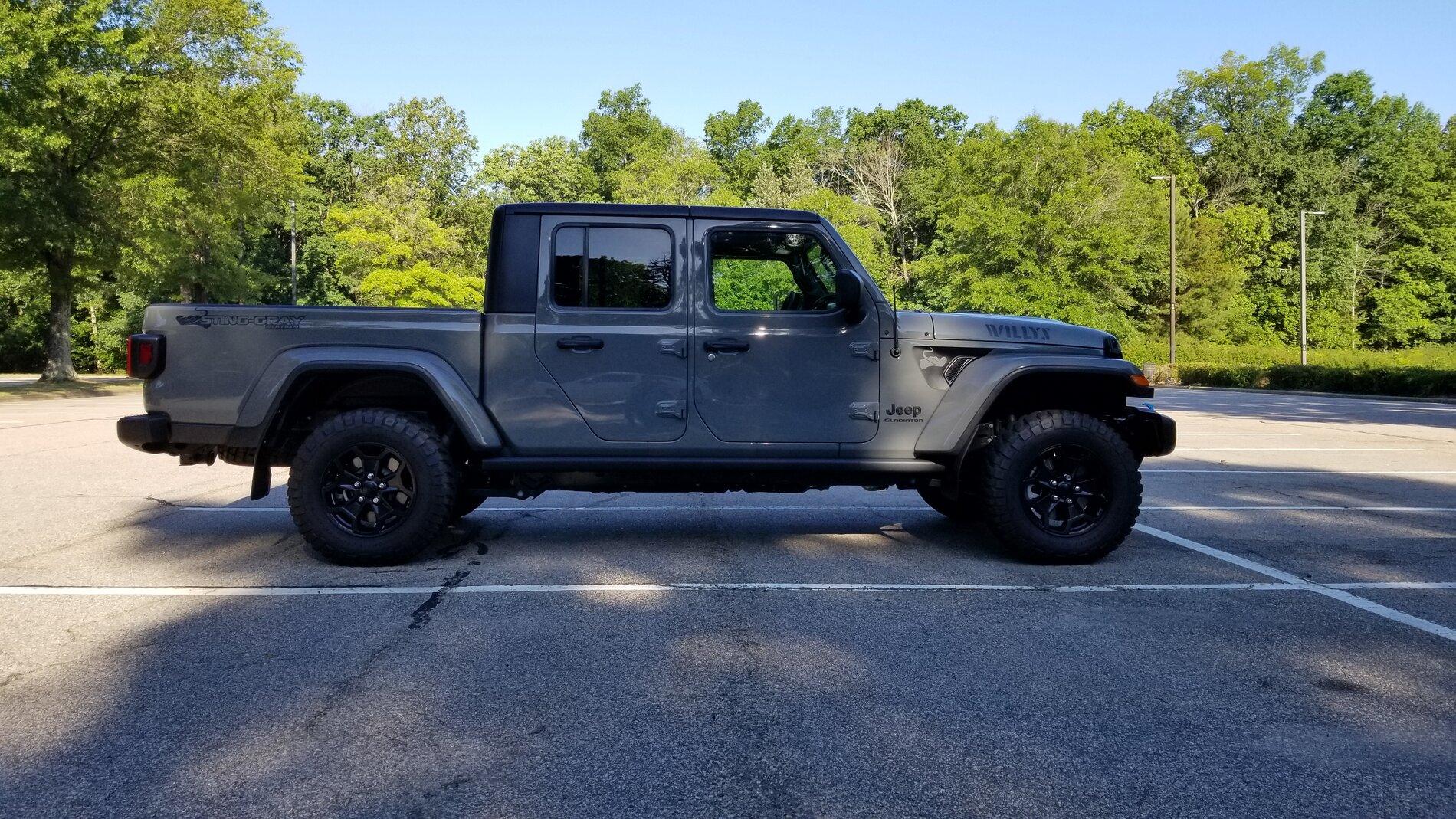

I noticed I had one wheel off the driveway and lower, so today I parked on some flat, level asphalt at work, and was shocked at the difference. From the ground to the rock-rails the front is still 1/2 in lower (8.75" vs 9.25" IIRC), the fender openings from the ground are exactly the same (37.75" IIRC). So I guess the RC is just about as perfect as you could want, shout out to ROUGH COUNTRY!
PS. She's getting some summer wheels and tires later today!
