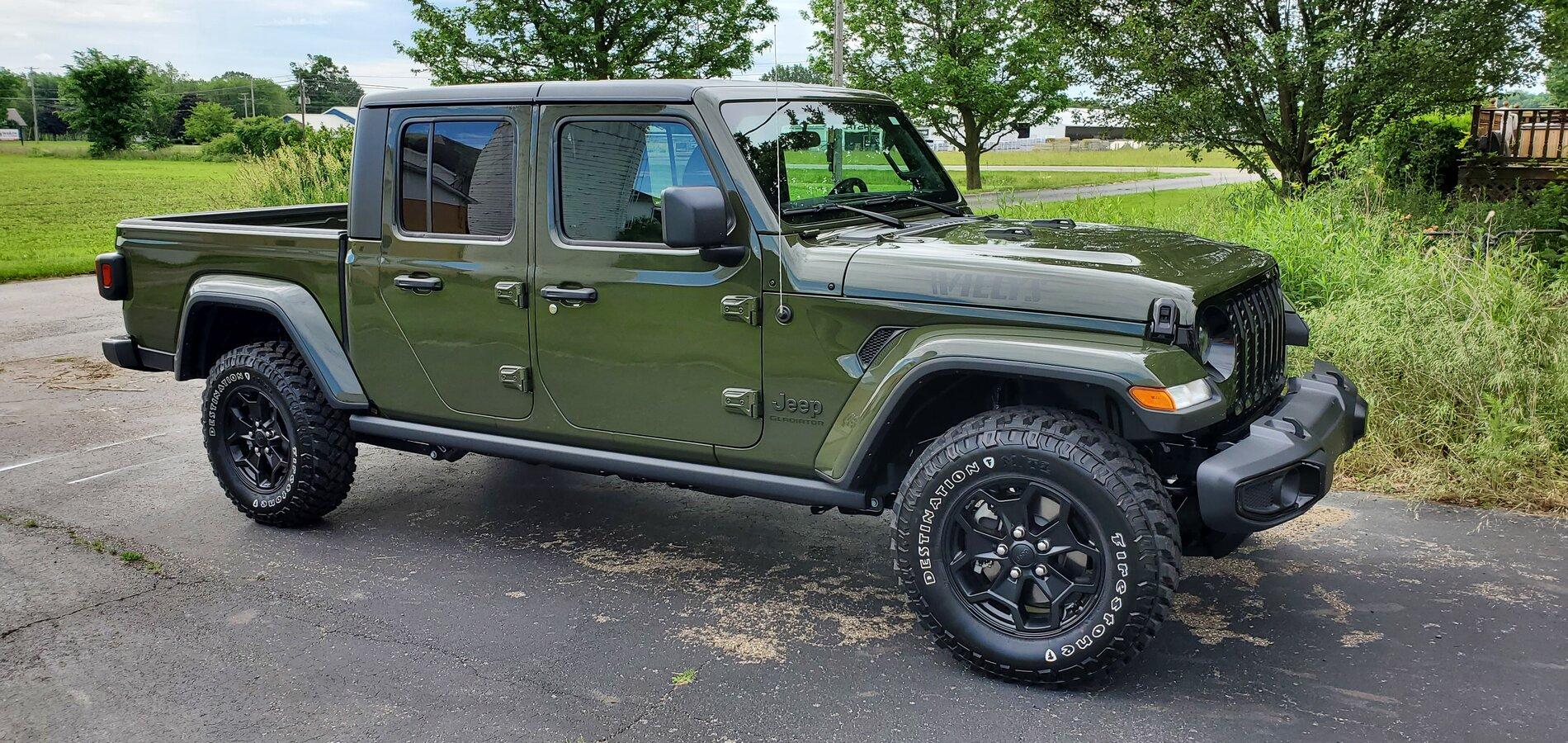

Here's a thread for the Willys edition of the Gladiator that's coming out next Model Year!
I hit a deer driving my taco off road. The damage to the front wasn't bad (radiator, and radiator supports), but all the airbags deployed. They told me the '15 off road had to toss both front seats to replace the airbags. This added thousands to the bill and insurance totalled it. I needed a mid-sized truck to handle the fireroads and slipped roads in the hills of West Virginia. Reviews rated this the best off roading option. I didn't know Jack about Jeeps other than their reputation.
During the test drive I drove it over some parking lot curbs. The front end of my taco would bottom out when I'd do this: The Willys never came close. I got a good feeling.
I called my gear-head friend for his opinion and found out he absolutely loves these things. In the winter we sometimes get lots of snow, and these things shouldn't have any issues.
This is the morning after I drove her home.
But I couldn't leave her this way, so I tested it out on the farm. In fact, I took two trips to the field with my daughter, and a co-worker.
It drove like a dream. My 2WD F150 would struggle a bit, and my taco off road would bottom out. This one seemed bored. The trail of mud it left in the driveway, and road was impressive.
I think this is the beginning of a beautiful friendship. Now I need to find a brush guard.
Any recommendations would be greatly appreciated. I'm brand new to the whole Jeep culture thing. It's still quite surreal.

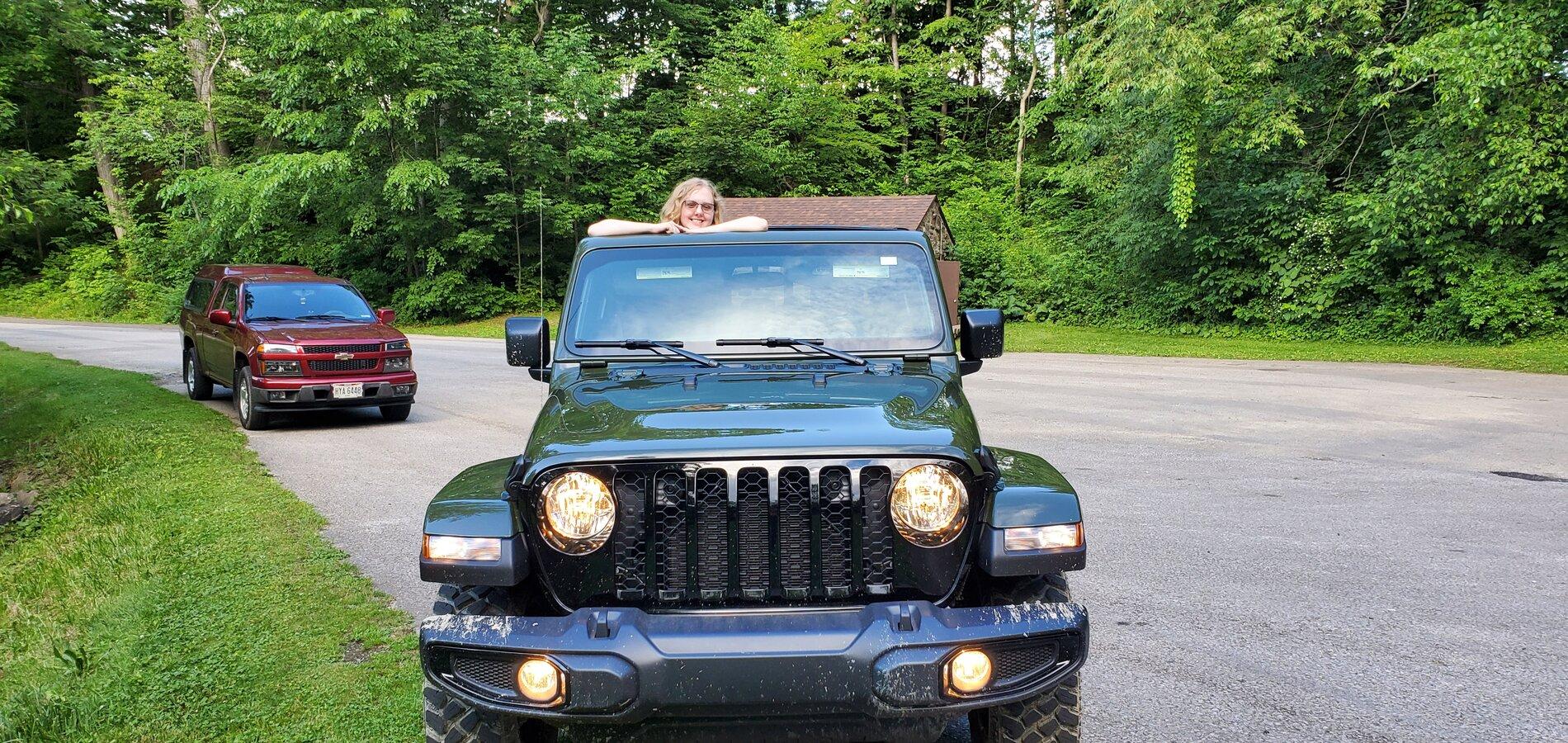

My youngest daughter let me know that she's already a Jeep girl. I mentioned the removable tops, and she popped it right off.

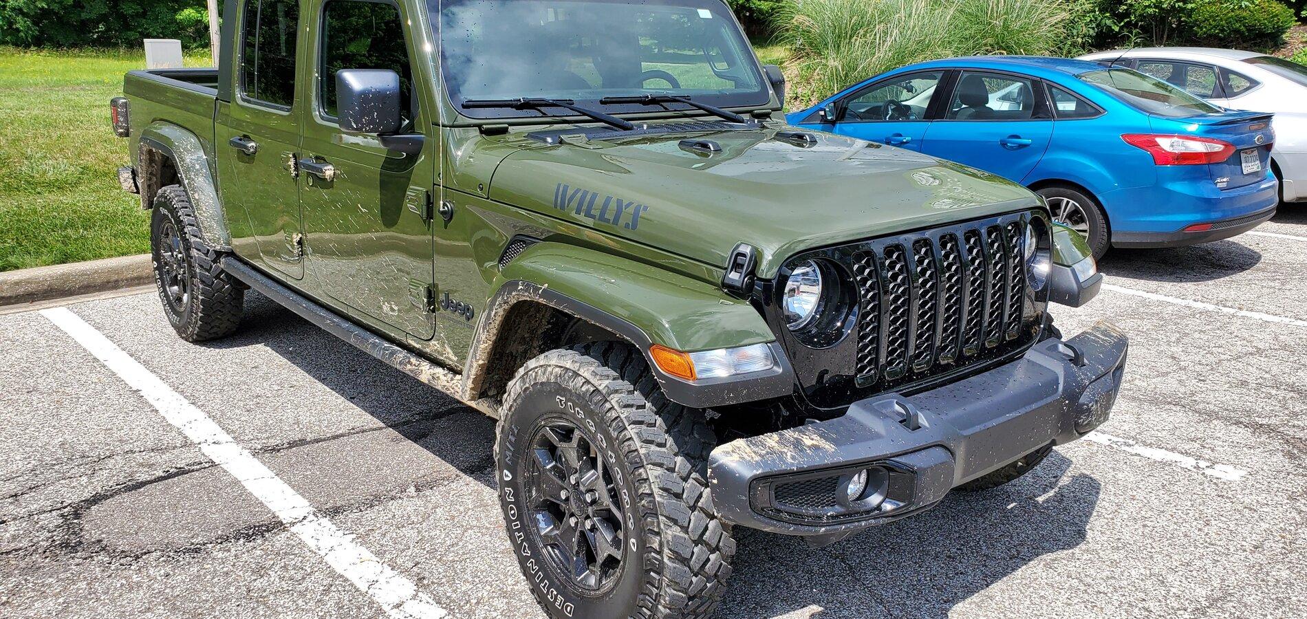

Hi All,
New Willys Owner, first time Jeep owner. I absolutely love it. I do have a question. If I wanted to do a simple leveling kit and some 33 or 35 inch tires on the stock wheels. Whats the best setup? Wheel spacers? Thanks!

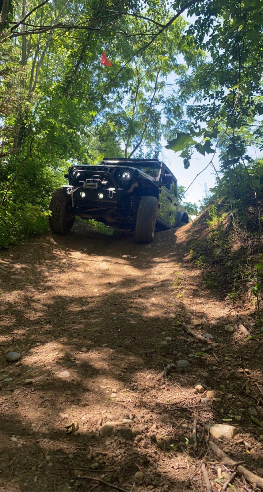

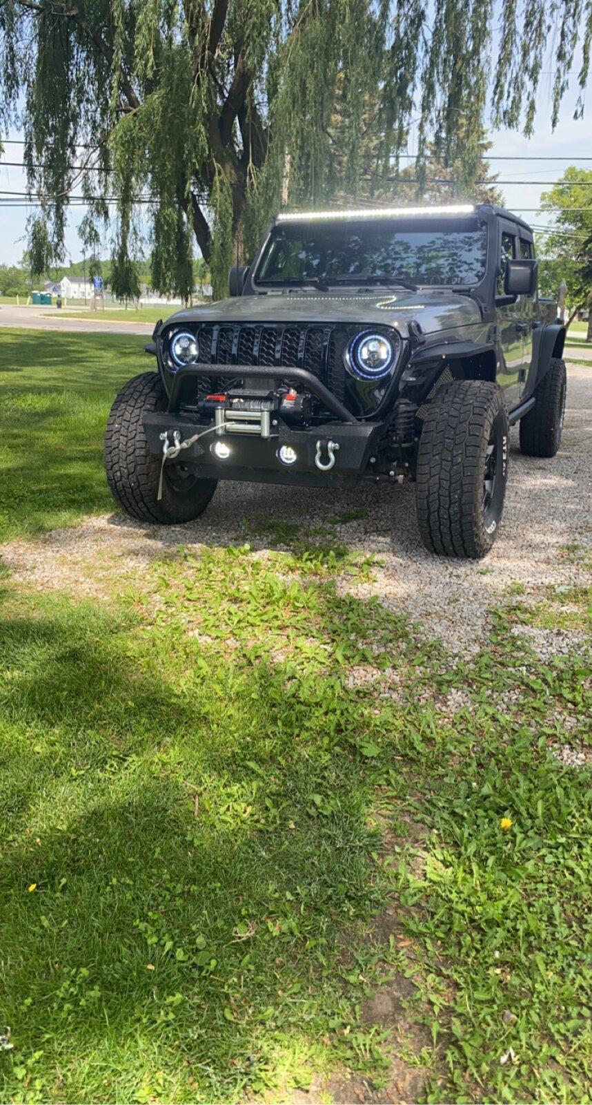

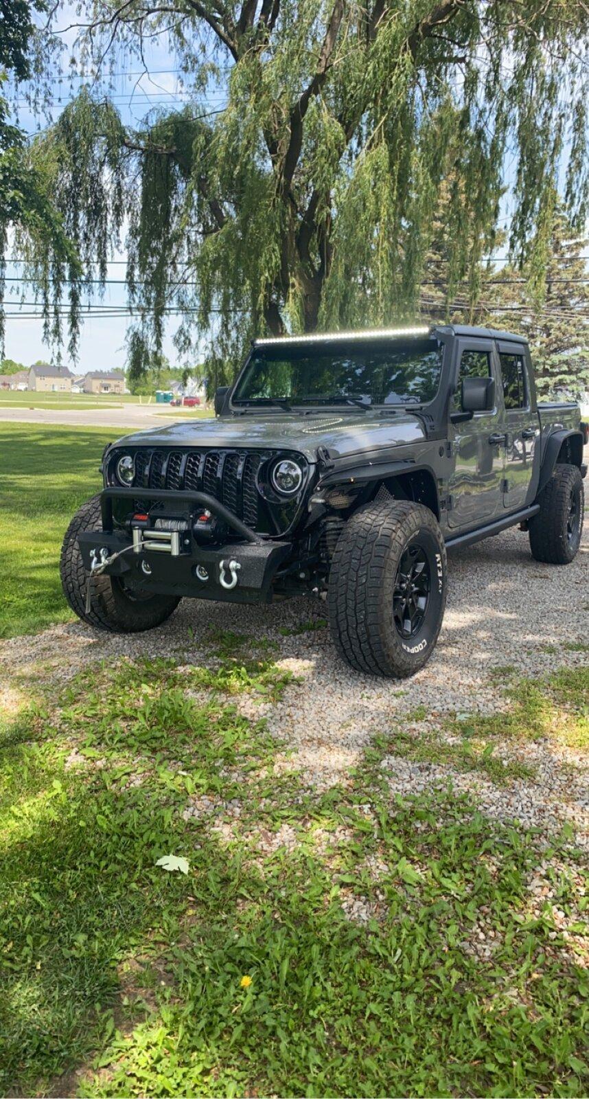

2021 gladiator willys
34.5 inch copper at3 xlt
3.5 inch rough country lift (springs&shocks)
50 inch rough country a pillar mount light bar
Dv8 front and rear slim fender flares
Dv8 inner fenders front
Red rock stubby front bumper
Rough country 9500 lb winch
Z automotive mini tuner
Fox steering stabilizer
Lange coyote off road mirrors
23 inch stubby antenna
Rugged ridge window vents
Sill guards
Drop in bed liner
Gator folding tonneau cover
1.75 inch wheel spacers
RGB halo led headlights and fog lights
Rock lights

Set up is all preference and what kind of stance you’d like it to have when it’s all said and done. On stock suspension I went to 34.5x12.5 cooper at3 and put on 1.75 inch wheels spacers to prevent rubbing. I’m still running stock wheels as well. I accidentally ordered a 2.5 inch leveling kit from rough country and never used it. still have it if you would be interested in it. I ended up going with 3.5 inch rough country suspension kit and love it.

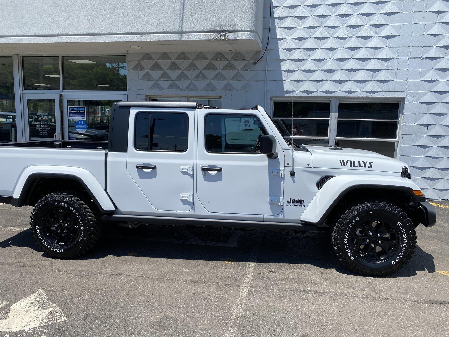

Hi All,

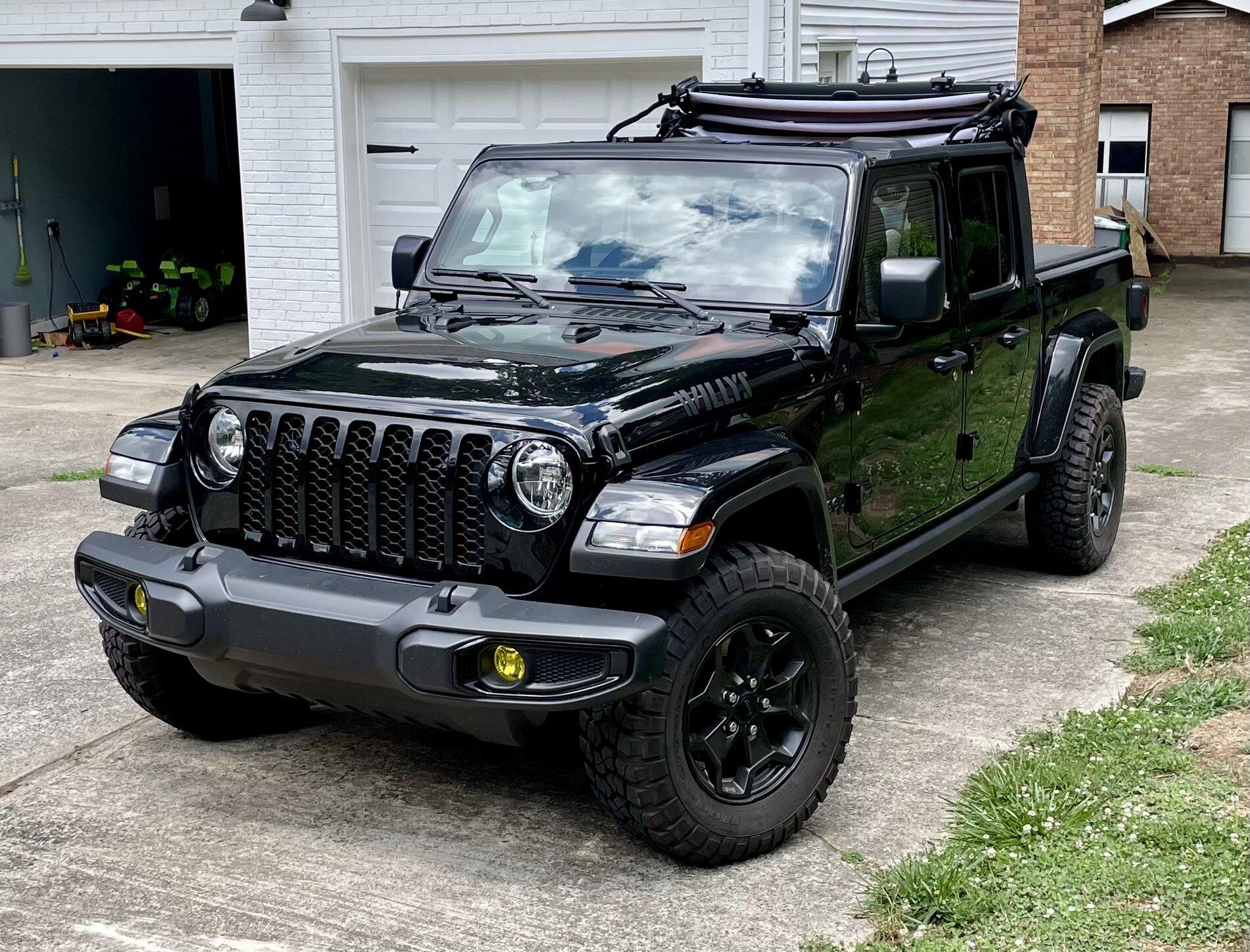

You can fit both 33s and 35s with no level kit. On 35s you won't have much space if you are off-roading. So if that is a concern you may want to do a level kit.
Here is mine with the stock suspension on 33s and stock wheels

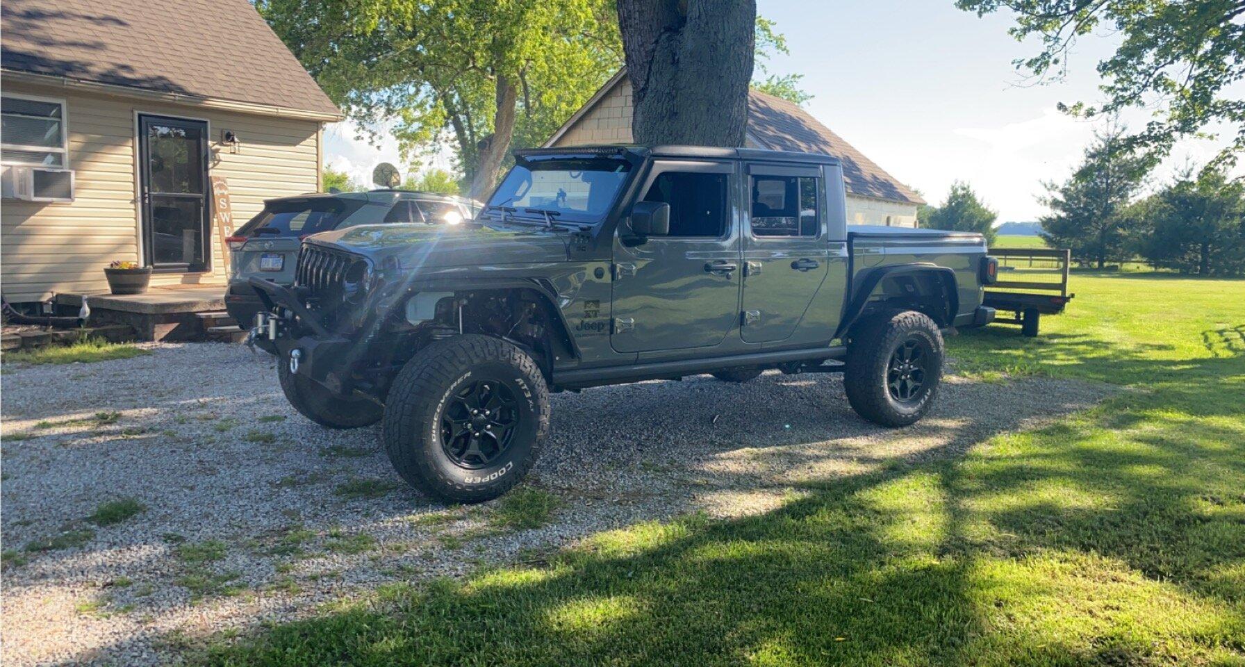

Here is 33s with stock wheels, Rubicon front springs and max tow rear springs.
