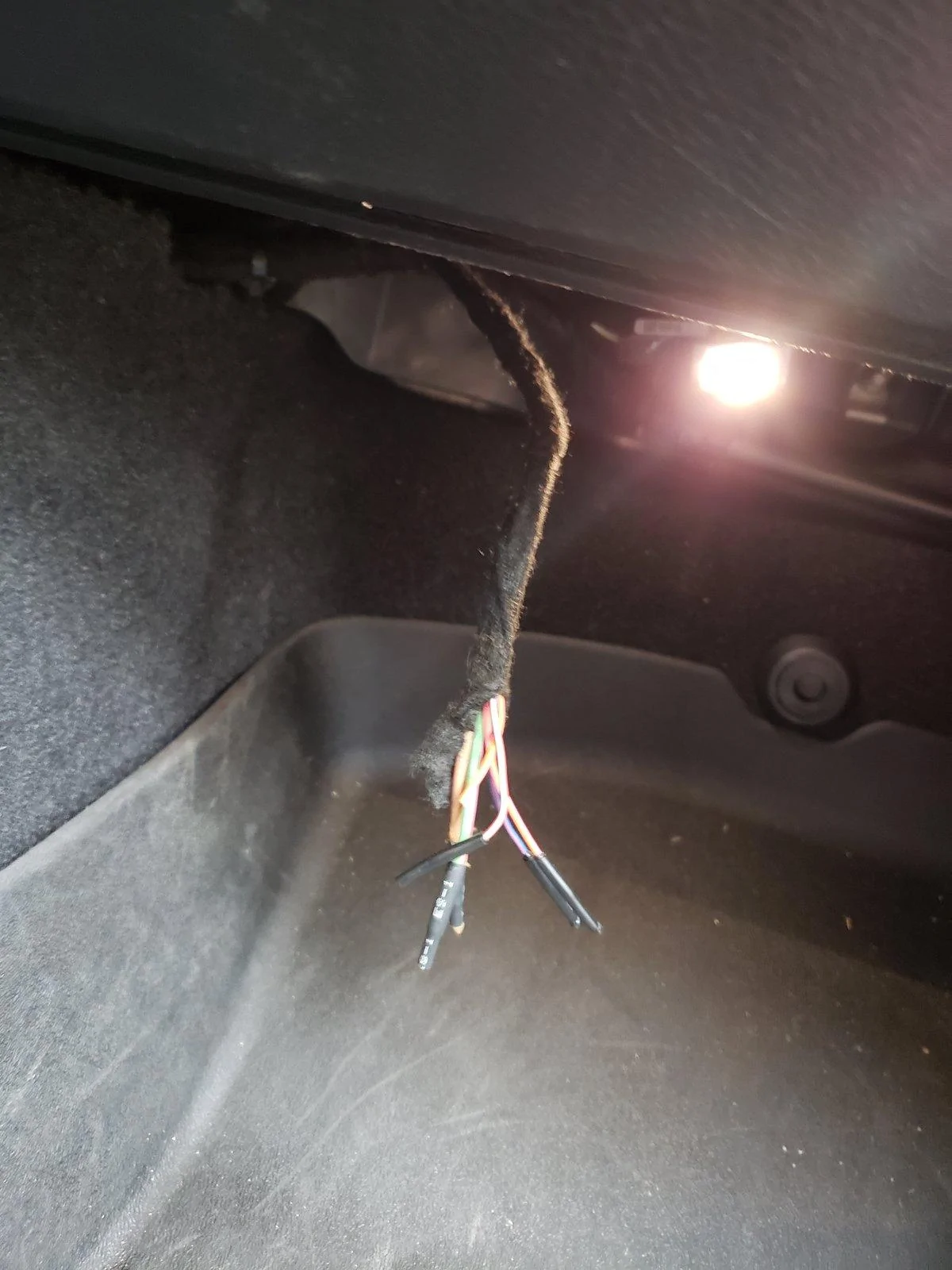

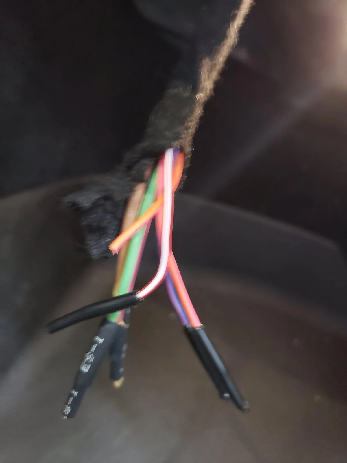

Anybody have an idea where these wires go? Just notice them hanging down under the glove box up by the fire wall.

Those would go to your auxiliary switches if you had them.
The other end is under the hood, behind the battery all taped up in a wad.

No lights yet, so I can just tuck them in back under the dash?

I do have 4 aux switches, Thanks for the heads up

There should be six total. One is always hot, one is switched with the ignition, and four for the AUX switches, of which there is a parallel set next to the battery. It's okay to tuck them back under the dash. Just make sure none of the wire ends are exposed.

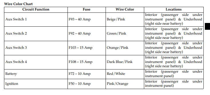

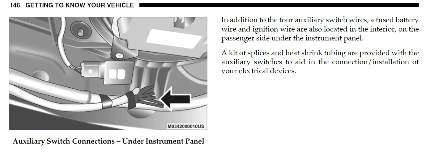

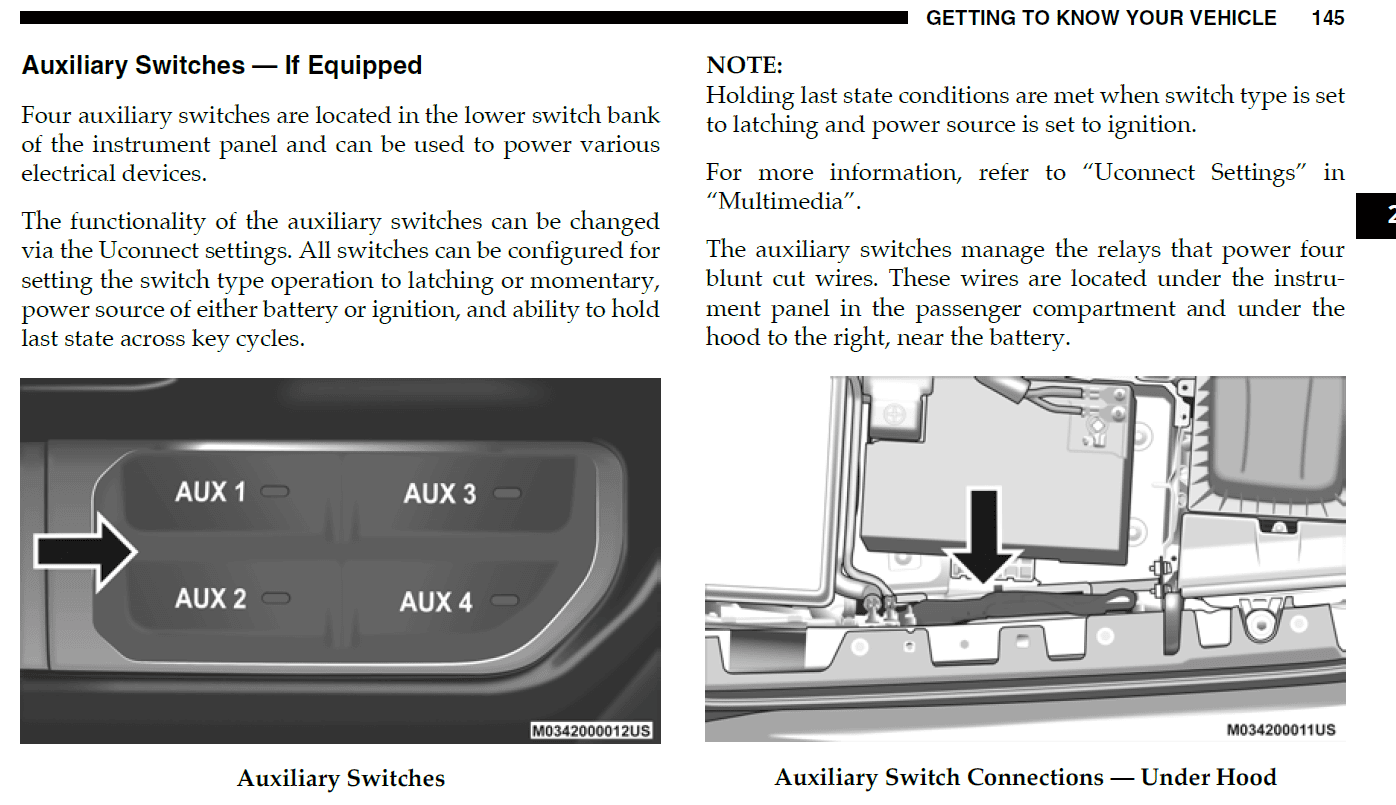

All the details.. a bit surprised leads were unwrapped if you bought your JT new. Mine were wrapped so tight and attached to another set of wires they were hard to find.
