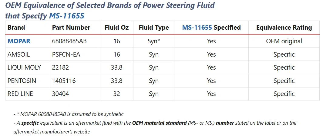

So what did he put in that makes you think it’s not compatible?
Well, she said "regular power steering fluid". To me that means probably old style mineral oil based stuff, or ATF based, neither of which is compatible with the synthetic stuff used in our electric pumps.

Whatever fluid he used must say it meets MS-11655 specifications. There are a handful of non-mopar brands that do, but they certainly are not "regular power steering fluid". These are the ones I know of:
Jeep Gladiator Wrong power steering fluid top off 1771703770351-bm
