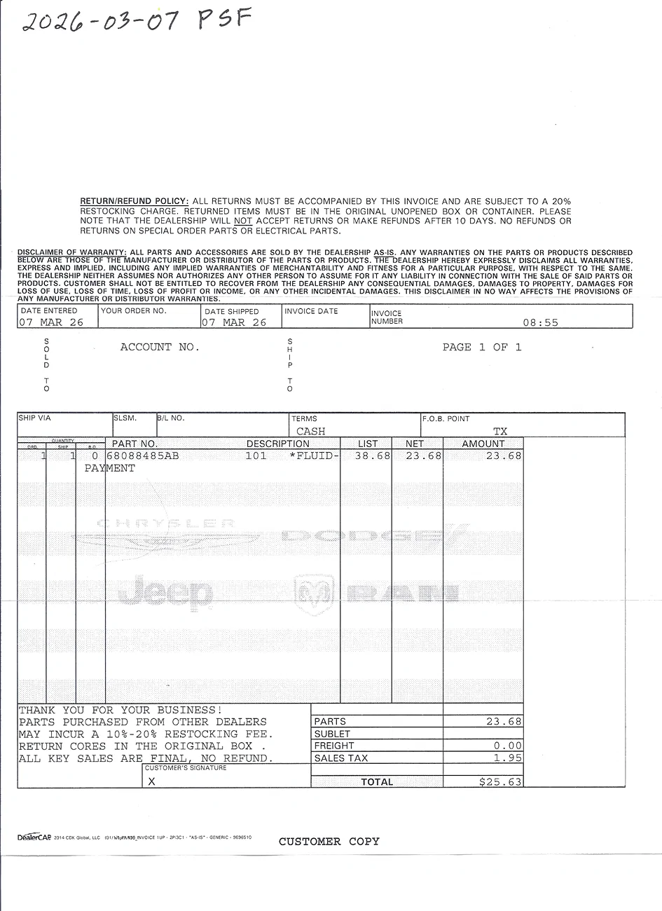

Yes, the correct MOPAR part is 68088485AB ELECTRIC STEERING PUMP FLUID.
Either one of two material standards, MS-11655 or MS.90030, may appear on the label.
Material standard number MS-11655 is on the bottle sold by a Jeep dealer, found in the MOPAR Chemical Catalog (2024), and commonly referenced by aftermarket brands.
On a bottle sold by Amazon ($29.91), it is MS.90030. This material standard number is not listed in the Chemical Catalog.
The price from a Jeep parts advisor can be lower ($23.68, se
e attachment below), especially if you provide your customer number.
For more details, see section 1.2 in Power Steering Fluid Options for Jeep Gladiator.
I don't know why the material standard number is different.
Jeep Gladiator Power Steering Fluid Level 00104 - MOPAR 68088485AB ELECTRIC STEERING PUMP FLUID - 2026-03-07
