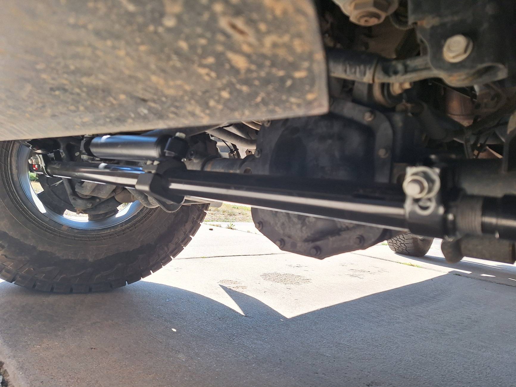

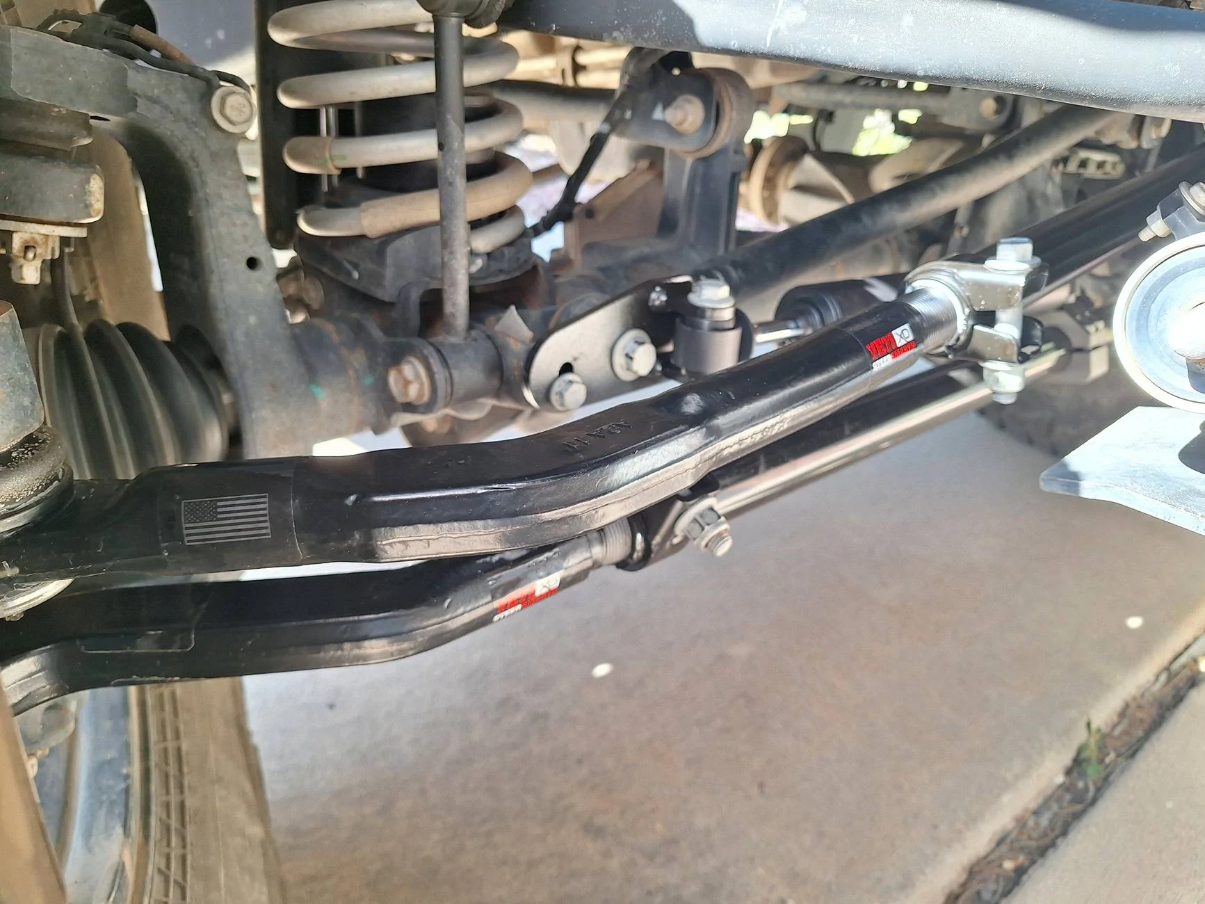

If you want, I can dig some up of mine. I have their PRO track bar, pro tie rod, XD drag link, and sector shaft brace.
