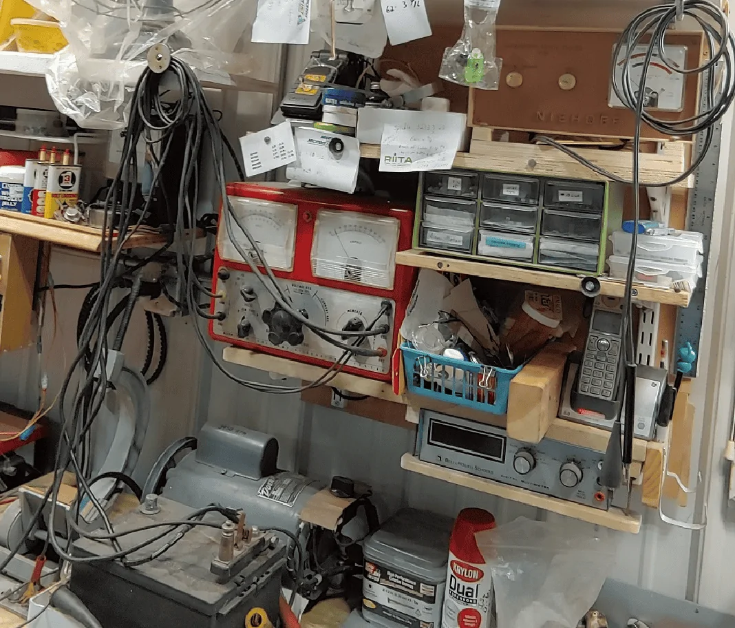

You would have to fully disconnect the aux battery before testing it, but with a battery tester you have that option.
Testing a battery requires a full charge, draining the surface charge, then applying a known load and watching voltage under that load - like the dealers do.
That being the case, a volt meter won't "test" a battery, but it's a tool for recognizing patterns in voltage and behavior. You can pretty much tell when there's a battery issue vs. something else.
(and it was good to find out James has two of his "watchers" so he can more easily tell what's going on.)
I've always said that having a volt meter in a car is one of the single best tools you can have.
Ammeters in cars years ago were all but worthless. They meant little but were cool for sports car enthusiasts. Along came volt meters and I was like - thank goodness someone had a clue.
The volt meter in my SX4 will tell me more about that car's electric systems than the AMX cluster in my Javelin with ammeter could ever tell.
Anyway, my point is that a volt meter won't test a battery, but will give an indication of SoC and how well it handles a load. Is it handling it well enough for the rating/size of that battery or not?
It's a tool once one knows what to watch for.
This is how you test a battery and charging system ->
