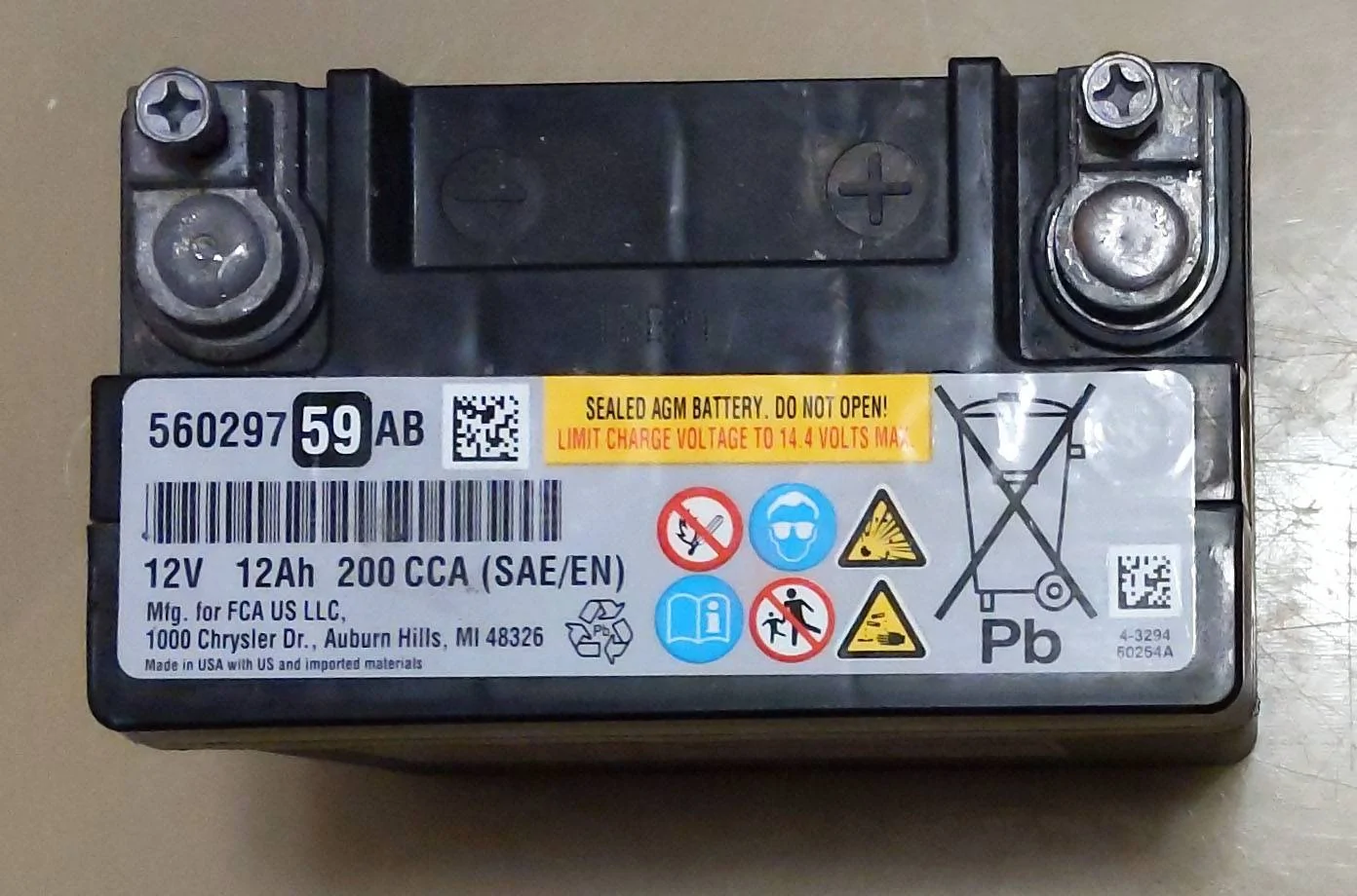

Must be a programing change. My JL charged in the mid 14v for years, but never went over 14.8v. I wonder if they still put the 14.4v charging limit warning on the aux battery.

I've noted that 14.4 on several batteries, even non-MOPAR and sort of laughed. Even a good AGM charger exceeds that. At least mine do. And my 2020 wasn't afraid to hit 14.6-14.7 at times.
