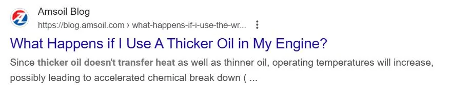

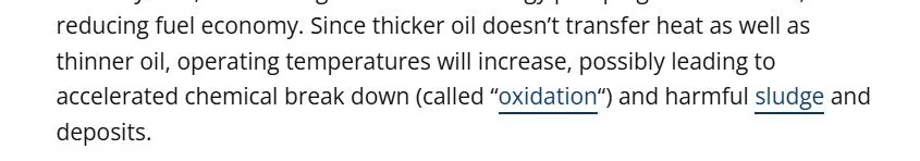

From AMSOIL themselves -
Jeep Gladiator 0W-40 in PUG 3.6 1753795526252-7

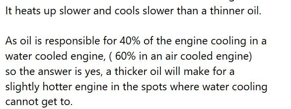

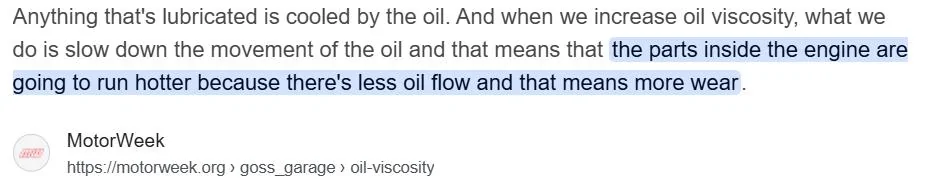

You can reach the threshold of thermal breakdown faster with a thicker oil (when I say "thicker", I mean jumping 2 grades up, from a 20 to a 40, for example. 20 to 30 should be of little issue)
From BITOG - (some funny stuff there, too. It's just ordinary people responding in most cases, so be careful what you take from there. )
Jeep Gladiator 0W-40 in PUG 3.6 1753795971170-l8
Jeep Gladiator 0W-40 in PUG 3.6 Screenshot 2025-07-29 081714
Jeep Gladiator 0W-40 in PUG 3.6 Screenshot 2025-07-29 081929
Little problem if any at all with the move from 0w20 to 0w30 or even 5w30 in the heat of AZ but going 2 grades according to real experts can be problematic in both short term oil life and long term engine life.
But....but....but my engine doesn't run hotter!
No, because the cooling system is keeping up or head of the BTUs of heat being generated.
But...but...but my oil temp gauge isn't reading higher!
No, because of where it's being sensed, and because we have an oil cooler.
We risk running certain parts of the engine hotter - not the heat measured at a single location at the thermostat or the back of the head, but localized heat, due to the thicker oil not carrying it away, or even causing that heat.
You may see only 240 degrees oil temperature, but localized conditions can take it to closer to 280 or higher, so bits of that oil reach thermal breakdown, impacting anti-oxidizing chemicals, etc.
