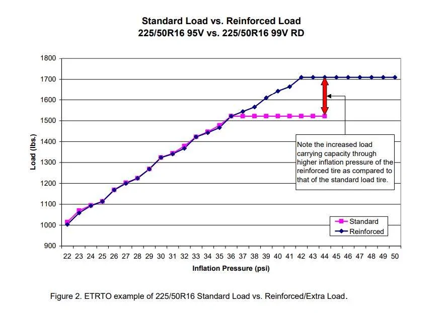

...The way I think about it is the "Flex" of the sidewall is a constraint that is to not be violated;
The max flex is the flex that would occur at max load, at specified pressure;
A way to model the "flex" is the number of square inches of tire footprint - 2469/44 is 56.11 square inches for the stock tire;
Since the tire data placard says 36 psi - this means the same footprint, 56.11 sq inches would occur with a tire loading of 36 * 56.11, which is 2020 lbs per tire/wheel;
This is just wrong. The area of the contact patch is not load divided by pressure. It isn't even true for something as simple as a balloon. The reason? Pressure on the contact patch is not uniform. Here's a good explanation from Barry's Tire Tech.
The main thing to understand here is that load capacity is not a linear function of tire pressure. That's why we have load inflation tables. Toyo provides them in a pdf here. Falken has them here in html. Note that they are the same. The standard is set by the Tire and Rim Association (TRA) for the P-metric, LT-metric and Flotation sizes and the European Tyre and Rim Technical Organisation (ETRTO) for the ISO-metric sizes.
I did not mean to imply that my analysis was an exactly correct model, but useful
as a 1st order approximation;
Your pdf link - to Toyo tires has a graph that is very close to linear, which validates my thinking;
I was not trying to say what the patch area was exactly, but just calculate how the pressure/loading must change to maintain that particular patch area;
Here is my snip of that graph;
