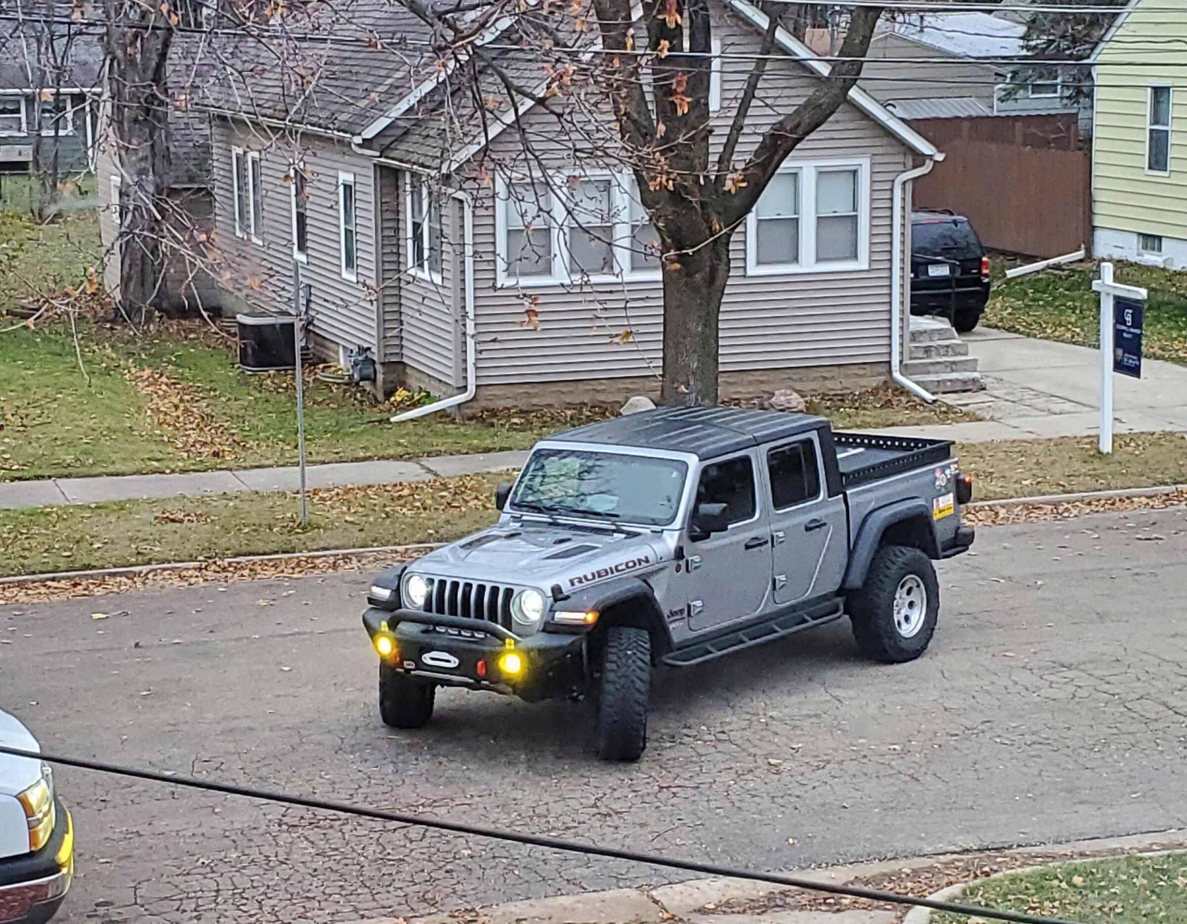

I’ll add a data point.
-Rubicon
-35’s
-mopar lift
-Rebel Off-road half-rack
-steel bumper
I’m getting about 15.1. Thinking about taking off the wings of the bumper for a while to run it as a stubby just to see how that impacts my mpg’s.

When you do that I'd be willing to bet it drops even more. More air flow up under the fenders is going to cause more wind drag and less fuel economy, how much less is anybody's guess.

Yep, 100% agree. Same reason I stated before that I went full width on the bumper and went with a less aggressive treqd design this time over a Mud terrain. I know it's not going to get great gas mileage but there are things you can do to control how bad or good it is just by thinking out your build. People will
Argue with me all day that a light bar above the windshield will not affect Mpgs but anything you put up there that blocks air from flowing freely around the vehicle is going to cause drag, and then will cause Mpgs to go down.
