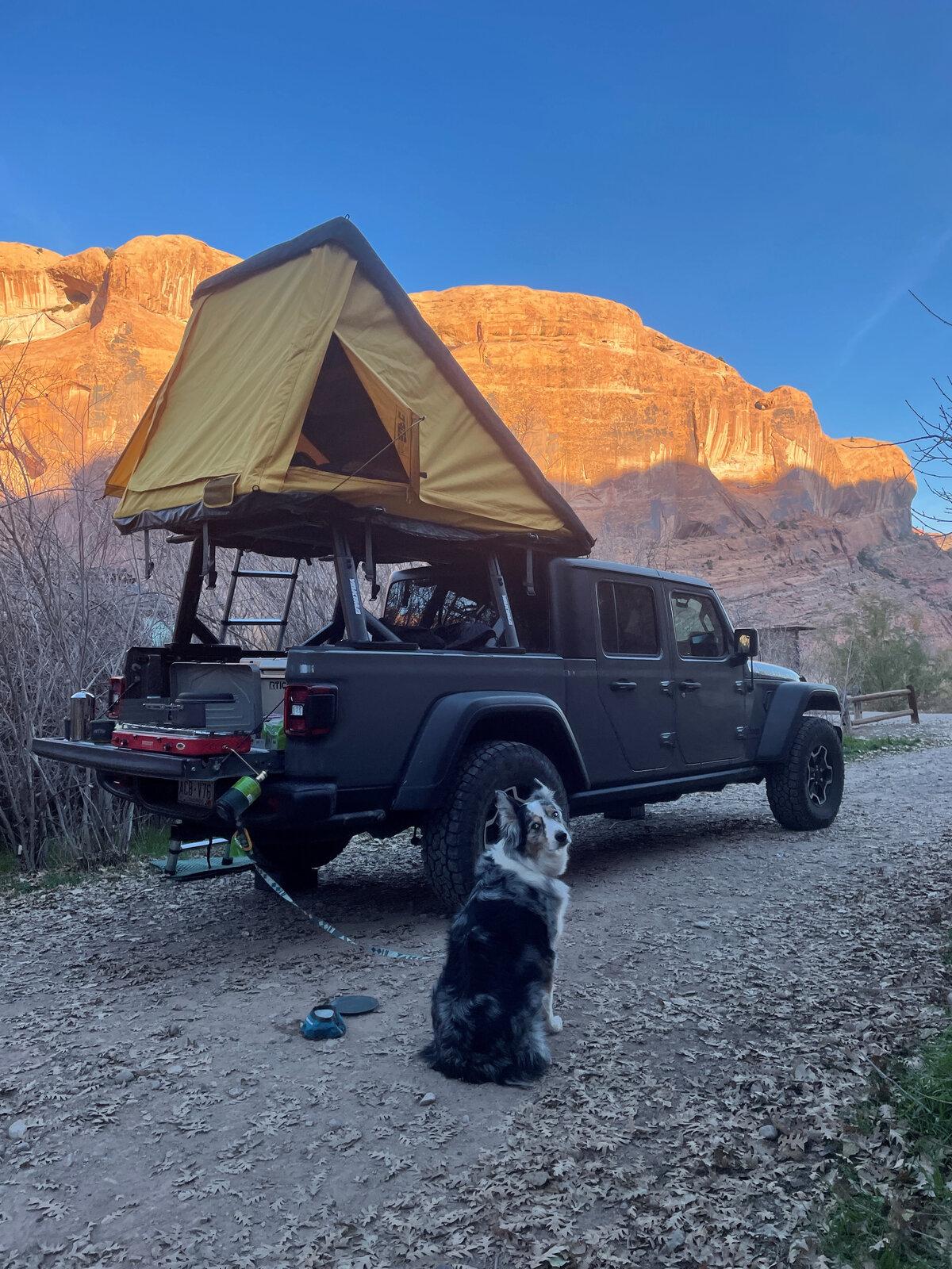

I have a similar setup, and just averaged about 18mpg driving from Moab, UT to Denver, UT with speed between 70-85mph.
A couple of things though which might contribute to the difference:
  1. I have my tire size calibrated via Tazer
  2. I was mindful to pick one of the lightest 35" ATs I could find (Toyo ATIII, 35x11.50x17)
  3. I kept my factory alloy wheels (22lb/wheel)
  4. Aluminum bed rack (something like 50lb total)
  5. RTT looks big, but its pretty low profile when closed, and only weighs about 85lbs.

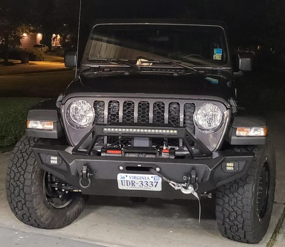

It’s been just over 4k miles so far and mpg just seems to keep dropping. I even baby the S out this thing when driving it. I have a rack and roof top tent so I figured that’s killing it the most. I took it off about a week ago and still getting 13.1 with city/hwy mix. Everyone on this board is posting like 15-20 and many have more mods and bigger tires. So trying to figure out wtf I can do to get more range out of this thing.
I’m wondering if maybe the tazer could be causing an issue somehow. Going to take that off and test this week.
21 rubicon
35” Baja atz with 17” fuel zephyr wheels (kinda heavy wheels).
RR arcus stubby bumper
Taser mini- updated about 2 months ago to fix issues it had.
4h auto ( I wonder if this also drops mpg
I run regular fuel, so 87/89 normally.
Thoughts on stuff to try? I read the thread with the pulsar but that won’t work on the 21 I guess.
