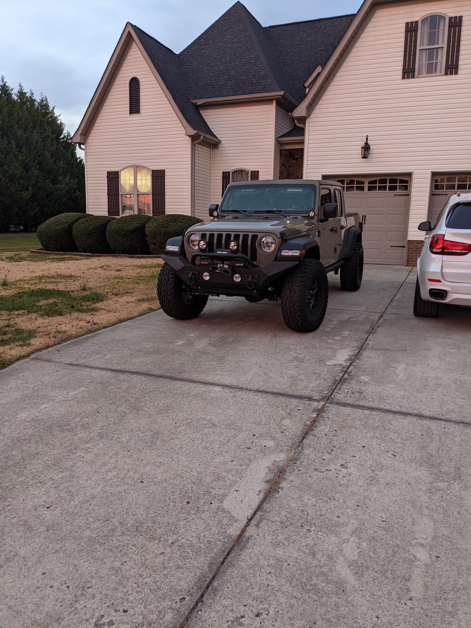

I'm at 98lbs a corner roughly and I'm able to get just above 17 most of the time. I have dropped to around 16.7 for a few days since it's gotten down to below 30 a few days and no higher than 50 but as soon as it got back to getting in the 60's I was able to get it back up to 17.2. All my data is long term, I got over 40,000 miles on mine. 18,000 miles of those on 315 70 17 BFG KO2S where I never saw below 18.2 Mpgs and could get as high as right at 20 on a long trip. I've been running 37's for the last 22,000 miles and it dropped to 17.2 for the most part and i can get around 18.2 on long trips. Stock gearing 4.10 gears sitting like this
Jeep Gladiator 13.1mpg best I can get with 35’s. Questions inside….. PXL_20211204_221828903
