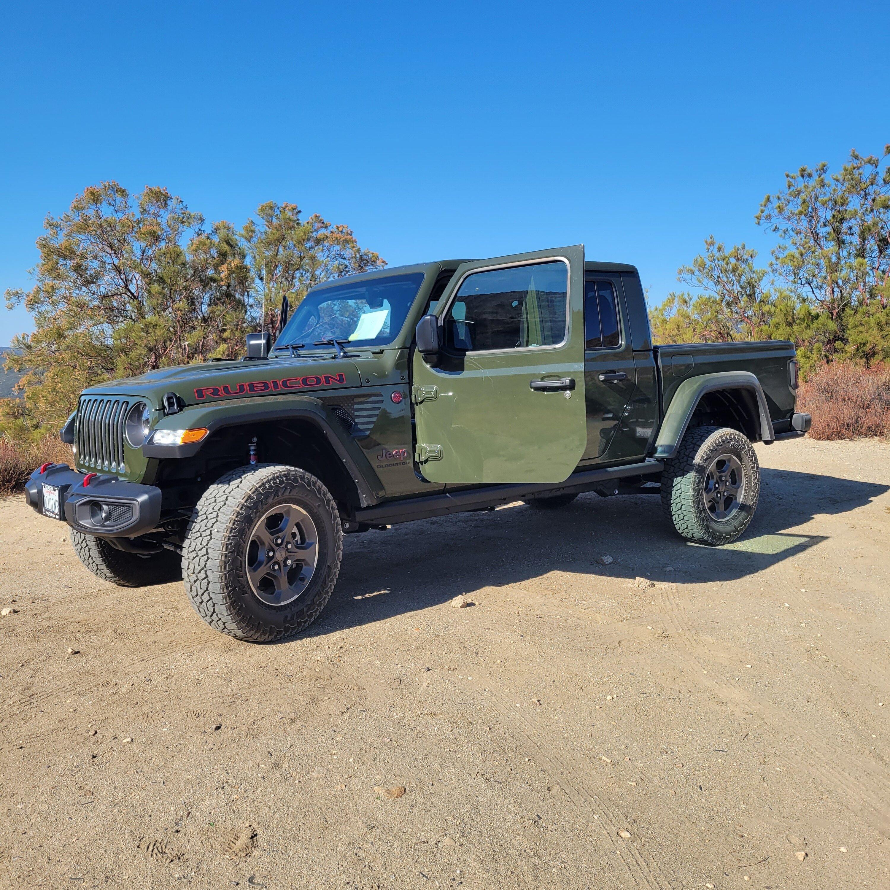

Went with Mopar 2" lift on the Overland to take advantage of the springs and FOX shocks. Only went with the 2" AEV spacer lift on my Rubicon as it already had the right springs and shocks. Did not change the ride! I wheel alot but not hard core rock climbing. Still have the factory 33's. Cant justify $1500 in new tires for a 1" benefit. Will address that when these wear out! And $500 for the AEV spacer vs $1400 for the Mopar lift. Put the spacers in myself and then had the dealer re-torque the UCA's and LCA's that I couldnt quite get the torque on.
