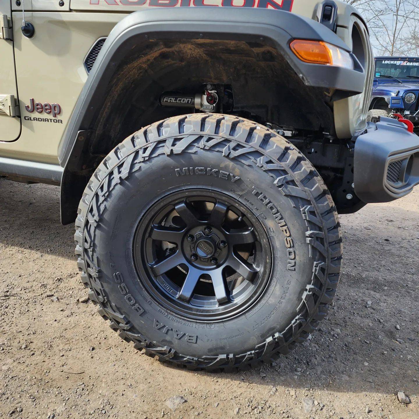

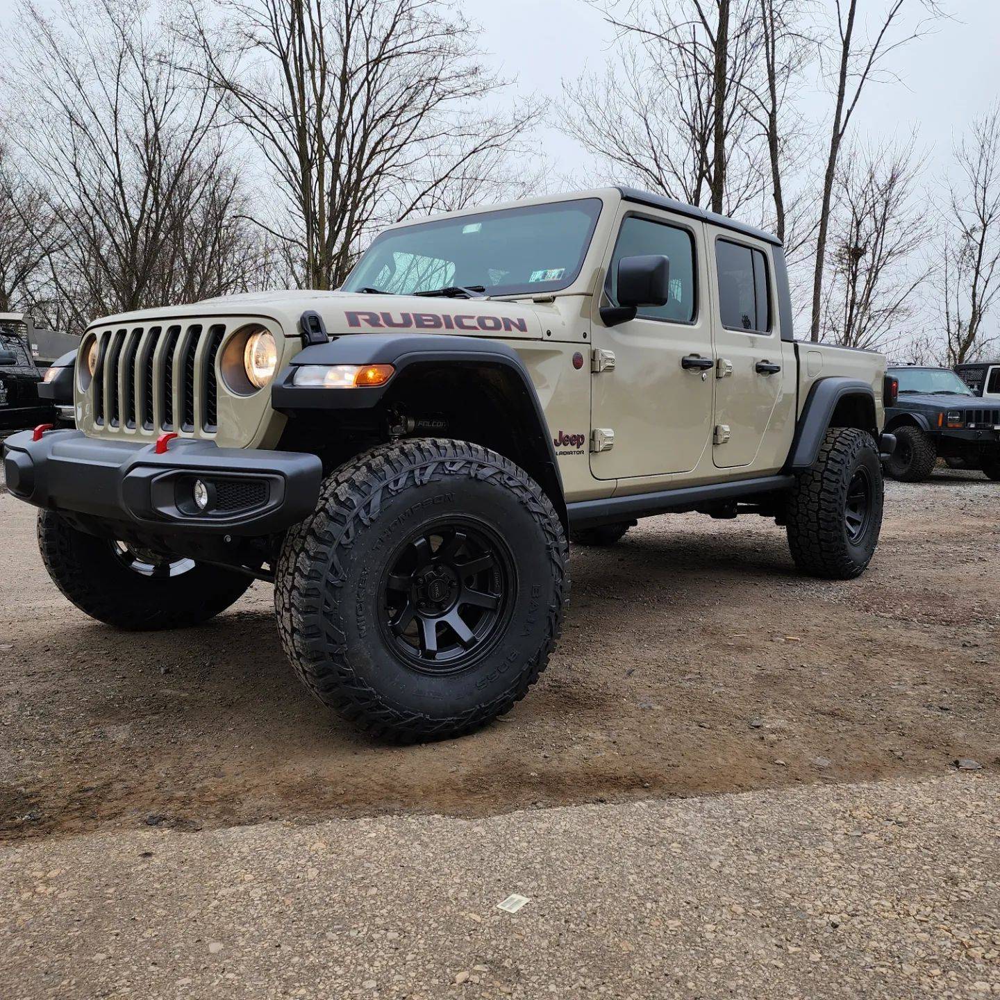

The wheels are KMC Trail - though looking at the KMC website now it seems they no longer offer the matte black color (only matte bronze). They are 17x9 -12mm and running the numbers through this calculator, Offset Calculator, my change from stock wheels/tires (285/70-17 and +44mm offset) to the KMC Trails and Baja Boss A/Ts (37x12.5LT17 and -12mm offset) moved the outside edge of my tire out by 2.85". I added the Double Black Off Road 2" Fender Extensions shown in the picture below, and with the extensions I have no appreciable poke. Unfortunately I don't have any side shots showing what the poke was with the new wheels/tires and no fender extensions.

The two set of fronts approach is for the mopar extreme fender flares. I bought 2" extensions from Double Black Off Road (DBOR JT Rubicon US Spec) - they provide full coverage for both front and rear fenders, but the are expensive. Even on sale on the DBOR site, the shipping costs ended up being about $220 dollars. They seem to be decent quality (though I would have liked to see a little better finish on them for the price). The install was simple. I have more details in my build thread if you are interested.

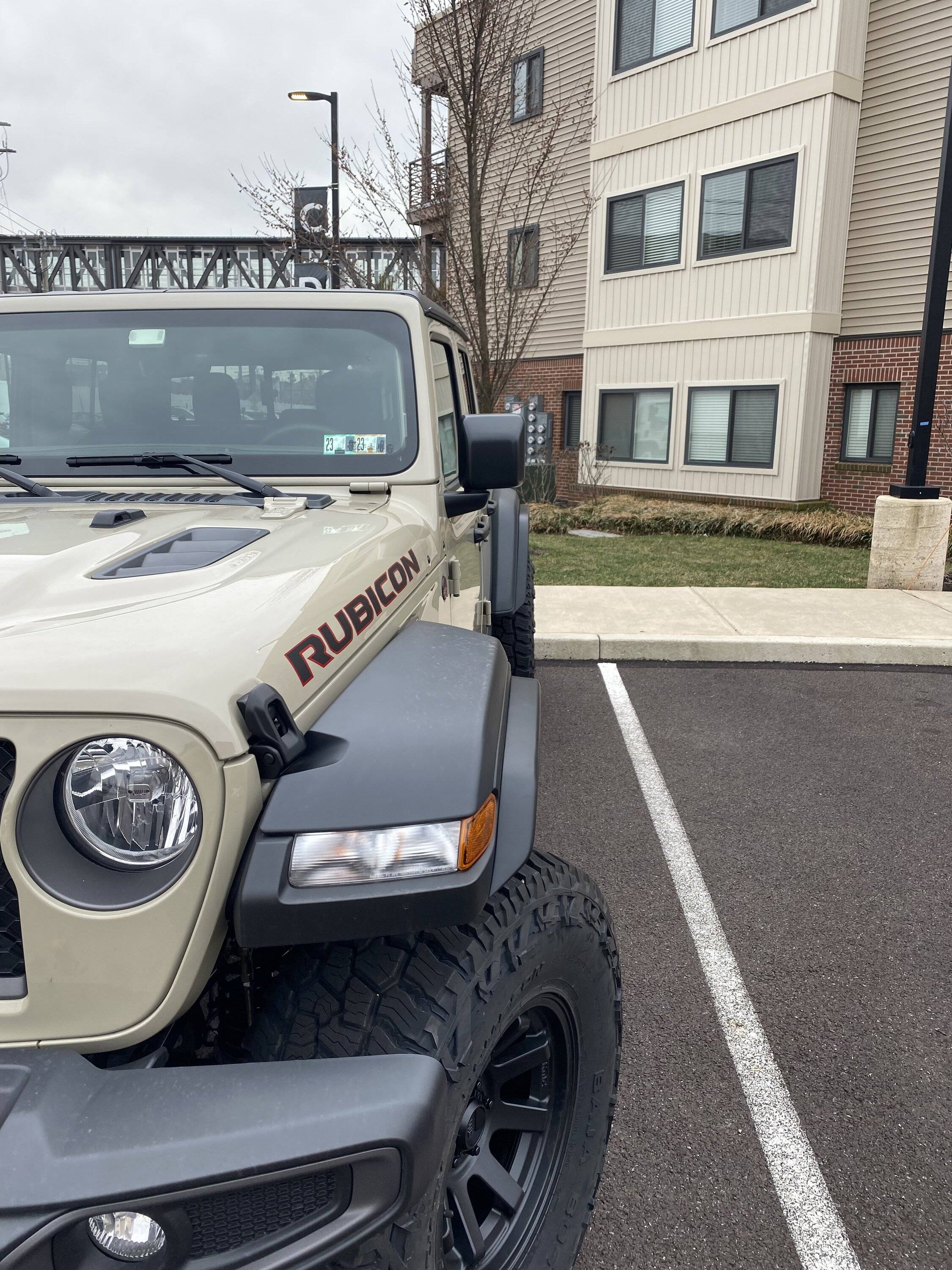

Yeah - it's basically $600 once you add in the shipping. Pennsylvania has some crappy laws about tire poke that are almost randomly enforced (or not enforced). My main goal was to avoid those potential issues. I didn't like that partial coverage of the extreme recon flares and I couldn't find another aftermarket solution that didn't involve replacing the factory fenders .... I was figuring total cost would be about $500-550 based on the DBOR web site saying shipping to US would be about $195 .... I just checked the paperwork from my order and shipping turned out to be $260!
Given what I know now, I am not sure I'd order them again solely due to the cost. I do like the looks of them on my JT though and they seem pretty solid. We'll see how long it takes for me to booger one up on tree or something while out on the trail.

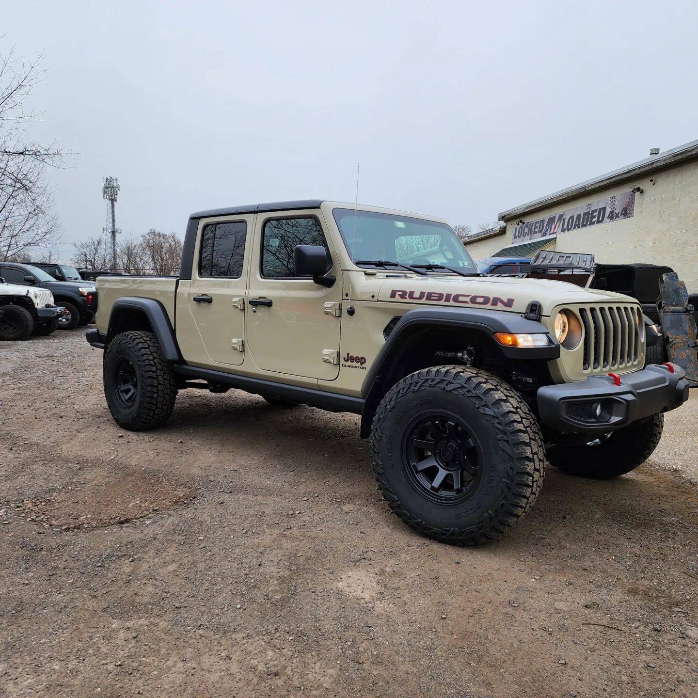

Currently living the apartment life with no where to do my own work, but lucky to get hooked up with LockedNLoaded 4x4 in Collegeville, PA. my JT looks awesome with the 2.5" Overland Plus kit, Falcon SP shocks and KMC Trail wheels wrapped in 37" Mickey Thompson Baja Boss ATs ... took out for a quick drive and spent two hours tooling around town, running some highway speeds and poking along back roads ... loving the whole setup.

It's completely driveable. I lost around 2 mpg in combined driving, and I don't see 8th gear all that often. I thought I'd need/want to regear right away and figured I'd save some money for 5.13's. After three months of driving on the 4.10s I still haven't prioritized saving some money for a regear - so that must mean I am not that bothered by it as-is.
