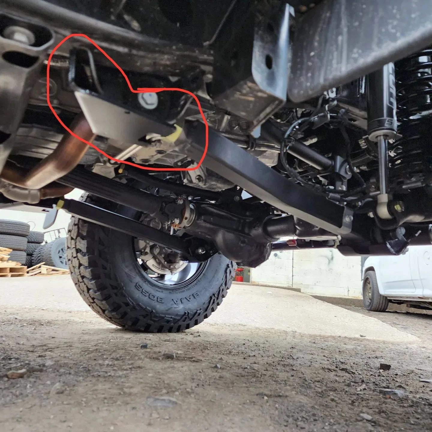

Is this a skid plate? What brand?

I like RH stuff, didn’t know they had frame skids.
How do the rear ones install? I, as most people, had to ream out one of the holes on my Rusty’s rear frame skid to bolt up.
Was also very interesting getting the small nuts in.
RockHard just has one bolt?
The RH frame side front skids are an easy install, you only have to remove the nut and slide the skid on, replace the nut and torque appropriately. I think the RH rear frame side skids only mount with the control arm bolt. I went with Rusty's for the rear frame side skid for the extra mounting bolts to avoid any chance of the skid rotating - no issues with holes lining up. Maybe that was just dumb luck, or I've seen some people post that they may have recently started making those holes slightly larger to address the fit issues people were experiencing.
