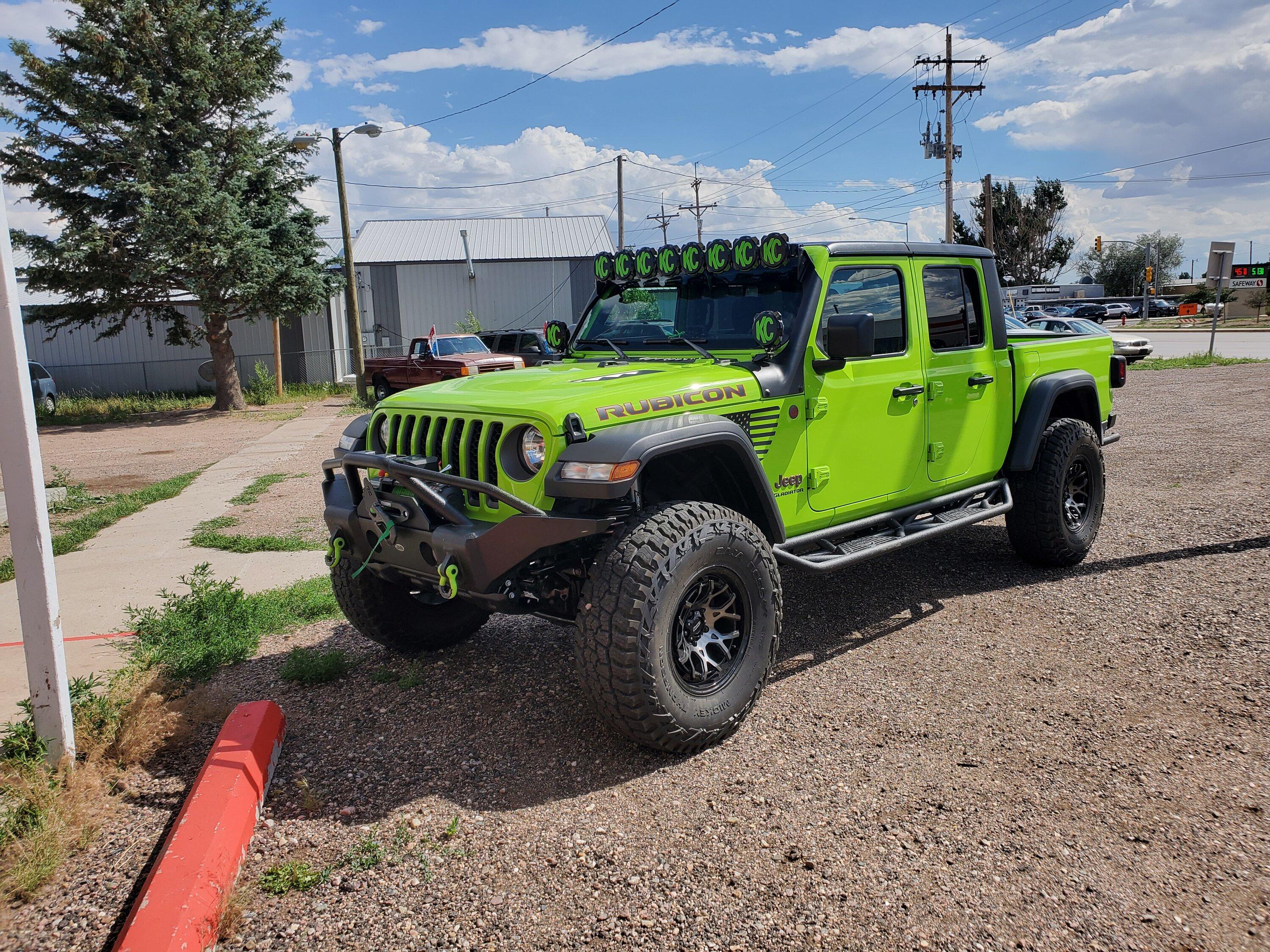

Sweet Gladiator!!!
Someone loves their Hooke Roads!

I do they seem to hold up to some abuse and they don't bankrupt you lol🤣😂🤣
