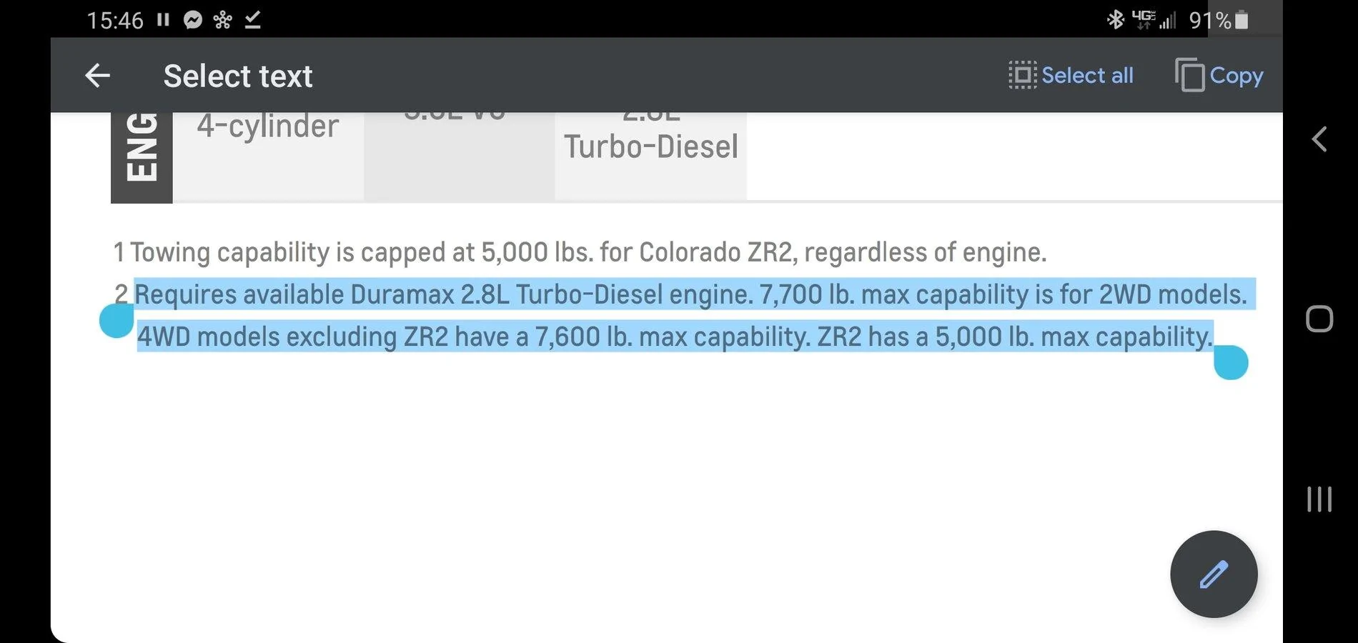

DaveNH
Dave
Nov 13, 2017
303
276
New Hampshire
Hyundai Sonata
The diesel colorado still has a higher tow rating than the v6. According to an interview with Dave Harriton, it has lower cooling requirements than the gas engine. Of course, its also down a lot of horse power.
Only in 2wd though.
Max in 4wd is 7600# compared to 7650# for the Pentastar w/Max Tow.
