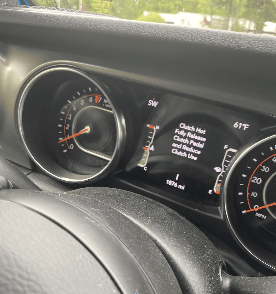

Recently, I have been hearing a clunk sound when I change the gears as soon as the clutch is engaged. It happens between every two gears whether it is 1 to 2 or 3 to 4, 3 to 2, etc. Going to a different dealership tomorrow morning. Here we go! 2nd visit in two months! cheers to the manual transmission ?
The sound is a new issue. The previous issues: clutch smell and not being able to climb have been "almost" resolved. The truck has 1900 miles on it. My truck may not perform too well but it sure looks good ⬇⬇⬇?
They said the clunk sound is normal and should not be an issue. After I told them the story of my truck not performing well on hills, the technician drove the car down a hill (15 degrees) and tried to back up and white smoke came off the transmission while revving up less than 3000 RPM and overheat message showed up for the first time ever (see below), and I immediately asked him to stop the torture. Then, they let me drive a stock Rubicon with M/T (with 30k miles on it) on the same hill, and it did move without any smokes or smell despite not being easy. They say that my clutch has not broken into yet and also I can't expect much from it with the oversized tires. They suggested regearing the truck for about $3000.
I also confirmed that the Rubicon JT also made the clunk sound similar to my vehicle when you lift up your foot a bit faster as you change gears. I am stuck with it and regearing seems like the only solution. Perhaps, I am going to start a thread to see if anyone has ever attempted to covert an M/T to Automatic and how much that would cost. It may sound crazy but if it is going to cost less than 6-7k, it may not be a bad idea. I'd lose more money if I sell my truck and order a new one with the same options and A/T.
