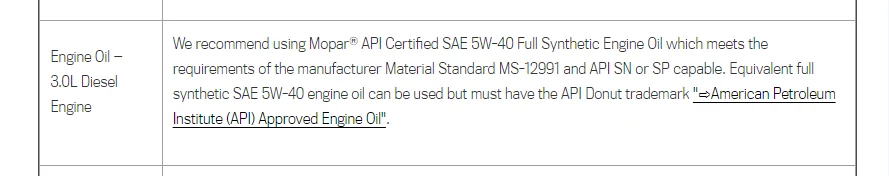

2022 Owners Manual Update to Oil Requirements

When did rotella t6 drop its ash and stop creating dpf issues? (Earlier post sounded excited to use it…)
I would stick with an low ash/MS-12991 oil rather than trying to save a few bucks.
Usually dpf issues don’t start showing their face until 80-100k miles…. And the warranty is up at the 100k mark. Rolling the dice if you are trying to stay compliant.

Emailed them on the jeep app, here is what I got back.
Hello Gary,
Thank you for contacting Jeep Customer Care! I can understand wanting to confirm the information with us directly. I would be happy to look into this with you and certainly provide what is recommend directly from Jeep.
I am showing what is recommend would be. For best performance and maximum protection under all types of operating conditions, the manufacturer recommends engine oils that meet the requirements of the manufacturer Material Standard MS-12991, and that are API SN certified and meet the requirements of the manufacturer
Looking into this further I am showing We recommend you use SAE 5W-40 API Certified Synthetic Engine Oil, meeting the requirements of FCA Material Standard MS-12991 such as Mopar, Pennzoil, and Shell Helix. Refer to your engine oil filler cap for correct SAE grade.
The last option would be Shell Rotella T6 5W-40 diesel engine oil is a full synthetic motor oil that features exclusive Triple Protection Plus technology, formulated with fully synthetic base oils plus advanced additives to protect against wear, deposits, and oil breakdown.
These would be the list of options that can be used with the make and model. If you have any further question certainly I would recommend chatting in directly on the brand site or emailing in again.
Should this matter be urgent, or if you desire a quicker response, please contact us by phone to discuss your issue with one of our Jeep Advisors.
Jeep Brand: 877-426-5337
For any future communication related to this email, please refer to reference number 83912796
Sincerely,
Emily
The Jeep Brand
