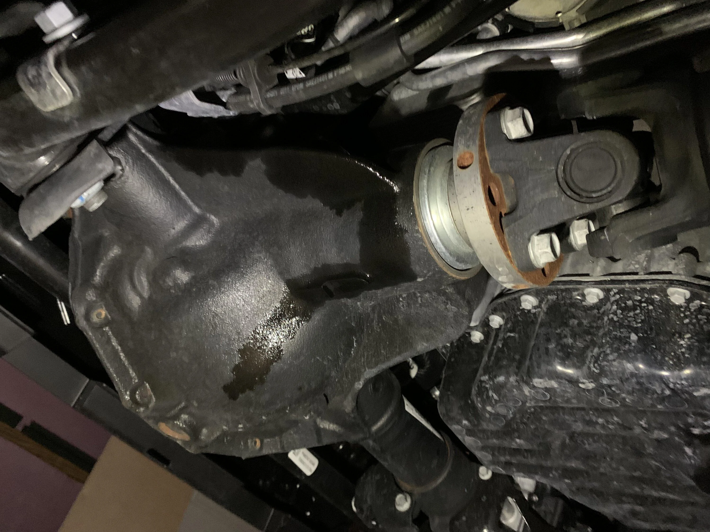

At one point, it was on sale for just $15 for a jug. I've used this oil since new. Skipped all Jeep wave free oil changes, caused i like my engine bay free of oil spills :)
yeah, no shite, my first wave change i didnt notice until i got home that there was oil all over the frame, wiring and suspension on the drivers side (diesel engine), man I was pissed. I have done my own maint. for 40 yrs and would never have left something like that....dumb ass dealers
I had some other issues so I made an appointment and said screw it and let them change the oil since it was free. I was amazed they didn't make a mess, but they did put it in 11 quarts of T6.

Had them do mine a couple weeks ago. They put t6 in and made a mess.
BigG
Gary
Feb 11, 2018
76
120
97321
JTRD
Papermaker
Emailed them on the jeep app, here is what I got back.

Both Jeep Wave oil changes I’ve had done the dealer made a mess, although less so the second time after I mentioned it. Both times removal of the filter assembly seems to be the culprit. Not sure if it is only a workmanship issue, maybe also design, but either way still frustrating

I did the first oil change myself and didn’t make a mess, but if I did I would at least clean it up. Instead I wiped it off my garage floor.
