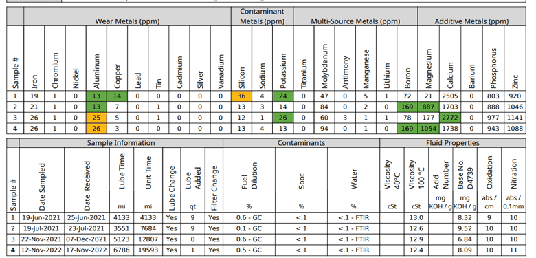

The aluminum and iron wear metals are high on the 3rd gen EcoDiesel. Below is my UOA report from a 2020 Ram 1500 EcoDiesel. It is believed that the aluminum is due to a combination of low-tension piston rings and an offset wrist pin. A high mileage teardown is needed to see wear on piston skirts. I'll be pulling another sample next month.
Odd because offset wrist pins have been used for many decades - way back, in fact. Nothing new, and is a normal practice to allow lighter, shorter pistons, less noise when cold and so on.
I'd be interested in knowing why low tension rings would contribute to aluminum since it's, well, less pressure from the rings themselves gliding over the oil on the cylinder wall as they move back up. The pressure on the combustion stroke would be the same since the tension there is generated by the combustion gases/pressures working behind the ring forcing it outward, sealing against the cylinder wall, scraping oil off as they go down.
The up-stroke would mean less tension as the rings would glide back up over the oil film and not against the aluminum cylinder wall.
So - would love to hear why low tension rings would mean more aluminum wear, not less. The idea behind them is less friction on exhaust, intake and compression strokes.

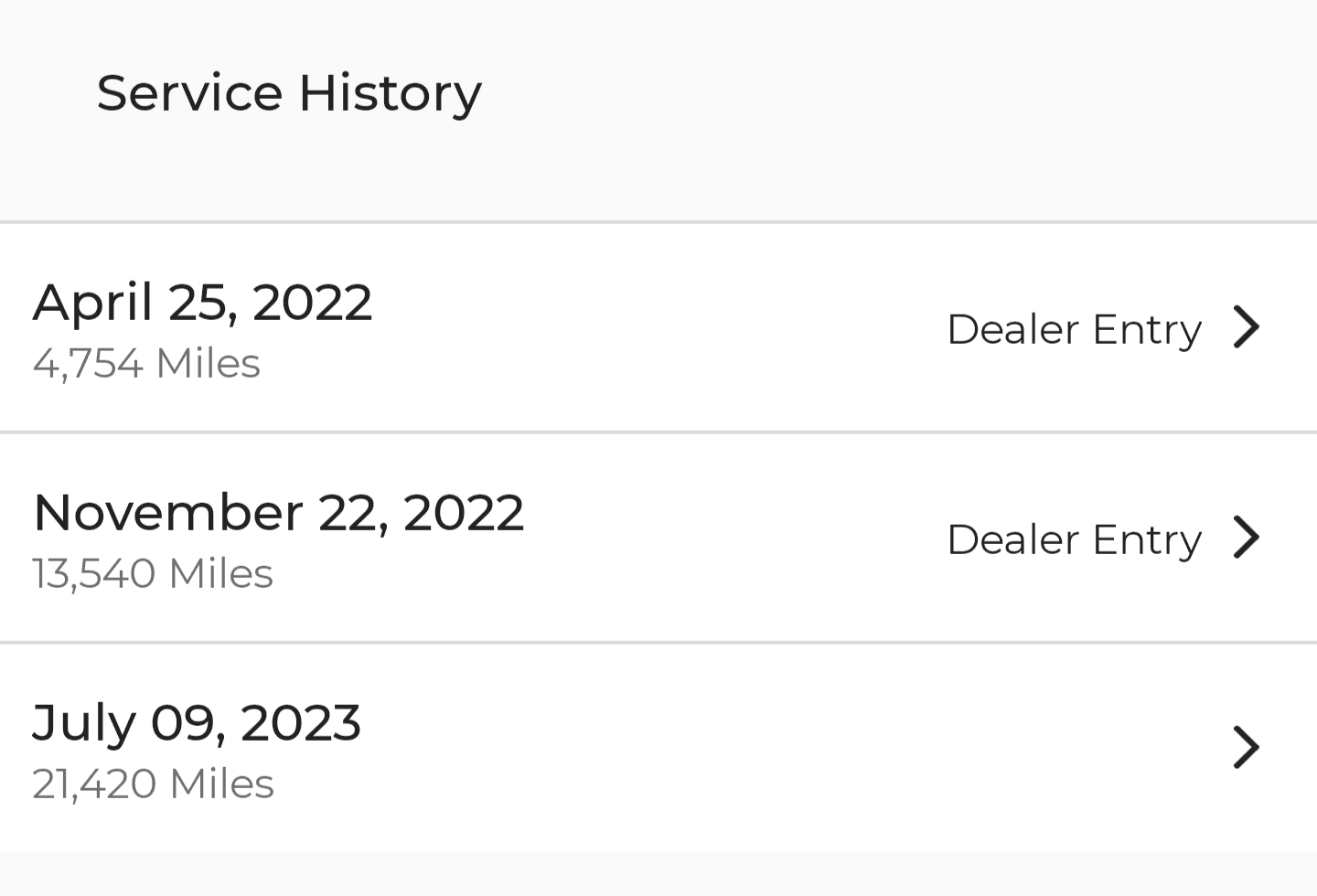

This was my third oil change.
Jeep Gladiator Ecodiesel Oil Analysis - updated 11/23/23 Screenshot_20230803-074557
Each record below is a change. Factory ran to 4754, then changed again at 13540, then pulled this sample at 21420. There are 7,880 miles on this test. OEM I meant the jeep wave change at 13540 was pp 5w40 and a OEM filter.
Ah... my bad... I misunderstood... thank you for kindly correcting me.
Sorry @ShadowsPapa
