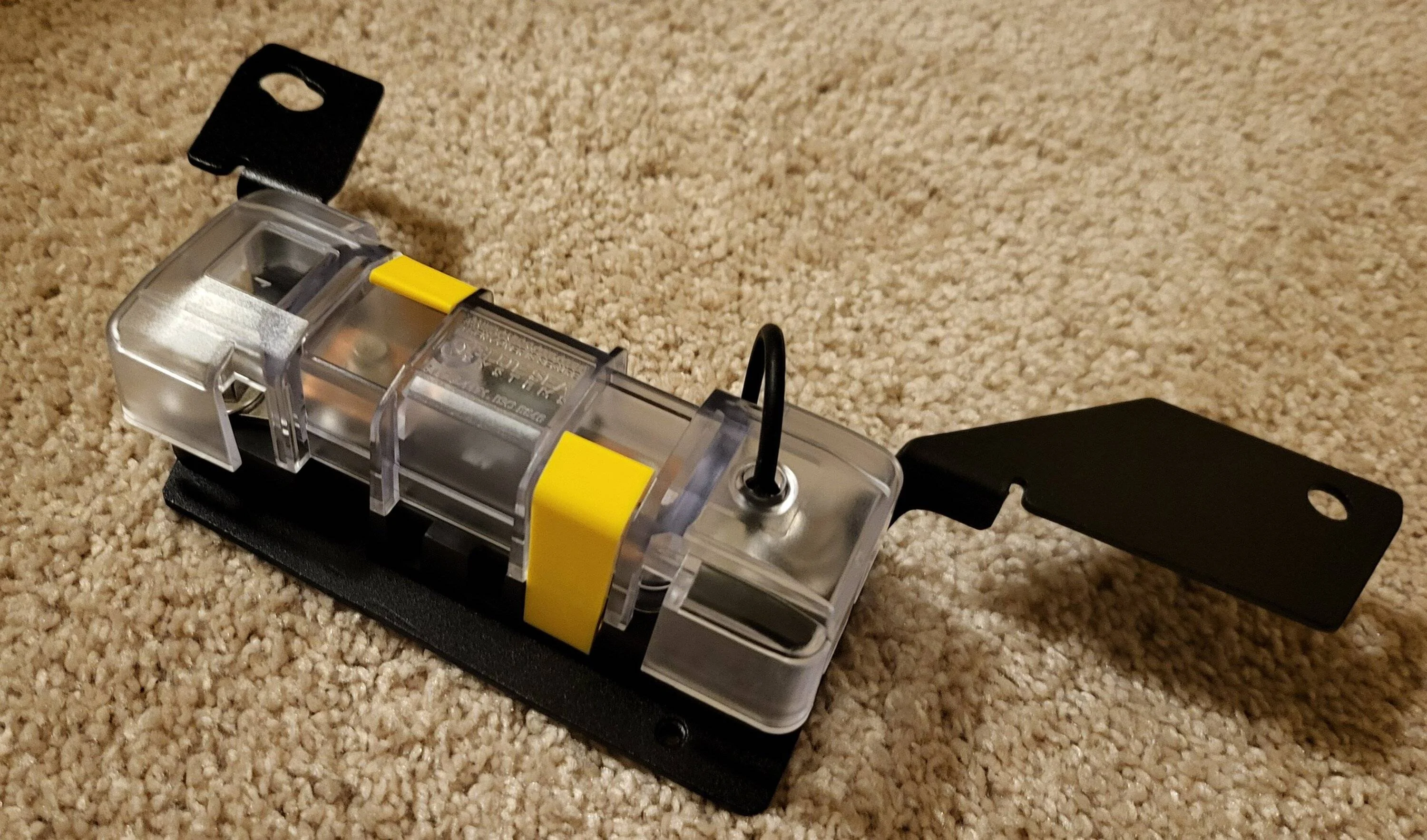

1/20/2024 Engine bay fuse holder bracket

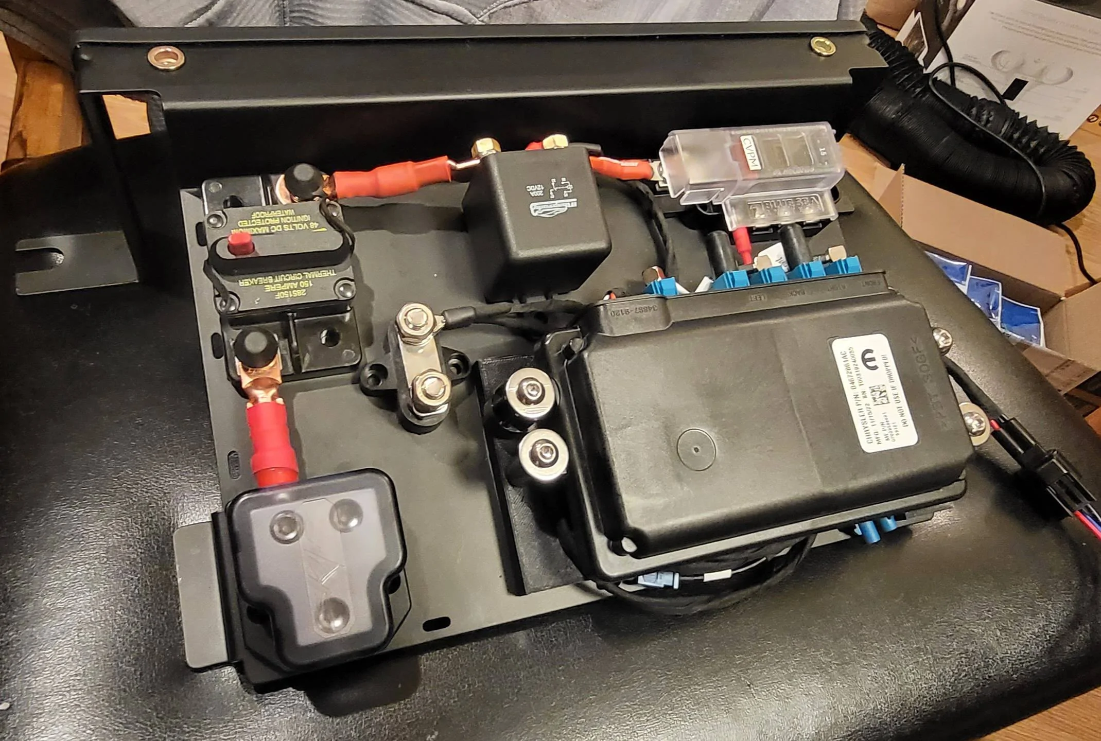

Completed Underseat Module
Jeep Gladiator Mopar Trail Cam DIY Installation - 2023 Diesel Gladiator Rubicon 20240113_223113

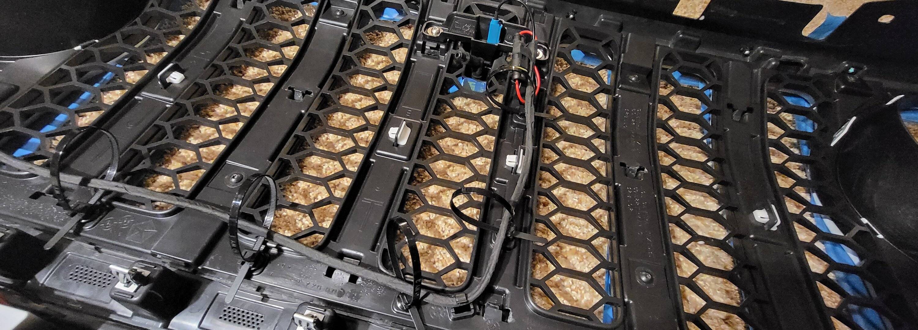

Fakra Z cable in 3 ft length was used for behind the grille wire bundle.
2 of 16ga wires were used to make the harness and this allowed some girth around Fakra cables and splints for further durability. The cables are bundled together with harness tape and held in place by surface mounted zip ties.

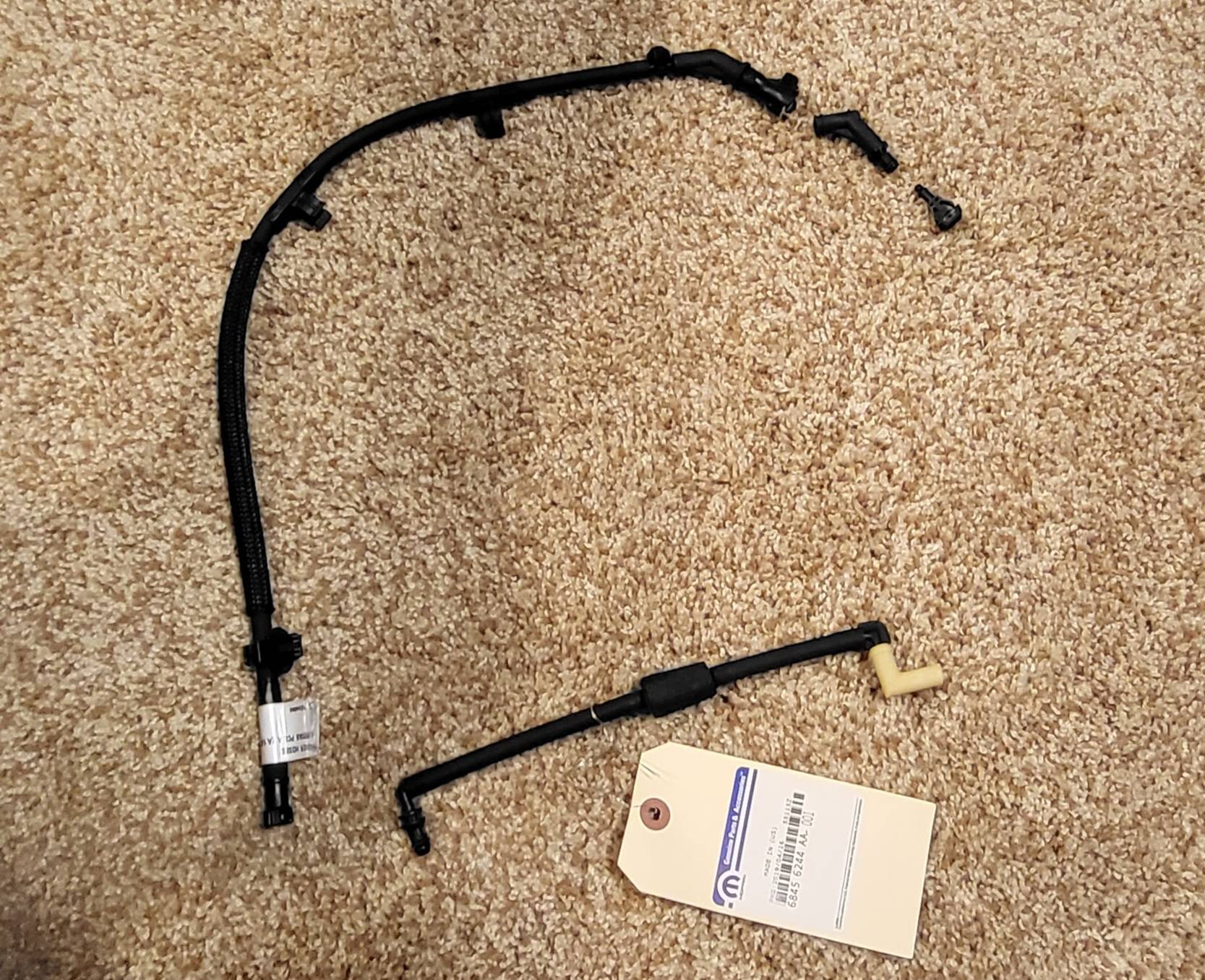

Washer parts: These parts fit with each other in the follow order.
68370210AA Camera washer nozzle - This part fits outside of the grille section.
68370825AA Washer nozzle elbow - This part and any subsequent hoses fit behind the center grill section.
68370828AA Hose #1: washer hose between washer nozzle elbow at the camera to Hose 2
68456244AA Hose #2: intermediate hose washer hose between Hose 1 to the pump. *This part is too short to reach the diesel version of washer bottle/pump. BUT IT IS NECESSARY TO HARVEST THE FITTING TO HOSE #1 Shown as bottom hose on the photo below.
Windshield Washer Hose Kit - 3 Meter Universal Washer Fluid Hose https://a.co/d/esoPQ8G
Automotive Vacuum Tubing Connector Vacuum Tee Connector Assortment- https://a.co/d/6ioKWig
68310928AA Washer pump (Verified to fit)
68382603AB Washer wiring harness(ABSOLUTELY NOT NECESSARY)

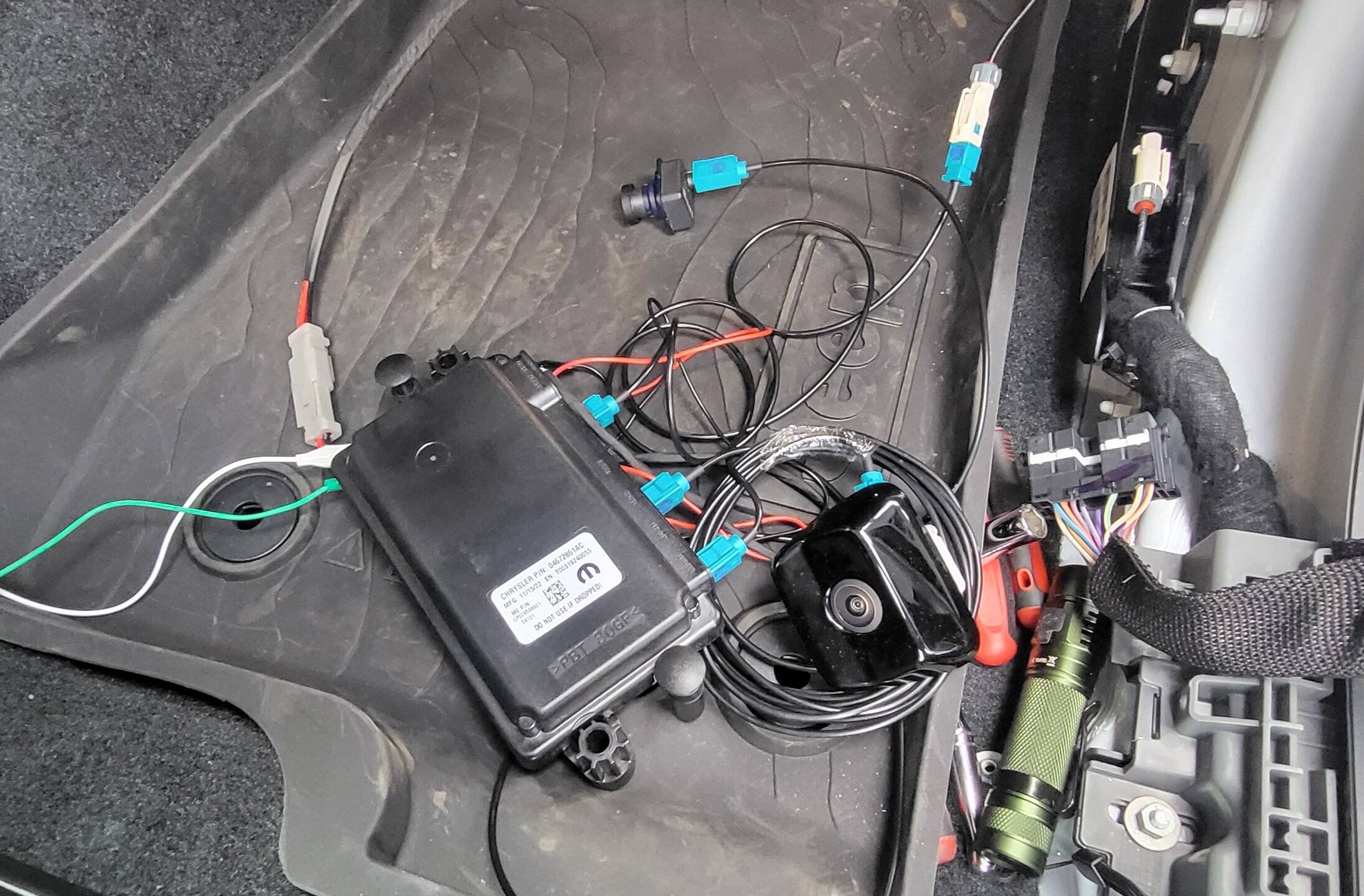

Completed mock installing the CVPM, front and rear cams using power from 12V outlet, using CAN bus behind the glove box and I got front and rear cam to show on the 8.4" screen.
There were a few critical details that were not so clear and some are just not applicable to 2023 Gladiator Diesels for both the physical installation and vehicle configuration using AlfaOBD.

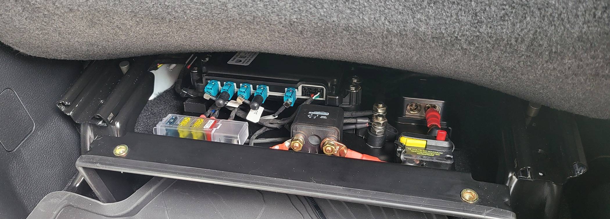

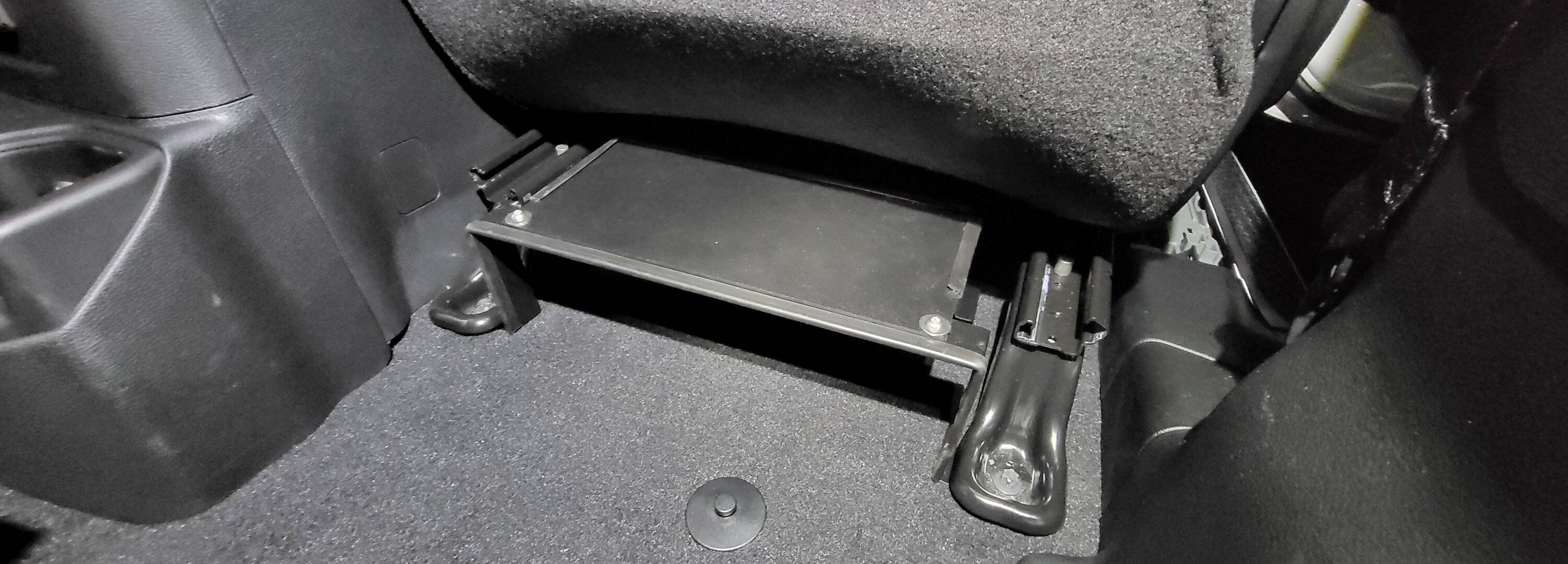

Here is the underseat module being accessed from below the seat as deployed.
The protective cover plate removed.
Jeep Gladiator Mopar Trail Cam DIY Installation - 2023 Diesel Gladiator Rubicon 1000010849

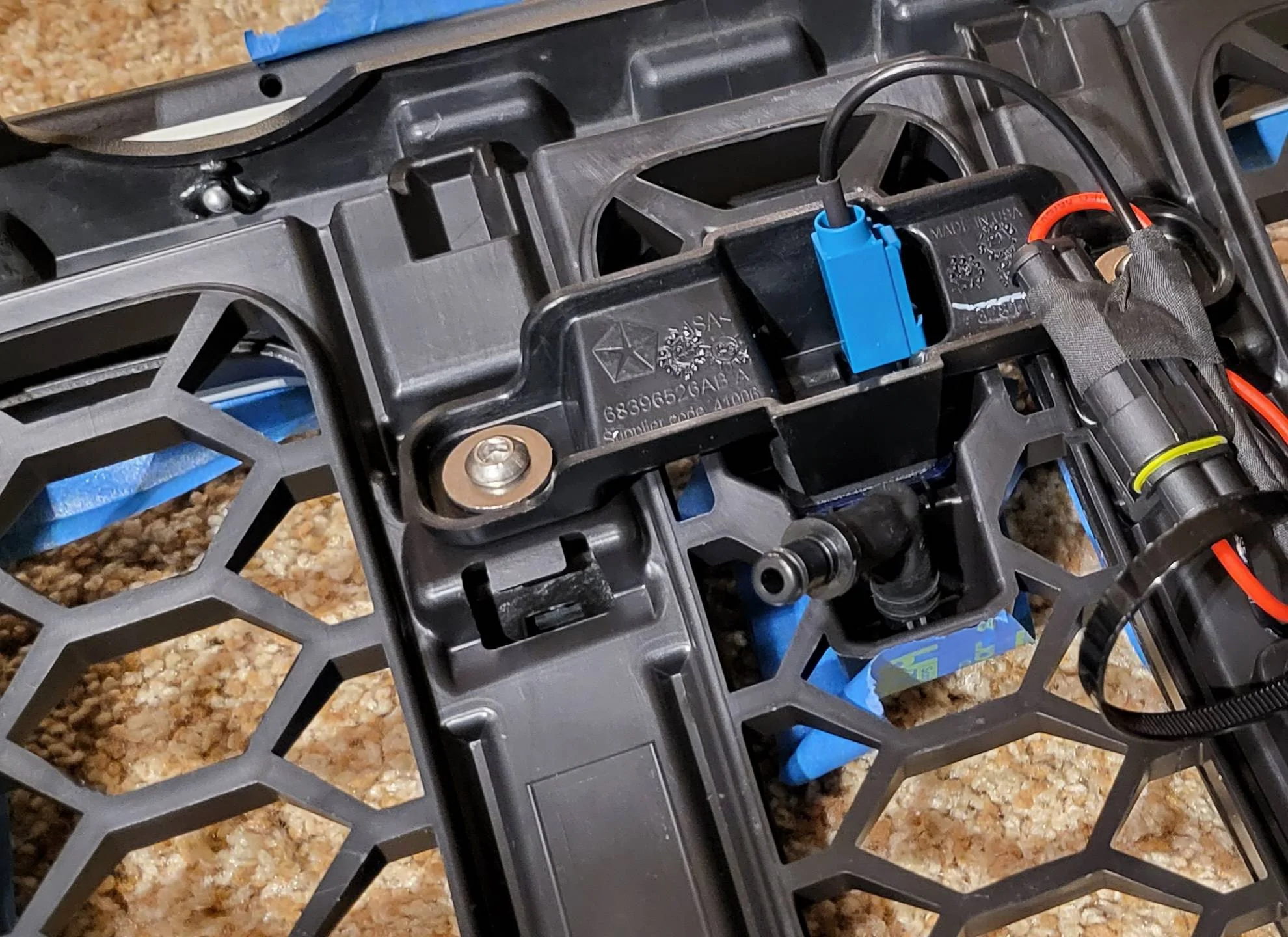

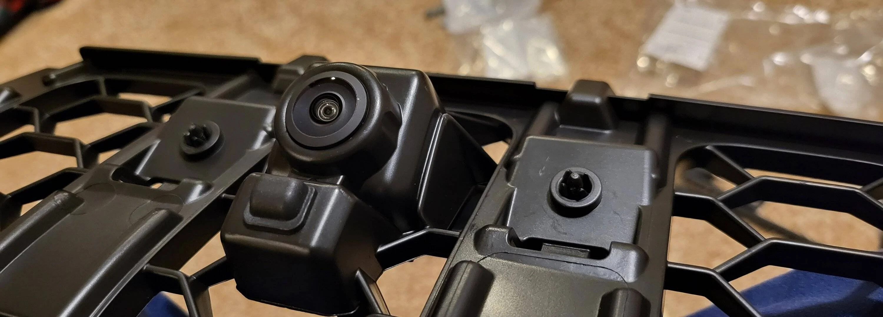

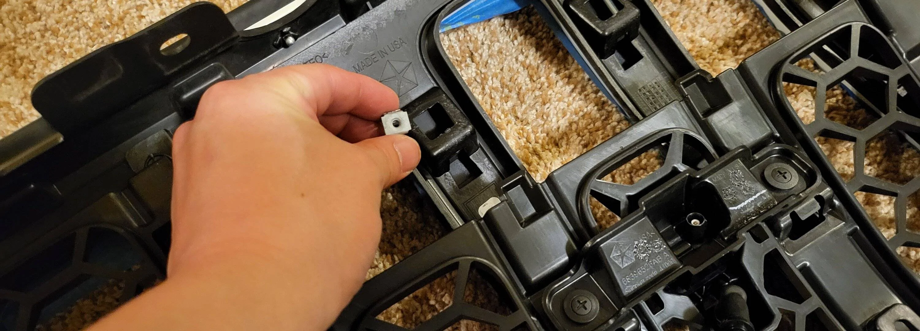

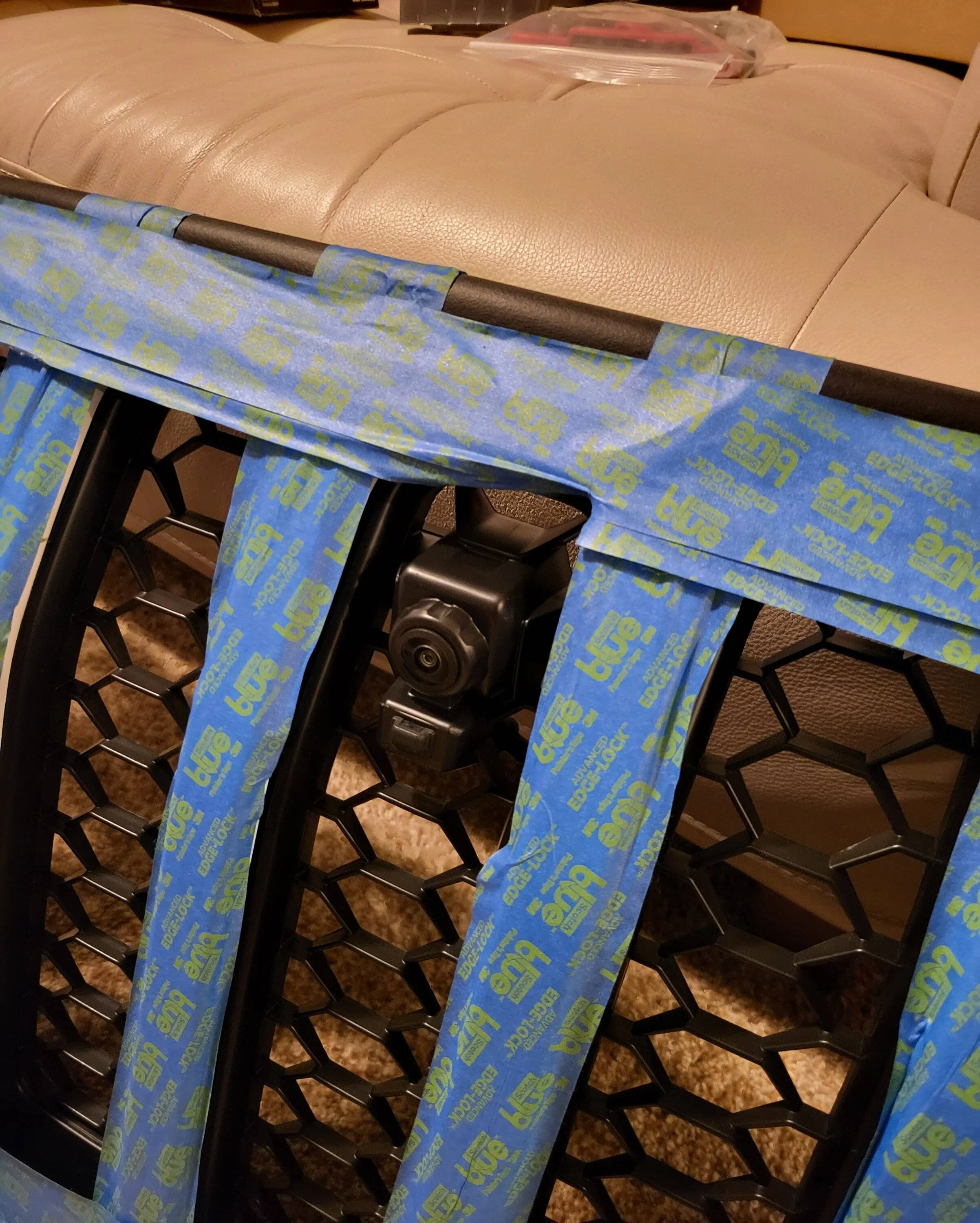

Possible 2023 Model Year or Parts Incompatibility:
Updated: 1/19/2024
When you order all the parts using existing parts list from other write ups, there are two notable parts that I was not able to use.
One is the nutsert for the grill and the other is the mounting screws for the camera bracket.
You can see below the nutsert is too small for the hole, it is intended for. The following parts were not utilized for my install.
(06510197AA (2) TWO Front camera bracket nuts)
(68090949AA (2) TWO Front camera bracket screws)
I believe this may be due to difference in year or trim. I purchased all the black inner grill pieces new so these hardwares should fit but they do not.
Jeep Gladiator Mopar Trail Cam DIY Installation - 2023 Diesel Gladiator Rubicon 20240103_225013
Added 1-19-2024: Interestingly, the actual nutserts for the CVPM works in these holes and the M6 bolts fit into it.
Jeep Gladiator Mopar Trail Cam DIY Installation - 2023 Diesel Gladiator Rubicon 20240119_100948
(OUTDATED INFO) So I have mounted the camera bracket differently using push retainer clips/rivets and they seems to be doing the job well. Picture above shows how the camera bracket is mounted.
Jeep Gladiator Mopar Trail Cam DIY Installation - 2023 Diesel Gladiator Rubicon 20240103_224909
So here it is all assembled.

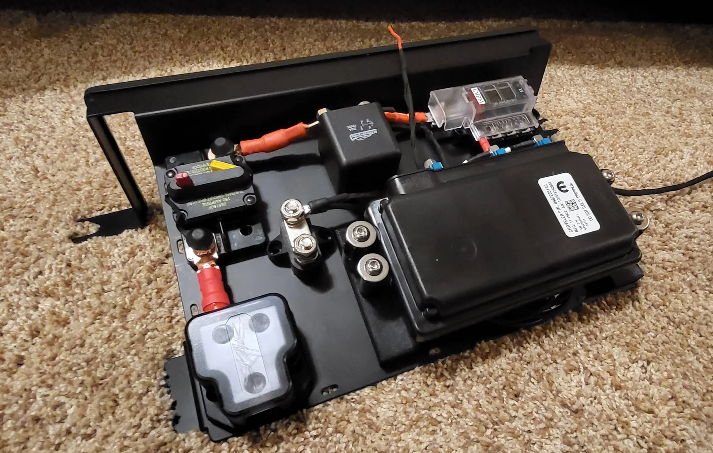

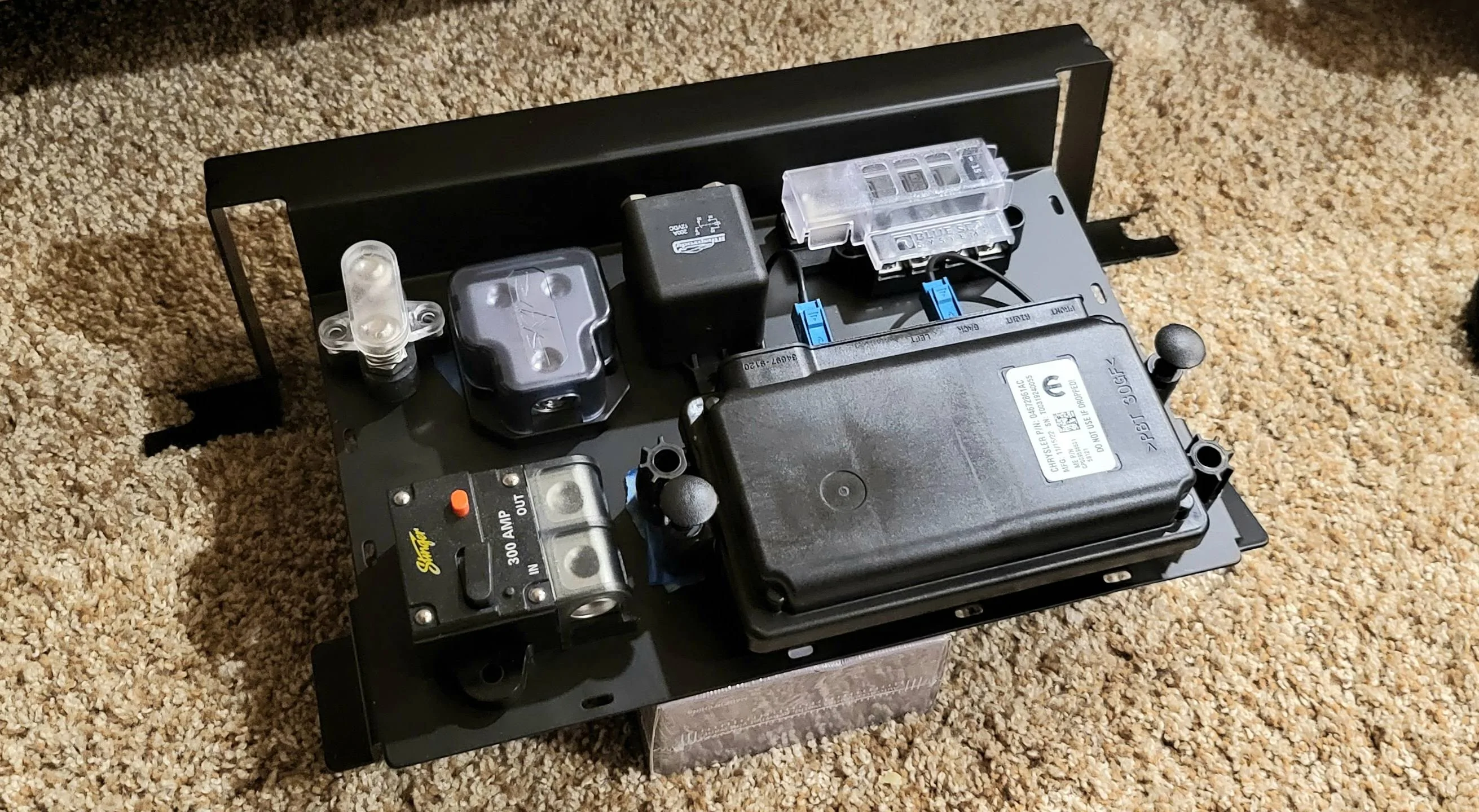

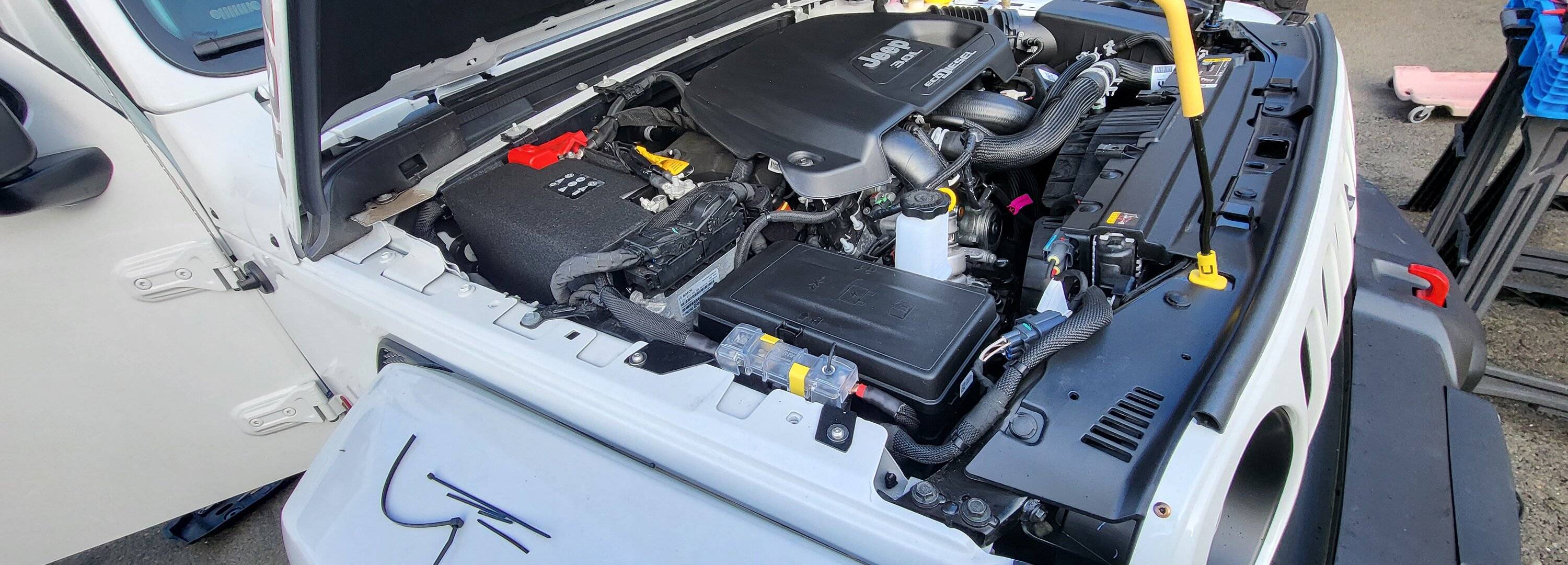

Power Distribution Center and CVPM mount prototyping:
The goal is to run the least amount of wires through the firewall and still have enough power to run air compressor and RockSlide Engineering Side Steps simulteneously inside the cab plus possible other future accessories like CB and a few other 12v items. Fused PDC for individual circuits has not arrived yet.

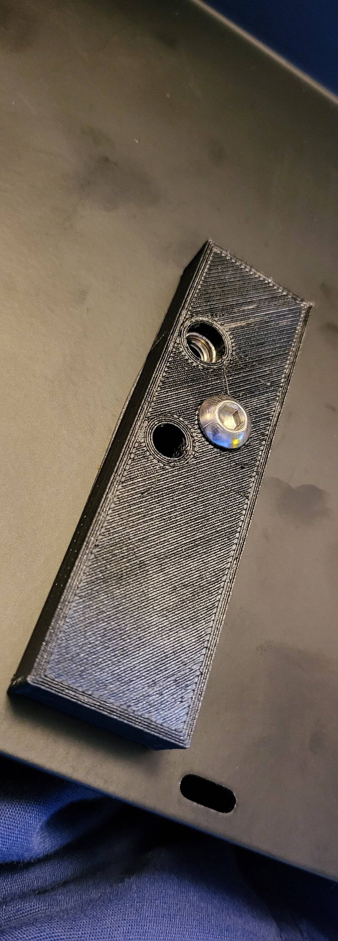

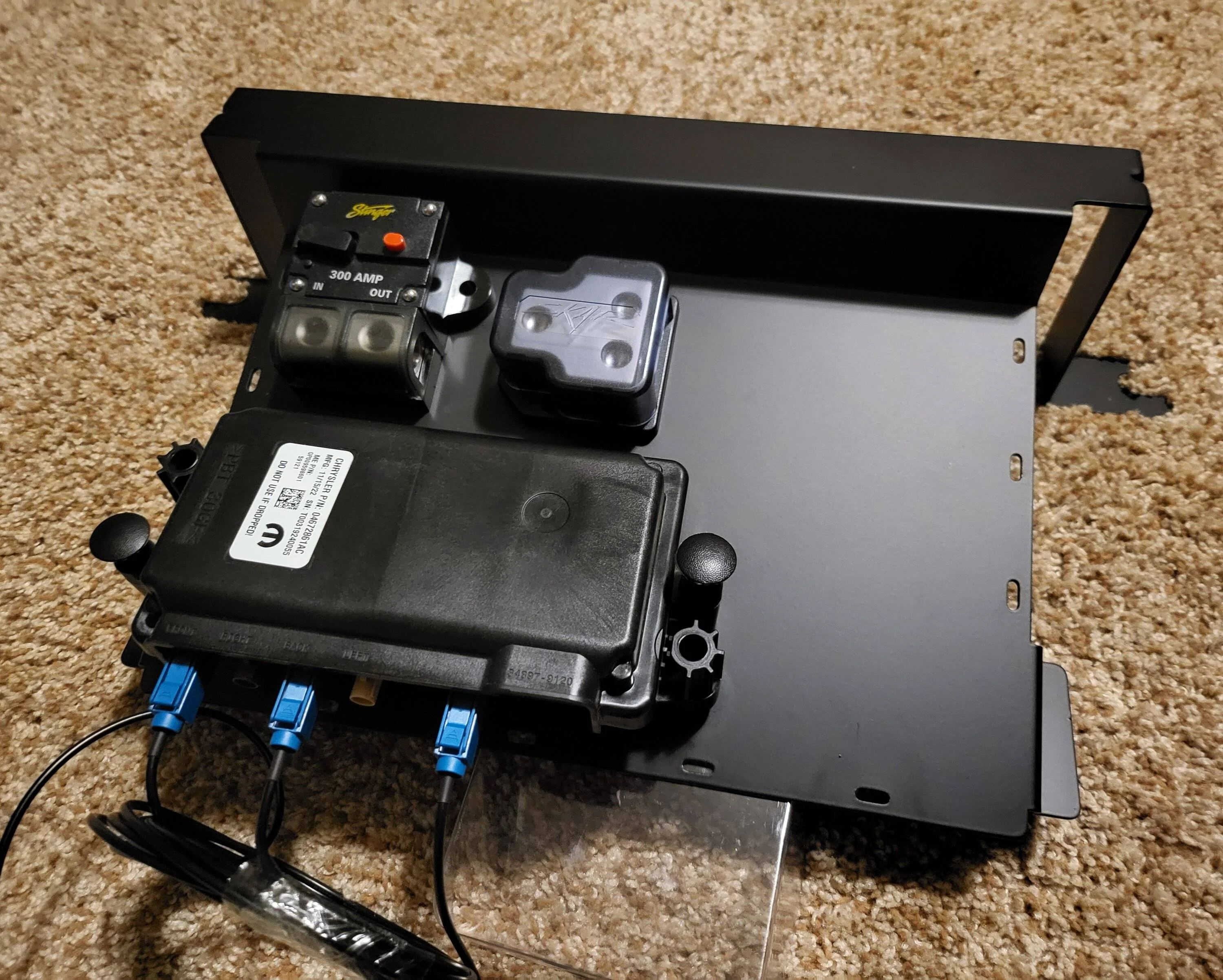

Started designing brackets for the CVPM.
Jeep Gladiator Mopar Trail Cam DIY Installation - 2023 Diesel Gladiator Rubicon 20240111_153914
That is version 1. Simplified version in the works.
Mocked up component placement.
Jeep Gladiator Mopar Trail Cam DIY Installation - 2023 Diesel Gladiator Rubicon 20240111_165444

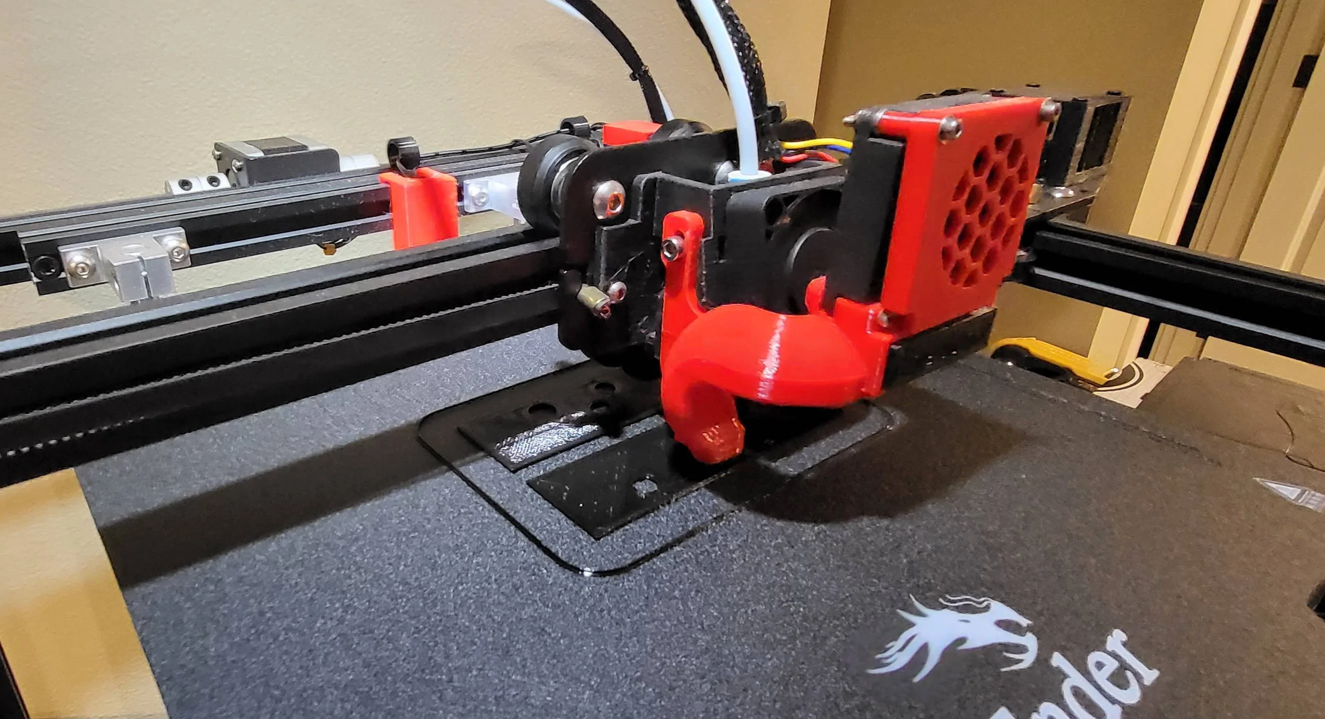

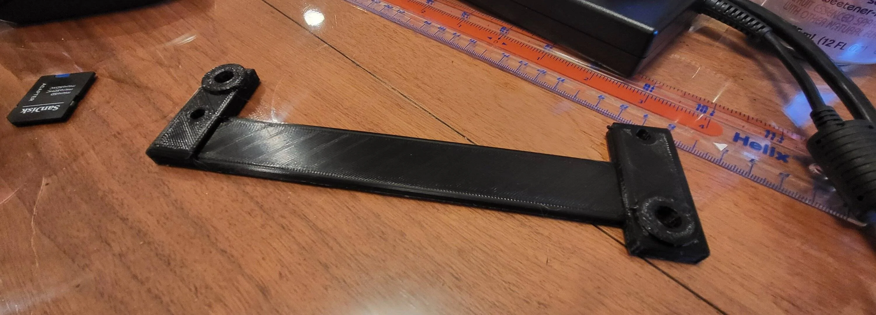

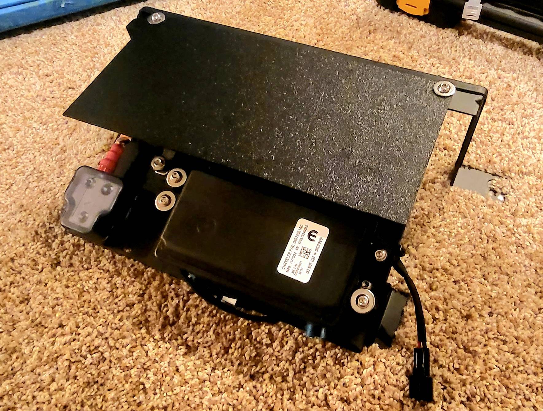

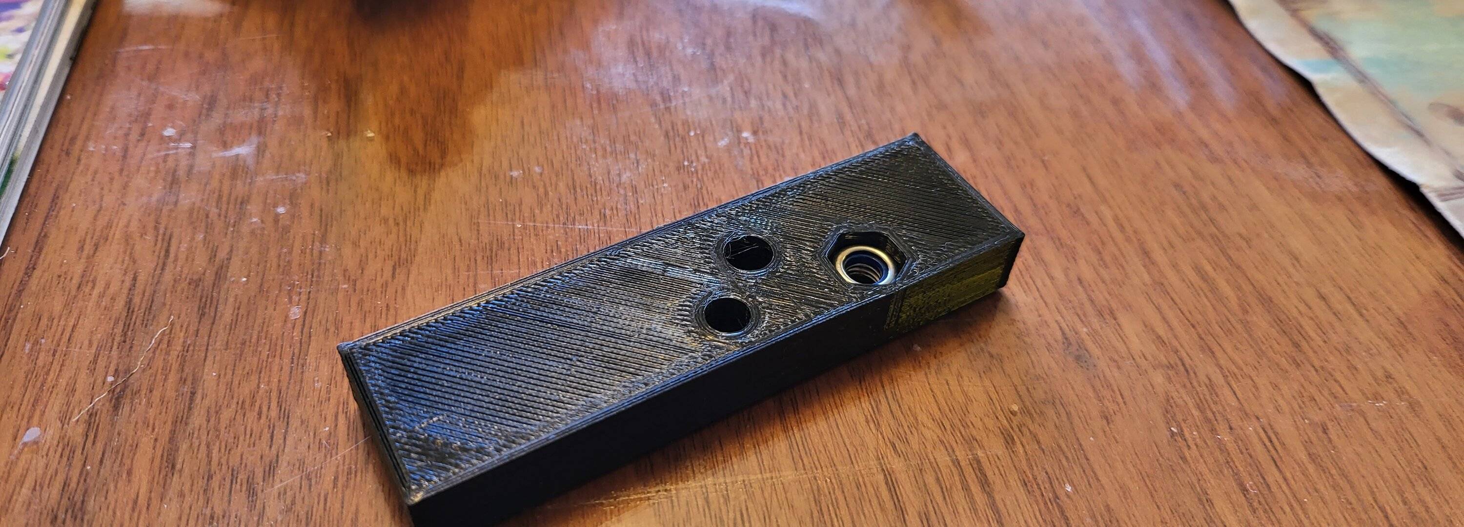

Final Version of the CVPM brackets being printed.
Jeep Gladiator Mopar Trail Cam DIY Installation - 2023 Diesel Gladiator Rubicon 20240111_205816
Embedded a nut for future serviceability.
Jeep Gladiator Mopar Trail Cam DIY Installation - 2023 Diesel Gladiator Rubicon 20240112_132959
Mounted through the platform with 3M trim tape underneath.
Jeep Gladiator Mopar Trail Cam DIY Installation - 2023 Diesel Gladiator Rubicon 20240112_143010
All mounted: Added nutserts on the top to add dust cover. Edge protector added along the top edge where it will be exposed to the rear passenger.
Jeep Gladiator Mopar Trail Cam DIY Installation - 2023 Diesel Gladiator Rubicon 20240113_194140
Final Product: 3 wire hook up, 12V Positive and Negative, Ignition Hot plus CAN bus connector.

Finished underseat CVPM/PDC module.
Jeep Gladiator Mopar Trail Cam DIY Installation - 2023 Diesel Gladiator Rubicon 20240112_203823

You put stuff under the seat - where does Jeep put that stuff in a factory install?
Behind the back seat, behind the of the interior plastic trim.
@Jimmy07 and @ecidiego made two great guides on these stock placement. They were the original trail blazers.
40,442
53,857
@Jimmy07 and @ecidiego made two great guide on these stock placement. They were the original trail blazers.
I've read most of ecidiego's write-up but not all details.
Knowing that - I'll take "what's under your seat" for 200.
It was enough of a pain to route the wiring for the power steps and dealing with all that trim.
OTOH, I'm just picky enough it might outweigh the hours extra going back that far.
Anyway -got it, thanks.
